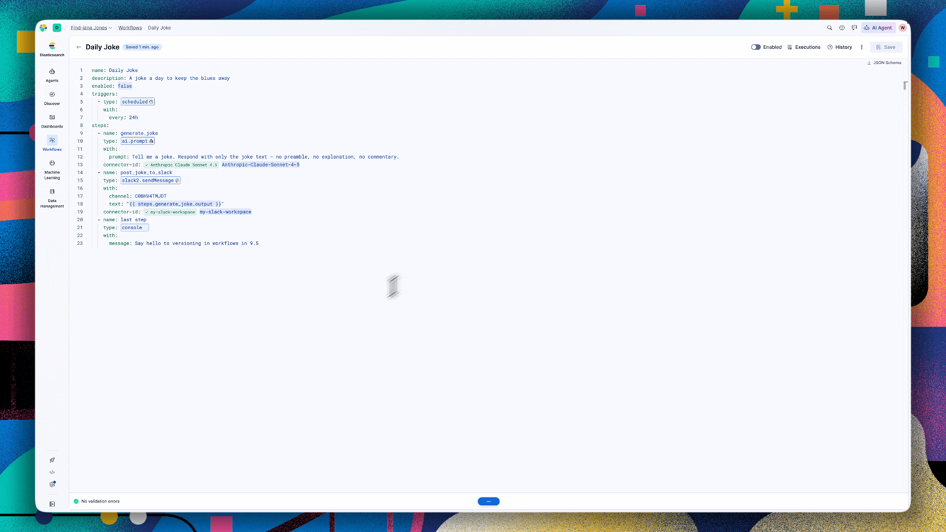

In 9.5 that bet pays off, and it is GA. Inside the workflow editor, you write what you want in plain language:

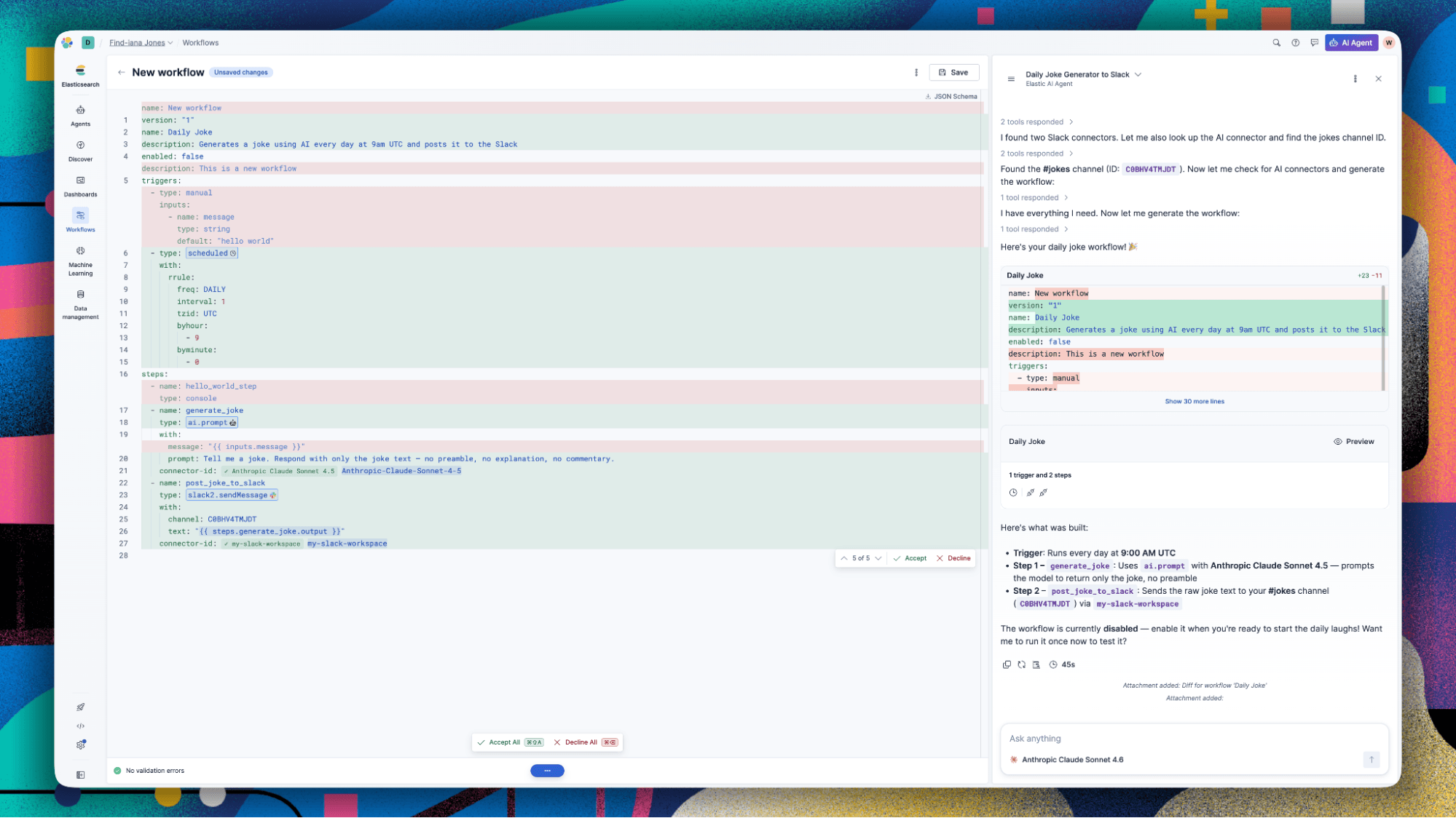

When a detection alert fires for a host, pull the last 24 hours of related logs, ask the AI step to summarize what happened, and post the summary to the on-call Slack channel.
The Elastic AI Agent generates the workflow: the trigger, the Elasticsearch query, the AI summarize step, the Slack step, wired together with the right inputs and outputs. You get inspectable, editable YAML back. Nothing runs until you read it, adjust it, and decide to run it. You can also point it at a workflow you already have and describe the change you want, and it edits in place.
Natural language prompt on the right, the generated YAML on the left, in the 9.5 workflow editor.
