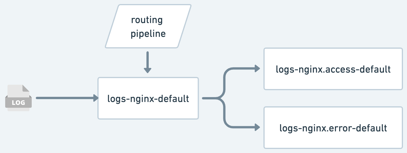

Elastic Observability offers a wide range of integrations that help you to monitor your applications and infrastructure. These integrations are added as policies to Elastic agents, which help ingest telemetry into Elastic Observability. Several examples of these integrations include the ability to ingest logs from systems that send a stream of logs from different applications, such as Amazon Kinesis Data Firehose, Kubernetes container logs, and syslog. One challenge is that these multiplexed log streams are sending data to the same Elasticsearch data stream, such as logs-syslog-default. This makes it difficult to create parsing rules in ingest pipelines and dashboards for specific technologies, such as the ones from the Nginx and Apache integrations. That’s because in Elasticsearch, in combination with the data stream naming scheme, the processing and the schema are both encapsulated in a data stream.
The reroute processor helps you tease apart data from a generic data stream and send it to a more specific one. You may use that mechanism to send logs to a data stream that is set up by the Nginx integration, for example, so that the logs are parsed with that integration and you can use the integration’s prebuilt dashboards or create custom ones with the fields, such as the url, the status code, and the response time that the Nginx pipeline has parsed out of the Nginx log message. You can also split out/separate regular Nginx logs and errors with the reroute processor, providing further separation ability and categorization of logs.
