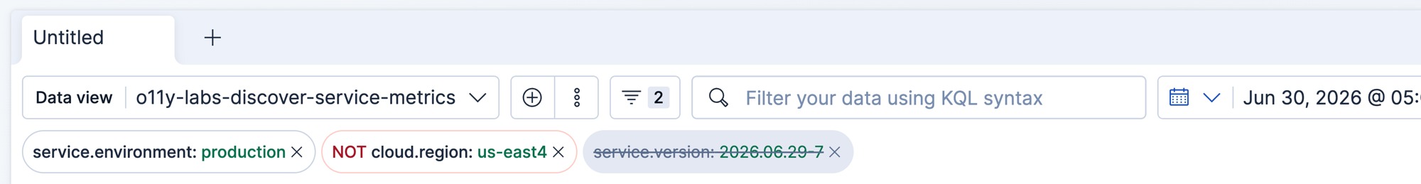

Choose a data view in Kibana Discover
The data view is the first filter in Discover. It decides which Elasticsearch indices are searched, which time field drives the histogram, and which fields are available in the left field list.
For this walkthrough, the Discover data view points to:
o11y-labs-discover-service-metrics
The time field is @timestamp. That matters because the time picker limits the documents before you add a query, a filter pill, or a selected field.
Use a narrow data view when you can. For example, a data view that targets only service metrics makes Discover easier to scan than a broad logs-*,metrics-* data view when you already know the question is about metrics.
Once the data view is selected, add the fields that support the investigation:
  • service.name
  • service.environment
  • cloud.region
  • metrics.latency.p95_ms
  • metrics.cpu.pct
  • metrics.error.rate

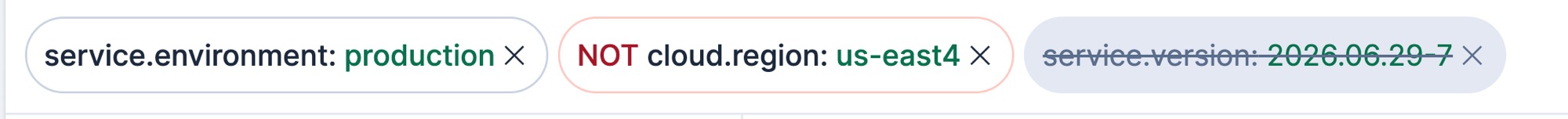

Filter pills in Discover: include, exclude, disable, and pin
UI filters are useful when you want a visible, editable list of constraints. They are also helpful when you are exploring fields from the document table and want Discover to write the field syntax for you.
In the document table, use the field actions (the +/- icons that appear when you hover over a value) to include or exclude it. For example:
service.environment: production
NOT cloud.region: us-east4
service.version: 2026.06.29-7  (disabled)
These three filters show the main filter controls:
  • Include a value when you want only matching documents.
  • Exclude a value when a dimension is not part of the problem.
  • Temporarily disable a filter when you want to keep it nearby but remove it from the current query.
  • Pin a filter when it should stay active as you move between Kibana apps.
Pinned filters are useful for investigations that cross app boundaries. For example, you can pin service.environment: production before moving from Discover to dashboards, Lens, or another view. Disabled filters are useful for testing a theory without deleting the context that got you there.
The key habit is to keep the filters readable. If a query has a long search expression and many hidden assumptions, another engineer has to reconstruct your thinking. Filter pills make the major scope decisions visible.

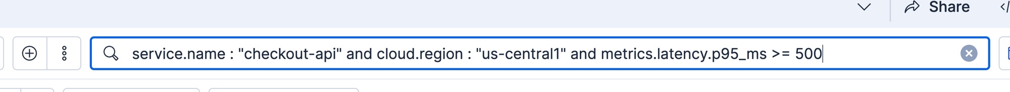

KQL query syntax for field, range, and boolean searches
KQL, the Kibana Query Language, is a good default for Discover searches. It supports field names, exact values, ranges, wildcards, and boolean logic in a readable form.
For the checkout latency example, this KQL query narrows the view to one service, one region, and high p95 latency:
service.name : "checkout-api" and cloud.region : "us-central1" and metrics.latency.p95_ms >= 500
Read it from left to right:
  • service.name : "checkout-api" keeps one service.
  • cloud.region : "us-central1" keeps one cloud region.
  • metrics.latency.p95_ms >= 500 keeps latency samples at or above 500 ms.
You can add the environment in KQL:
service.environment : "production" and service.name : "checkout-api" and cloud.region : "us-central1" and metrics.latency.p95_ms >= 500
Or you can keep service.environment: production as a UI filter. Both approaches are valid. For shared investigations, we prefer stable scope, such as environment and service, as filter pills, and the active hypothesis, such as a latency threshold, in the search bar.
KQL also works well for combining fields:
(service.name : "checkout-api" or service.name : "payments-api") and
metrics.error.rate > 0.02
This is useful when a user-facing flow crosses multiple services. You can compare a small group of services without switching data views or creating a dashboard first.

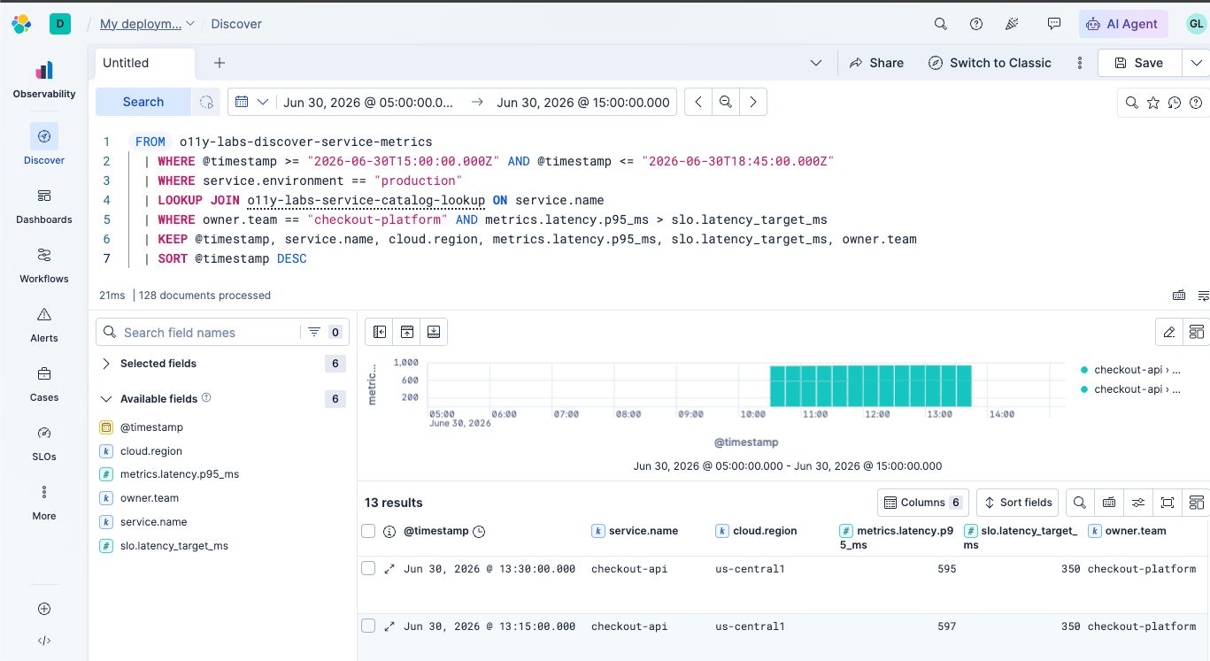

Run the LOOKUP JOIN query
Now Discover can run an ES|QL query that joins the metric documents with that catalog metadata using LOOKUP JOIN. Remember that this command needs Elasticsearch 9.1 or later, that the lookup index must be created with index.mode: lookup, and that the join field, service.name here, must be mapped as keyword in the lookup index.
FROM o11y-labs-discover-service-metrics
| WHERE @timestamp >= "2026-06-30T15:00:00.000Z" AND @timestamp <= "2026-06-30T18:45:00.000Z"
| WHERE service.environment == "production"
| LOOKUP JOIN o11y-labs-service-catalog-lookup ON service.name
| WHERE owner.team == "checkout-platform" AND metrics.latency.p95_ms > slo.latency_target_ms
| KEEP @timestamp, service.name, cloud.region, metrics.latency.p95_ms, slo.latency_target_ms, owner.team
| SORT @timestamp DESC
This is the part classic mode does not cover. Classic Discover can filter the metric documents, but ES|QL can enrich those rows with data from another index before displaying the result.
The result table answers a more operational question than the original search. It shows the affected service, the region, the latency value, the target, and the owning team in one view.
This pattern is useful for more than ownership. You can keep small lookup indices for service tier, deployment ring, escalation channel, business capability, or runbook URL. Then you can join that context into metric searches at investigation time.
