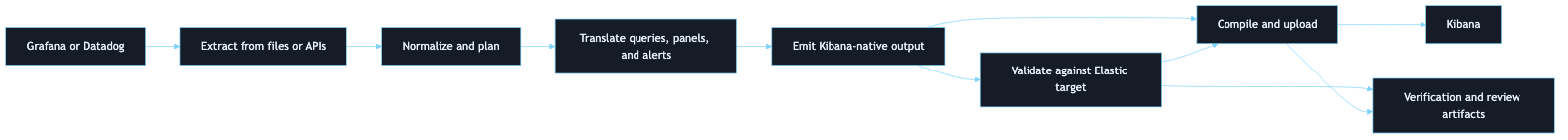

The migration platform automates the query translation and panel rebuilds that used to dominate Datadog moves. Elasticsearch stores Kubernetes metrics efficiently and runs the ES|QL queries those panels use. See Elasticsearch as a metrics backend for benchmark context and storage comparisons.
The platform maps Datadog queries to Kibana panels, validates ES|QL against live data, and writes artifacts you can inspect before anything goes to production.

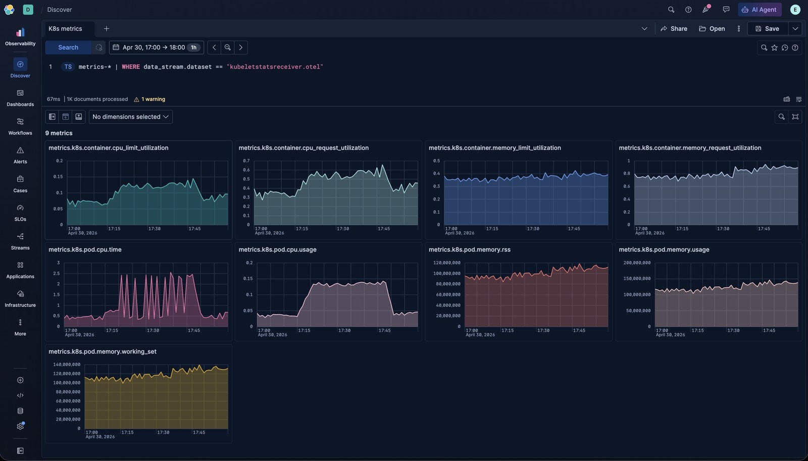

Ingest Kubernetes metrics first
Empty panels after upload usually mean Elasticsearch does not yet have the series the Datadog queries reference. Make sure to confirm ingest before you run the migration.
There are two common paths to do so:
  1. OpenTelemetry into managed OTLP with Kubernetes receivers (kubeletstats, k8s_cluster), then explore in Discover
  2. Existing Prometheus or agent pipelines that already write pod and node metrics to metrics-*
The migration CLI accepts --field-profile otel to map Datadog tags such as pod_name, kube_namespace, and kube_cluster_name to OpenTelemetry fields like kubernetes.pod.name and kubernetes.namespace. If panels are empty after migration, verify field mapping and the selected time range before you change translator settings.

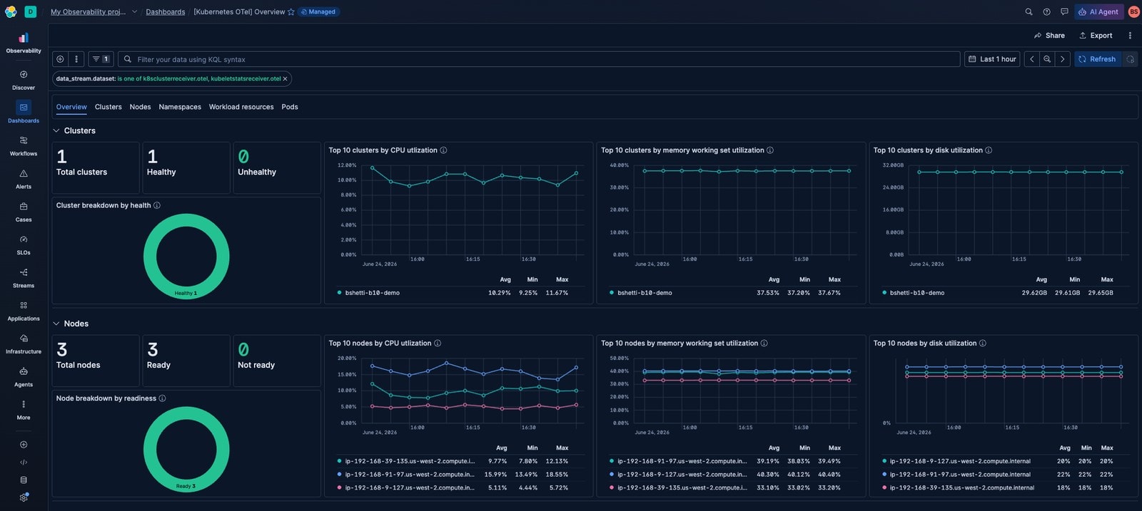

Validate the migrated Datadog dashboard in Kibana
Open Kibana → Dashboards and locate the migrated Kubernetes - Overview board. Confirm that cluster and namespace pod counts, CPU and memory series, pod phase panels, CrashLoopBackOff widgets, and deployment replica charts return data for your selected time range.
If you migrated monitors, open Observability → Rules. Imported rules remain disabled until you enable them after reviewing thresholds.
