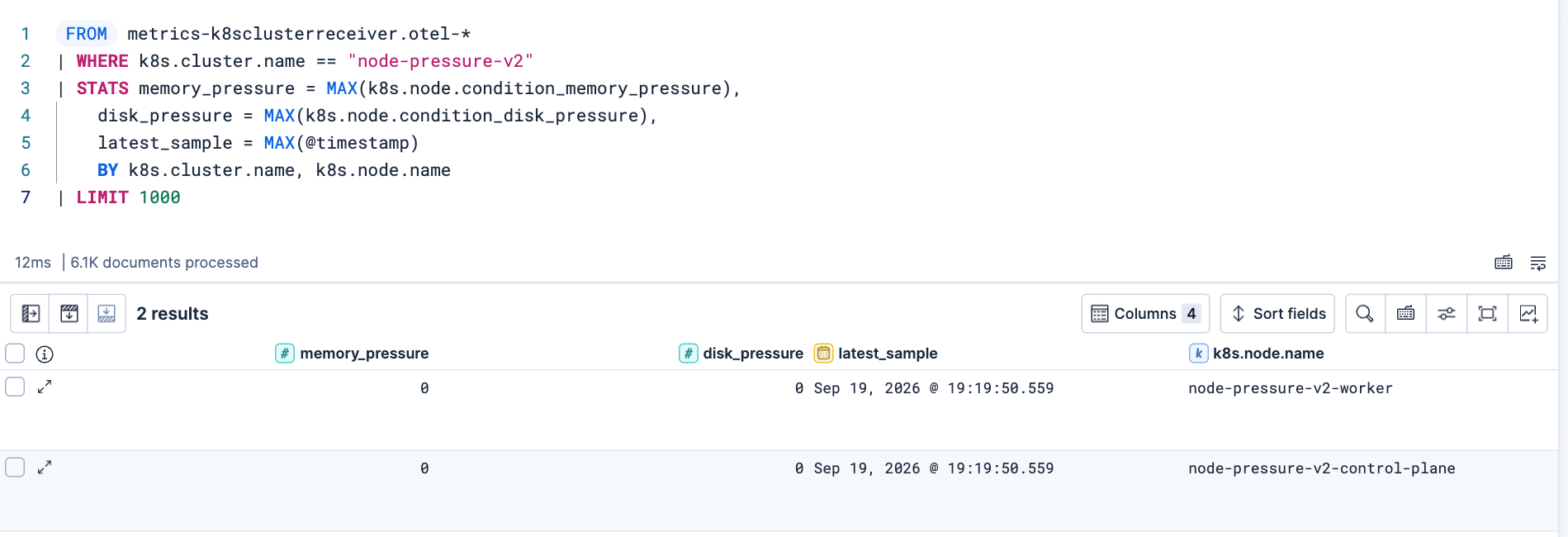

In Discover, confirm two data streams:
  1. metrics-kubeletstatsreceiver.otel-* has fresh k8s.node.memory.available values for each k8s.node.name.
  2. metrics-k8sclusterreceiver.otel-* has k8s.node.condition_memory_pressure and k8s.node.condition_disk_pressure, where 0 is false and 1 is true.
Run this Elasticsearch Query Language (ES|QL) query in Discover to see the latest value of both conditions per node in the selected time range:
FROM metrics-k8sclusterreceiver.otel-*
| WHERE k8s.cluster.name == "node-pressure-v2"
| STATS memory_pressure = MAX(k8s.node.condition_memory_pressure),
    disk_pressure = MAX(k8s.node.condition_disk_pressure),
    latest_sample = MAX(@timestamp)
    BY k8s.cluster.name, k8s.node.name
| LIMIT 1000
k8s.node.memory.available tracks the value that the kubelet acts on. In the test, the metric read 6,093,116 KiB one second before the kubelet logged an eviction with available: 6092844Ki.

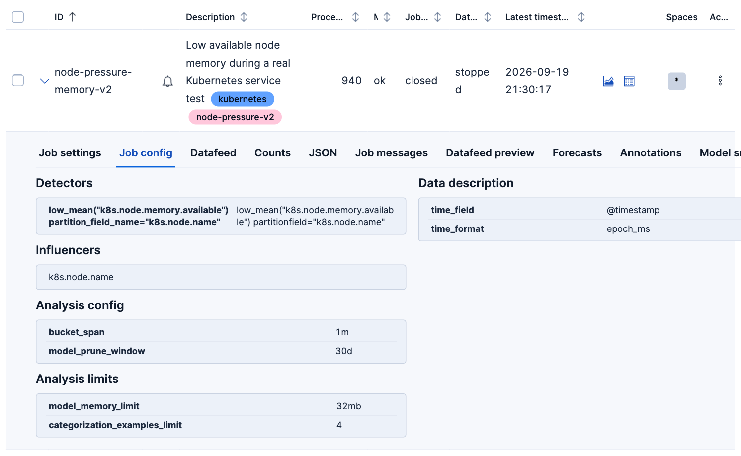

Step 2: Create a per-node anomaly detection job for node memory
Create the job and its datafeed in Dev Tools > Console:
PUT _ml/anomaly_detectors/node-pressure-memory-v2
  "analysis_config": {
    "bucket_span": "1m",
    "detectors": [{
      "function": "low_mean",
      "field_name": "k8s.node.memory.available",
      "partition_field_name": "k8s.node.name"
    "influencers": ["k8s.node.name"]
  "analysis_limits": {"model_memory_limit": "32mb"},
  "data_description": {"time_field": "@timestamp"},
  "model_plot_config": {"enabled": true},
  "datafeed_config": {
    "datafeed_id": "datafeed-node-pressure-memory-v2",
    "indices": ["metrics-kubeletstatsreceiver.otel-*"],
    "query_delay": "20s",
    "frequency": "10s",
    "query": {"bool": {"filter": [
      {"term": {"k8s.cluster.name": "node-pressure-v2"}},
      {"exists": {"field": "k8s.node.memory.available"}}
The following settings matter most:
  • low_mean scores only buckets where the average is unusually low, so a node that frees memory never raises an anomaly.
  • partition_field_name gives every node its own baseline. A 64 GiB node and an 8 GiB node never share a model.
  • bucket_span of 1m suits 10-second sampling in a small cluster. A span of 5m or 15m costs less and smooths noisy nodes, and the alert arrives later.
  • query_delay of 20s leaves time for metrics to arrive before a bucket is analyzed.
  • model_plot_config stores the model bounds, which Single Metric Viewer draws as the expected range.
Open the job, and start the datafeed from the beginning of your node history. Replace the start value with the timestamp of your first kubeletstats document:
POST _ml/anomaly_detectors/node-pressure-memory-v2/_open
POST _ml/datafeeds/datafeed-node-pressure-memory-v2/_start
{"start":"2026-09-19T18:53:00Z"}
In Machine Learning > Manage jobs, confirm that the processed record count increases. If a job created through the API is missing from the list, select Synchronize saved objects.
A mean detector needs at least eight non-empty buckets or two hours of data, whichever is greater. For production, let the model see full workload cycles, including the busy periods that you expect.

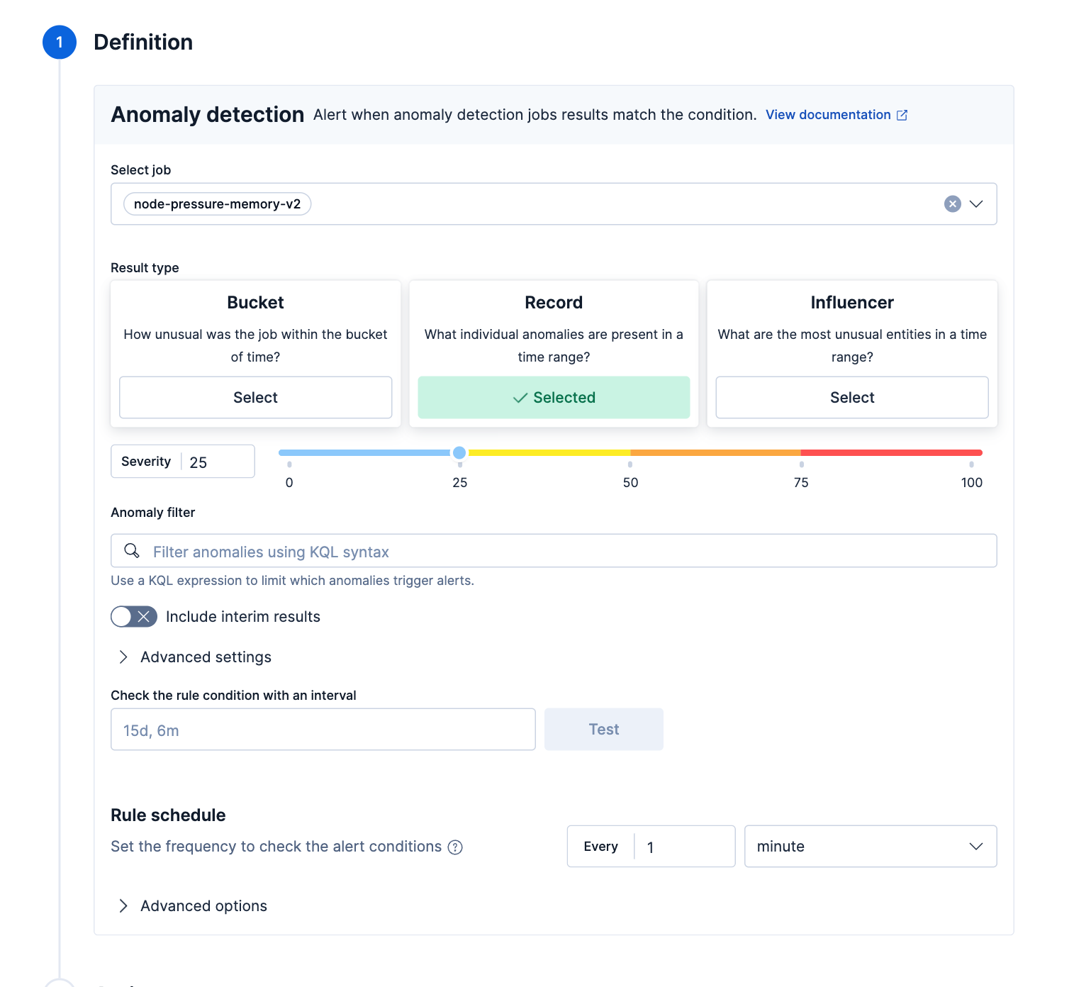

Step 3: Create an alerting rule on the anomaly score
Open Stack Management > Rules > Create rule, select Anomaly detection, name the rule Node pressure v2 as "unusual memory headroom", and choose the job. Use the following settings:
Setting
Value
Why
Result type
Record
Evaluates each node's own anomaly
Severity threshold
25
Lower edge of the 25–50 band in Anomaly Explorer
Include interim results
Off
Evaluates finalized buckets only
Check interval
1 minute
Matches the job's bucket span
The anomaly score is a 0–100 measure of how unusual a bucket is for that node. Tune the threshold against routine changes in your cluster.
Add a connector and an action so the alert reaches Slack, email, or PagerDuty. Include {{context.anomalyExplorerUrl}} and {{context.topRecords}} from the anomaly detection action variables in the message, so the notification links straight to the affected node.

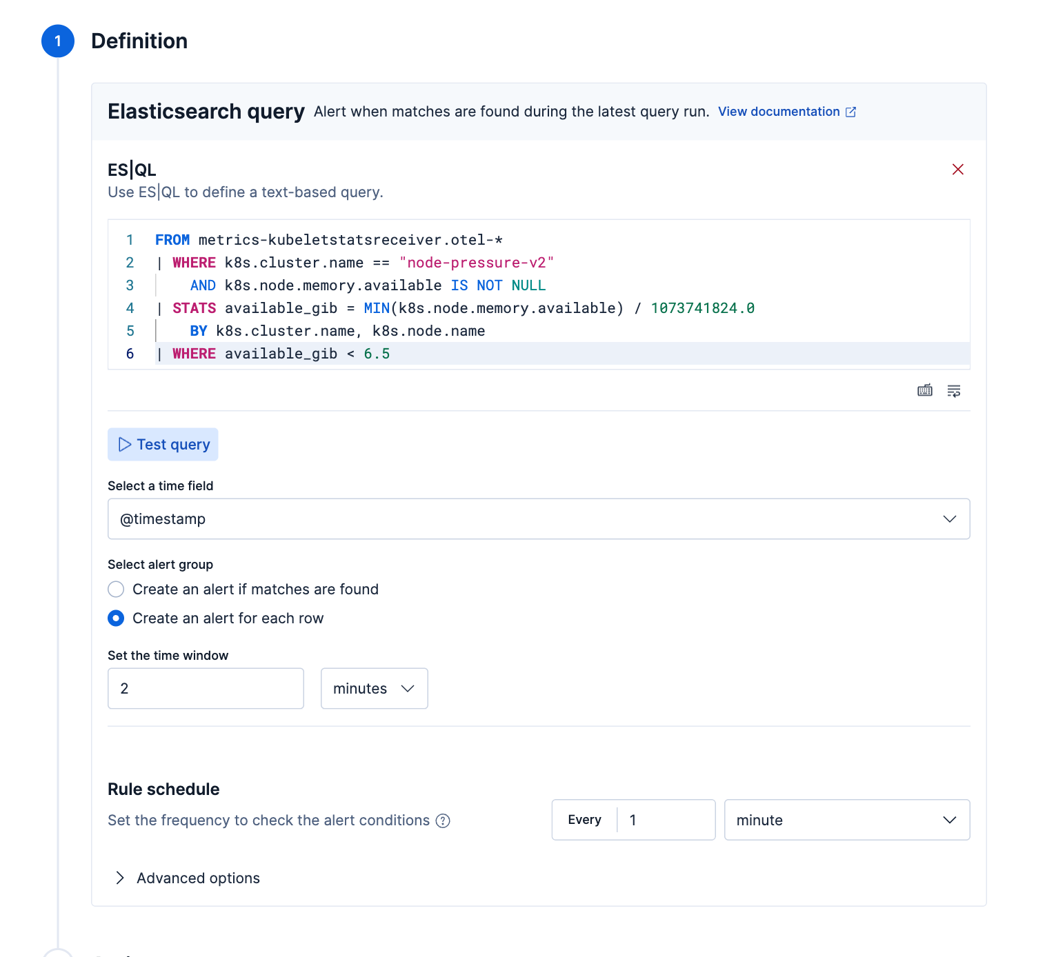

Step 4: Add Kubernetes alerting rules for headroom and pressure conditions
A workload that grows at its usual pace can exhaust a node without producing a high anomaly score. Cover that case with an Elasticsearch query rule that uses this ES|QL query:
FROM metrics-kubeletstatsreceiver.otel-*
    AND k8s.node.memory.available IS NOT NULL
| STATS available_gib = MIN(k8s.node.memory.available) / 1073741824.0
| WHERE available_gib < 6.5
Name the rule Node pressure v2: memory headroom warning, set the time field to @timestamp, select Create an alert for each row, and use a two-minute window with one-minute checks. The 6.5 GiB level sits 0.5 GiB above the scenario's soft eviction threshold. Size your own margin to how fast memory can fall between two rule runs.

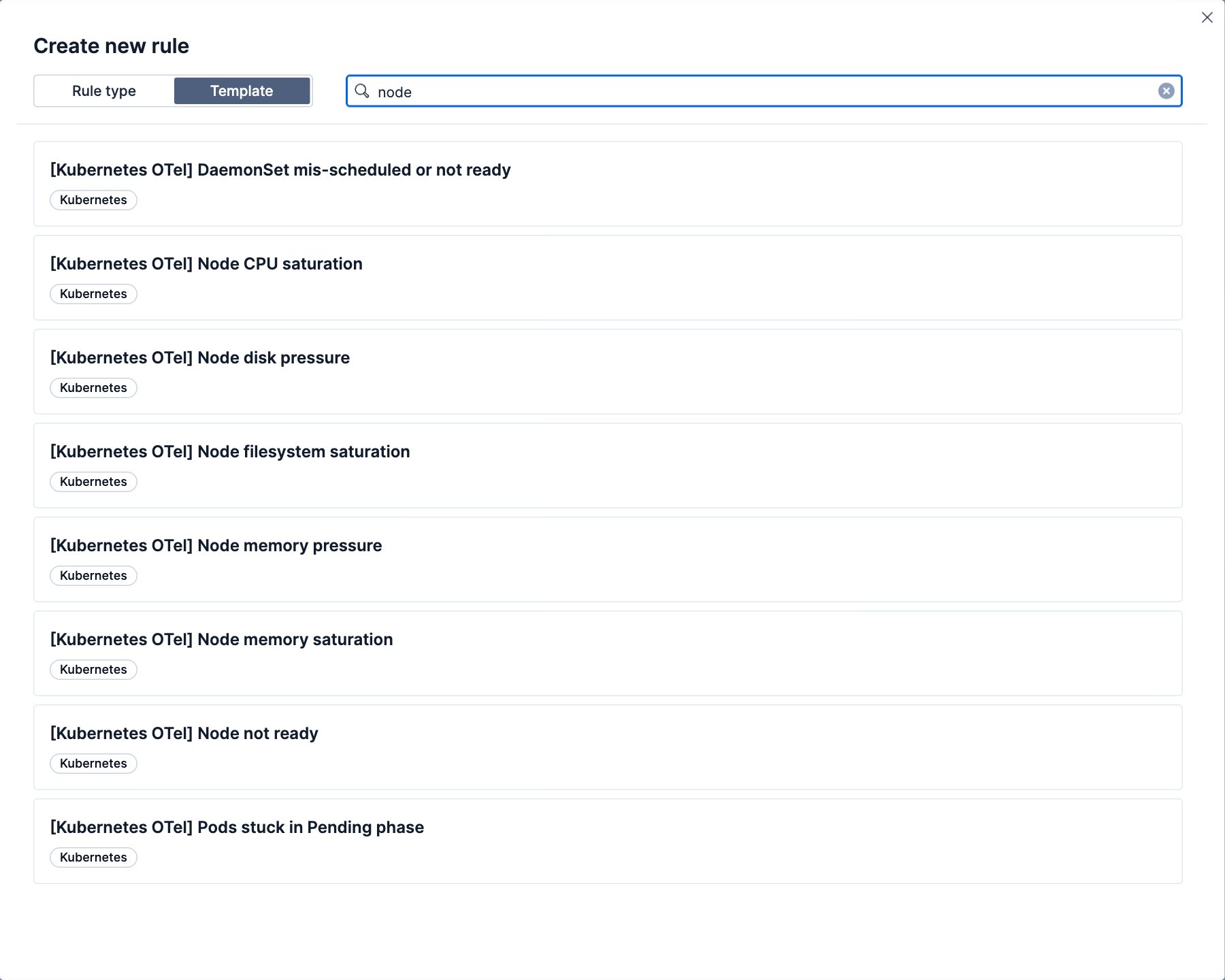

Then create the condition rules from Create rule > Templates: [Kubernetes OTel] Node memory pressure and [Kubernetes OTel] Node disk pressure. Add this line after each template's TS source line, so the rule only evaluates your cluster:
The templates wait for three consecutive matches by default. This walk-through sets the alert delay to one match, because a soft eviction grace period can be shorter than three rule runs. Alerting rule templates in Elastic integrations covers the window, schedule, and alert delay settings in more detail.

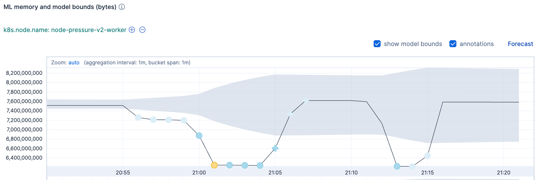

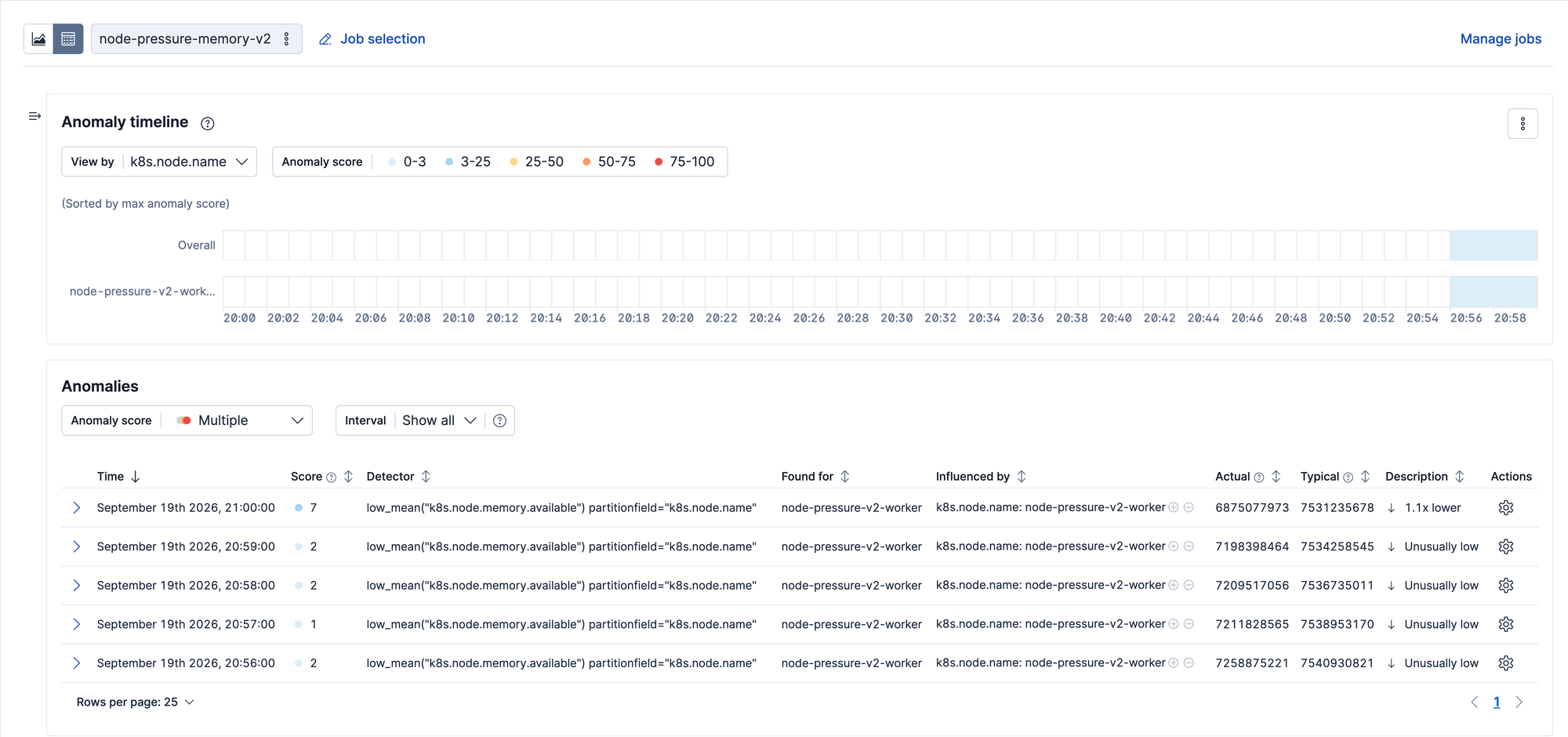

Read the anomaly record to find the affected node
Open Machine Learning > Anomaly Explorer, and select the job and the alert's time range. Then find the k8s.node.name in the anomaly record. Compare the Actual and Typical columns. Set the table interval to Show all to see one row per bucket.
In the scenario, the 20:56 bucket averaged 6.76 GiB against a typical 7.02 GiB, and the rule evaluated a score of 30 for it. MemoryPressure was still false, and the node was above the 6.5 GiB headroom level. Every HTTP request succeeded.
The Score column in this screenshot, taken after the run, reads 2 for the same bucket. Anomaly scores are renormalized as the model sees more data, which the results section covers.

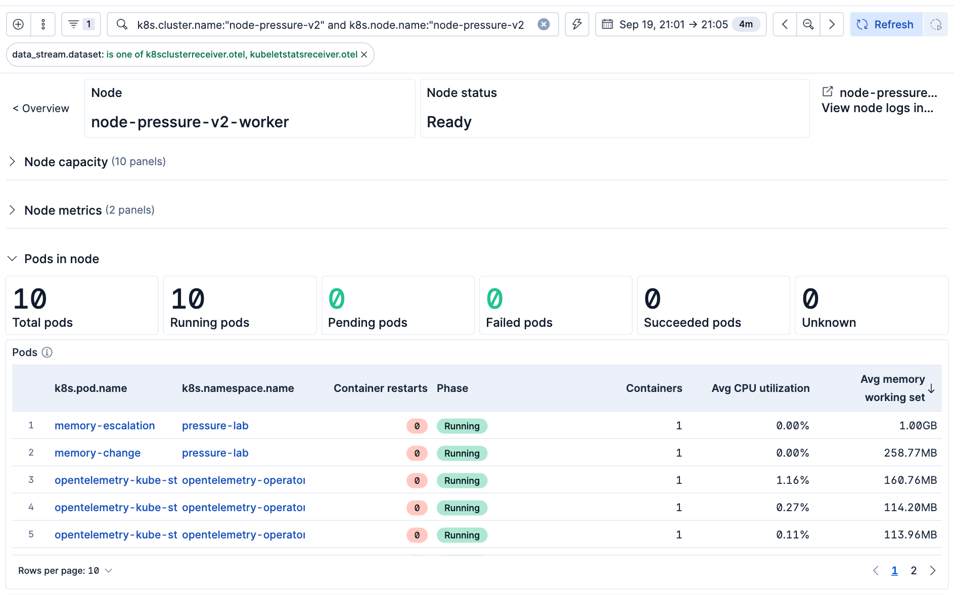

Which pod caused the Kubernetes node pressure?
Open the [Kubernetes OTel] Node Detail dashboard, and filter to the alert's cluster and node. Then sort the pod table by Avg memory working set.
The largest pod and the one that changed can be different pods. This query compares each pod's last five minutes with its earlier baseline:
    AND k8s.node.name == "node-pressure-v2-worker"
    AND k8s.pod.memory.working_set IS NOT NULL
    AND @timestamp >= NOW() - 1 hour
| STATS
    recent = AVG(k8s.pod.memory.working_set) WHERE @timestamp >= NOW() - 5 minutes,
    baseline = AVG(k8s.pod.memory.working_set) WHERE @timestamp < NOW() - 15 minutes
    BY k8s.namespace.name, k8s.pod.name
| EVAL recent_mib = ROUND(recent / 1048576, 1),
       baseline_mib = ROUND(COALESCE(baseline, 0) / 1048576, 1)
| EVAL change_mib = ROUND(recent_mib - baseline_mib, 1)
| WHERE recent_mib IS NOT NULL
| SORT change_mib DESC
| LIMIT 5
The 10-minute gap between the two windows keeps a new pod's first minutes out of its baseline. Two minutes after the scenario's alert, the query returns memory-change with a change_mib of 246.8 and every other pod on the node within 1 MiB of its baseline.

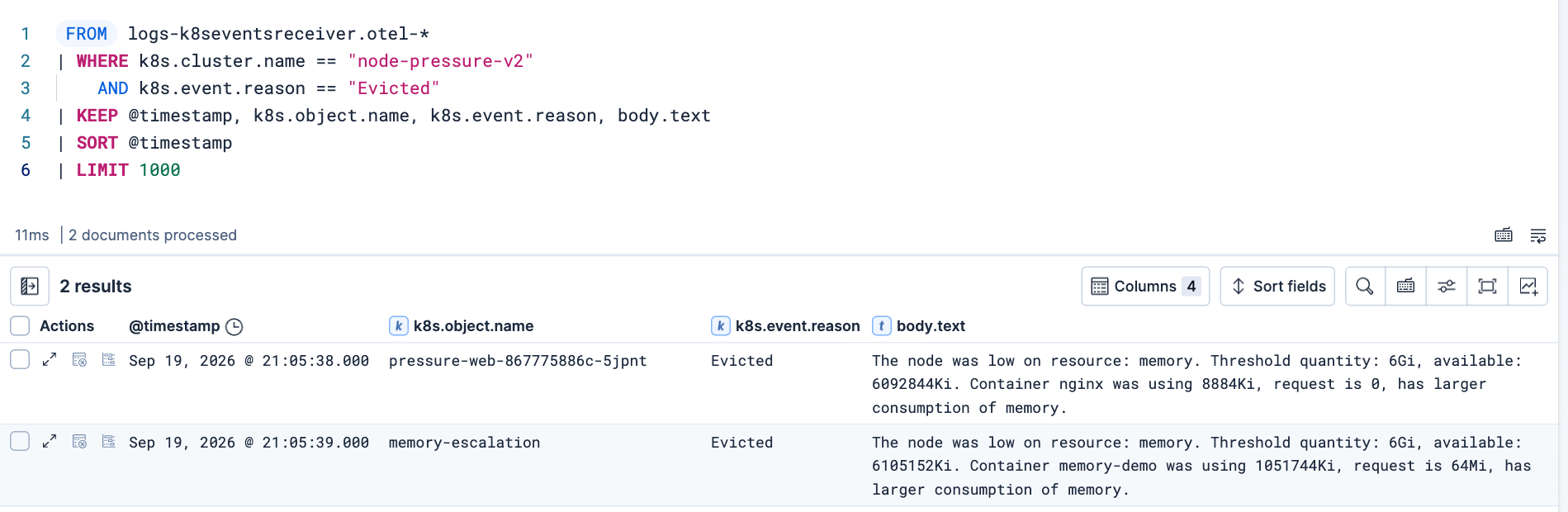

Then confirm recovery from both sides. Available memory returns to its typical range, and service requests succeed. Plus, no pods were evicted during the response. This query reads eviction events collected by the k8s_events receiver:
FROM logs-k8seventsreceiver.otel-*
    AND k8s.event.reason == "Evicted"
| KEEP @timestamp, k8s.object.name, k8s.event.reason, body.text
| SORT @timestamp
| LIMIT 1000

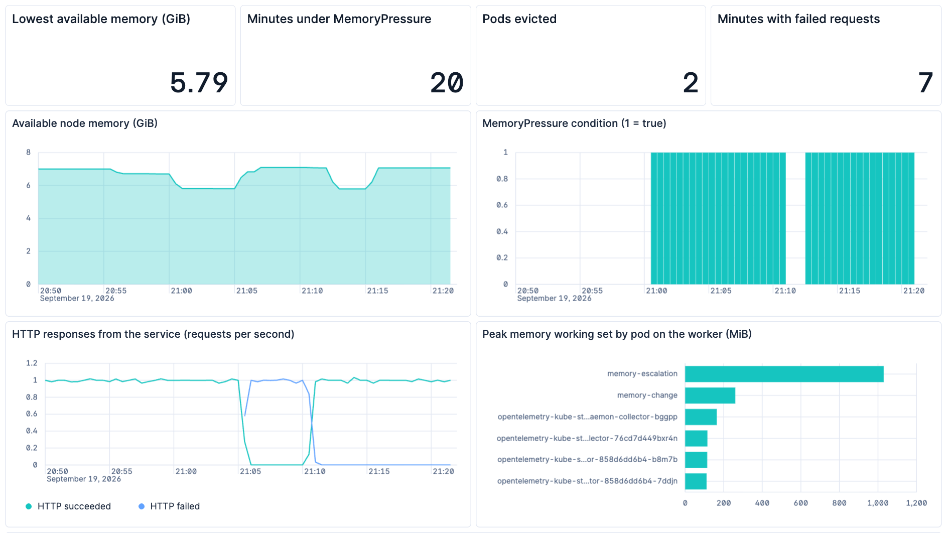

When the scenario runs without intervention, the kubelet evicts the NGINX pod first, with the message Container nginx was using 8884Ki, request is 0. The 1 GiB memory-escalation pod follows one second later. The evicted NGINX pod used under 9 MiB, and its eviction took the service down
The pressure condition clears later than the memory recovers. The kubelet holds MemoryPressure for its eviction-pressure-transition-period, five minutes by default, after the signal returns above the threshold.
How much warning does anomaly detection give before a pod eviction?
The anomaly alert opened 2 minutes 31 seconds before MemoryPressure and 7 minutes 29 seconds before the first failed request, but only when memory grew gradually. The scenario ran twice. In Run 1, the load continued until the kubelet evicted pods. In Run 2, both allocations started together and the load was removed after the headroom alert, because Run 2 raised no anomaly alert.
Event
Run 1: Load continues
Run 2: Load removed
Load starts
20:56:03 (256 MiB), 21:00:29 (1 GiB)
21:12:35 (both)
First finalized anomaly score
30.1
4.2
Anomaly alert
20:58:09
None
MemoryPressure true
21:00:40
21:12:45
Headroom alert
21:01:21
21:13:21
First eviction and failed request
21:05:38
None
Load removed
21:06:54
21:15:52
MemoryPressure clears
21:10:53
21:20:45
The same dashboard embeds the Single Metric Viewer of the anomaly detection job, with the model bounds and the anomaly markers for both runs. The companion notebook imports this dashboard, so you can read your own run the same way.
Three results stand out:
  1. The anomaly alert led MemoryPressure by 2 minutes 31 seconds. It flagged the 256 MiB change, before the 1 GiB allocation that pushed the node over its threshold. Five of the 7 minutes 29 seconds before the first failed request are the configured soft grace period.
  2. The headroom alert trailed MemoryPressure in both runs, by 41 and 36 seconds. A 1 GiB step crosses a 0.5 GiB margin and the eviction threshold in the same rule interval. In Run 2, the grace period provided the time to act.
  3. The anomaly score depends on how memory changes. The same total load arriving at once scored 4.2 and opened no anomaly alert.
Anomaly scores are renormalized as the model sees more data. The Run 1 record dropped from 30 to 2.7 in Anomaly Explorer after the 1 GiB step, while its initial_record_score kept the value that the rule evaluated. A flat two-hour baseline makes a 3.7% drop stand out. Expect lower scores for the same change on nodes with days of varied history.
