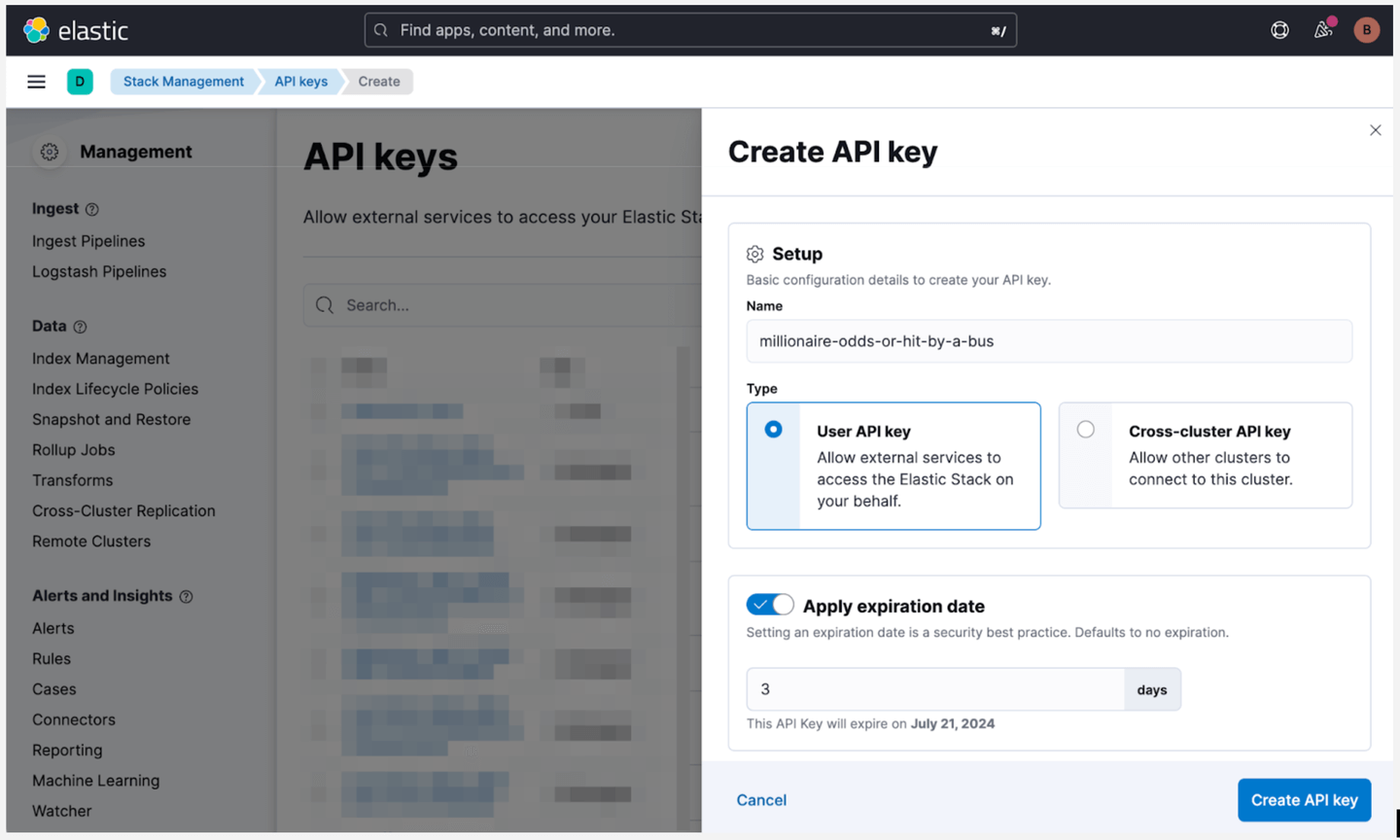

For the deployment API key, open Kibana, and generate the key in Stack Management / API Keys:

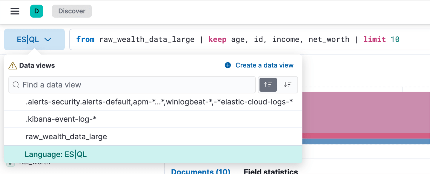

Understanding the wealth distribution with our first query
To get familiar with the dataset, head to Discover in Kibana and switch to ES|QL in the dropdown on the left hand side:

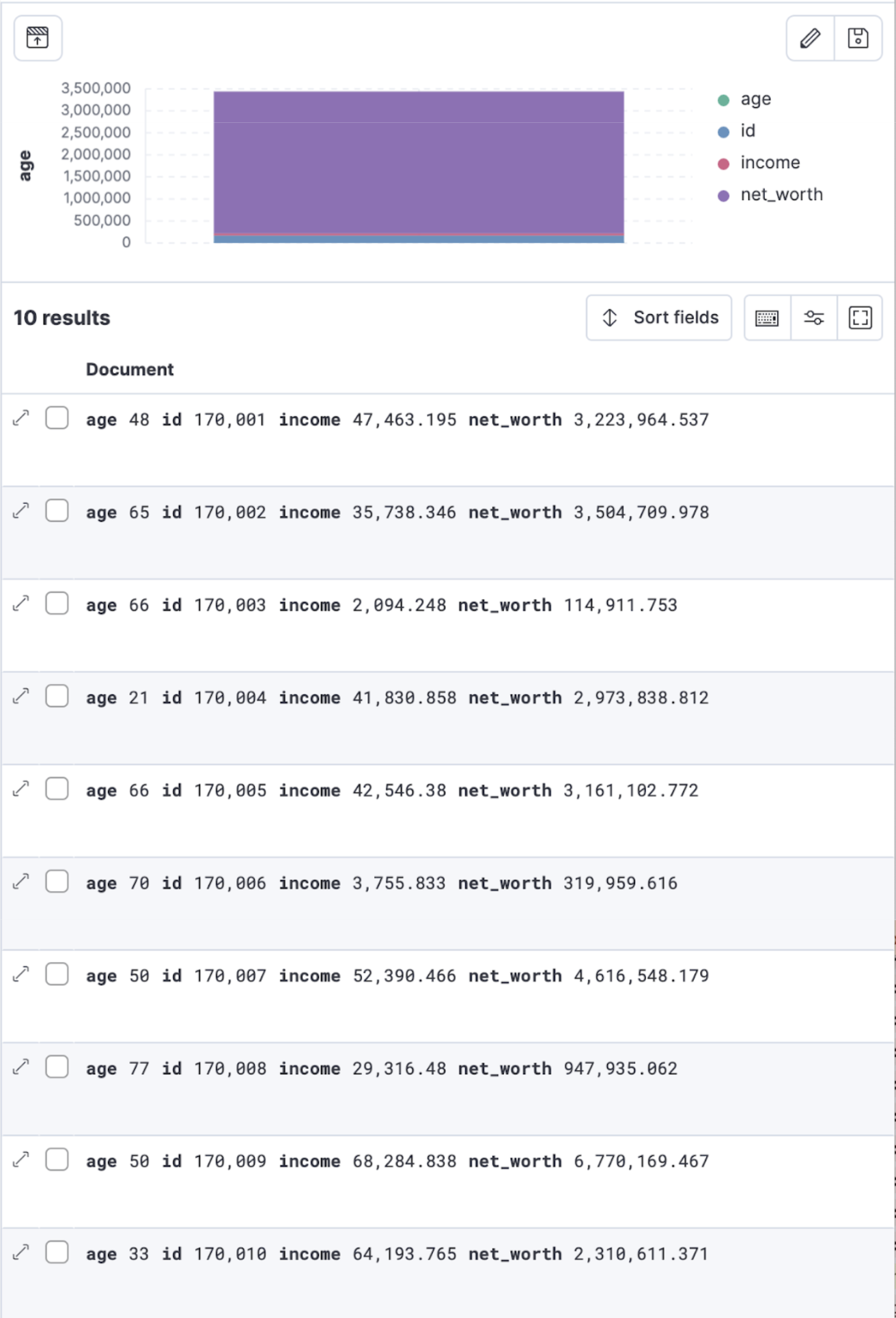

Let’s fire our first request:
from raw_wealth_data_large | keep age, id, income, net_worth | limit 10
As you could expect from our indexing script earlier, we are finding the documents we bulk ingested, notice the simplicity of pulling data from a given dataset with ES|QL where every query starts with the From clause, then your index.
In the query above given we have 500K lines, we limited the amount of returned documents to 10. To do this, we are passing the output of the first segment of the query via a pipe to the limit command to only get 10 results. Pretty intuitive, right?

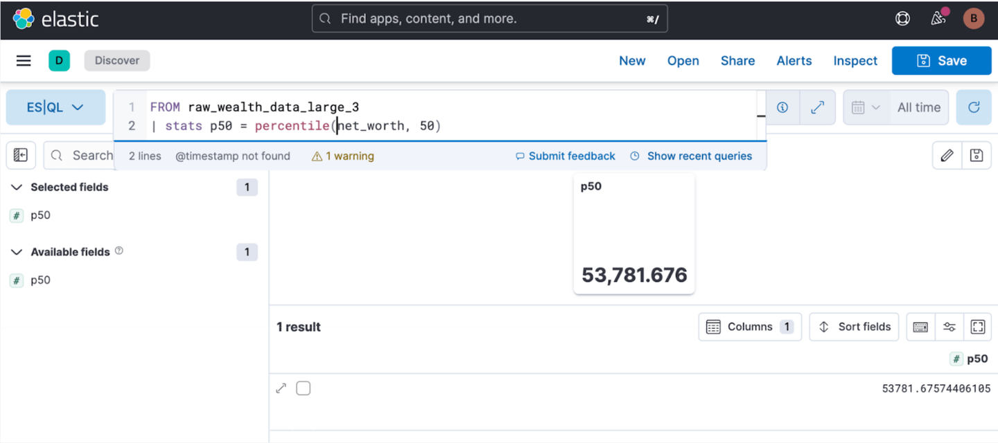

Alright, what would be more interesting is to understand the wealth distribution in our dataset, for this we will leverage one of the 30 functions ES|QL provides, namely percentile.
This will allow us to understand the relative position of each data point within the distribution of net worth. By calculating the median percentile (50th percentile), we can gauge where an individual’s net worth stands compared to others.
FROM raw_wealth_data_large
| stats p50 = percentile(net_worth, 50)
Like our first query, we are passing the output of our index to another function, Stats, which combined with the percentile function will output the median net worth:
The median is about 54K, which unfortunately is probably optimistic compared to the real world, but we are not going to solve this here. If we go a little further, we can look at the distribution in more granularity by computing more percentiles:

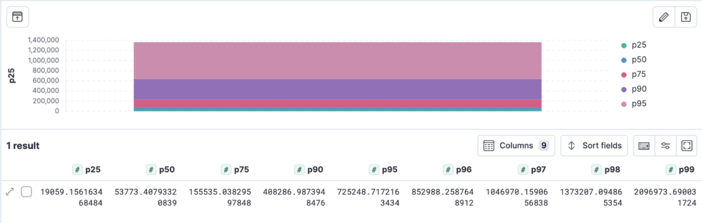

| STATS  p25 = percentile(net_worth, 25)
       , p50 = percentile(net_worth, 50)
       , p75 = percentile(net_worth, 75)
       , p90 = percentile(net_worth, 90)
       , p95 = percentile(net_worth, 95)
       , p96 = percentile(net_worth, 96)
       , p98 = percentile(net_worth, 98)
       , p97 = percentile(net_worth, 97)
       , p99 = percentile(net_worth, 99)
| keep p25, p25, p50, p75, p90, p95, p96, p97, p98, p99
With the below output:
The data reveals a significant disparity in wealth distribution, with the majority of wealth being concentrated among the richest individuals. Specifically, the top 5% (95th percentile) possess a disproportionately large portion of the total wealth, with a net worth starting at $852,988.26 and increasing dramatically in the higher percentiles.
The 99th percentile individuals hold a net worth exceeding $2 million, highlighting the skewed nature of wealth distribution. This indicates that a substantial portion of the population has modest net worth, which is probably what we want for this example.

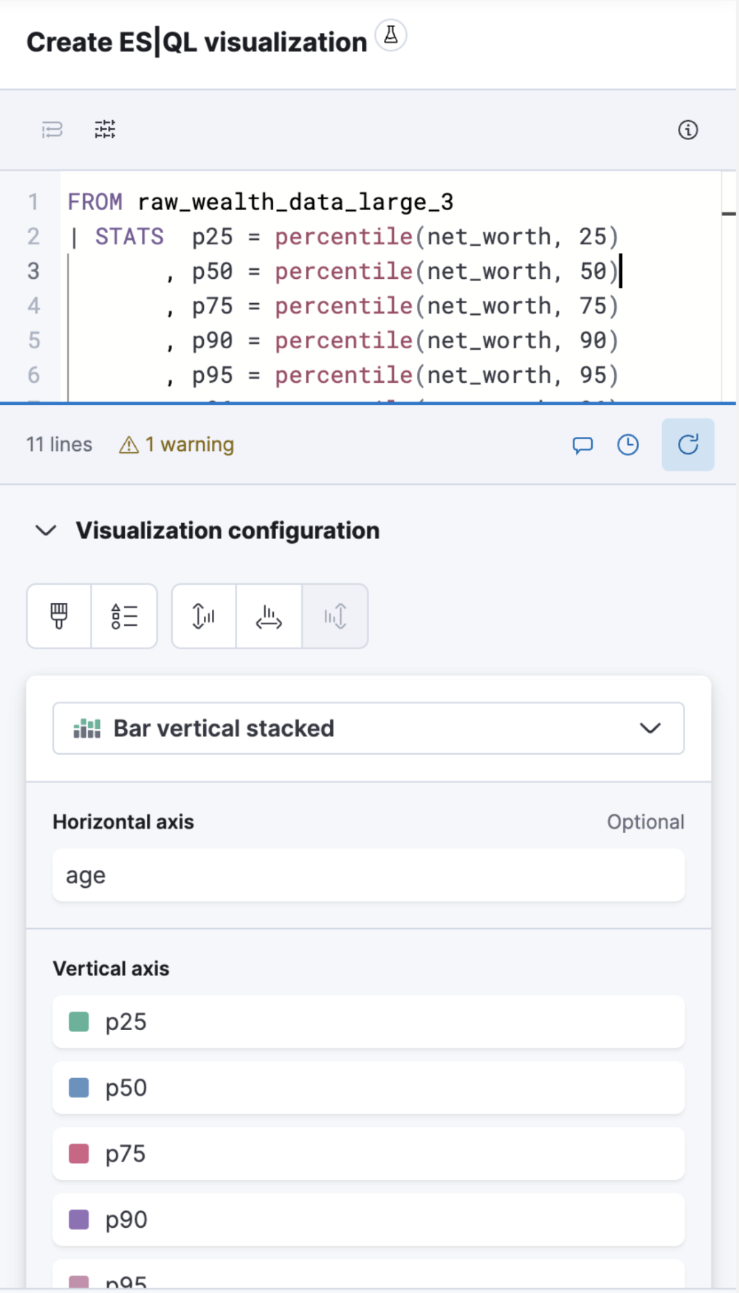

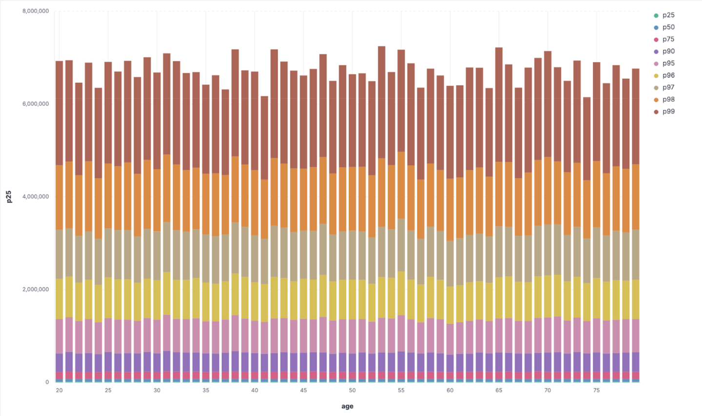

Another way to look at this is to augment the previous query and grouping by age to see if there is, (in our synthetic dataset), a relation between wealth and age:
      , p99 = percentile(net_worth, 99) by age
| keep p25, p25, p50, p75, p90, p95, p96, p97, p98, p99, age
This could be visualized in a Kibana dashboard. Simply:
  • Navigate to Dashboard
  • Add a new ES|QL visualization
  • Copy and paste our query
  • Move the age field to the horizontal axis in the visualization configuration
Which will output:
The above suggests that the data generator randomized wealth uniformly across the population age, there is no specific trend pattern we can really see.

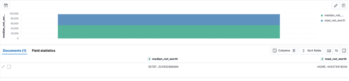

Median Absolute Deviation (MAD)
We calculate the median absolute deviation (MAD) to measure the variability of net worth in a robust manner, less influenced by outliers.
| stats median_net_worth = MEDIAN(net_worth), mad_net_worth = MEDIAN_ABSOLUTE_DEVIATION(net_worth)
| keep median_net_worth, mad_net_worth
With a median net worth of 53,787.22andaMADof53,787.22 and a MAD of 44,205.44, we can infer the typical range of Net Worth: Most individuals’ net worth falls within a range of 44,205.44aboveandbelowthemedian.Thisgivesatypicalrangeofapproximately44,205.44 above and below the median. This gives a typical range of approximately 9,581.78 to $97,992.66.

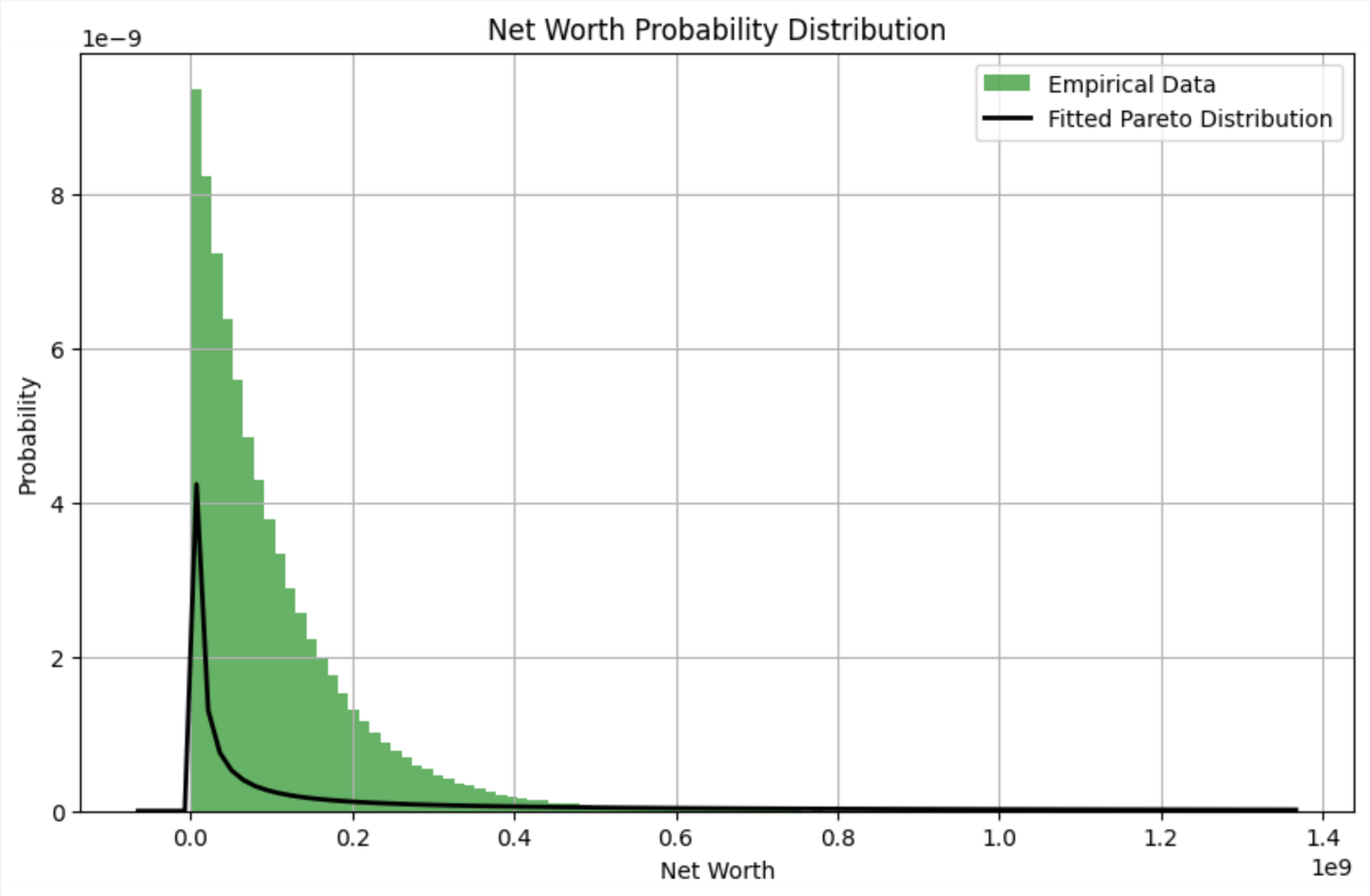

Fit Pareto distribution
Next, we fit our data to a Pareto distribution, which is often used to model wealth distribution because it reflects the reality that a small percentage of the population controls most of the wealth. By fitting our data to this distribution, we can more accurately represent the probabilities of different net worth levels.
from scipy.stats import pareto
# Fit a Pareto distribution to the data
shape, loc, scale = pareto.fit(all_data_df['net_worth'], floc=0)
# Calculate the probability density for each net worth
all_data_df['net_worth_probability'] = pareto.pdf(all_data_df['net_worth'], shape, loc=loc, scale=scale)
# Normalize the probabilities to sum to 1
all_data_df['net_worth_probability'] /= all_data_df['net_worth_probability'].sum()
print("Data with Net Worth Probability:")
print(all_data_df.head())
We can visualize the pareto distribution with the code below: ``

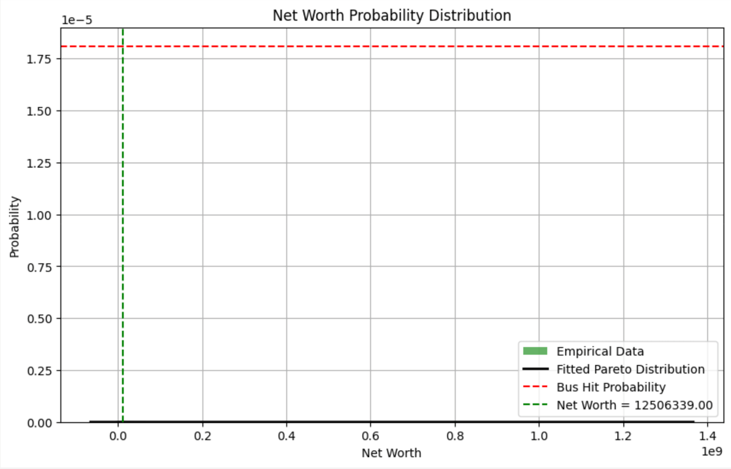

Breaking point
Finally, with the calculated probability, we determine the target net worth corresponding to the bus hit probability and visualize it. Remember, we use the magic number ChatGPT gave us for the probability of getting hit by a bus:
# Find the Net Worth Corresponding to the Bus Hit Probability
target_probability = 0.0000181
cumulative_probability = all_data_df['net_worth_probability'].cumsum()
target_net_worth_df = all_data_df[cumulative_probability >= target_probability].head(1)
target_net_worth = target_net_worth_df['net_worth'].iloc[0]
print(f"Net Worth with Probability >= {target_probability}: {target_net_worth}")
# Plot the Net Worth Probability Distribution
plt.figure(figsize=(10, 6))
plt.hist(all_data_df['net_worth'], bins=100, density=True, alpha=0.6, color='g', label='Empirical Data')
xmin, xmax = plt.xlim()
x = np.linspace(xmin, xmax, 100)
p = pareto.pdf(x, shape, loc=loc, scale=scale)
plt.plot(x, p, 'k', linewidth=2, label='Fitted Pareto Distribution')
plt.axhline(y=target_probability, color='r', linestyle='--', label='Bus Hit Probability')
plt.axvline(x=target_net_worth, color='g', linestyle='--', label=f'Net Worth = {target_net_worth:.2f}')
plt.xlabel('Net Worth')
plt.ylabel('Probability')
plt.title('Net Worth Probability Distribution')
plt.legend()
plt.grid(True)
plt.show()
Conclusion

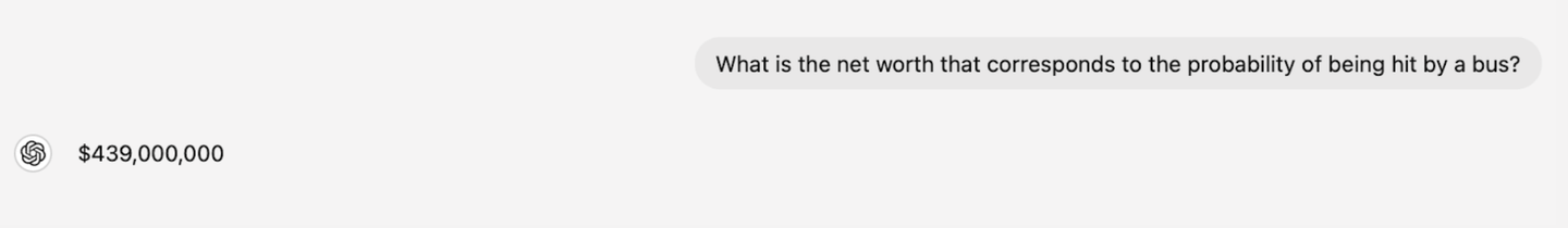

Based on our synthetic dataset, this chart vividly illustrates that the probability of amassing a net worth of approximately $12.5 million is as rare as the chance of being hit by a bus. For the fun of it, let’s ask ChatGPT what the probability is:
Okay… $439 million? I think ChatGPT might be hallucinating again.
