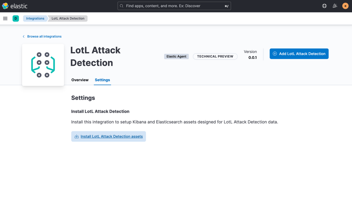

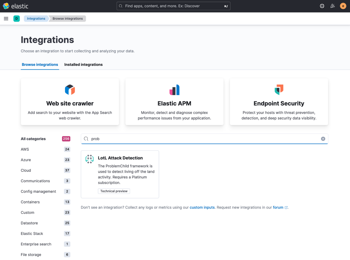

Step 1: Installing the package assets
In Kibana, the Integrations app now includes the LotL Attack Detection package. To install the assets, click the Install LotL Attack Detection assets button under the Settings tab.
This will install all of the artifacts necessary to use the ProblemChild model to generate alerts when LotL activity is detected in your environment.
To install the assets, click the `Install LotL Attack Detection assets` button under the `Settings` tab.

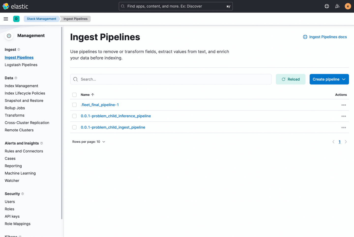

Once installation is complete, you can navigate to Stack Management > Ingest Pipelines and see that the <version-number>-problem\_child\_ingest\_pipeline has been installed and can now be used to enrich incoming ingest data. The ingest pipeline leverages the <version-number>-problem\_child\_inference\_pipeline in order to do this.
Once installation is complete, you can navigate to Stack Management > Ingest Pipelines and see that the `<version-number>-problem_child_ingest_pipeline` has been installed and can now be used to enrich incoming ingest data.

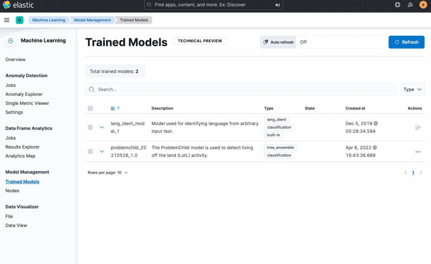

Similarly, the installed ProblemChild model can now be seen in Machine Learning > Model Management > Trained Models

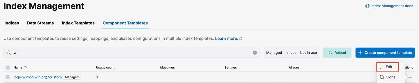

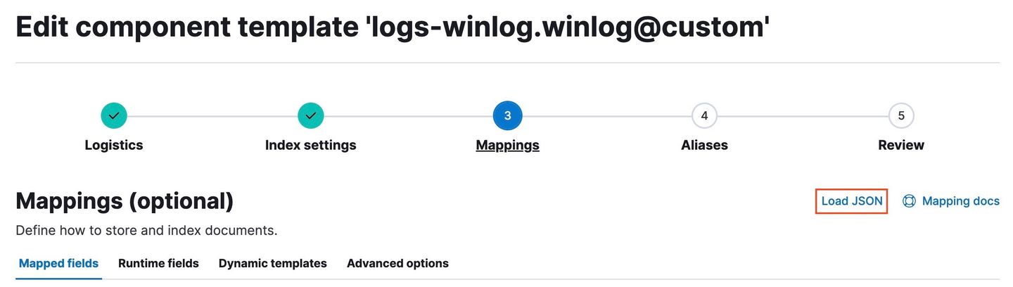

You will also want to add the following mappings to the Elastic beat you chose:
  "properties": {
    "problemchild": {
      "properties": {
        "prediction": {
          "type": "long"
        "prediction_probability": {
          "type": "float"
    "blocklist_label": {
      "type": "long"
You can do this under Stack Management > Index Management > Component Templates. Templates that can be edited to add custom components will be marked with a @custom suffix. Edit the @custom component template for your Elastic beat by pasting the above JSON blob in the Load JSON flyout.

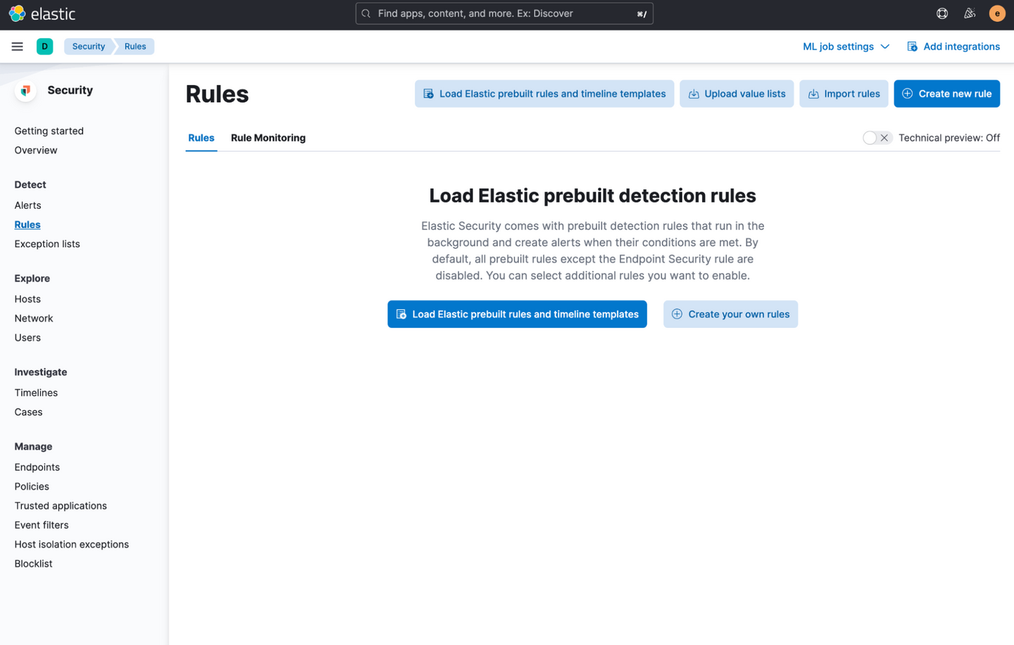

Step 4: Enabling the rules
To maximize the benefit of the ProblemChild framework, activate the installed detection rules. They are triggered when certain conditions for the supervised model or anomaly detection jobs are satisfied. The complete list of the installed rules can be found in the Overview page of the package itself or in the latest experimental detections release.
In order to enable and use the installed rules, you can navigate to Security > Rules and select _Load Elastic prebuild rules and timeline templates_.
In order to enable and use the installed rules, you can navigate to Security > Rules and select `Load Elastic prebuild rules and timeline templates`.

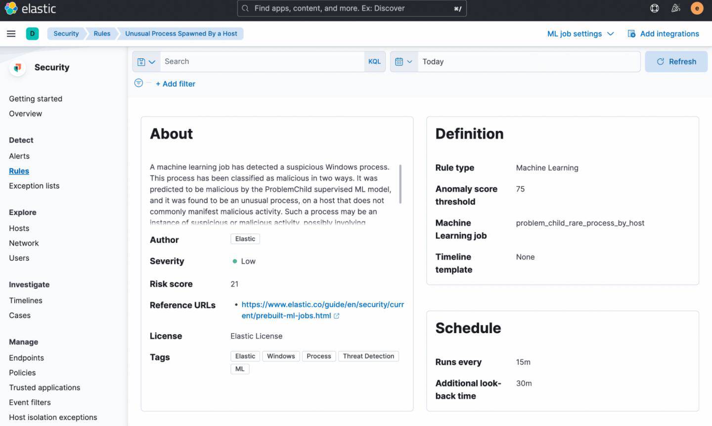

The ML job rules are triggered by anomalies found by the anomaly detection jobs that you set up in Step 3 — for example, this rule:
The above rule is triggered each time the anomaly detection job problem_child_rare_process_by_host detects an anomaly with an anomaly score greater than or equal to 75.
