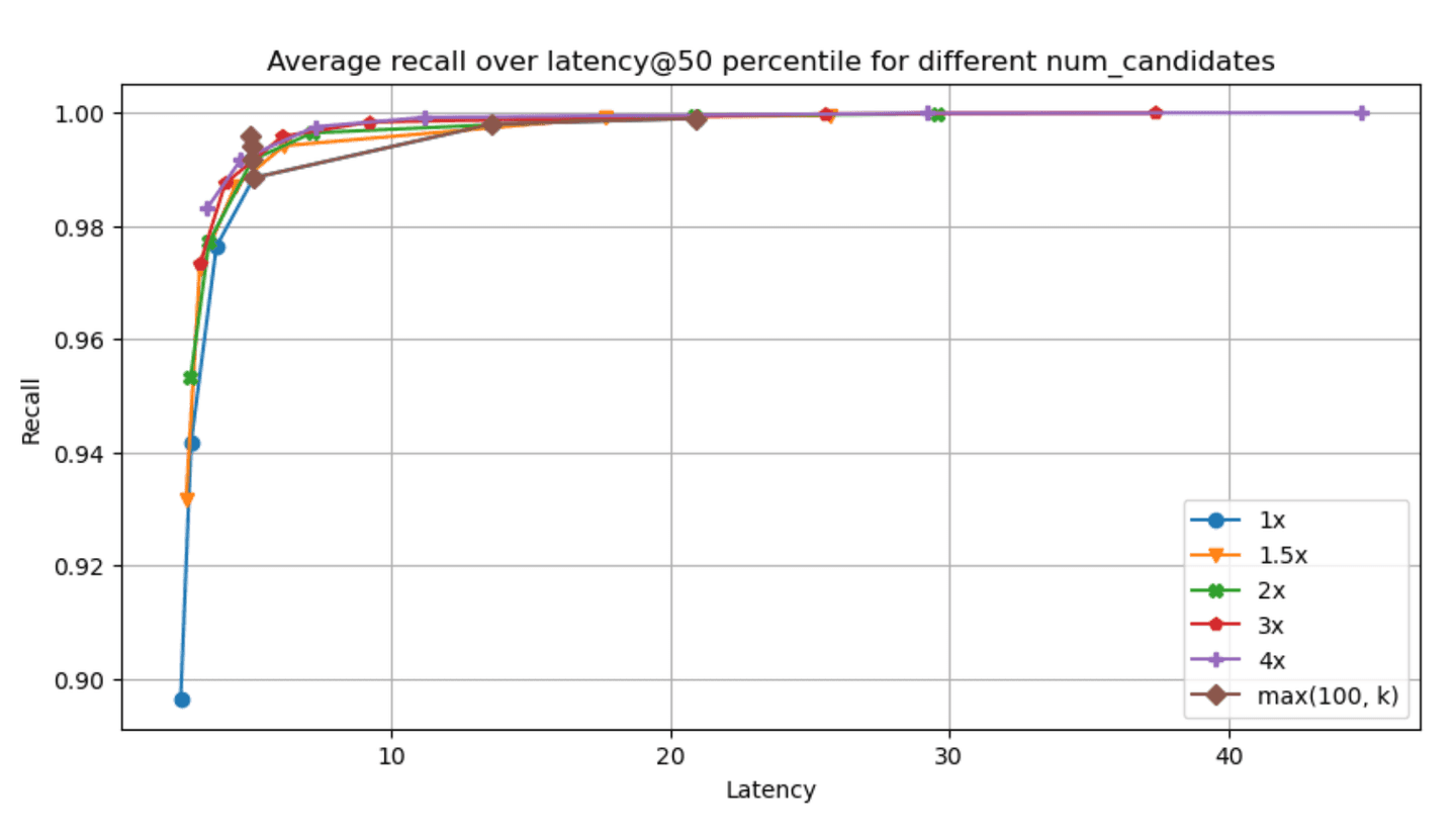

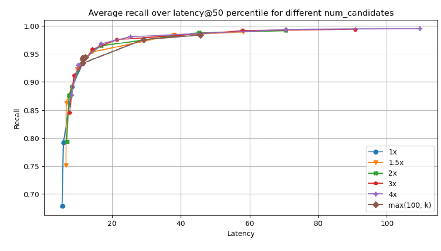

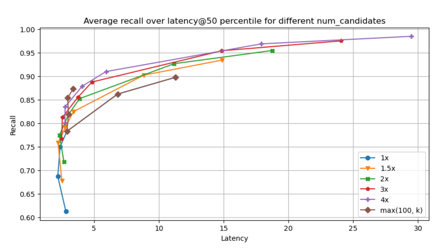

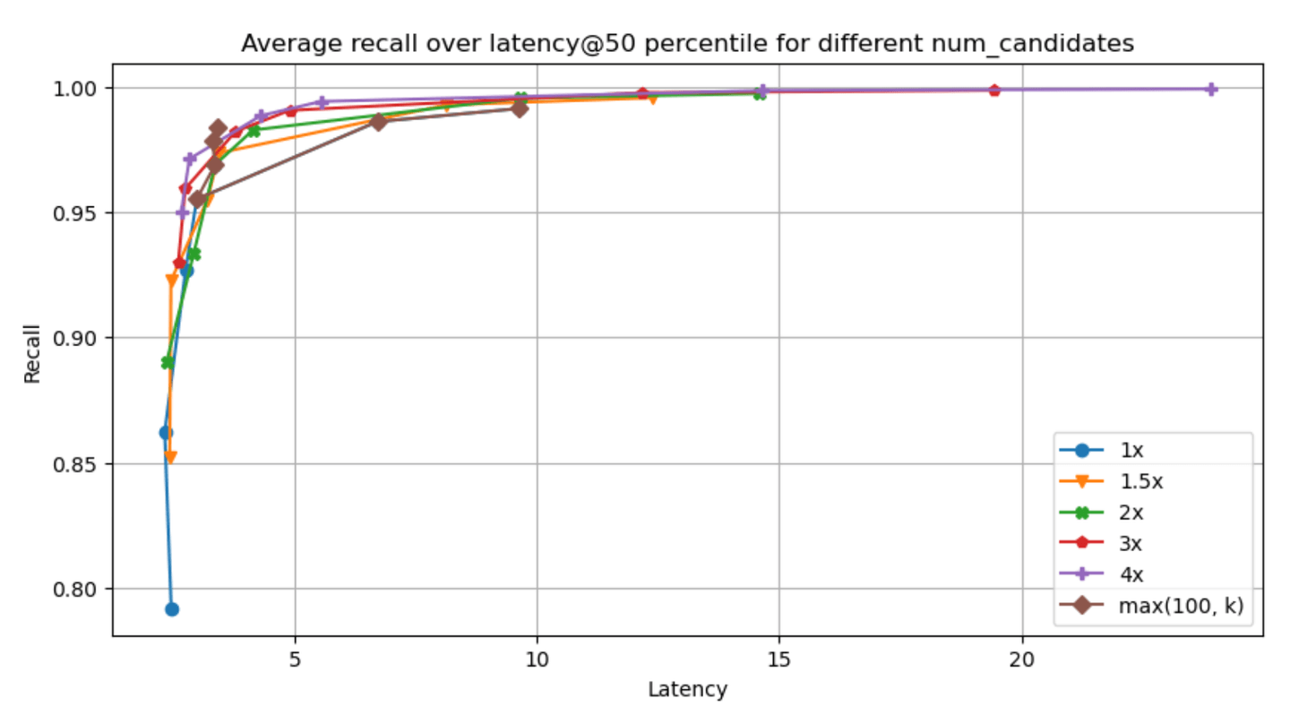

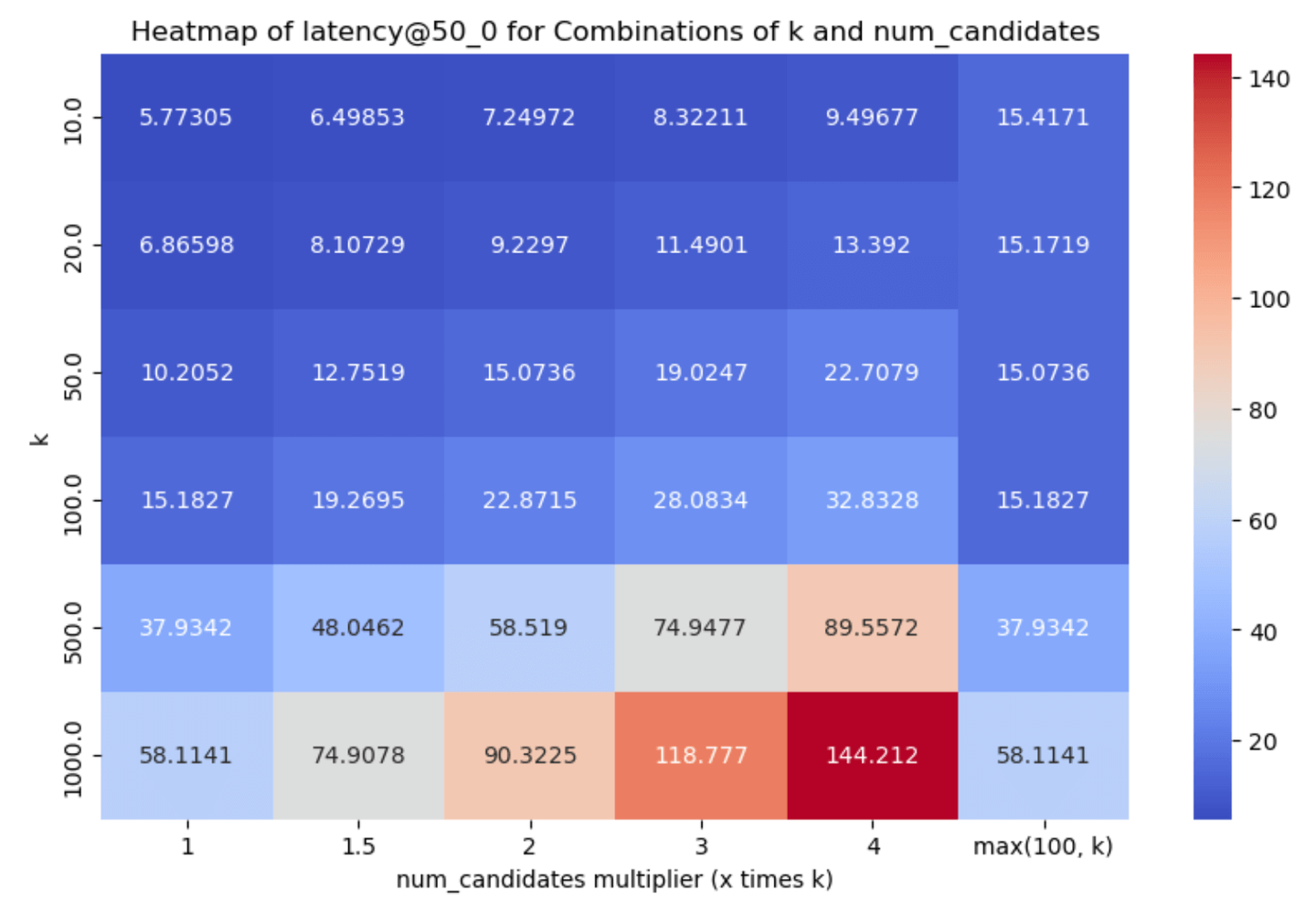

The recall - latency graphs for each of the specified datasets & param combinations can be found below (higher and to the left is better, latency is measured in ms):

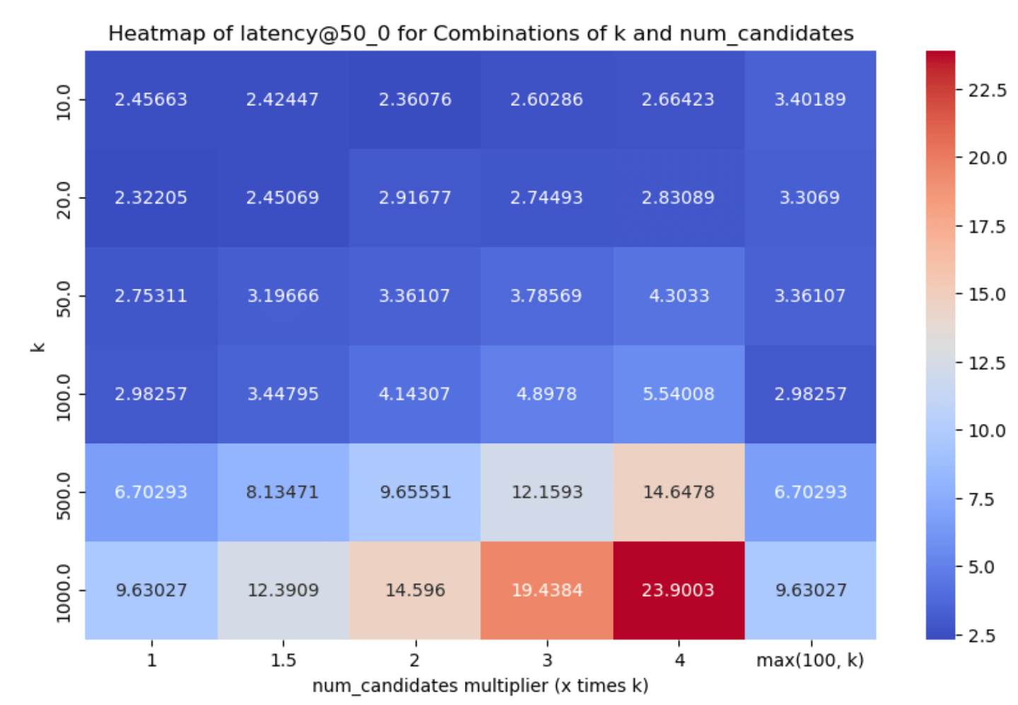

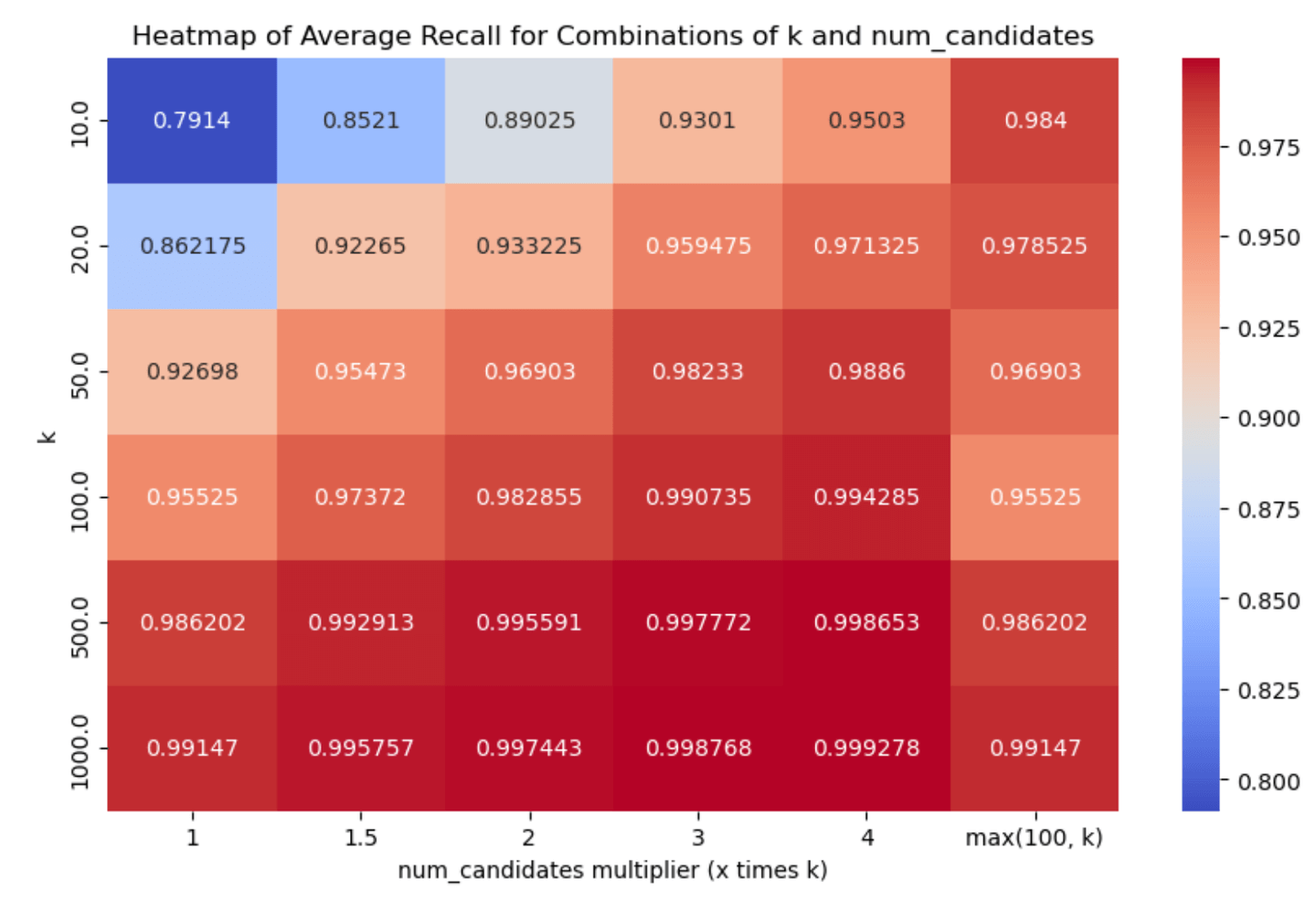

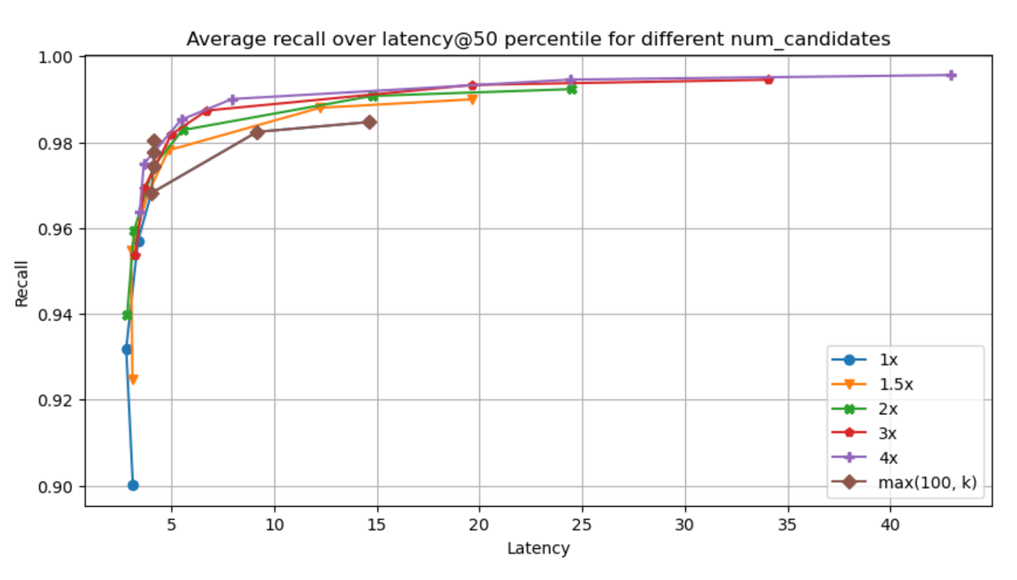

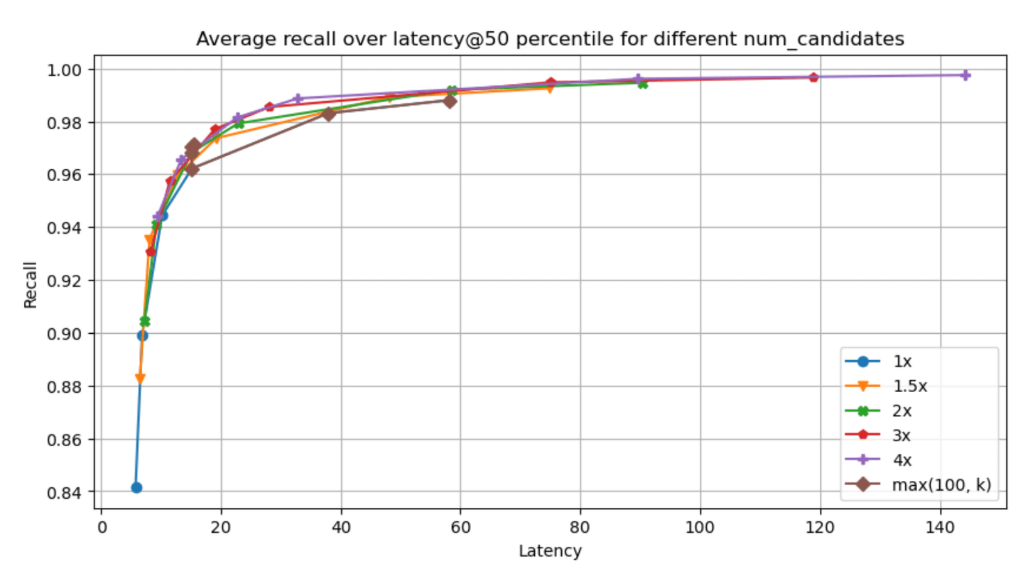

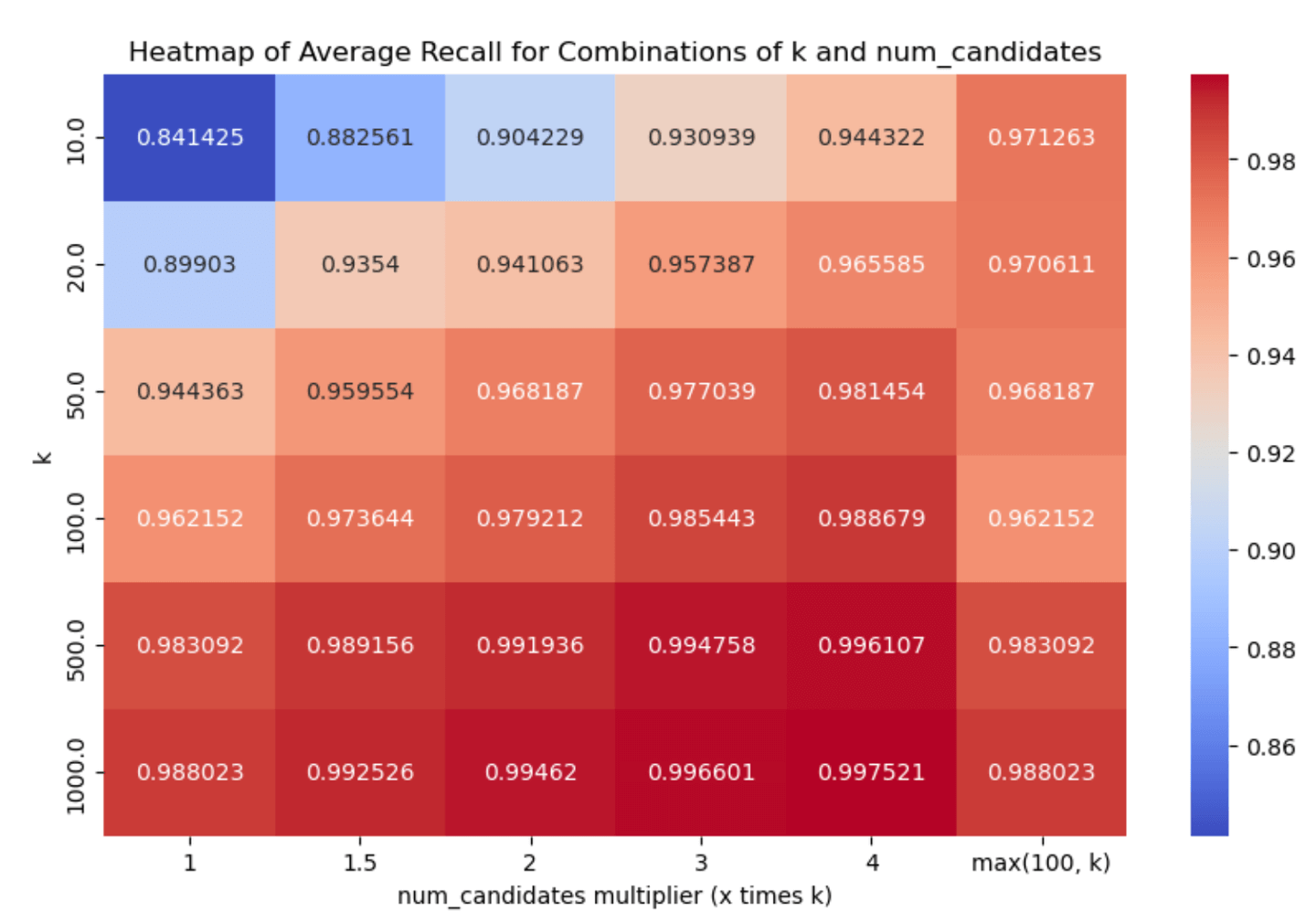

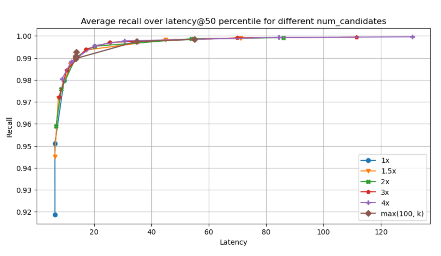

Narrowing down to the dense_vector and openai_vector tracks for the absolute values of latency@50th percentile and recall we have:
Dense Vector latency@50
Dense Vector recall
OpenAI latency@50
OpenAI Recall

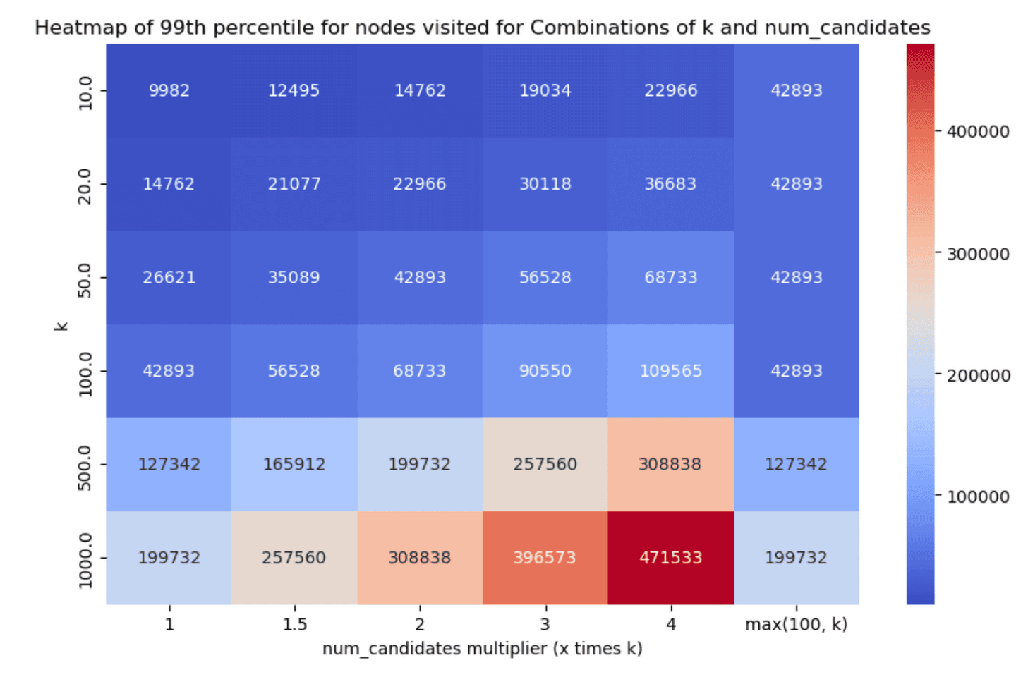

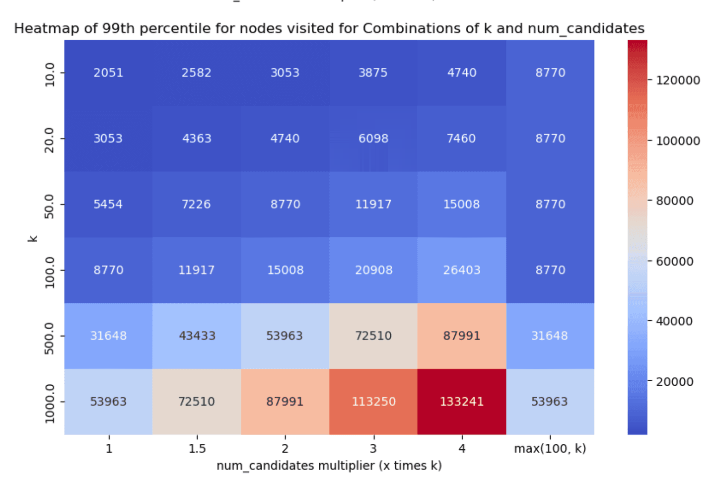

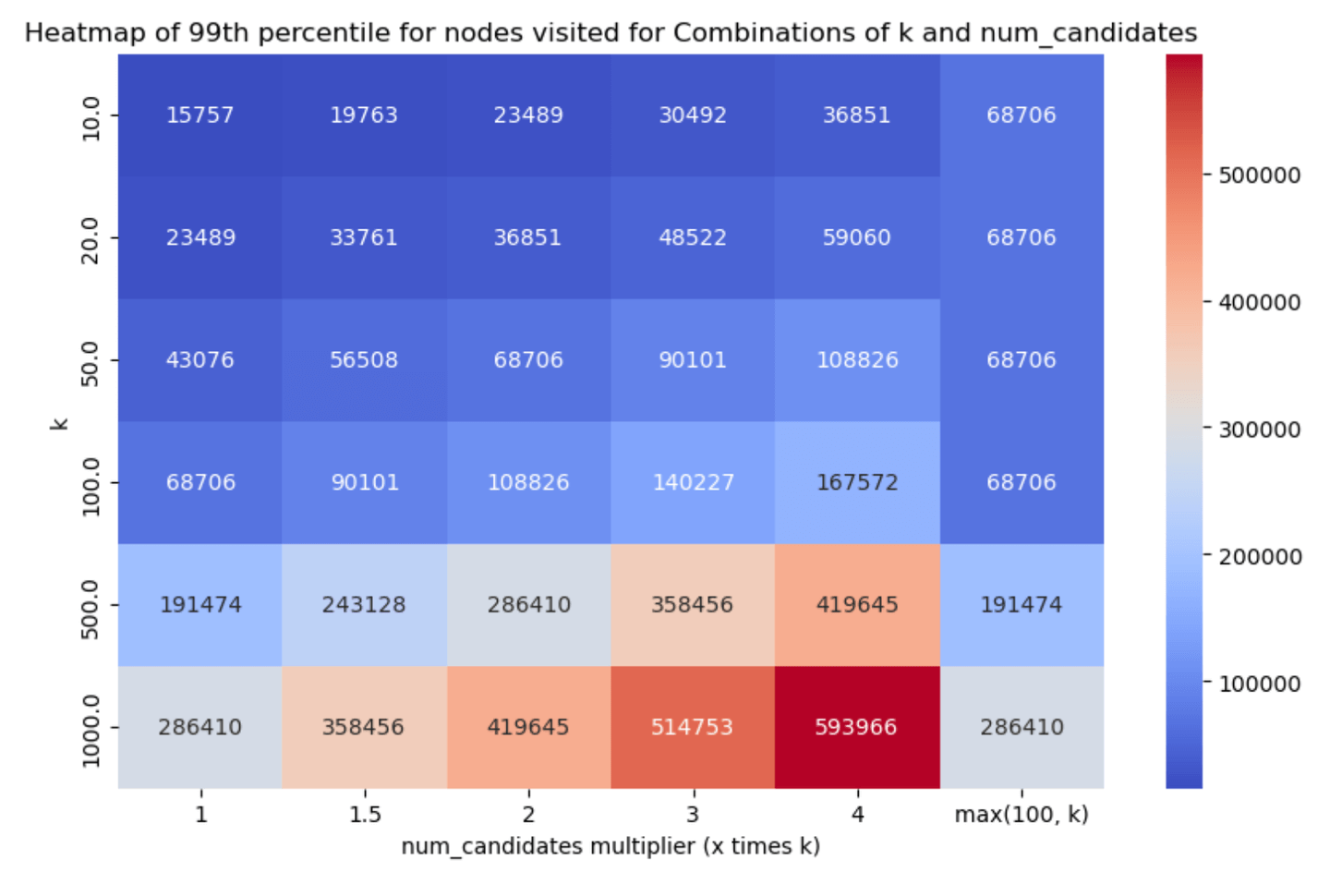

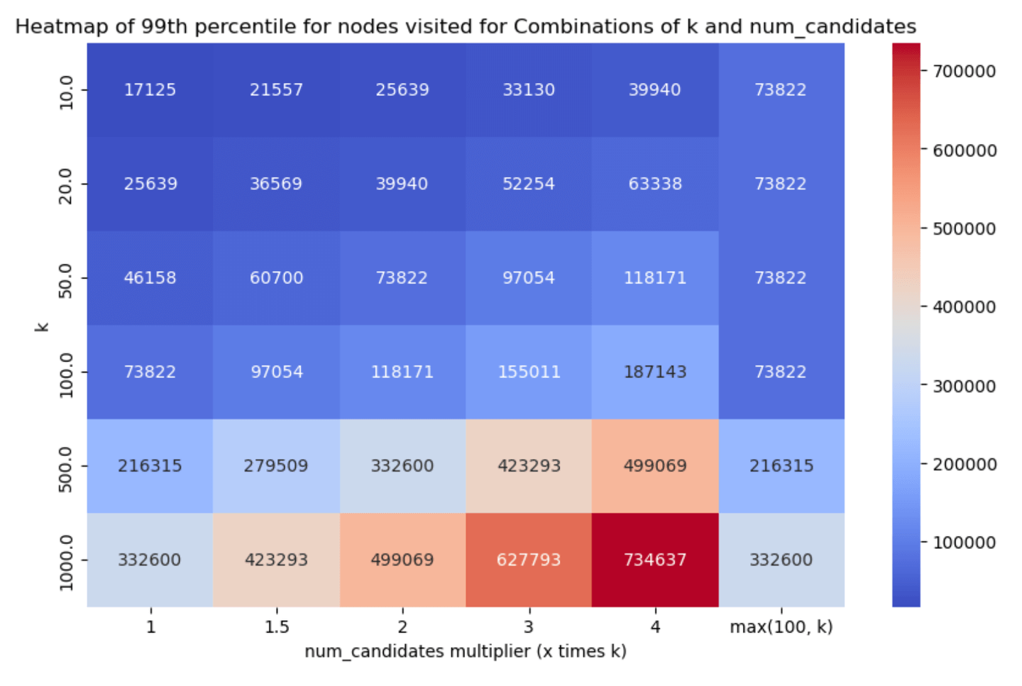

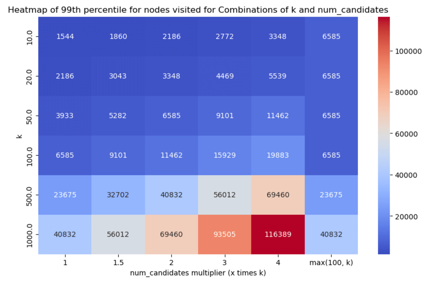

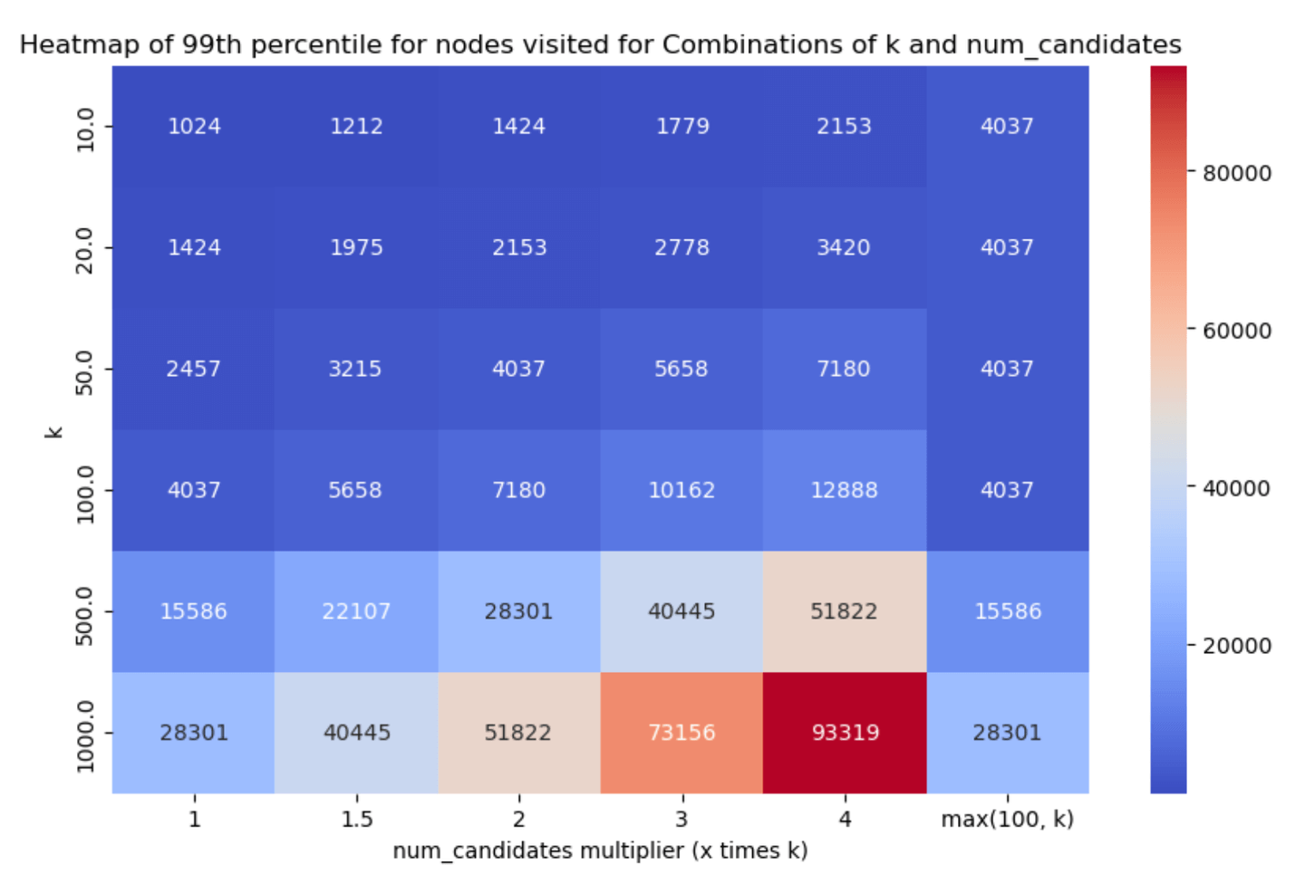

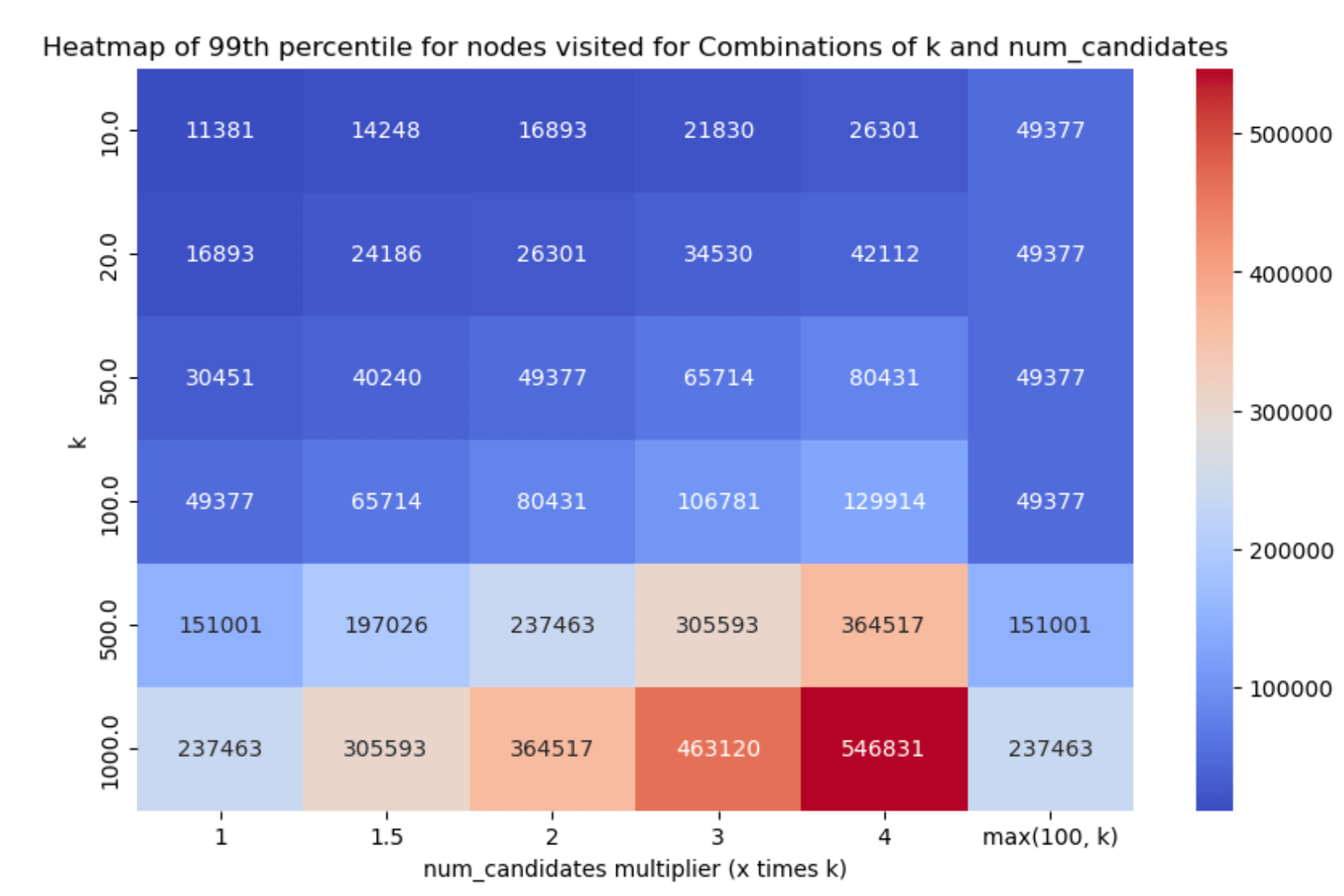

Similarly, the 99th percentile of the HNSW graph nodes visited for each scenario can be found below (smaller is better):

Taking a look at the results, two things stand out:
  • Having one vs many segments clearly affects recall & latency metrics in an inversely proportional manner. Having less segments decreases latency (as we have fewer graphs to traverse, i.e. searches to run) which is great, but it also affects recall in the opposite manner, as it is quite possible that some good candidates will be left out (due to a fewer num_candidates lists).
  • Even with little exploration we can achieve good enough recall in almost all cases, which is great!
We're constantly aiming at improving multi-segment search (a great example can be found in this post) so we expect that this tradeoff will be less of an issue going forward (the numbers reported here do not include these improvements).
Taking all things into account, the two main options we discussed were the following:
  • num_candidates = 1.5 * k - this achieves good enough recall in almost all cases, with very good latency scores.
  • num_candidates = Math.max(100, k) - this achieves slightly better recall especially for lower k values, with the tradeoff though of increased graph exploration and latency.
After careful consideration and (lengthy!) discussions, we opted to go with the former as the default, i.e. set num_candidates = 1.5 * k. We had to do far less exploration and recall was greater than 90% in almost all the cases we tested (with some significantly higher reported numbers as well), which should yield a good enough onboarding experience.
