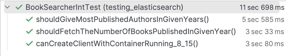

It's also worth noting that in the demo project (branch data-init), which currently has only three integration tests, roughly half of the total duration is spent on container startup. After the initial warm-up, individual tests take about 3 seconds each. Consequently, adding three more tests won't double the overall time to another 30 seconds, but will only increase it by roughly 9-10 seconds. The test execution times, including data initialization, can be observed in the IDE:
Tests execution time reported by IDE
