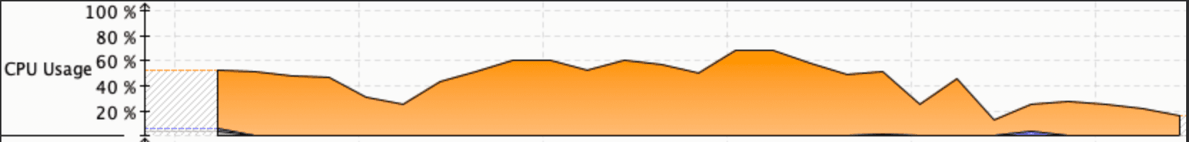

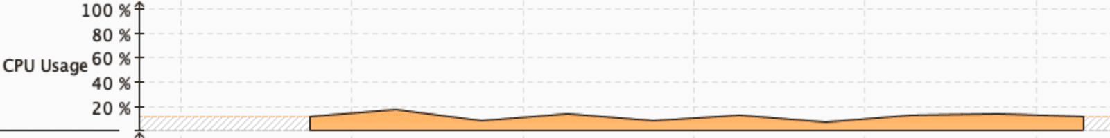

Let's assume, for simplicity, that the number of test cases in our example has doubled (rather than writing additional tests, we will copy the existing ones for this demo).
In the simplest approach, we could add three more @Test methods to the BookSearcherIntTest class. We can then observe CPU and memory consumption by using, in a somewhat unorthodox way, one of Java's profilers: Java Flight Recorder. Since we added it to our POM, after running the tests, we can open recording-1.jfr in the main directory. The results may look like this in Environment -> Processes:
As you can see, running six tests in a single class doubled the time required. Additionally, the predominant color in the CPU usage chart above is... no color at all, as CPU utilization barely reaches 20% during peak moments. Underutilizing your CPU is wasteful when you’re paying for usage time (whether to cloud providers or in terms of your own wall clock time to get meaningful feedback).
Chances are, the CPU you’re using has more than one core. The optimization here is to split the workload into two parts, which should roughly halve the duration. To achieve this, we move the newly added tests into another class called BookSearcherAnotherIntTest and instruct Maven to run two forks for testing using -DforkCount=2. The full command becomes:
./mvnw test '-Dtest=*IntTest*' -DforkCount=2
With this change, and using JFR and Java Mission Control, we observe the following:
Here, the CPU is utilized much more effectively.
