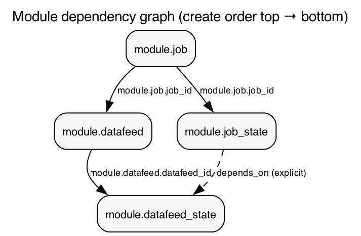

Wiring the modules together
module "job" {
  source = "./modules/job"
  job_id = var.job_id
module "datafeed" {
  source      = "./modules/datafeed"
  datafeed_id = var.datafeed_id
  job_id      = module.job.job_id
  indices     = var.indices
module "job_state" {
  source = "./modules/job_state"
  state  = "closed"
module "datafeed_state" {
  source      = "./modules/datafeed_state"
  datafeed_id = module.datafeed.datafeed_id
  state       = "stopped"
  depends_on = [module.job_state]
The output references (module.job.job_id, module.datafeed.datafeed_id) create an implicit dependency graph: Terraform will always create the job before the datafeed, and the datafeed before its state resource. On destroy, the order is automatically reversed.
In the diagram below, solid arrows represent the implicit dependency graph created when one module’s outputs feed into another’s inputs. In contrast, the dotted arrow between job_state and datafeed_state denotes the explicit depends_on defined in the root main.tf.
The explicit depends_on on module.datafeed_state deserves explanation: There's no data flow between the datafeed state and job state modules, but the Elasticsearch API requires the job to be open before a datafeed can start. Without this dependency, Terraform would attempt both in parallel, which would fail.
We start with the job "closed" and the datafeed "stopped". We'll open and start them in later steps to demonstrate lifecycle management.
  state       = "started"    # was "stopped"
terraform apply
The datafeed is now running. Since we haven't specified start or end times, it will process all available data in its indices and will continue polling for new data in real time.
Cleaning up
When you're done, a single command tears everything down in the correct reverse order:
  • Datafeed state first.
  • Then job state.
  • Then datafeed.
  • Then job.
  • Then API key.
  • And then the deployment:
terraform destroy
Destroy complete! Resources: 6 destroyed.

Why does the Elasticsearch Terraform provider require an explicit depends_on between datafeed state and job state?
The Elasticsearch API requires a job to be open before its datafeed can start. Because there is no data flow between the two state modules, Terraform would otherwise attempt to start both in parallel and fail. The explicit depends_on = [module.job_state] in the root main.tf enforces the required sequencing.
