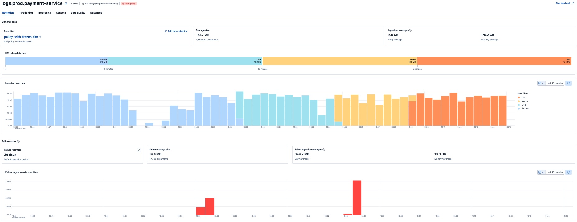

Retention management lives in the Retention tab of each stream. This is your control panel for understanding how much data you’re storing, how quickly it’s growing, and how your lifecycle policies are applied. It’s also where you can monitor and configure the Failure store, which tracks and retains documents that failed to be ingested.
Metrics at a glance
At the top of the view, you’ll find an overview of key metrics:
  • Storage size: the total data volume currently held by the stream.
  • Ingestion averages: calculated from the selected time range, Streams extrapolates both daily and monthly averages to give you a sense of long-term trends.
This combination of near-real-time and projected values helps you quickly spot when ingestion is ramping up and whether your retention policy aligns with it.
Ingestion over time
Below the metrics, a graph shows ingestion volume over time. This information is approximated based on the number of documents over time, multiplied by the average document size in the backing index.
Visualizing lifecycle phases
When an ILM policy is effective, the retention view becomes more visual. Streams displays a phase breakdown (hot, warm, cold, frozen) showing the data volume stored in each phase. This gives you a clear sense of how your data is distributed across the storage tiers and whether your lifecycle is doing what you expect.

A failure store is a secondary set of indices inside a data stream, dedicated to storing documents that failed to be ingested. Within the Retention tab, you can toggle the Failure store on or off, and configure its own retention period. We’ll cover Failure store and Data quality in more detail in this article.

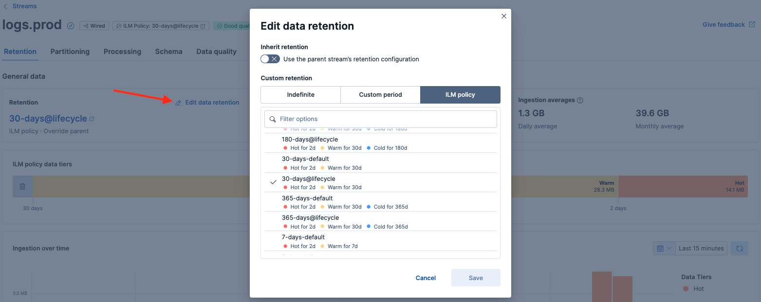

Switching between DSL and ILM
You can freely switch a stream between DSL and ILM management, or update a DSL retention with just a few clicks. Streams takes care of updating the lifecycle settings at the data stream level, ensuring consistent retention across all existing backing indices, not just new ones.
Whether you prefer the simplicity of DSL or the fine-grained tiering of ILM, you can move between the two seamlessly.

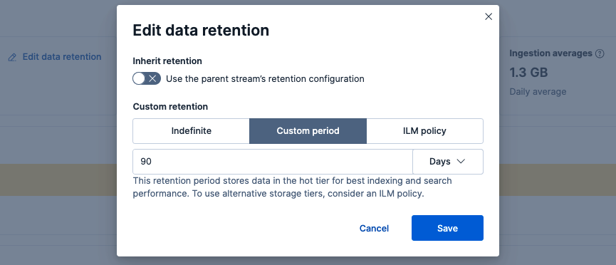

Clicking “Edit data retention” opens a modal that allows you to update the stream’s configuration. From there you can update the ILM policy or set a custom retention period via DSL.
You can set a custom period, or pick an Indefinite retention for your data.

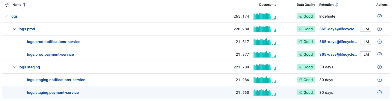

Wired streams live in a tree structure, and that hierarchy allows an inheritance model.
A child stream can inherit the lifecycle of its nearest ancestor that has a concrete policy (ILM or DSL). This keeps your configuration lean and consistent since you can set a single lifecycle at a higher level in the tree and let Streams automatically apply it to all relevant descendants.
If that ancestor’s lifecycle is later updated, Streams cascades the change down to all children that inherit it, so everything stays in sync.
In the figure below, we set a different retention for logs.prod and logs.staging environments. The child partitions of these environments automatically inherit the configuration.
