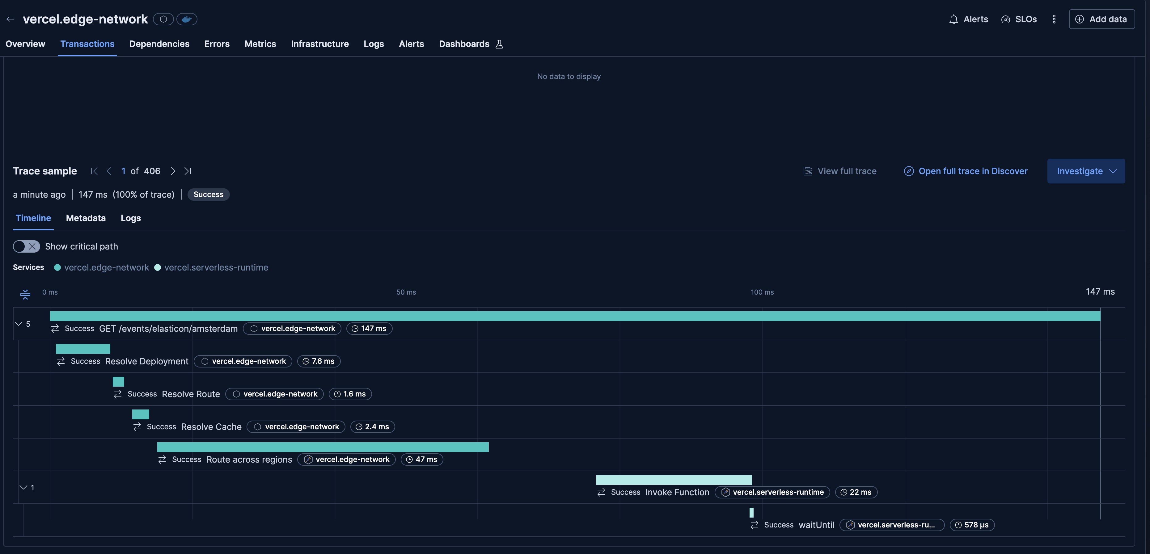

Traces are where the integration gets genuinely powerful for debugging. When you configure a Trace Drain, Vercel automatically instruments infrastructure spans and outbound HTTP fetch calls. You can add the @vercel/otel package for framework and custom spans. These traces surface in Kibana's Service Inventory: trace waterfalls, service maps, and the ability to jump directly from a trace to the related log lines. A Pro or Enterprise plan is required for traces. Traces use a separate endpoint from the other signals; they go to /v1/traces on the Managed OTLP endpoint.

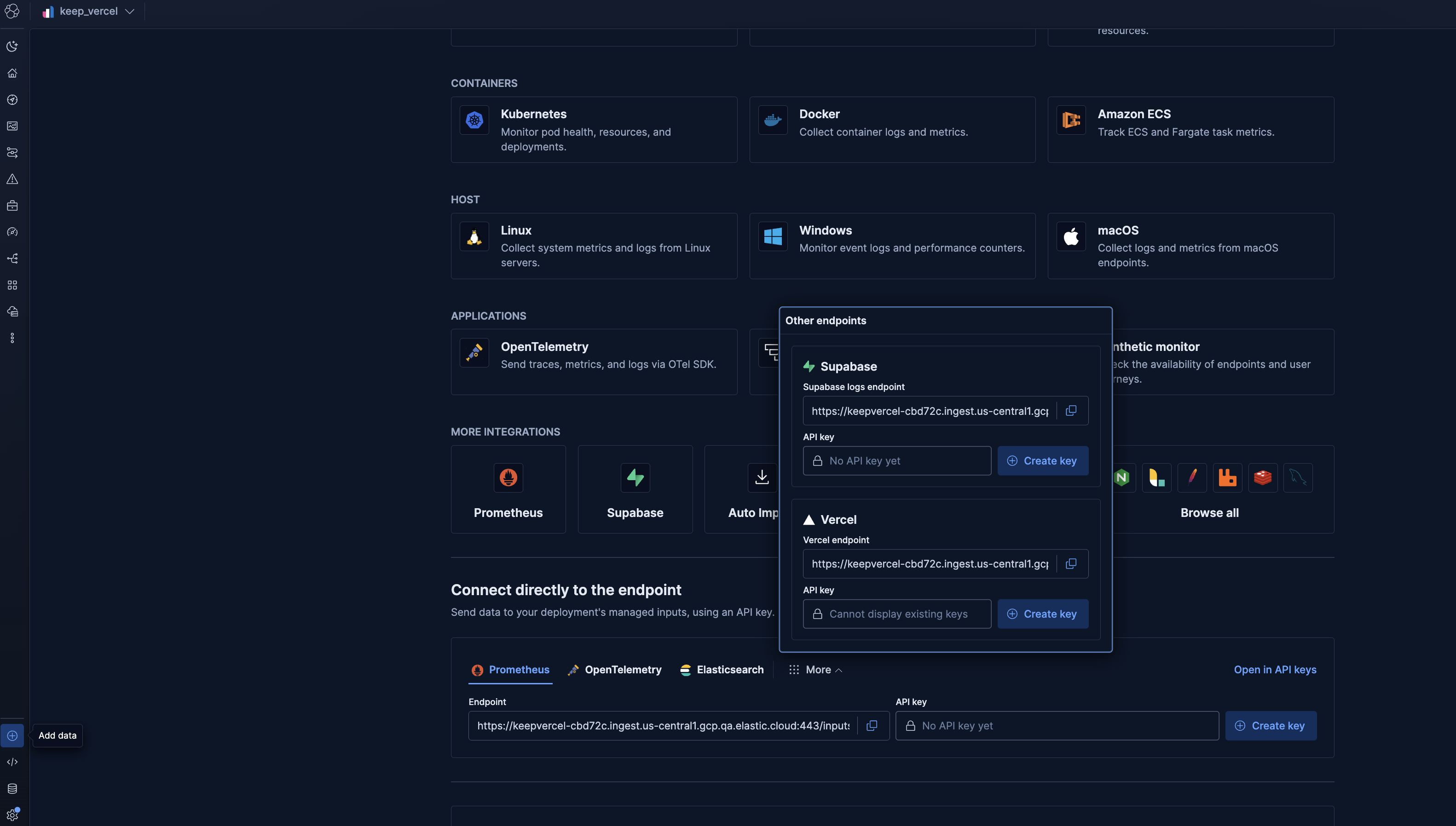

In Elastic Cloud, go to Add data → Connect directly to the endpoint. You'll see the Vercel endpoint listed alongside an option to create an API key. Grab both before heading to Vercel.
The Vercel endpoint URL and API key are both available here; everything you need before touching Vercel's settings.

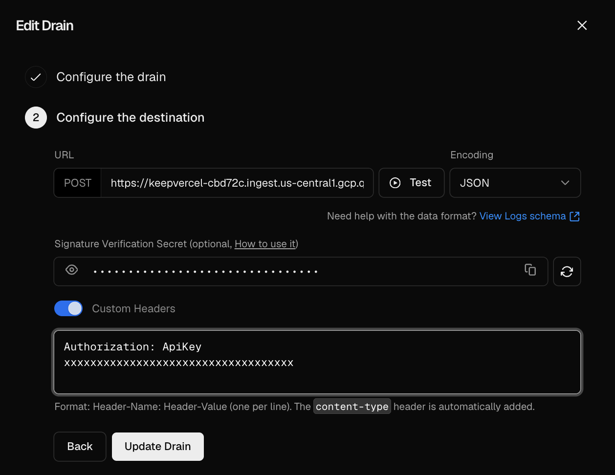

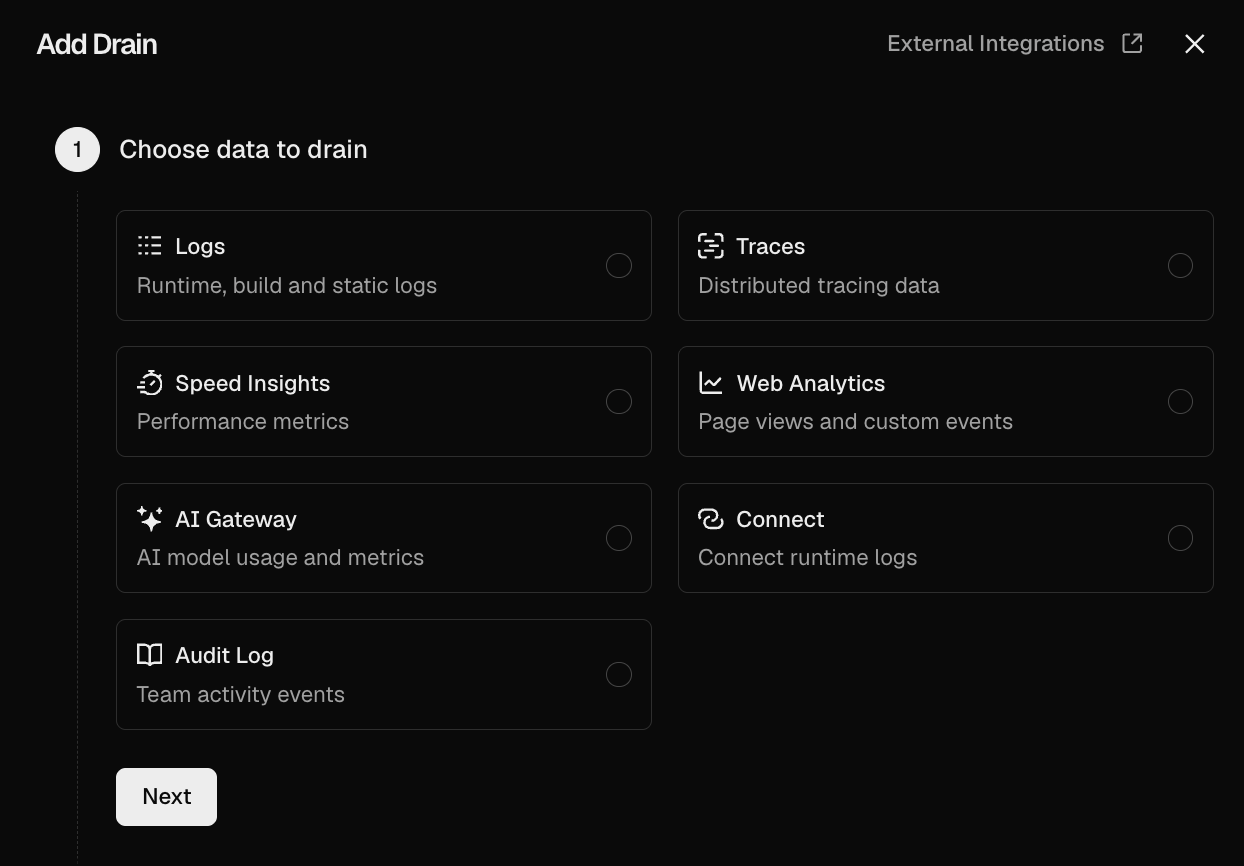

Over in Vercel, open your team settings and go to Drains → Add Drain. Pick the signal type you want to collect, hit Next, paste in the Elastic endpoint URL, and add one custom header:
Authorization: ApiKey <your-key>
Vercel lets you drain Logs, Traces, Speed Insights, Web Analytics, Audit Logs and more, with each as a separate drain. Logs, Speed Insights, Web Analytics, and Audit Logs share the Vercel endpoint, while Traces use the Managed OTLP traces URL.
The destination URL and Authorization header are all it takes – Elastic handles everything from here.

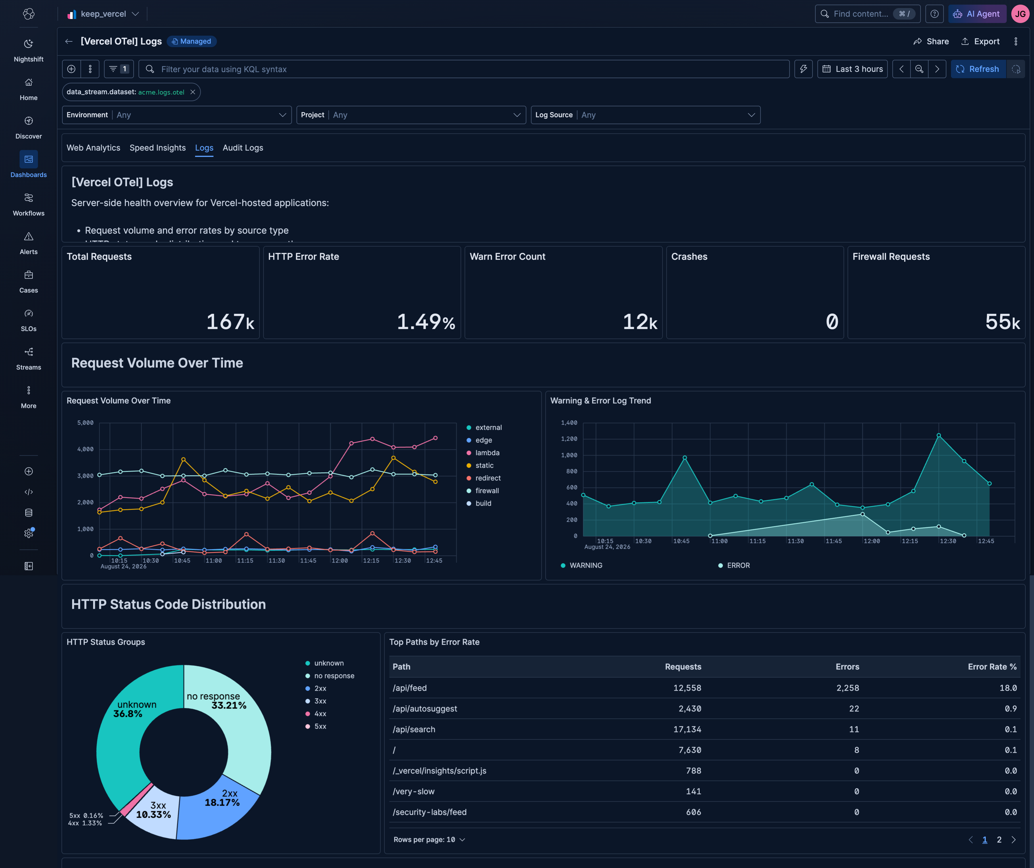

Once data is flowing, all the assets (dashboards, alert and SLO templates) install automatically. But the real value isn't in isolation, it's having everything in the same place when something goes wrong.
Dashboards

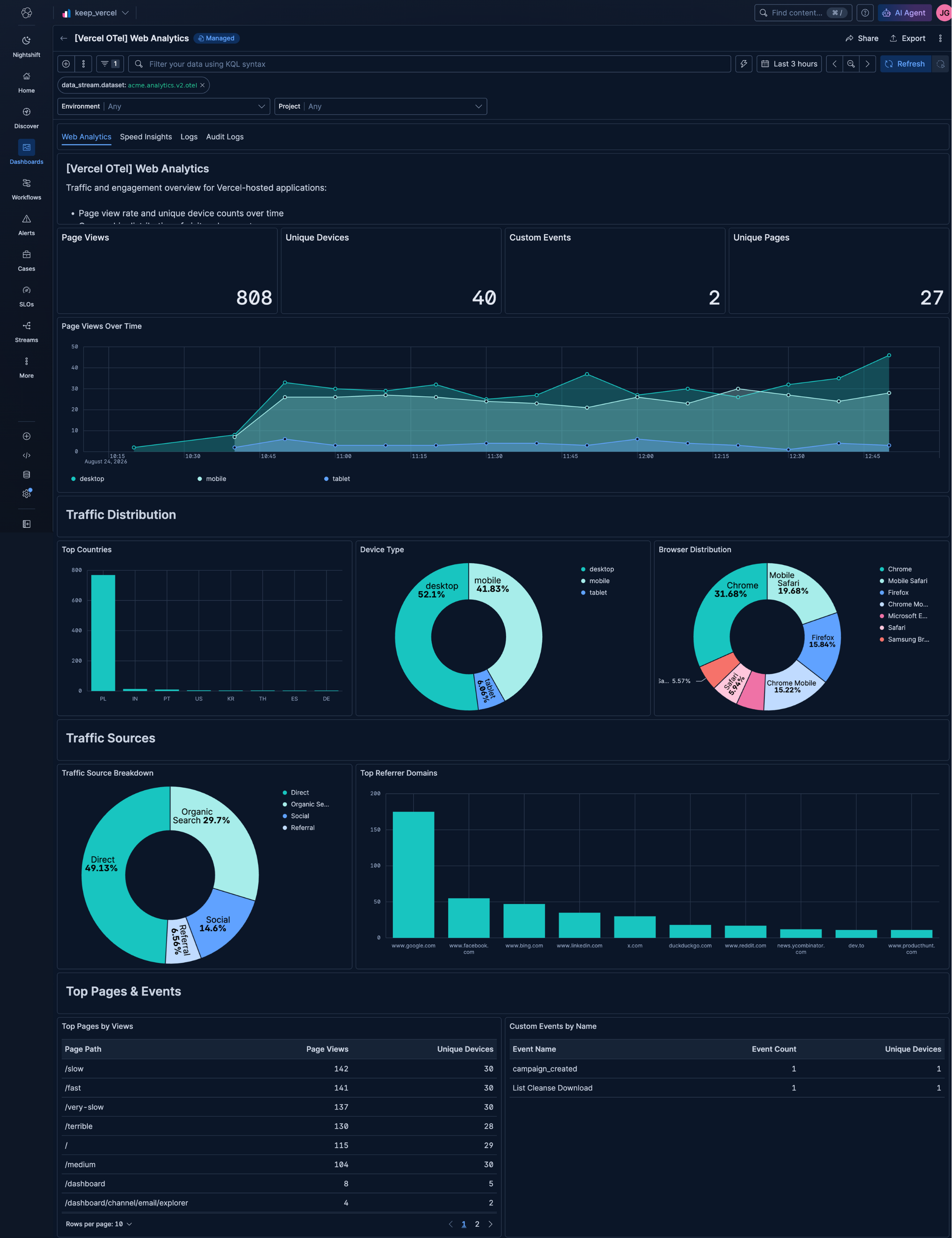

The Logs dashboard is where most investigations start: request volume, error rates, HTTP status distribution, top routes, and regional breakdowns. If errors are concentrated in a single region or a specific route, you can spot it right away.

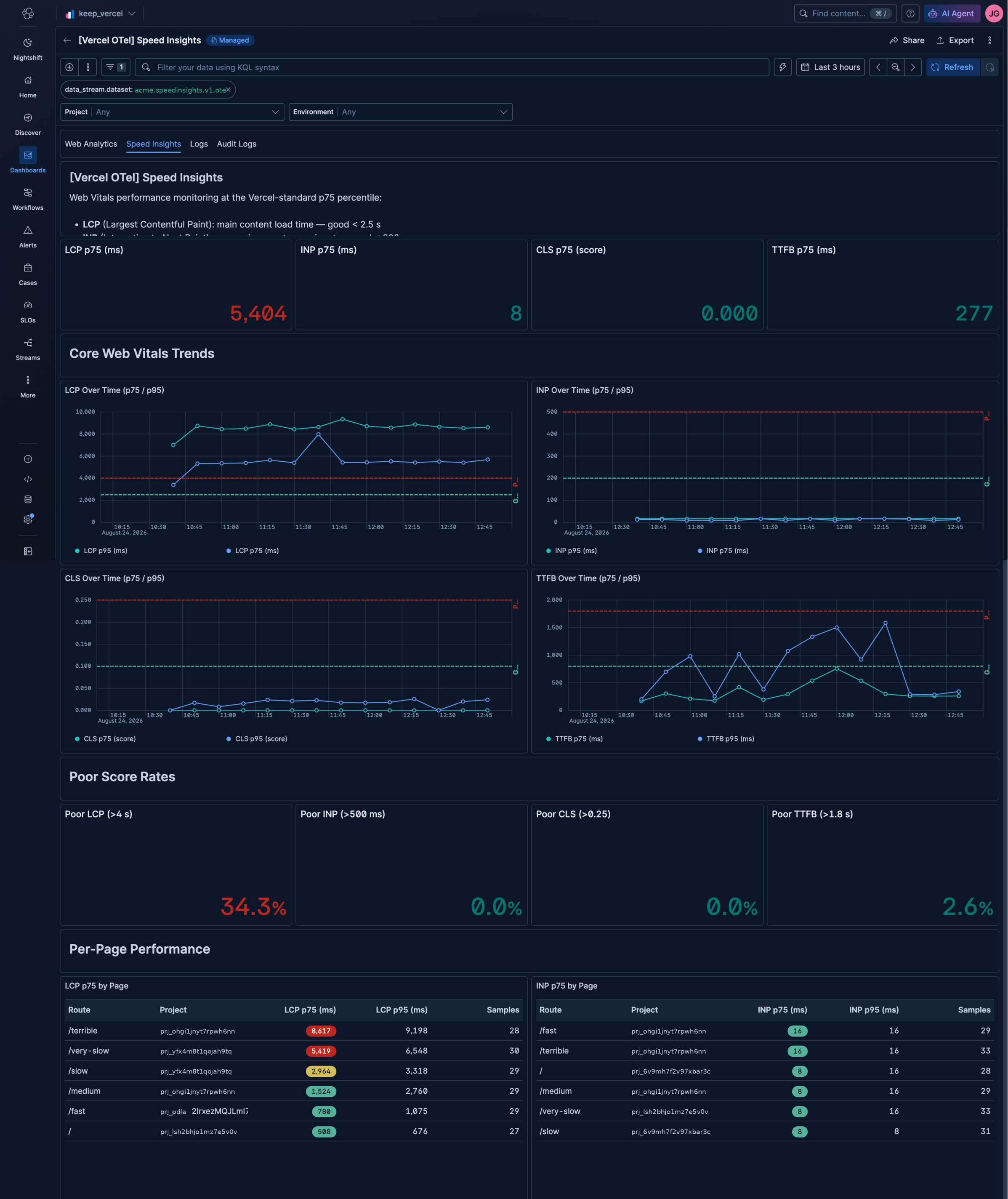

The Speed Insights dashboard shows Core Web Vitals at p75, over time and per page, using the same "good / needs improvement / poor" thresholds Vercel uses. When a deployment ships and LCP starts drifting, this is where you'll see it first.
The Web Analytics dashboard covers the client-side traffic story: page views, geography, devices, top pages, and custom events. It is useful on its own, but especially alongside the Logs dashboard when you're trying to understand whether a server-side problem is actually reaching users.

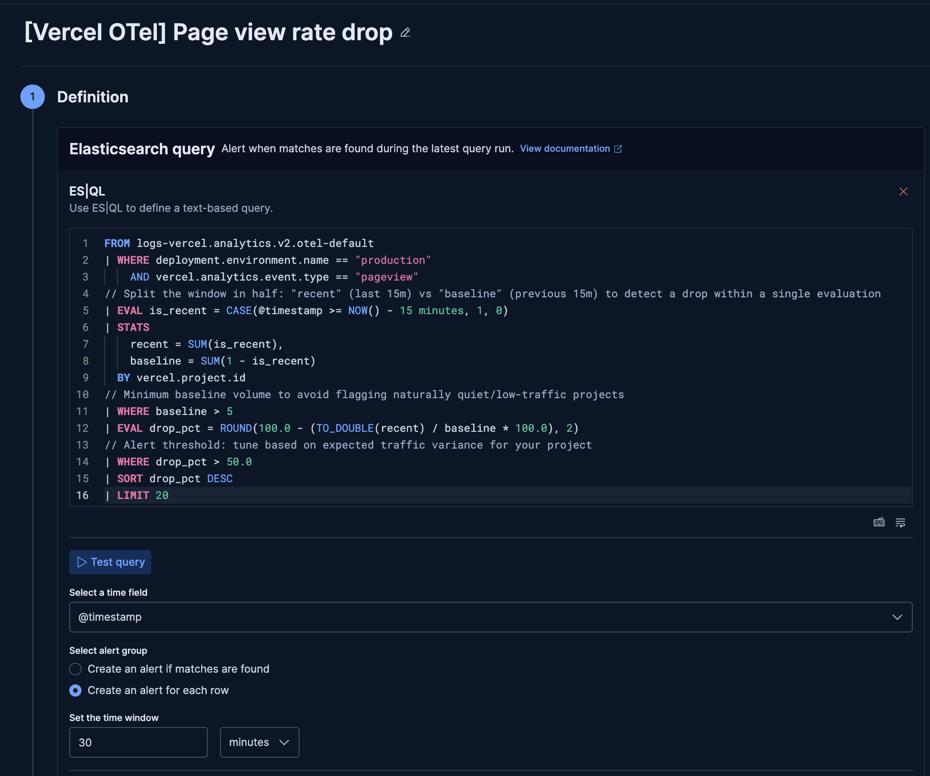

Ten alert rules for Vercel failure modes
Beyond dashboards, ten pre-built alert rules cover the failure modes that actually matter for Vercel workloads:
  • 5xx spikes.
  • Lambda and edge function hard crashes (the kind that never return an HTTP response and disappear from standard error-rate math).
  • Sudden traffic drops on both server and client side.
  • Regional error concentration.
  • TTFB degradation as an early warning for LCP regressions.
  • WAF deny spikes.
  • Suspicious audit activity from a single actor.

Trace waterfalls and service maps in Kibana
For traces, once data is flowing you get the full experience in Kibana's Service inventory: end-to-end trace waterfalls, service maps, and log lines correlated right alongside the spans.
