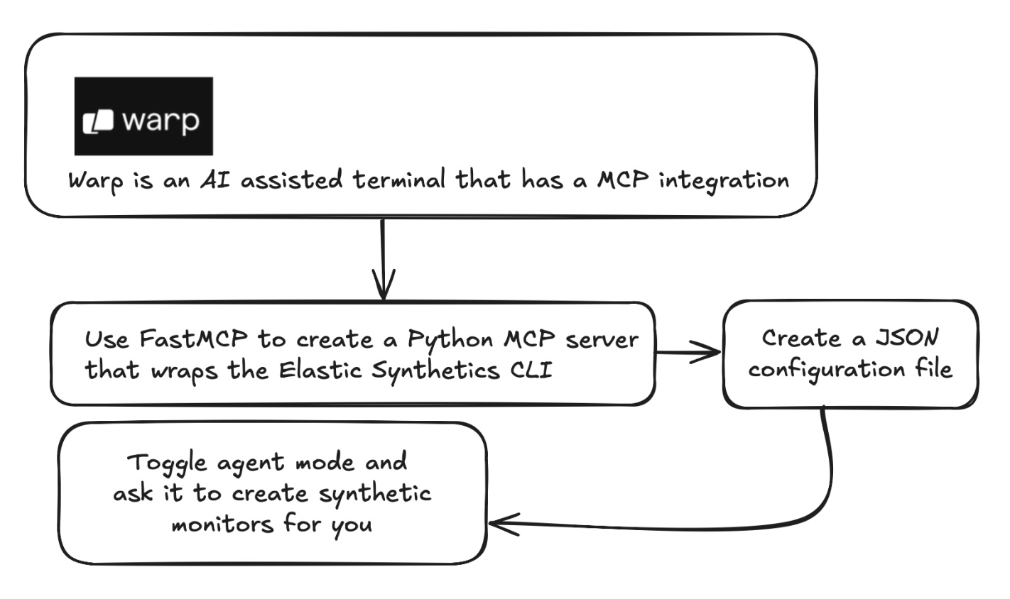

To automatically create user journeys using TypeScript, you can create Playwright tests based on a prompt using Warp, an AI-assisted terminal, Gemini 2.5 Pro, and MCP. This application was built using Python and FastMCP, which wraps the synthetic agent to deploy browser tests to Elastic automatically. This blog post will guide you through how the application works, how to use it, and its development process. You can find the complete code on GitHub.
Solution overview
Currently, this solution is set up to run inside Warp as an MCP server; however, you can also use another client, such as Claude Desktop or Cursor. From there, you create a Python script using FastMCP, which allows you to create functions that are callable by an LLM. Within Warp, you can make a configuration file in JSON that enables you to point to your Python script and pass in all the environment variables you are working with. From there, you'll want to toggle agent mode and ask a question about creating synthetic testing or call the MCP function directly. There are many options for which LLM you can select, be sure to check out Warp's documentation to learn more about the options available.

Step 2: Set up a configuration file in Warp

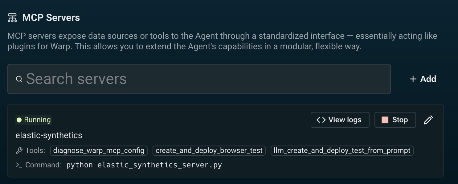

Inside of Warp, you will want to go to the side panel, where it says MCP servers and where it says “add”.
After that, you will be prompted to add a JSON configuration file that should resemble the following. Be sure to add your own Kibana URL, update the correct path, and include your own keys and tokens.

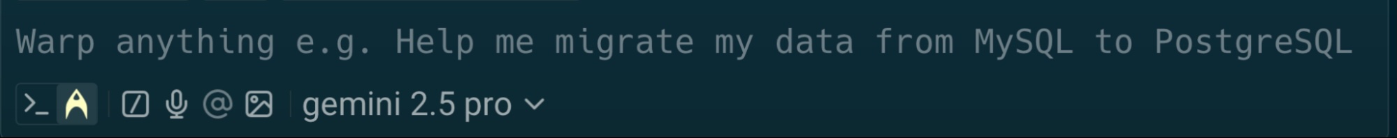

Now that you've set up locally, you will want to toggle agent mode and select the LLM you wish to use. The reason why Gemini-Pro-2.5 was chosen for this blog post is that it provides a straightforward answer, while other LLMs selected returned a very lengthy response.

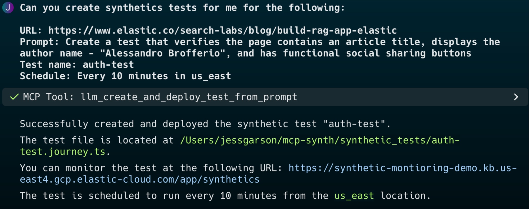

To start using the MCP tools, from your MCP server, you can ask a question that contains the test name, URL, prompt, and schedule.

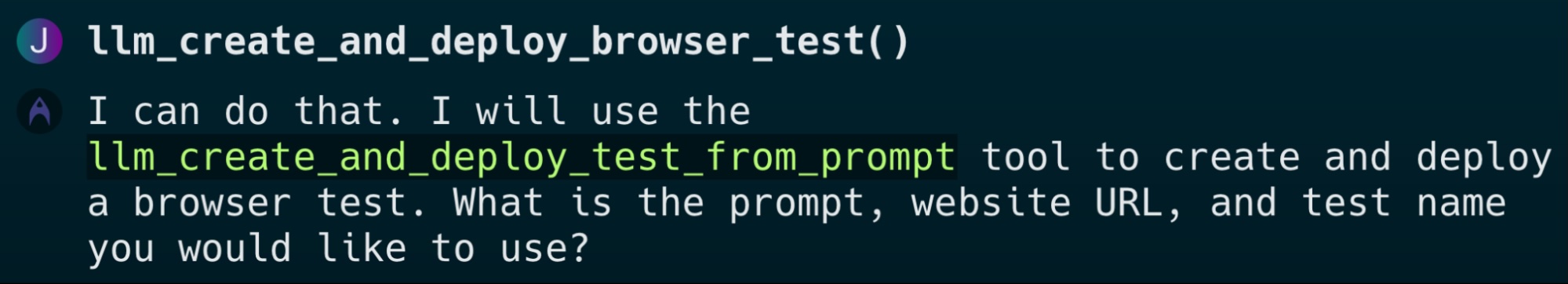

You can also call the directly by typing llm_create_and_deploy_test_from_prompt() and the program will prompt you for the relevant details:

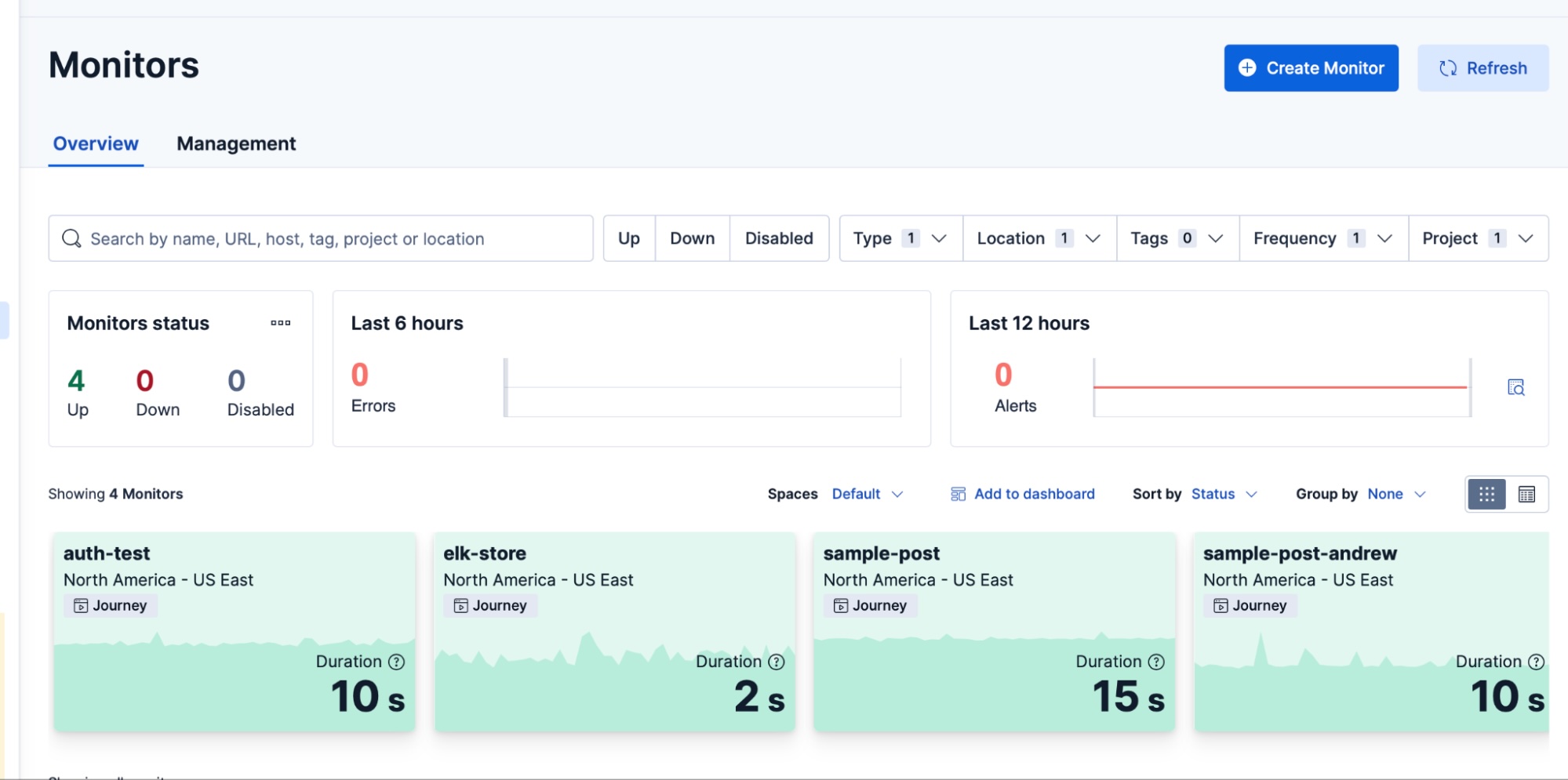

Inside Kibana, you should see your monitor listed if you click under Applications and select Monitors listed under Synthetics. You can also find a link to your monitor in the response of your MCP tool.
