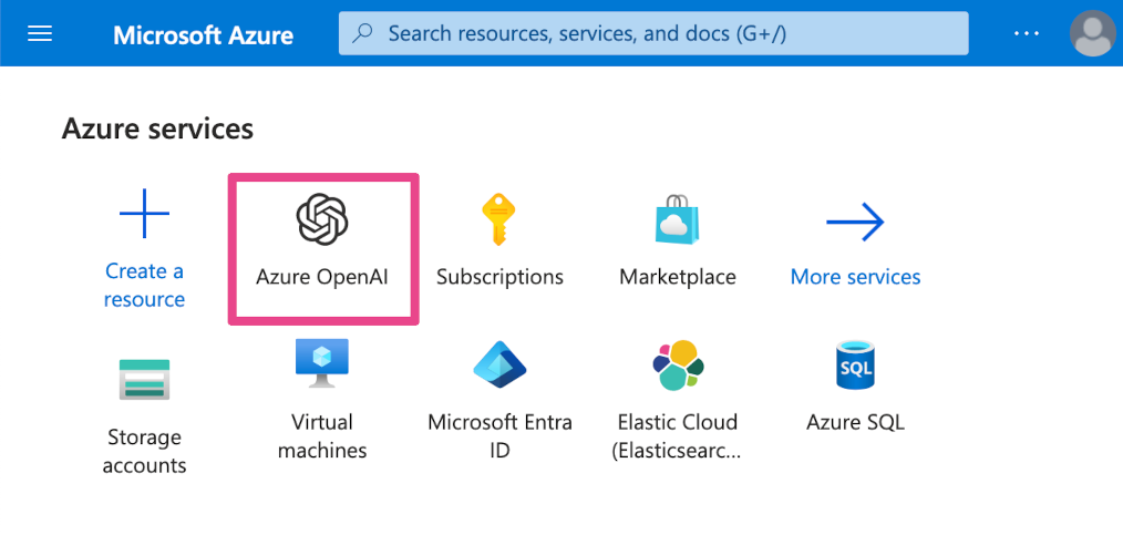

In the Azure portal, select Azure OpenAI.

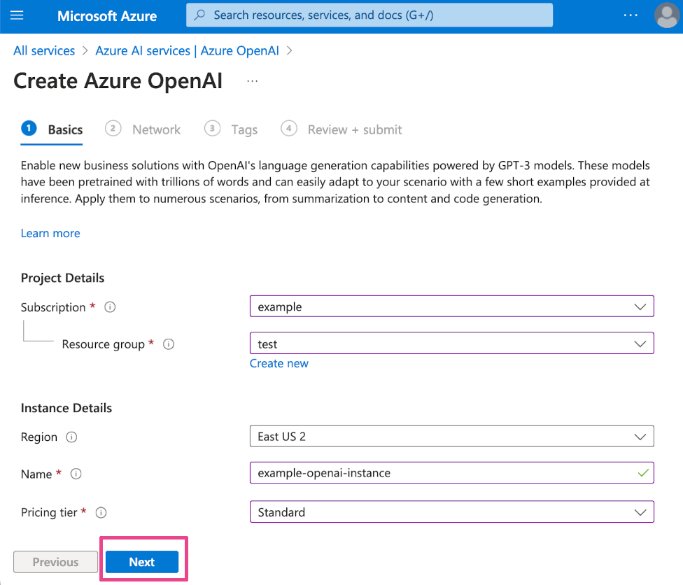

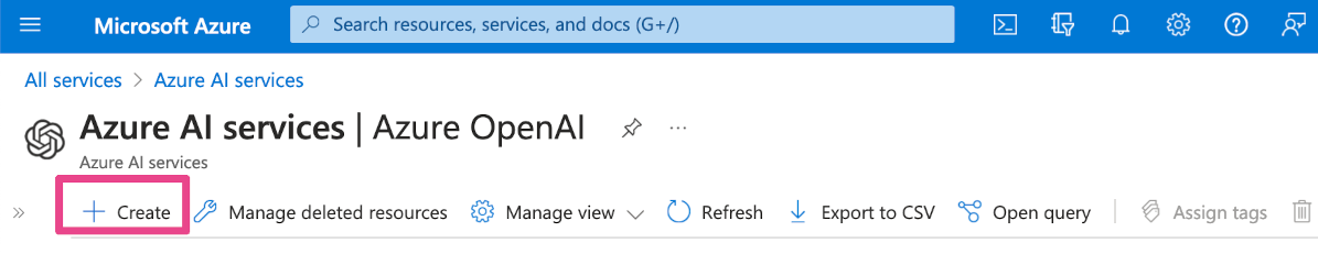

In the Azure OpenAI service, click the Create button.
Enter an instance Name and click Next.

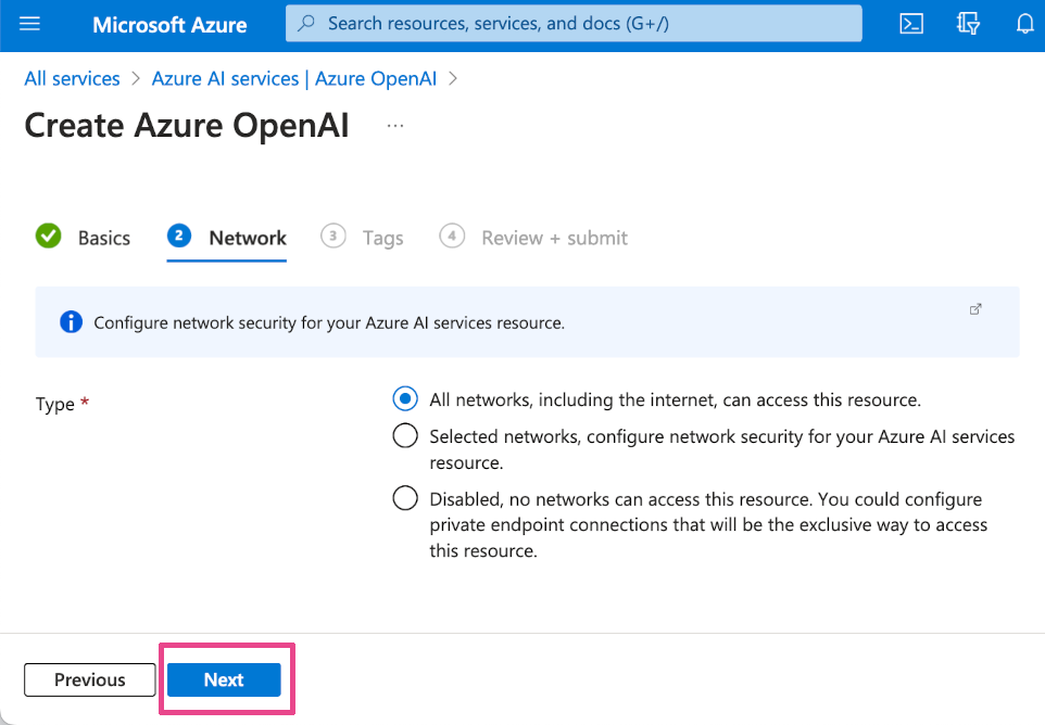

Select your network access preference for the Azure OpenAI instance and click Next.

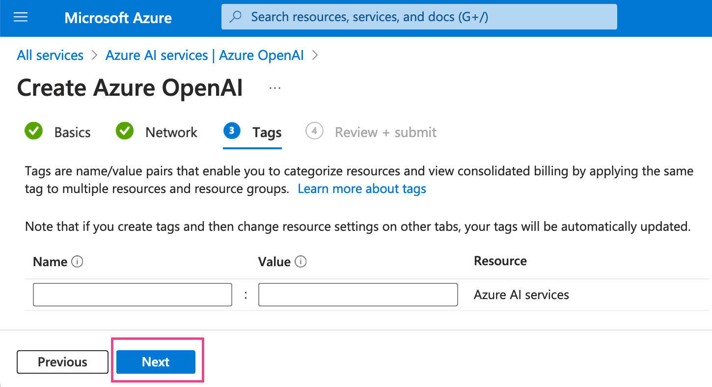

Add optional Tags and click Next.

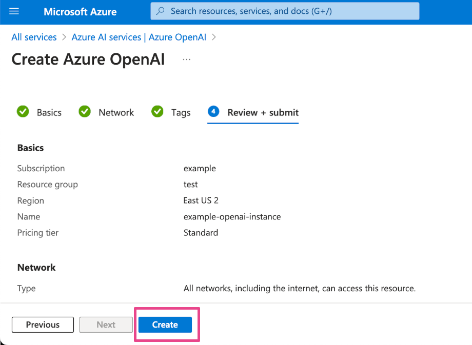

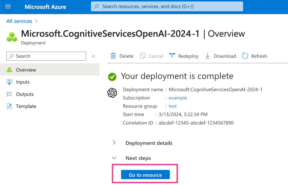

Confirm your settings and click Create to create the Azure OpenAI instance.

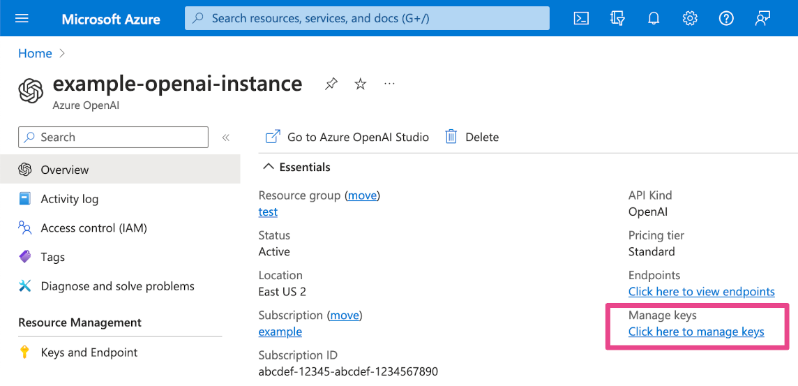

Once the instance creation is complete, click the Go to resource button.

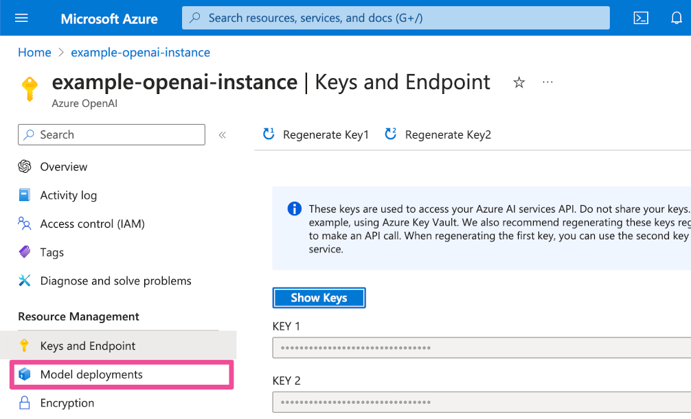

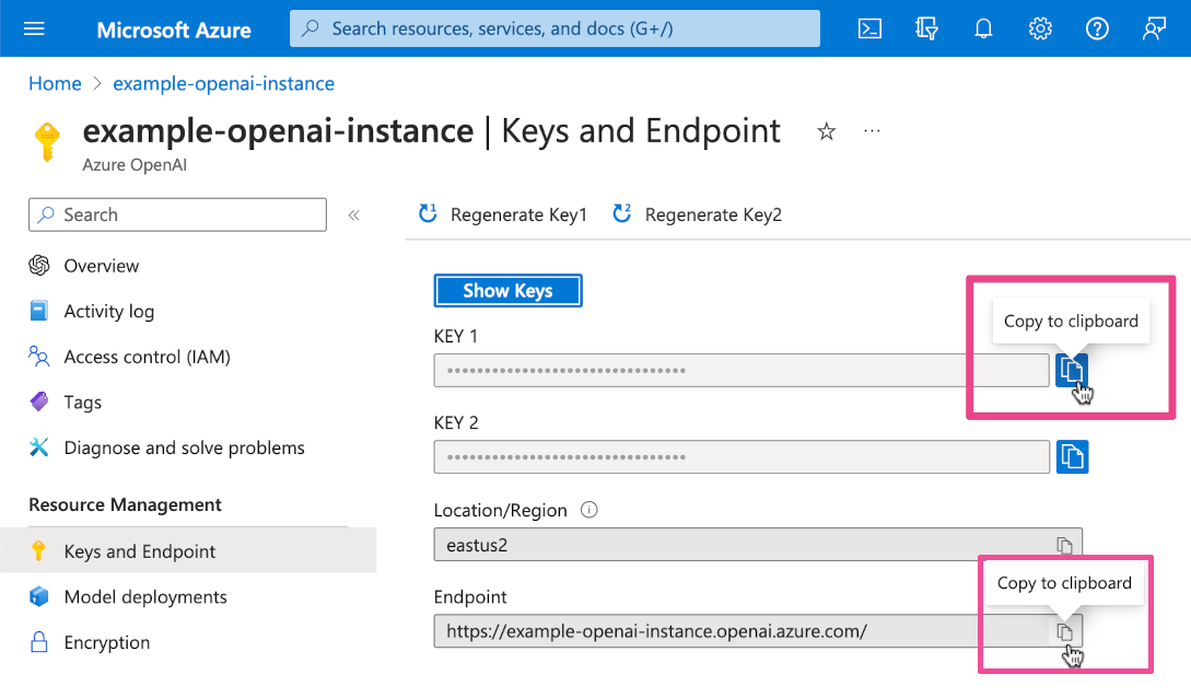

Click the Manage keys link to access the instance’s API key.
Copy your Azure OpenAI API Key and the Endpoint and save them both in a safe place for use in a later step.

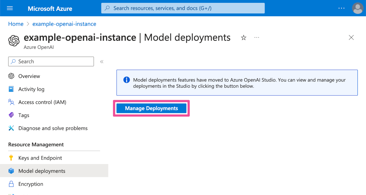

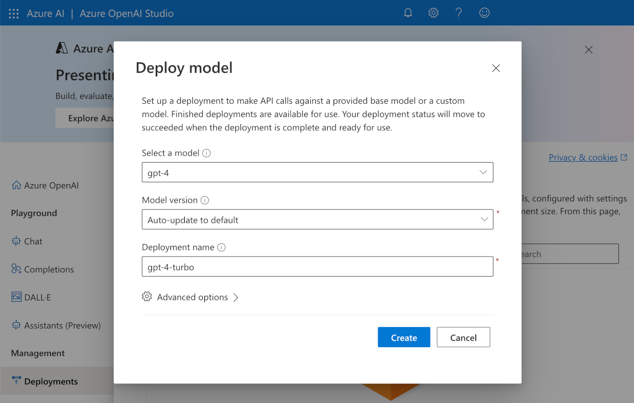

Next, click Model deployments to create a deployment within the Azure OpenAI instance you just created.

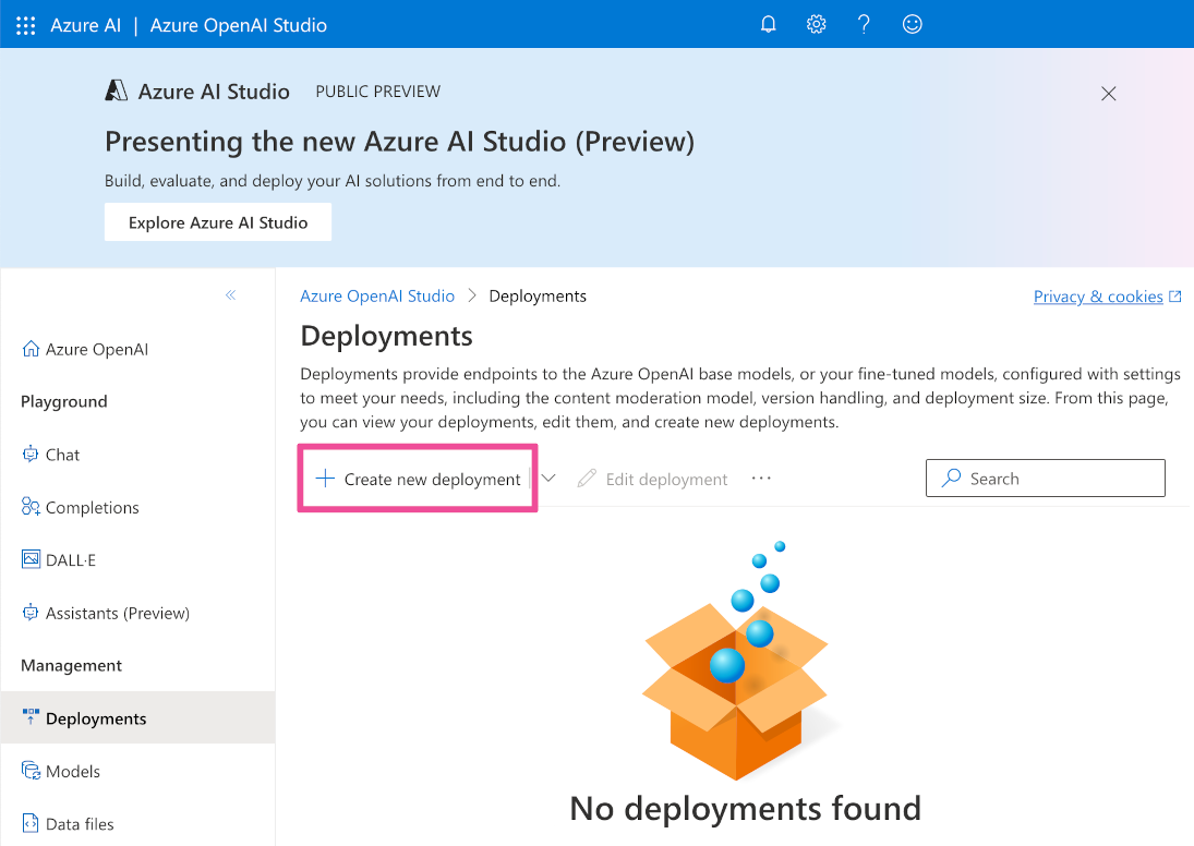

Click the Manage deployments button to open Azure OpenAI Studio.
Click the Create new deployment button.
Select the model type you want to use and enter a Deployment name. Note the Deployment name for use in a later step. Click the Create button to deploy the model.

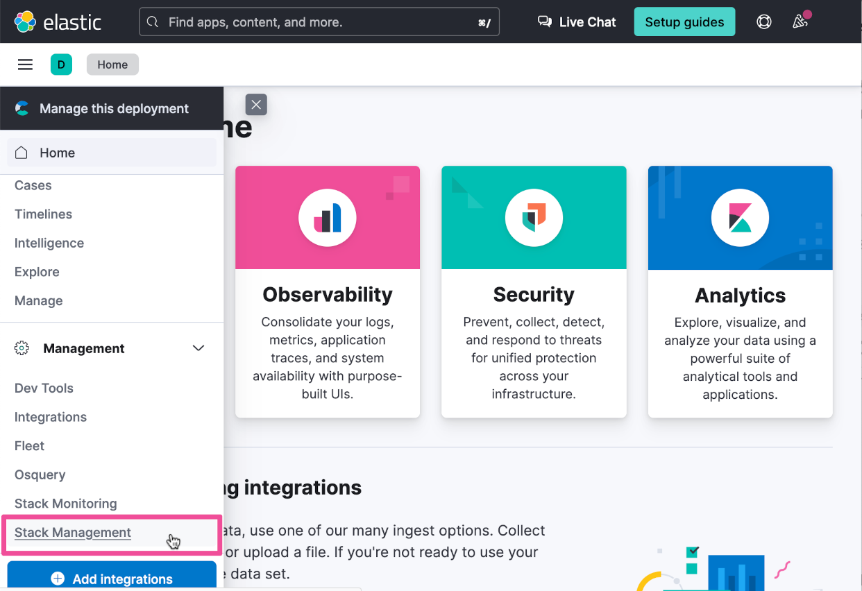

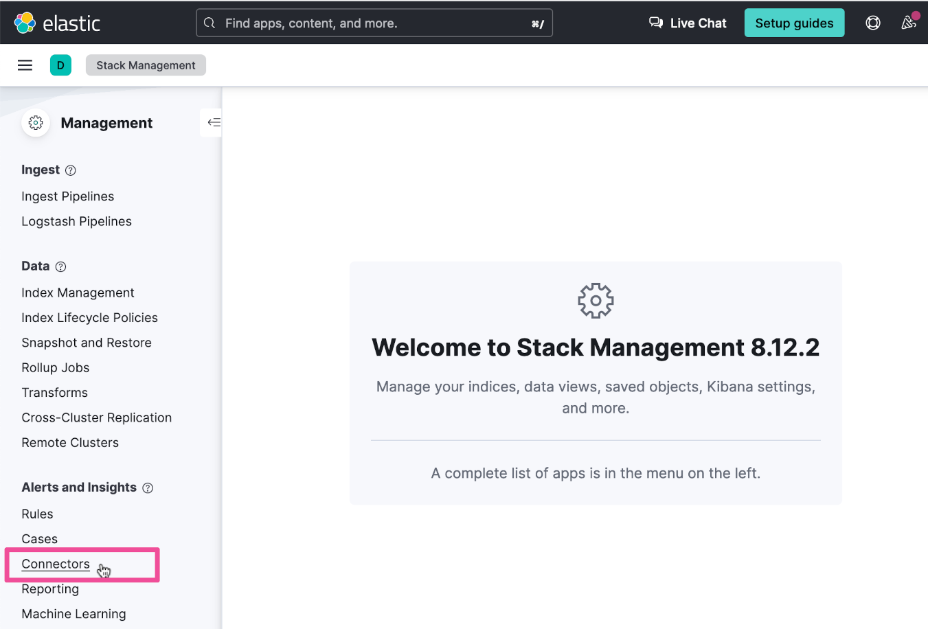

The next step is to create an Azure OpenAI connector in Elastic Cloud. In the Elastic Cloud console for your deployment, select the top-level menu and then select Stack Management.
Select Connectors on the Stack Management page.

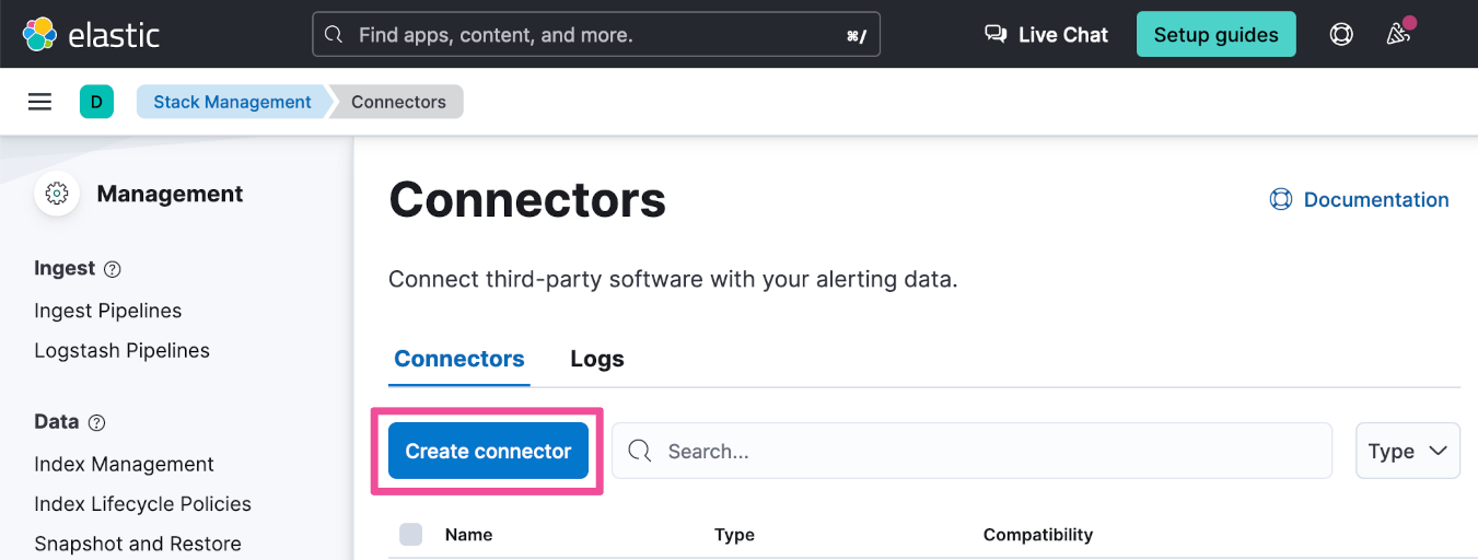

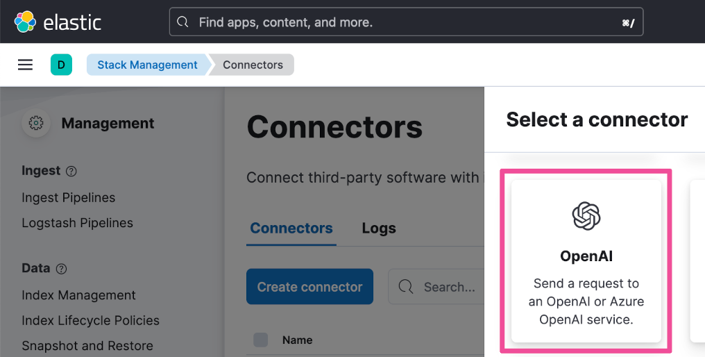

Select Create connector.

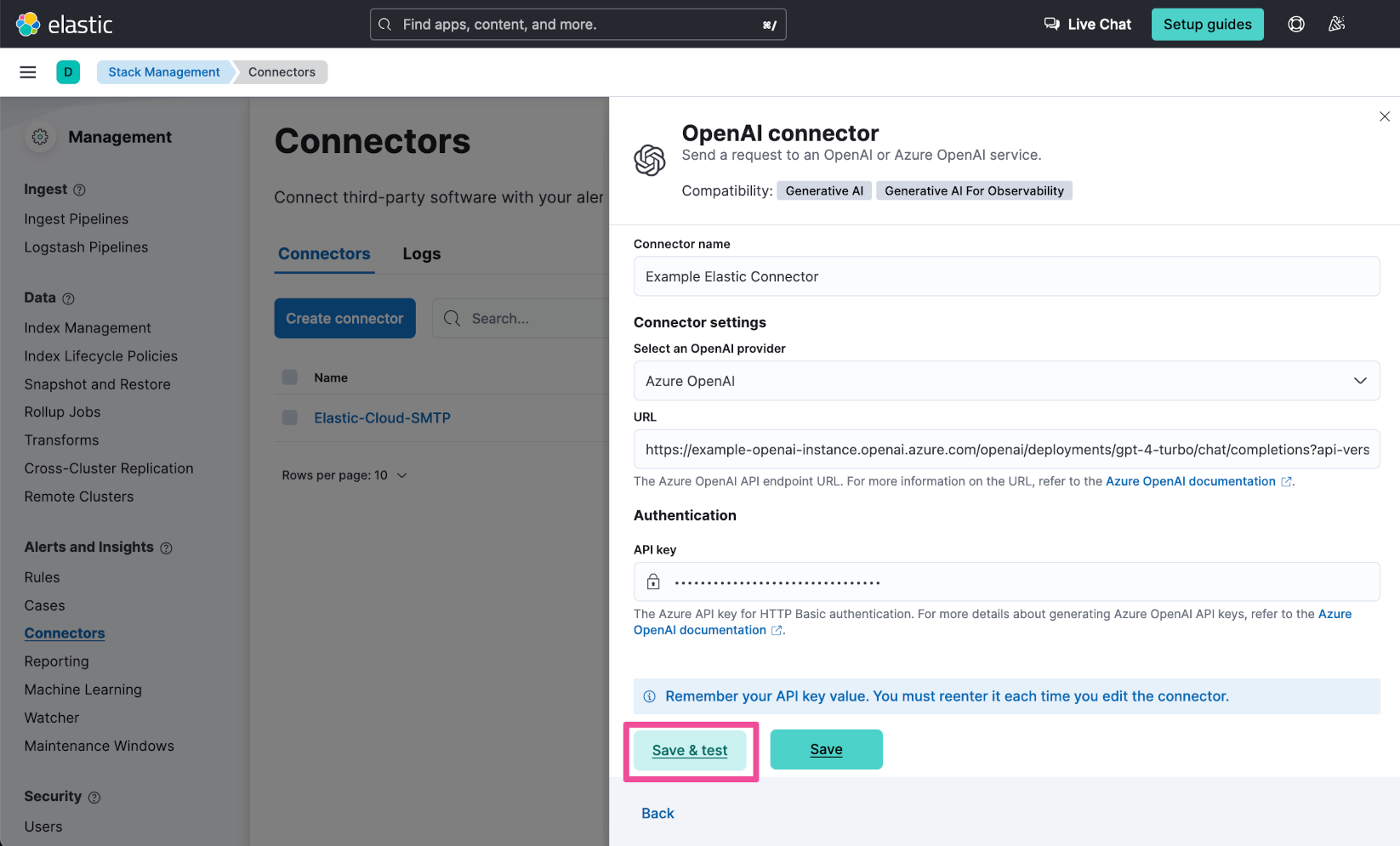

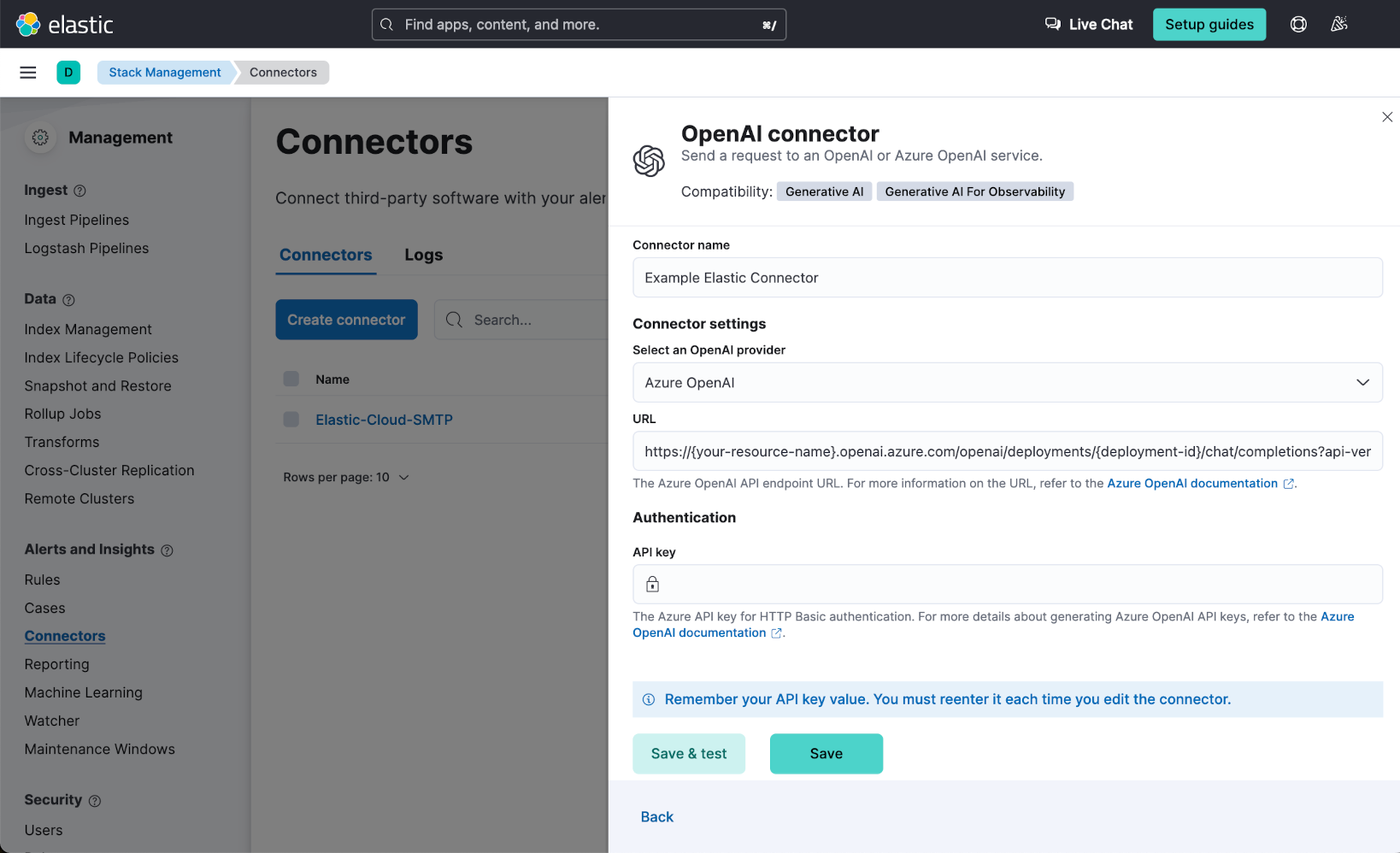

Select the connector for Azure OpenAI.
Enter a Name of your choice for the connector. Select Azure OpenAI as the OpenAI provider.
Enter the Endpoint URL using the following format:
  • Replace {your-resource-name} with the name of the Azure Open AI instance that you created within the Azure portal in a previous step.
  • Replace deployment-id with the Deployment name that you specified when you created a model deployment within the Azure portal in a previous step.
  • Replace {api-version} with one of the valid Supported versions listed in the Completions section of the Azure OpenAI reference page.
https://{your-resource-name}.openai.azure.com/openai/deployments/{deployment-id}/chat/completions?api-version={api-version}
Your completed Endpoint URL should look something like this:
https://example-openai-instance.openai.azure.com/openai/deployments/gpt-4-turbo/chat/completions?api-version=2024-02-01

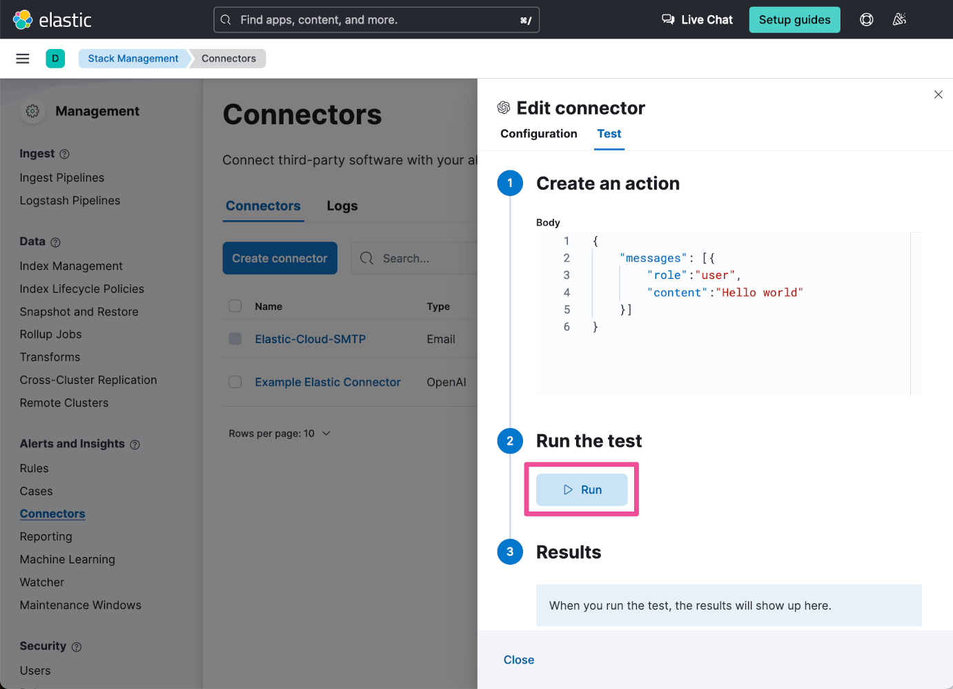

Enter the API Key that you copied in a previous step. Then click the Save & test button.

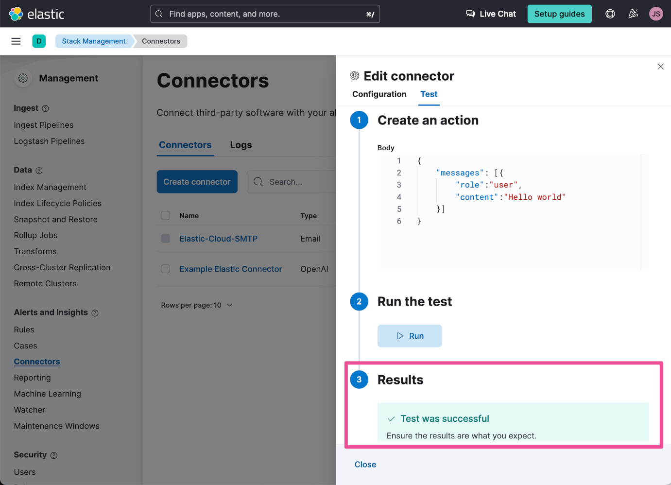

Within the Edit Connector flyout window, click the Run button to confirm that the connector configuration is valid and can successfully connect to your Azure OpenAI instance.
A successful connector test should look something like this:

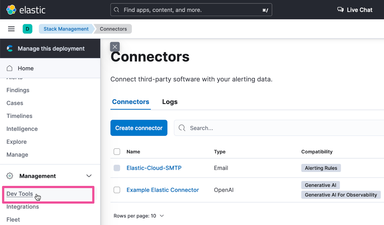

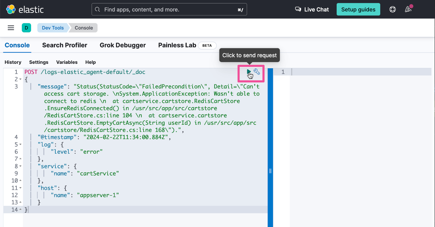

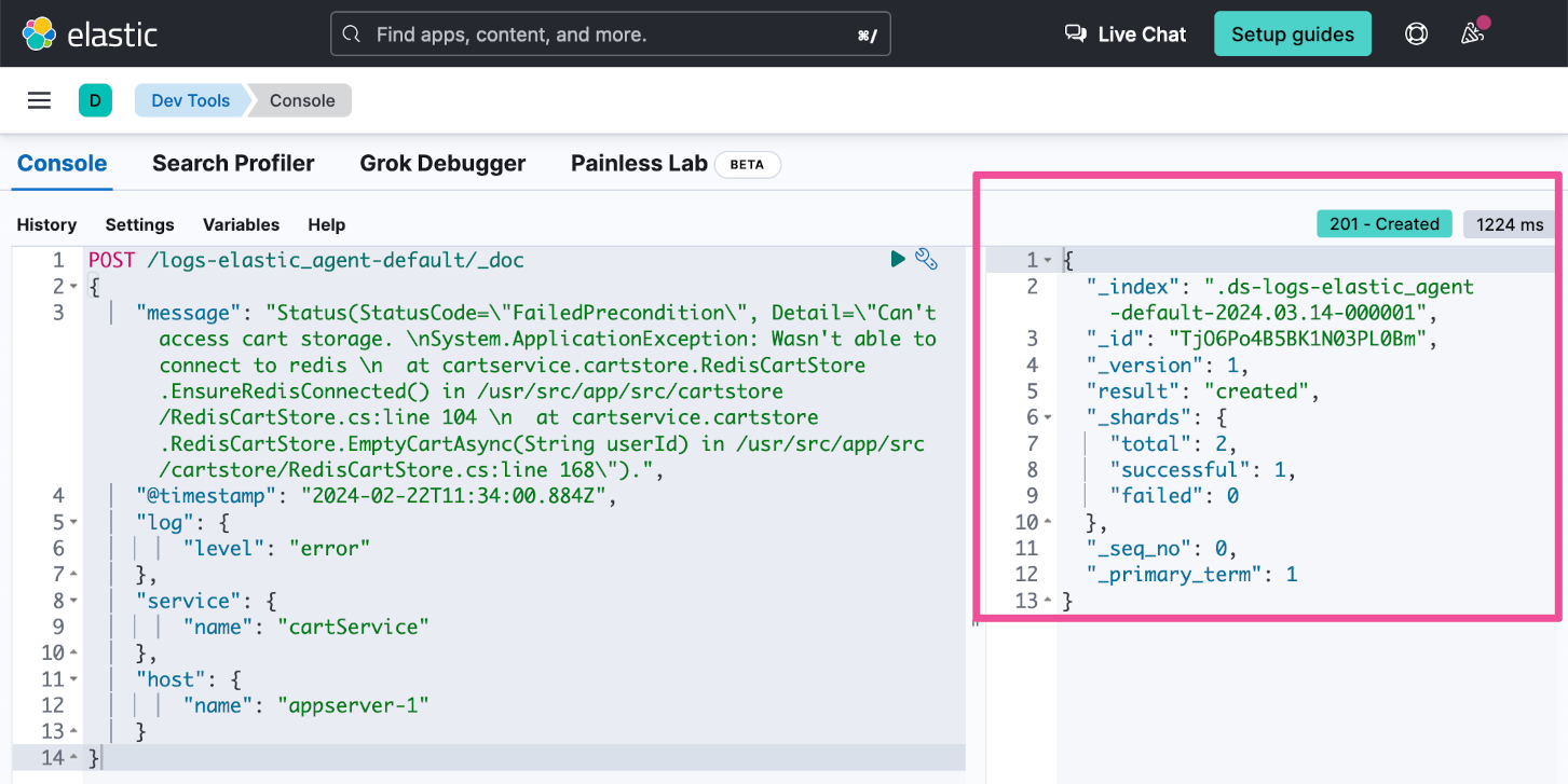

We’ll use the Elastic Dev Tools to add a single logs record. Click the top-level menu and select Dev Tools.
Within the Console area of Dev Tools, enter the following POST statement:
POST /logs-elastic_agent-default/_doc
	"message": "Status(StatusCode=\"FailedPrecondition\", Detail=\"Can't access cart storage. \nSystem.ApplicationException: Wasn't able to connect to redis \n  at cartservice.cartstore.RedisCartStore.EnsureRedisConnected() in /usr/src/app/src/cartstore/RedisCartStore.cs:line 104 \n  at cartservice.cartstore.RedisCartStore.EmptyCartAsync(String userId) in /usr/src/app/src/cartstore/RedisCartStore.cs:line 168\").",
	"@timestamp": "2024-02-22T11:34:00.884Z",
	"log": {
    	"level": "error"
	"service": {
    	"name": "cartService"
	"host": {
    	"name": "appserver-1"

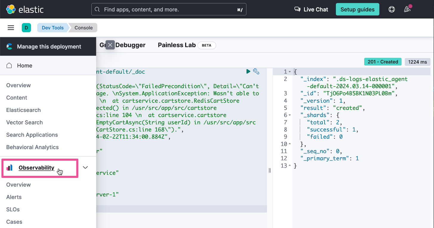

Then run the POST command by clicking the green Run button.
You should see a 201 response confirming that the example logs record was successfully created.
Use the Elastic AI Assistant
Now that you have a log record to work with, let’s jump over to the Observability Logs Explorer to see how the AI Assistant interacts with logs data. Click the top-level menu and select Observability.

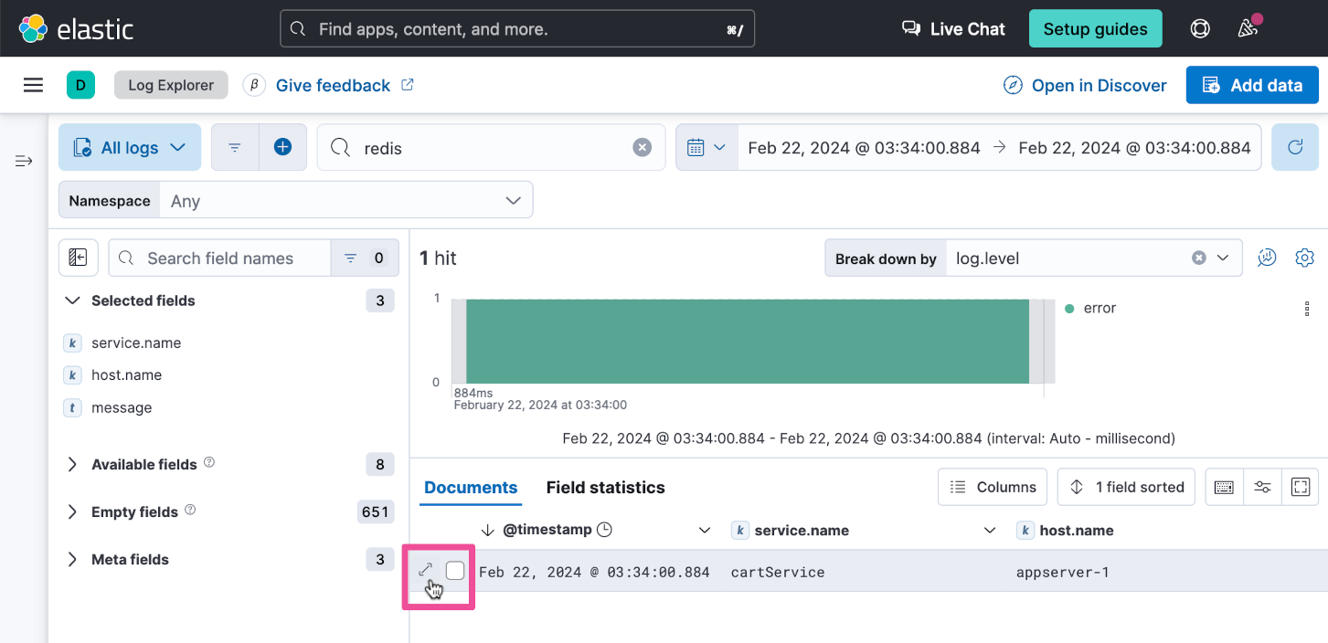

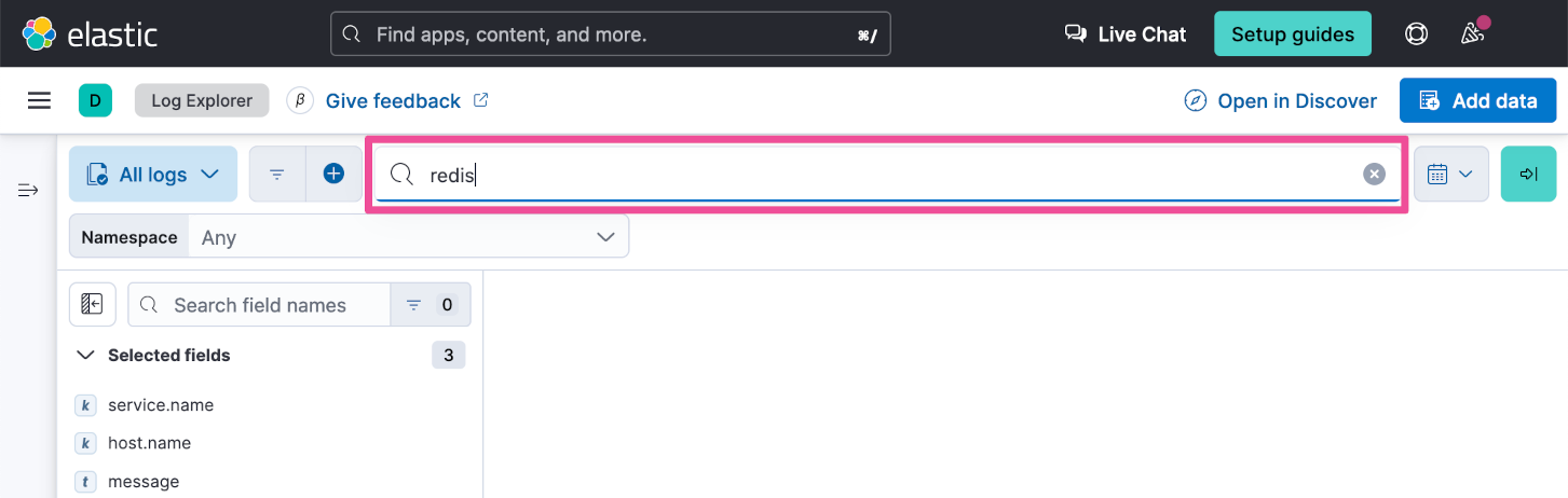

In the Logs Explorer search box, enter the text “redis” and press the Enter key to perform the search.

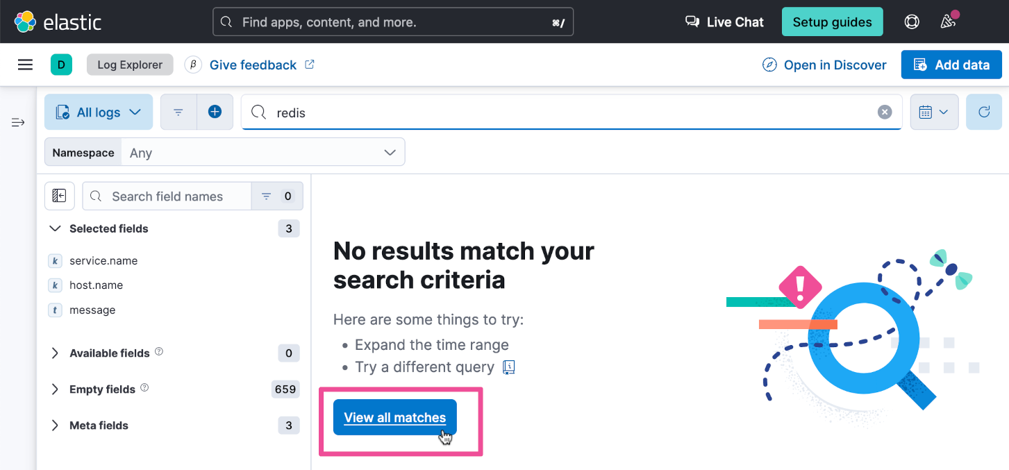

Click the View all matches button to include all search results.

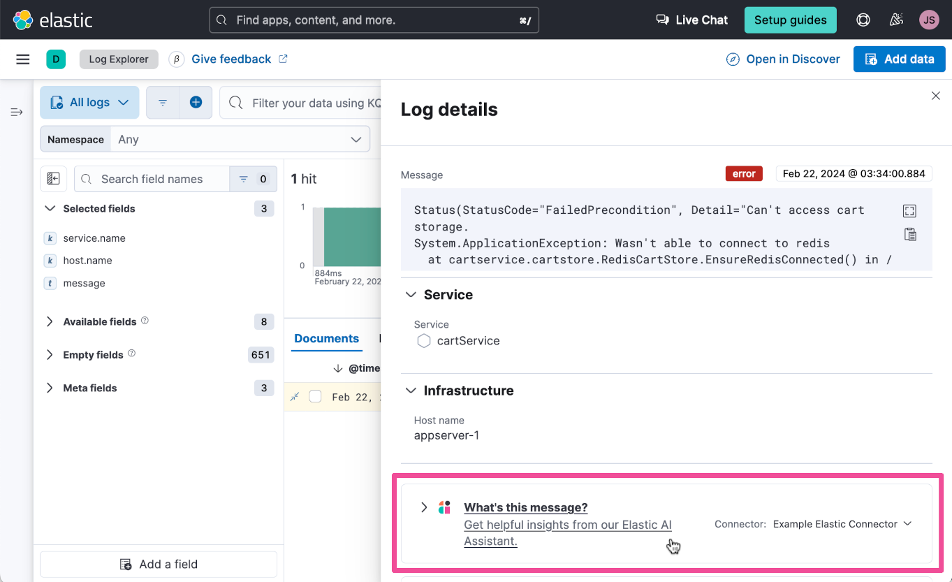

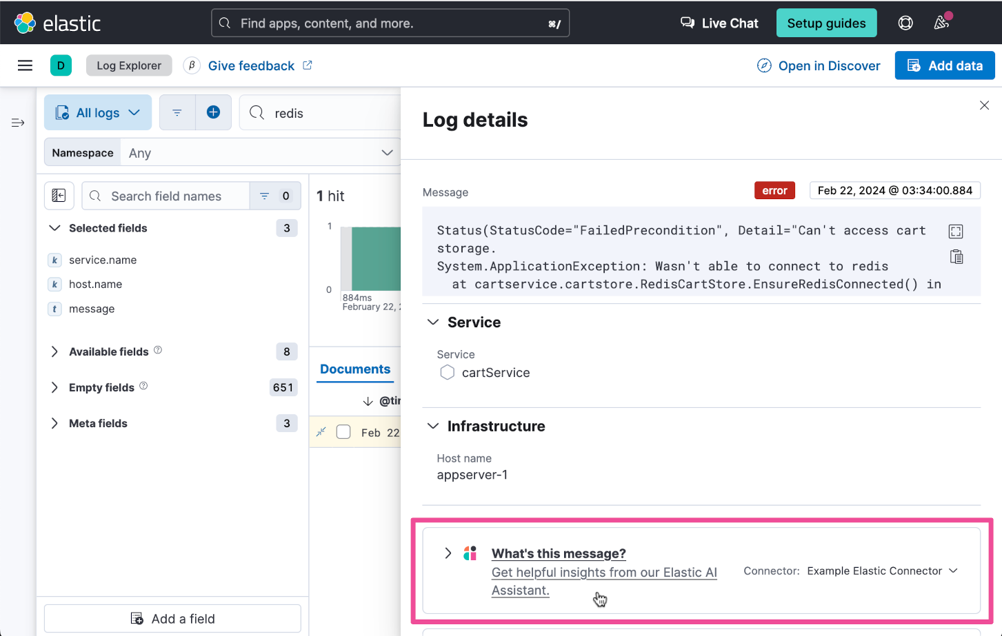

You should see the one log record that you previously inserted via Dev Tools. Click the expand icon to see the log record’s details.

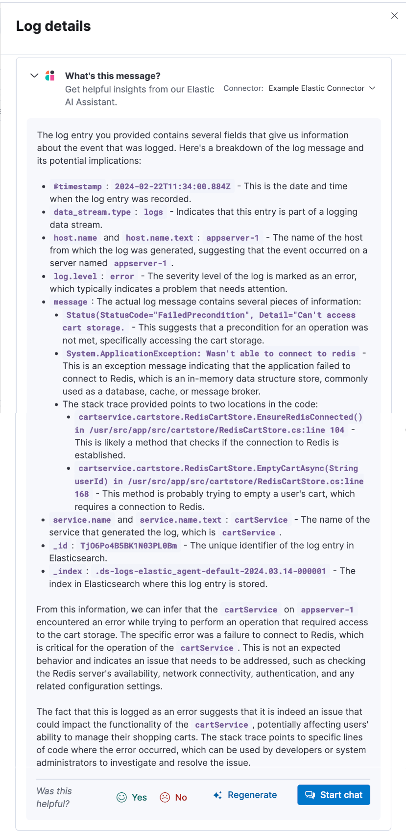

You should see the expanded view of the logs record. Instead of trying to understand its contents ourselves, we'll use the AI Assistant to summarize it. Click on the What's this message? button.
We get a fairly generic answer back. Depending on the exception or error we're trying to analyze, this can still be really useful, but we can make this better by adding additional documentation to the AI Assistant knowledge base.

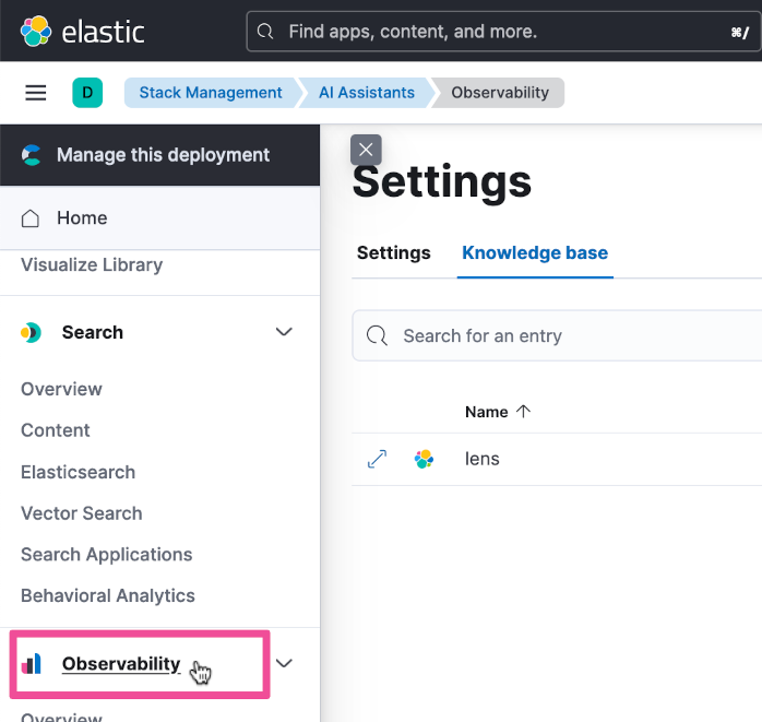

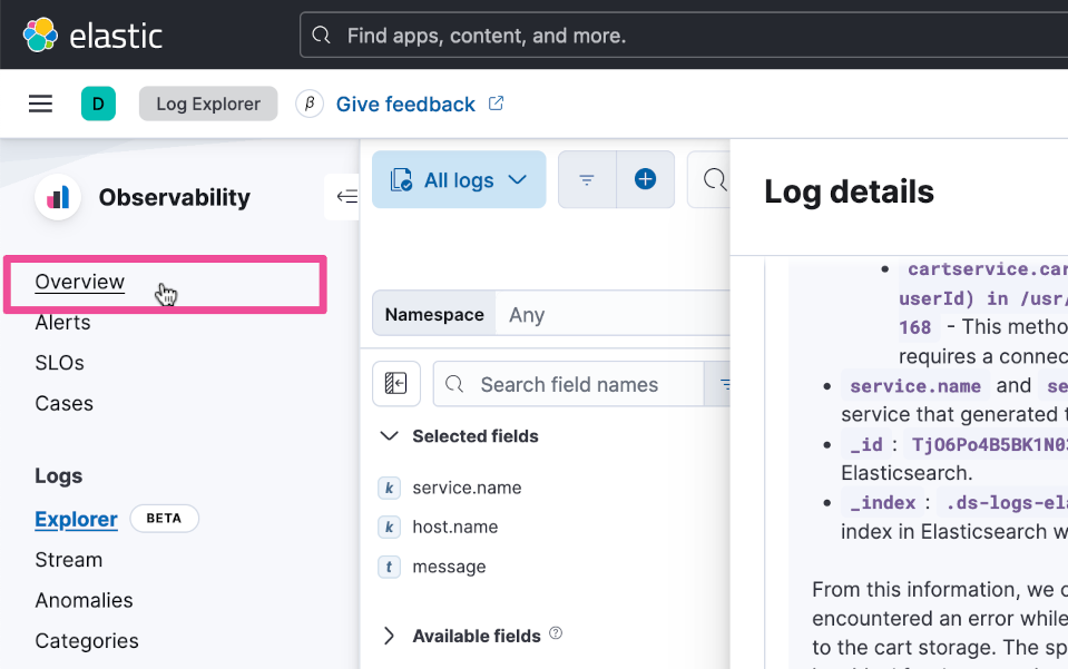

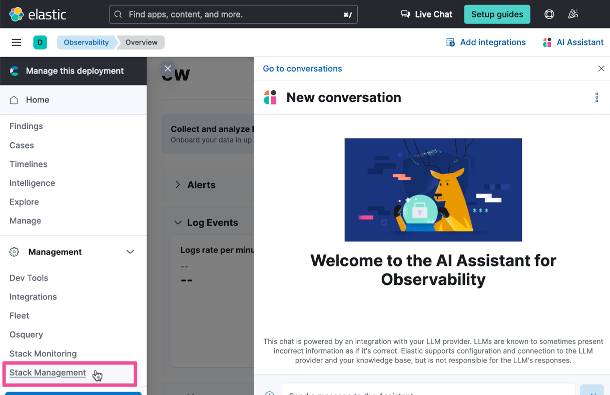

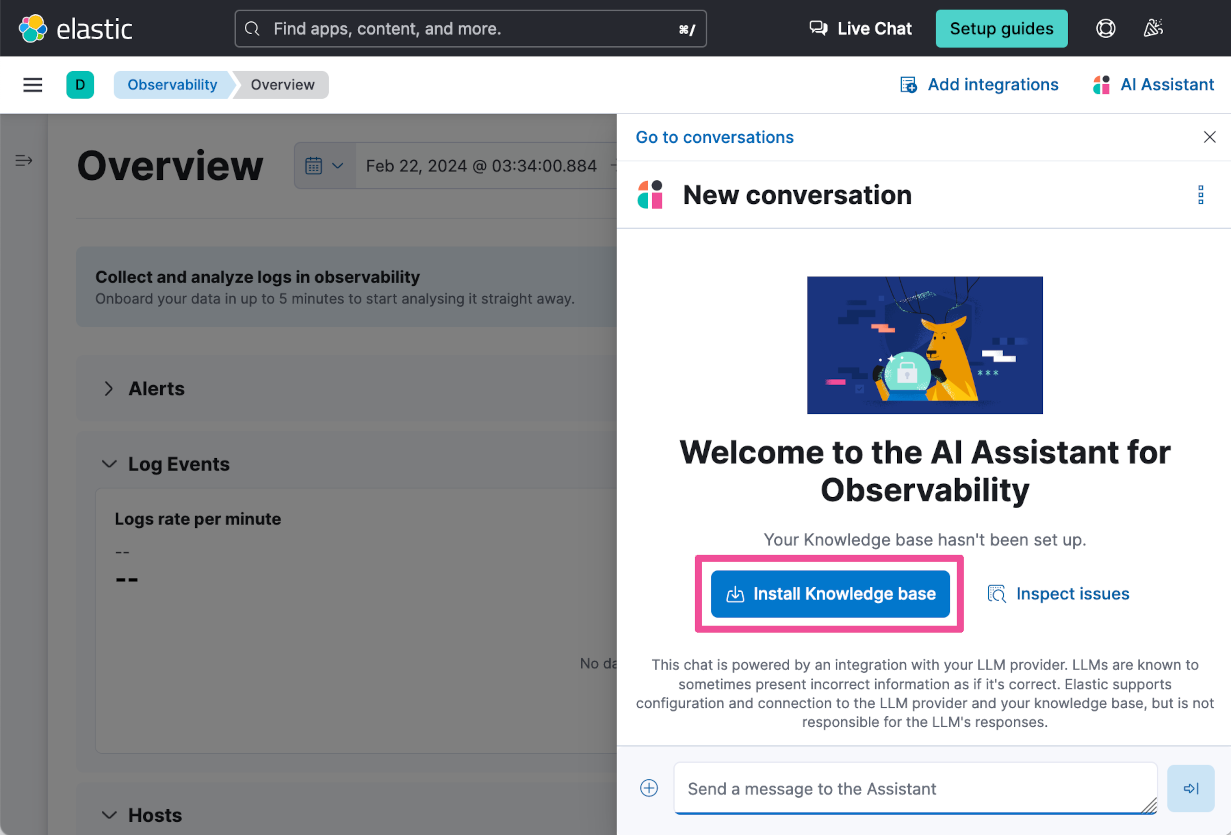

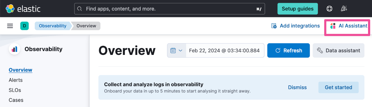

Select Overview from the Observability menu.
Click the AI Assistant button at the top right of the window.
Click the Install Knowledge base button.

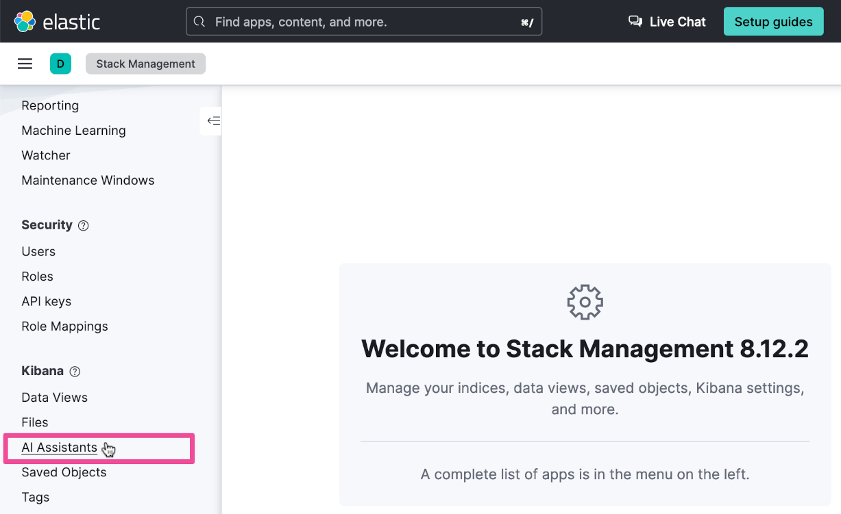

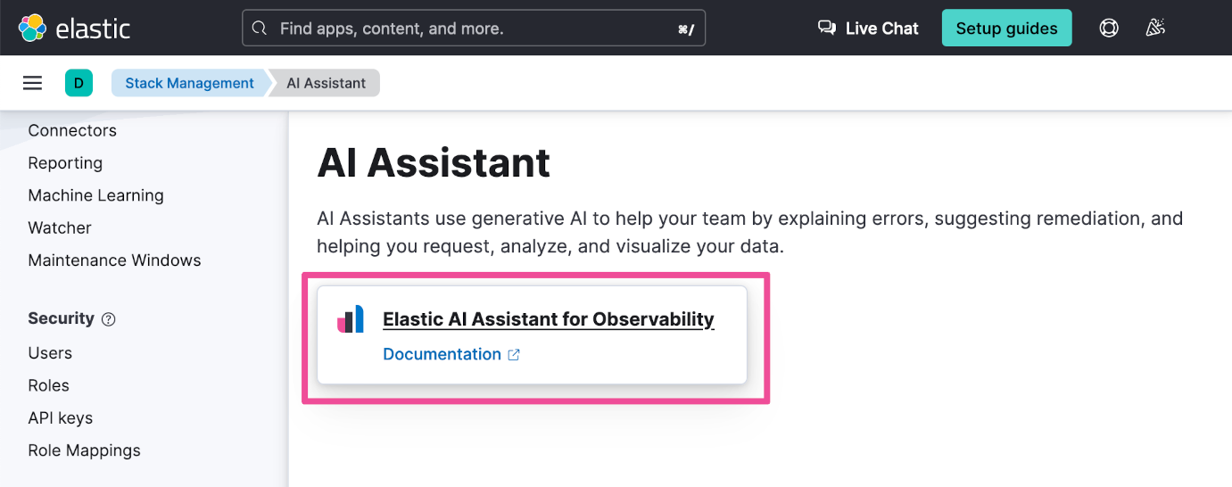

Click the top-level menu and select Stack Management.

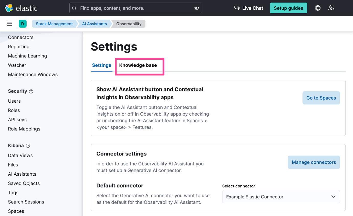

Then select AI Assistants.
Click Elastic AI Assistant for Observability.

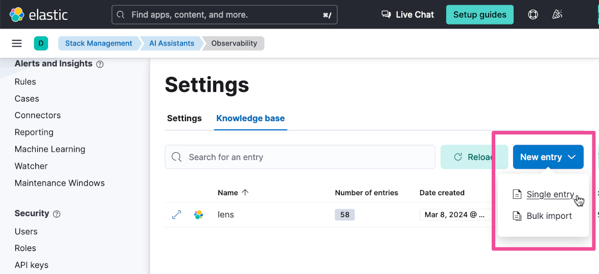

Select the Knowledge base tab.
Click the New entry button and select Single entry.

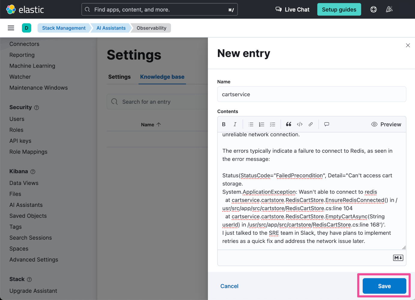

Give it the Name “cartservice” and enter the following text as the Contents :
Link: [Cartservice Intermittent connection issue](https://github.com/elastic/observability-examples/issues/25)
I have the following GitHub issue. Store this information in your knowledge base and always return the link to it if relevant.
GitHub Issue, return if relevant
Link: https://github.com/elastic/observability-examples/issues/25
Title: Cartservice Intermittent connection issue
Body:
The cartservice occasionally encounters storage errors due to an unreliable network connection.
The errors typically indicate a failure to connect to Redis, as seen in the error message:
Status(StatusCode="FailedPrecondition", Detail="Can't access cart storage.
at cartservice.cartstore.RedisCartStore.EmptyCartAsync(String userId) in /usr/src/app/src/cartstore/RedisCartStore.cs:line 168')'.
I just talked to the SRE team in Slack, they have plans to implement retries as a quick fix and address the network issue later.
Click Save to save the new knowledge base entry.

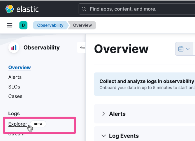

Now let’s go back to the Observability Logs Explorer. Click the top-level menu and select Observability.

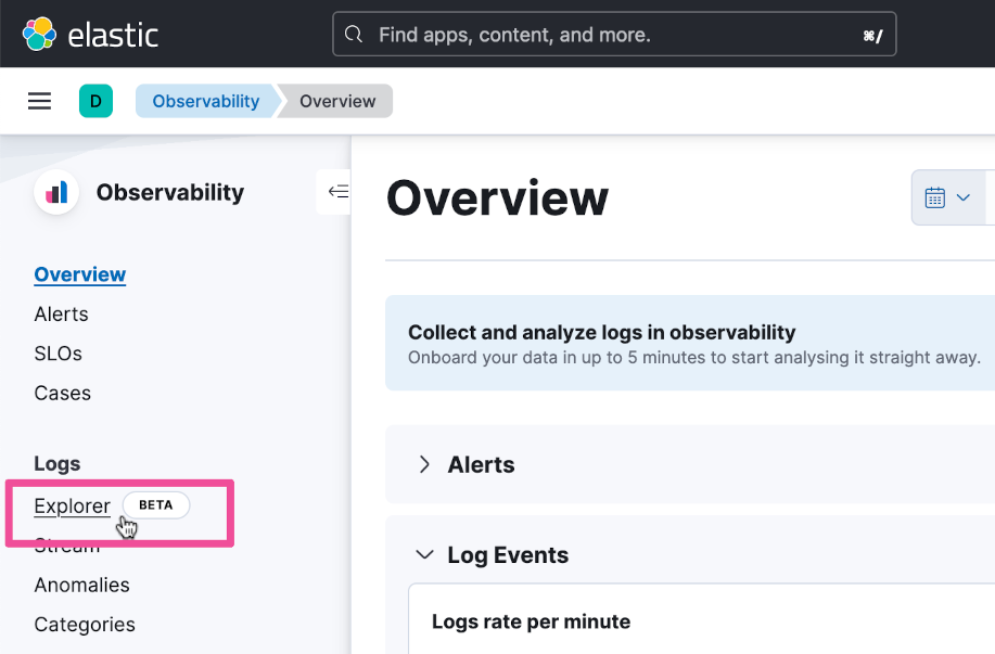

Then select Explorer under Logs.

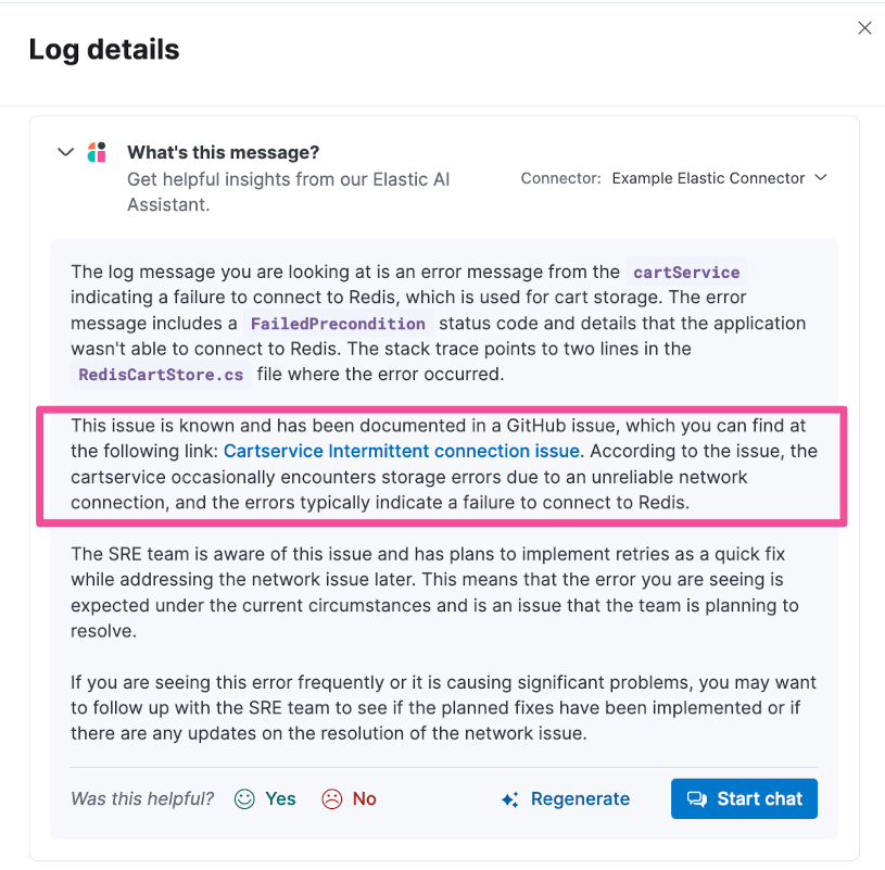

Expand the same logs entry as you did previously and click the What’s this message? button.
The response you get now should be much more relevant.
