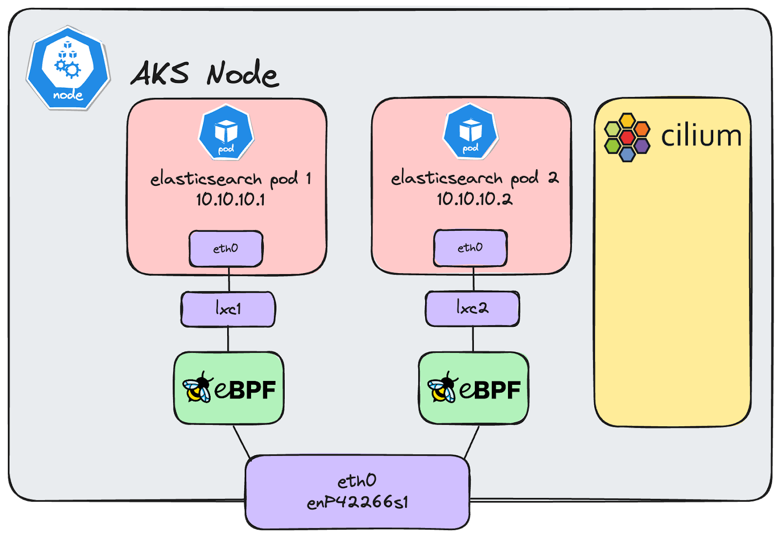

We mentioned earlier that we’re building Azure Elasticsearch Serverless on top of Azure’s AKS service, which is important to note because all of our AKS nodes use an Azure feature called Accelerated Networking. In this setup, network traffic is delivered directly to the VM’s network interface, bypassing the hypervisor. This is enabled by single root I/O virtualization (SR-IOV), which offers much lower latency and higher throughput than traditional VM networking. Each node is physically connected to a 100 Gb/s network interface, although the SR-IOV Virtual Function (VF) exposed to the VM typically provides only a fraction of that total bandwidth.
Despite the VM only having a fraction of the 100 Gb/s bandwidth, microbursts are still very possible. These physical interfaces are so fast that they can transmit and receive multiple packets in just nanoseconds, far faster than most buffers or processing queues can absorb. At these timescales, even a short-lived burst of traffic can overwhelm the receiver, leading to dropped packets and unpredictable latency.
Direct access to the SR-IOV interface means that our VMs are responsible for handling the hardware interrupts triggered by the NIC in a timely manner, if there's any delay in handling the hardware interrupt (e.g. waiting to be scheduled onto CPU by the hypervisor) then network packets can be missed!

So, we continued to dig. We’d eliminated ~99% of the packet loss, and the remaining loss rate wasn’t as significant as what we’d started with, but we still wanted to understand why it was occurring even after adjusting the RX ring buffer size of the NIC.
So what does dropped represent, and what is this lxc0ca0ec41ecd2 interface? dropped is similar to missed, but only occurs when packets are deliberately dropped by the kernel or network interface. Crucially though, it doesn’t tell you why a packet was dropped. As for the lxc0ca0ec41ecd2 interface, we use the Azure CNI Powered by Cilium to provide the network functionality to our AKS clusters. Any pod spun up on an AKS node gets a ‘logical’ interface, which is a virtual ethernet (veth) pair that connects the pod’s network namespace with the host’s network namespace. It was here that we were dropping packets.
In our experience, packet drops at this layer are unusual, so we started digging deeper into the cause of the drops. There are numerous ways you can debug why a packet is being dropped, but one of the easiest is to use perf attach to the skb:kfree_skb tracepoint. The "socket buffer" (skb) is the primary data structure used to represent network packets in the Linux kernel. When a packet is dropped, its corresponding socket buffer is usually freed, triggering the kfree_skb tracepoint. Using perf to attach to this event allowed us to capture stack traces to analyze the cause of the drops.
