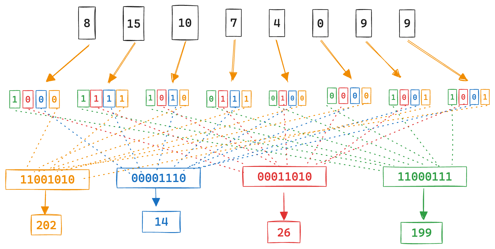

First of all observe that our best estimate of the dot product between two quantized vectors is
ytx=(ay1+byay2ny1y^)t(ax1+bxax2nx1x^)y^t x = \left(a_y 1 + \frac{b_y-a_y}{2^{n_y} - 1}\hat{y}\right)^t \left(a_x 1 + \frac{b_x-a_x}{2^{n_x} - 1}\hat{x}\right)
Expanding we obtain
y^tx^=ayax1t1+byay2ny1ax1ty^+bxax2nx1ay1tx^+byay2ny1bxax2nx1y^tx^\hat{y}^t \hat{x} = a_y a_x 1^t 1 + \frac{b_y-a_y}{2^{n_y} - 1} a_x 1^t \hat{y} + \frac{b_x-a_x}{2^{n_x} - 1} a_y 1^t \hat{x} + \frac{b_y-a_y}{2^{n_y} - 1} \frac{b_x-a_x}{2^{n_x} - 1} \hat{y}^t \hat{x}
Focusing on the vector dot products, since these dominate the compute cost, we observe that 1t11^t 1 is just equal to the vector dimension, and 1ty^1^t\hat{y} and 1tx^1^t\hat{x} are the sums of the quantized query and document vector components, respectively. For the query this can be computed once upfront and for the documents these can be computed at index time and stored with the quantized vector. Therefore, we need only compute the integer vector dot product y^tx^\hat{y}^t\hat{x} per comparison.

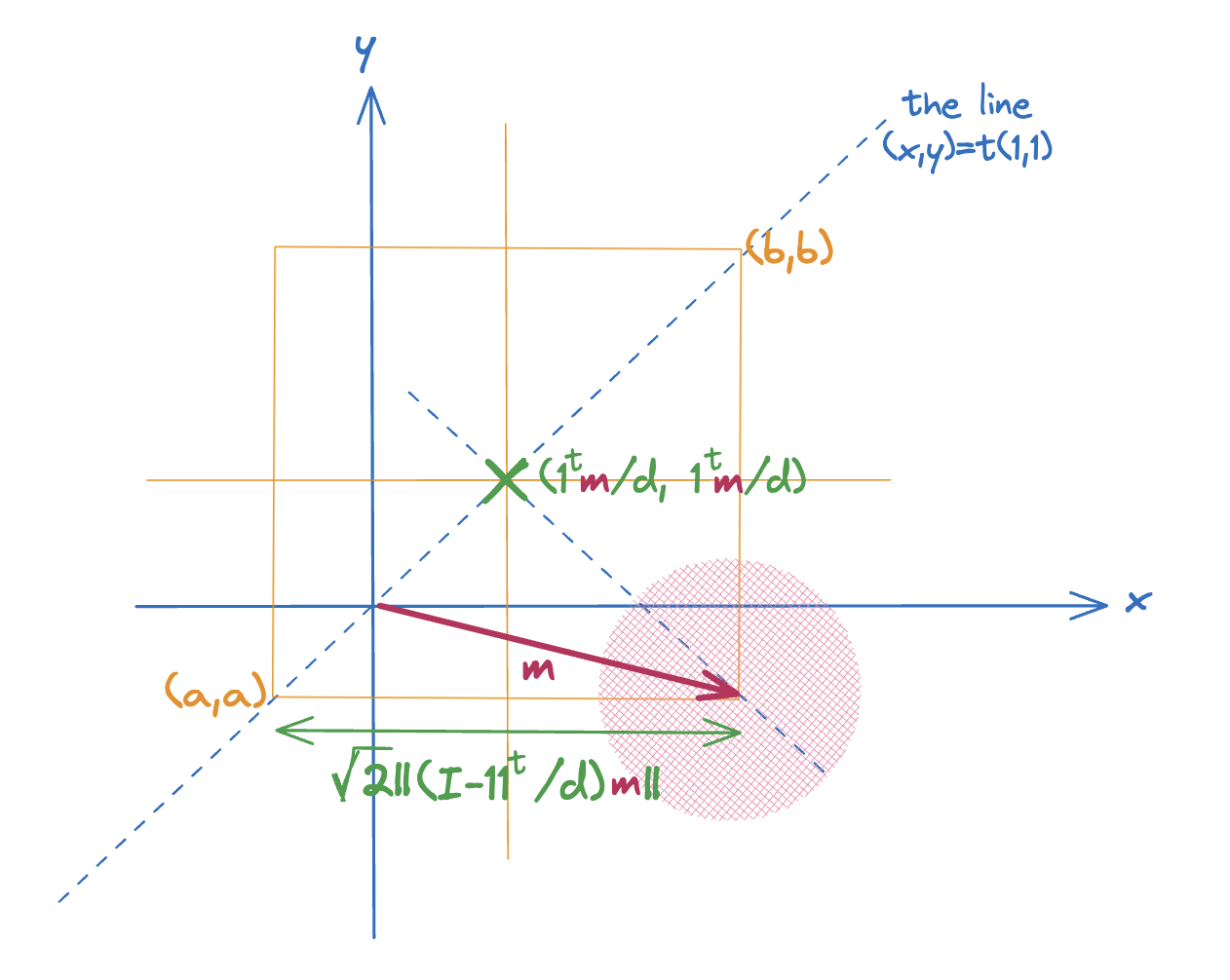

To build a bit more intuition about OSQ we digress to understand more about how scalar quantization represents a vector. Observe that the set of all possible quantized vectors lie inside a cube centered on the point a+b21\frac{a+b}{2}1 with side length bab−a. If only 1 bit is being used then the possible vectors lie at the 2d2^d corners of the cube. Otherwise, the possible vectors lie on a regular grid with 2nd2^{nd} points.
By changing aa and bb, we are only able to expand or contract the cube or slide it along the line spanned by the 11 vector. In particular, suppose the vectors in the corpus are centered around some point mm. We can decompose this into a component parallel to the 11 vector and a component perpendicular to it as follows
m=11tdm+(I11td)mm = \frac{1 1^t}{d} m + \left(I - \frac{1 1^t}{d}\right) m
If we center the cube on the point at 1tmd1\frac{1^t m}{d}1 then it must still expand it to encompass the offset m1tmd1m-\frac{1^t m}{d}1 before it covers even the center of the data distribution. This is illustrated in the figure below for 2 dimensions.

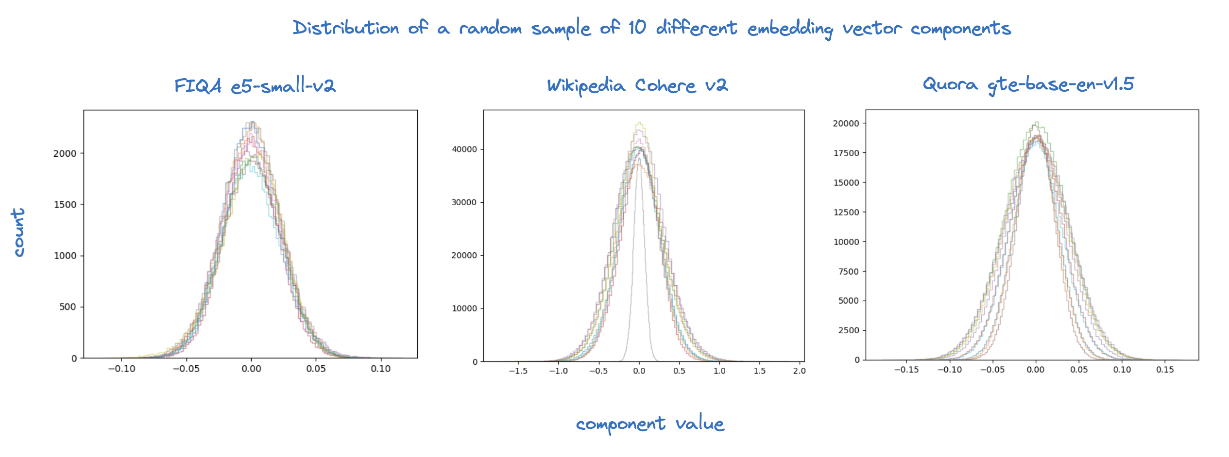

The distribution of centered vectors
So far we’ve shown that we can use a different bit count and a different quantization interval per vector. We next show how to exploit this to significantly improve the accuracy of scalar quantization. We propose an effective criterion and procedure for optimizing the choice of the constants aa and bb. However, before discussing this it is useful to see some examples of the component distribution in real centered embedding vectors.
We observe that the values are all fairly normally distributed and will use this observation to choose our initial quantization interval.
Looking at these plots one might guess it would be beneficial to scale components. Specifically, it seems natural to standardize the component distributions of the Cohere v2 and the gte-base-en-v1.5 embeddings. In general, this would amount to applying a scaling matrix to the document vectors before quantization as follows

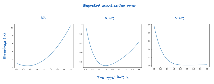

Initializing the quantization interval in scalar quantization
Optimizing this function numerically for various choices of nn gives the following quantization intervals
[a(1),b(1)]=[0.798,0.798][a(2),b(2)]=[1.493,1.493][a(3),b(3)]=[2.051,2.051][a(4),b(4)]=[2.514,2.514][a(7),b(7)]=[3.611,3.611]\begin{align*} \left[a_{(1)}, b_{(1)}\right] &= [-0.798, 0.798] \\ \left[a_{(2)}, b_{(2)}\right] &= [-1.493, 1.493] \\ \left[a_{(3)}, b_{(3)}\right] &= [-2.051, 2.051] \\ \left[a_{(4)}, b_{(4)}\right] &= [-2.514, 2.514] \\ \left[a_{(7)}, b_{(7)}\right] &= [-3.611, 3.611] \\ \end{align*}

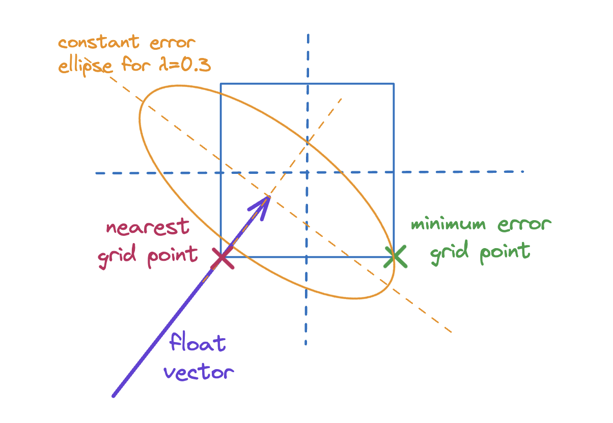

Error(a,b  |  λ)=(xˉ(a,b)x)t(xxtx2+λ(Ixxtx2))(xˉ(a,b)x)Error \left(a, b\; \middle| \; \lambda \right) = \left(\bar{x}(a,b) - x\right)^t \left( \frac{x x^t}{\|x\|^2} + \lambda \left(I-\frac{x x^t}{\|x\|^2}\right)\right) \left(\bar{x}(a,b) - x\right)
Here, we’ve made the dependence of this expression on the quantization interval explicit.
So far we’ve proposed a natural quantity to minimize in order to reduce the impact of quantization on MIP recall. We now turn our attention to how to efficiently minimize this quantity with respect to the interval [a,b][a,b].
There is a complication because the assignment of components of the vector to grid points depends on aa and bb while the optimal choice for aa and bb depends on this assignment. We use a coordinate descent approach, which alternates between computing the quantized vector x^\hat{x} while holding aa and bb fixed, and optimizing the quantization interval while holding x^\hat{x} fixed. This is described schematically as follows.
1     \;\; a0,b0max(mx+a(n)σx,xmin),min(mx+b(n)σx,xmax)a_0,b_0 \leftarrow \max\left(m_x+a_{(n)}\sigma_x, x_{min}\right), \min\left(m_x+b_{(n)}\sigma_x, x_{max}\right) 2     \;\; for k{1,2,...,rounds}k \in \{1,2,...,rounds\} do 3         \;\;\;\; compute x^(k)\hat{x}_{(k)} from ak1a_{k-1} and bk1b_{k-1} 4         \;\;\;\; ak,bkargmina,b  Error(a,b  |  λ,x^(k))a_k,b_k \leftarrow arg\min_{a,b}\; Error\left(a,b\; \middle| \; \lambda, \hat{x}_{(k)} \right) 5         \;\;\;\; if Error(ak,bk  |  λ,x^(k))>Error(ak1,bk1  |  λ,x^(k1))Error\left(a_k,b_k\; \middle| \; \lambda, \hat{x}_{(k)} \right) > Error\left(a_{k-1},b_{k-1}\; \middle| \; \lambda, \hat{x}_{(k-1)} \right) then break
First we’ll focus on line 3. The simplest approach to compute x^\hat{x} uses standard scalar quantization
x^(k),i=round(2n1bk1ak1(clamp(xi,ak1,bk1)ak1))\hat{x}_{(k), i} = \text{round}\left(\frac{2^n-1}{b_{k-1}-a_{k-1}} \left(\text{clamp}(x_i, a_{k-1}, b_{k-1}) - a_{k-1}\right)\right)
Specifically, this would amount to snapping each component of xx to the nearest grid point. In practice this does not minimize Error(a,b  |  λ)Error\left(a,b\; \middle| \; \lambda\right) as we illustrate below.
Refining the quantization interval - Optimized scalar quantization
Unfortunately, we can’t just enumerate grid points and find the minimum error one since there are 2nd2^{nd} candidates; therefore, we tried the following heuristic:
  1. Snap to the nearest grid point,
  2. Coordinate-wise check if rounding in the other direction reduces the error.
This isn’t guaranteed to find the global optimum, which in fact isn’t guaranteed to be one of the corners of the grid square containing the floating point vector. However, in practice we found it meant the error almost never increased in an iteration of the loop over kk. By contrast, when snapping to the nearest grid point the loop frequently exits due to this condition.
The heuristic yields a small but systematic improvement in the brute force recall. On average it amounted to +0.3% compared to just snapping to the nearest grid point. Given the impact is so small we decided it wasn’t worth the extra complexity and increased runtime.

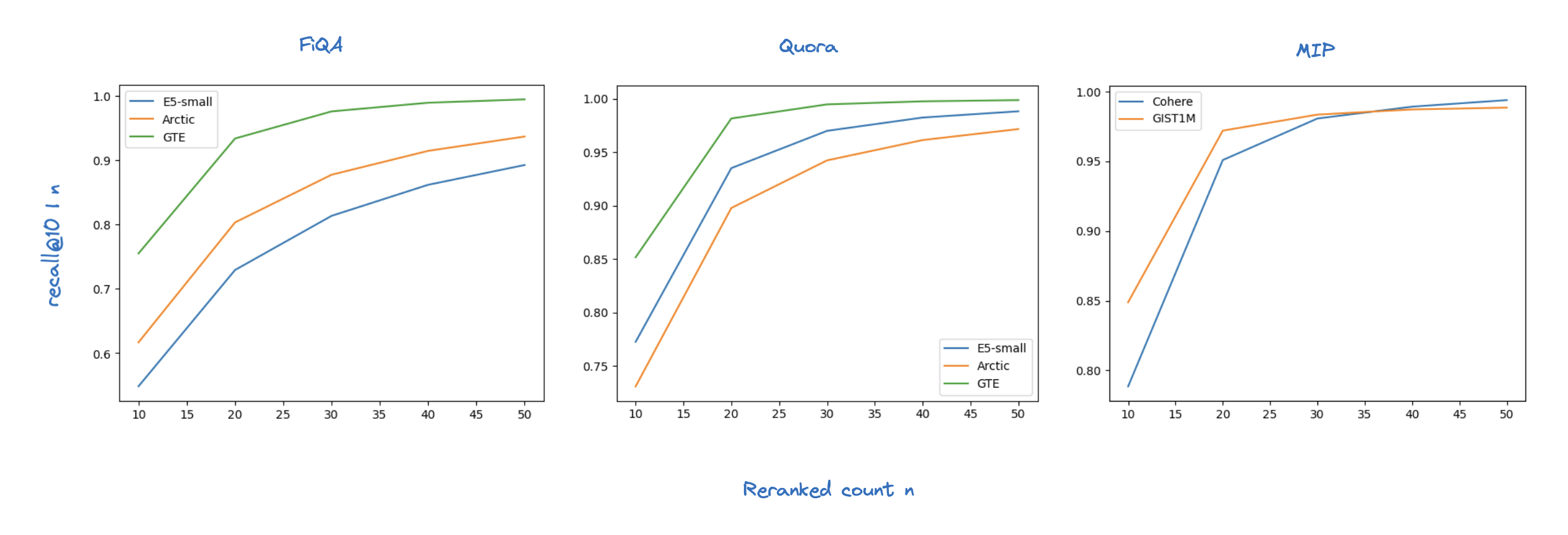

First off we study 1 bit quantization. We report brute force recall in these experiments to take any effects of the indexing choice out of the picture. As such we do not compare recall vs latency curves, which are very strongly affected by both the indexing data structure and the dot product implementation. Instead we focus on the recall at 10 reranking the top n hits. In our next blog we’ll study how OSQ behaves when it is integrated with Lucene's HNSW index implementation and turn our attention to query latency. The figures below show our brute force recall@10n10|n for n{10,20,30,40,50}n\in\{10,20,30,40,50\}.
How does it perform? Scalar quantization
Rolling these up into the average recall@10n10|n for the 8 retrieval experiments we tested we get the table below.

Compared to the baseline we gain 2% on average in recall. As for the ablation study, compared to using a global quantization interval we gain 26% and compared to our initial per vector quantization intervals we gain 10%.

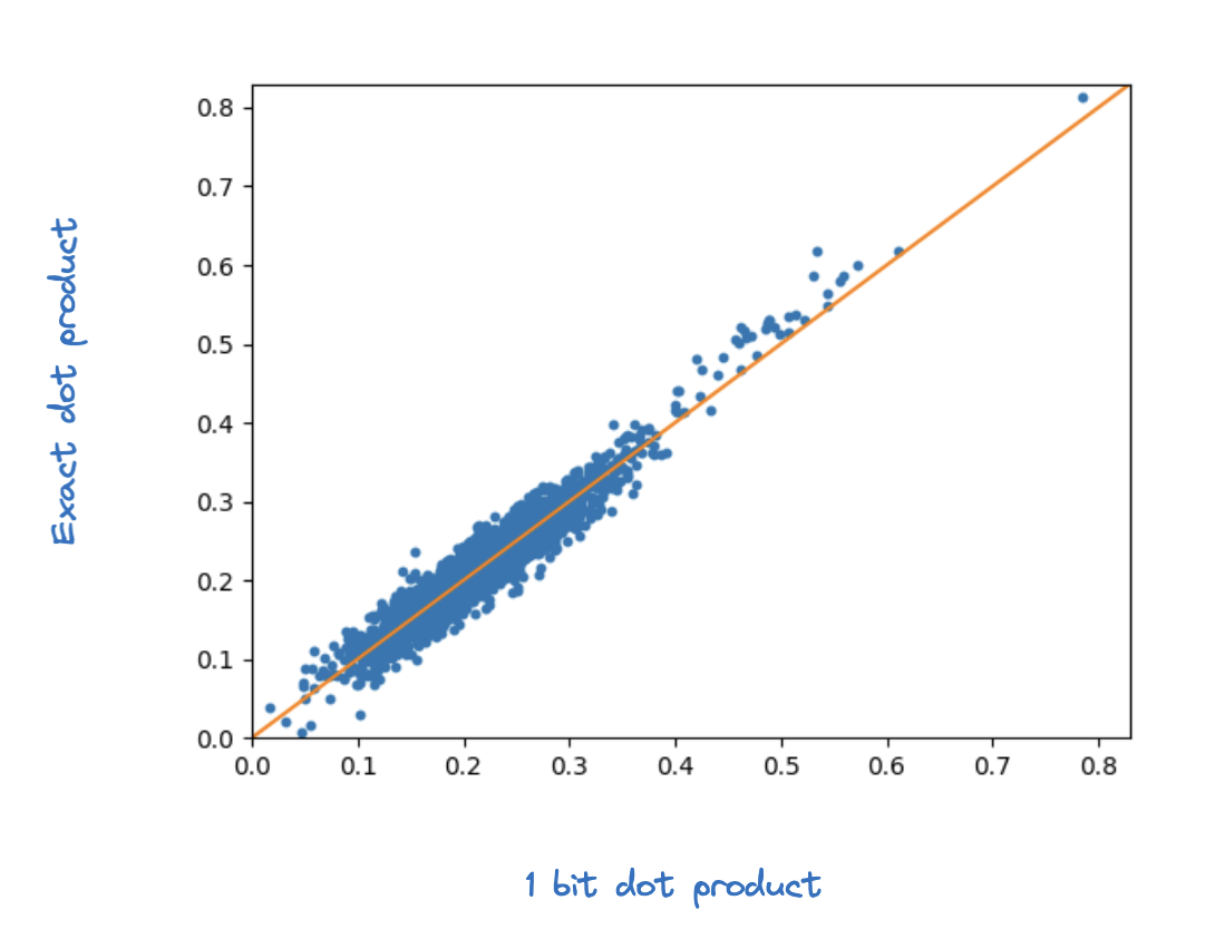

The figure below shows the floating point dot product values versus the corresponding 1 bit quantized dot product values for a sample of 2000 gte-base-en-v1.5 embeddings. Visually the correlation is high.
1 bit dot product - optimized scalar quantization
We can quantify this by computing the R2R^2 between the floating point and quantized dot products. For each dataset and model combination we computed the average R2R^2 for every query against the full corpus. We see small but systematic improvement in R2R^2 comparing OSQ to the baseline. The table below shows the R2R^2 values broken down by the dataset and model combinations we tested.
Dataset
Model
Baseline R2
OSQ R2
FiQA
e5-small
0.849
0.865
FiQA
arctic
0.850
0.863
FiQA
gte
0.925
0.930
Quora
e5-small
0.868
0.881
Quora
arctic
0.817
0.838
Quora
gte
0.887
0.897
Wiki
Cohere v2
0.884
0.898
GIST1M
0.953
0.974

10
0.74
0.84
20
0.90
0.97
30
0.94
0.99
40
0.96
0.995
50
0.97
0.997
Conclusion
We’ve presented an improved automatic scalar quantization scheme which allows us to achieve high recall with relatively modest reranking depth. Avoiding deep reranking has significant system advantages.
For 1 bit quantization we compared it to a very strong baseline and showed it was able to achieve systematic improvements in both recall and the accuracy with which it approximates the floating point vector distance calculation. Therefore, we feel comfortable saying that it sets new state-of-the-art performance for at 32×\times compression of the raw vectors.
It also allows one to simply trade compression for retrieval quality using the same underlying approach and achieves significant performance improvements compared to standard scalar quantization techniques.
We are working on integrating this new approach into Elasticsearch. In our next blog we will discuss how it is able to enhance the performance of our existing BBQ scalar quantization index formats.
