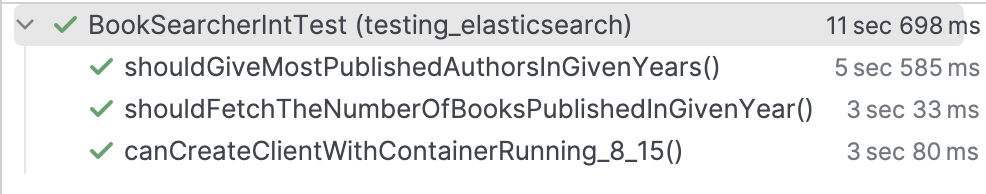

It's also worth noting that in the demo project (branch data-init), which currently has only three integration tests, roughly half of the total duration is spent on container startup. After the initial warm-up, individual tests take about 3 seconds each. Consequently, adding three more tests won't double the overall time to another 30 seconds, but will only increase it by roughly 9-10 seconds. The test execution times, including data initialization, can be observed in the IDE:

  • Integration tests can run faster without changing the tests themselves — just by rethinking data initialization and container lifecycle management.
  • Elasticsearch should be started only once, rather than for every test.
  • Data initialization is most efficient when the data is as close to Elasticsearch as possible and transmitted efficiently.
  • Although reducing the test dataset size is an obvious optimization (and not covered here), it's sometimes impractical. Therefore, we focused on demonstrating technical methods instead.
Overall, we significantly reduced the test suite's duration — from 5.5 minutes to around 30 seconds — lowering costs and speeding up the feedback loop.
