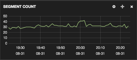

If you see INFO level log messages saying now throttling indexing or you see segment counts growing and growing in Marvel then you know merges are falling behind. Marvel plots the segment count under the MANAGEMENT EXTENDED section of the Index Statistics dashboard, and it should grow at a very slow logarithmic rate, perhaps showing a saw-tooth pattern as large merges complete:

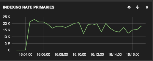

If you do have your own ids, try to pick one that is fast for Lucene if that is under your control, and upgrade to at least 1.3.2 since there were further optimizations to id lookup. Just remember that java's UUID.randomUUID() is the worst choice for an id because it has no predictability or pattern on how ids are assigned to segments, causing a seek per segment in the worst case.
You can see the difference in indexing rate as reported by Marvel when using Flake IDs:
versus using fully random UUIDs:
