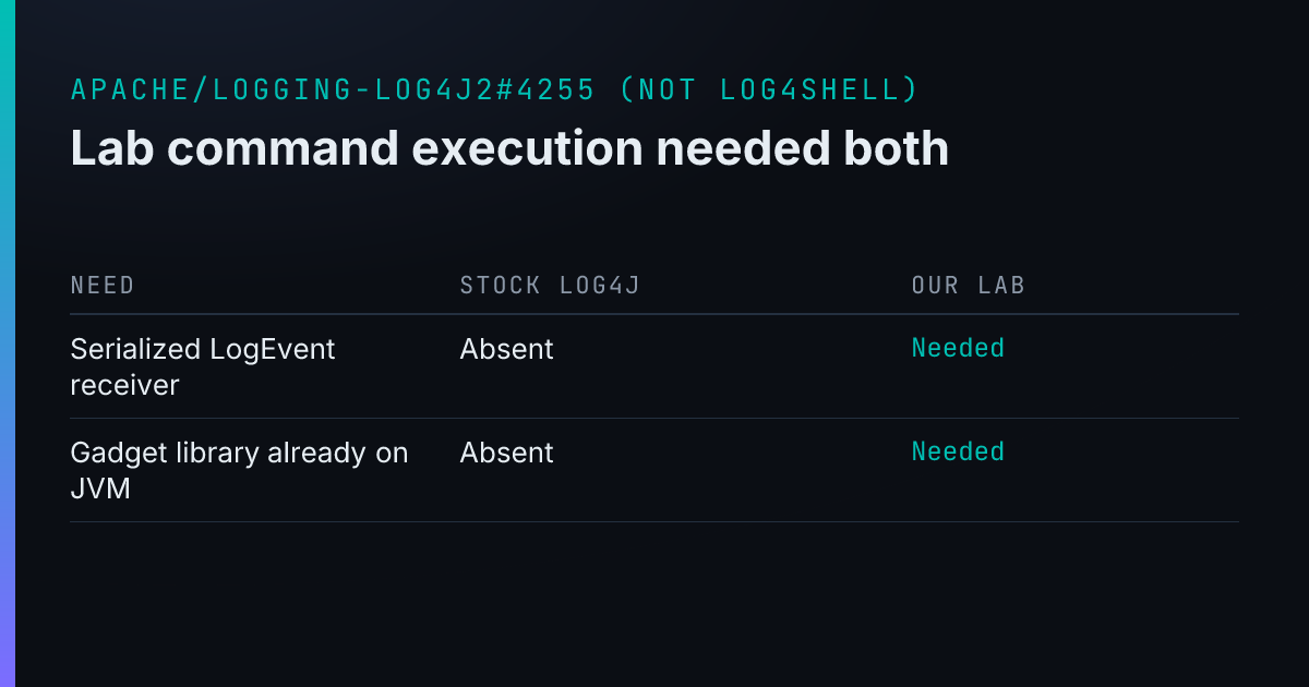

  • A class that FilteredObjectInputStream rejects on the outer stream executed once it was carried inside MarshalledObject on a serialized Log4jLogEvent.
  • Command execution in that lab required both a Java-serialized LogEvent receiver and a gadget library already on the victim JVM. log4j-api and log4j-core alone were not enough.
  • Installing a JEP 290 ObjectInputFilter on the same FOIS instance rejected the payload we had used. Before that call, the stream filter was null.
Table showing Log4j deserialization command execution needed a serialized LogEvent receiver and a gadget library

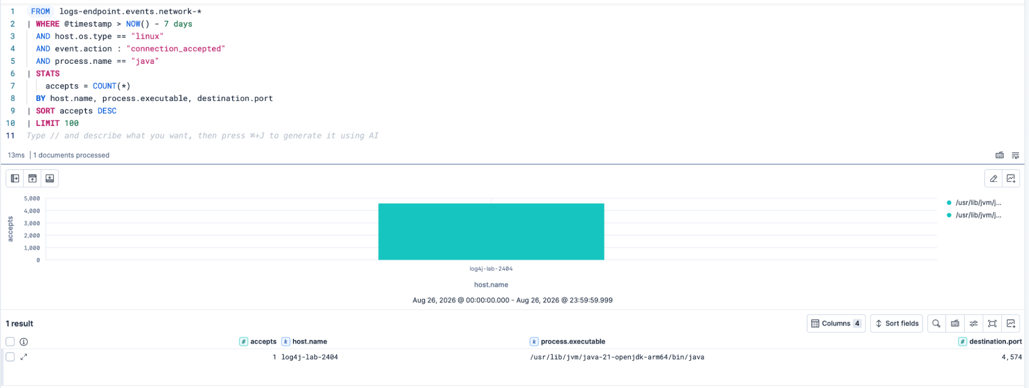

Hunting for leftover serialized LogEvent collectors
Goal: find JVMs that accept TCP connections, especially on hosts that are not supposed to be log-event hubs.
Persistence Through Reverse/Bind Shells ships Osquery for listening_ports, process_open_sockets, and processes. Use it as an inventory pass, then filter to java.
Keep private addresses. Example ES|QL (Linux Elastic Defend network events, last 7 days):
FROM logs-endpoint.events.network-*
| WHERE @timestamp > NOW() - 7 days
  AND host.os.type == "linux"
  AND event.action : "connection_accepted"
  AND process.name == "java"
| STATS
    accepts = COUNT(*)
  BY host.name, process.executable, destination.port
| SORT accepts DESC
| LIMIT 100
Triage: is this Tomcat/JBoss on 8080/8443, or an unexplained listen? SocketAppender's historical default TCP port is 4560. That port is a hint to look, not proof of Java serialization (JSON/XML layouts also used sockets). Command lines worth pulling out of the same data:

Kibana ES|QL hunting query for java connection_accepted network events grouped by host and destination.port

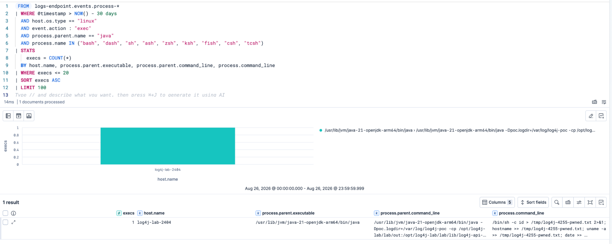

Hunting for java-spawned shells without a JNDI precursor
Goal: Detect gadget-style executions.
FROM logs-endpoint.events.process-*
| WHERE @timestamp > NOW() - 30 days
  AND event.action : "exec"
  AND process.parent.name == "java"
  AND (
    process.name IN (
      "bash", "dash", "sh", "ash", "zsh", "ksh", "fish", "csh", "tcsh", "mksh", "busybox",
      "curl", "wget", "perl*", "python*", "ruby*", "php*", "lua*", "socat",
      "nc", "ncat", "netcat", "netcat.openbsd", "netcat.traditional", "nc.openbsd",
      "nc.traditional", "nohup", "setsid", "disown", "hostname", "whoami", "id"
    ) OR
    process.name LIKE "python*" OR
    process.name LIKE "perl*" OR
    process.name LIKE "ruby*" OR
    process.name LIKE "lua*" OR
    process.name LIKE "php*"
| STATS
    execs = COUNT(*)
  BY host.name, process.parent.executable, process.parent.command_line, process.command_line
| WHERE execs <= 20
| SORT execs ASC
| LIMIT 100
Kibana ES|QL query detecting a java parent process spawning /bin/sh during Log4j deserialization exploitation
Pivot each hit to network events using the parent.entity_id field. If you see connection_accepted on an unexpected port (389, 1389, 1099, 53, 5353) and no outbound destination.port in the same minute, it is not the JNDI sequence. Investigate the JVM classpath for deserialization gadgets and whether that process reads an ObjectInputStream.
