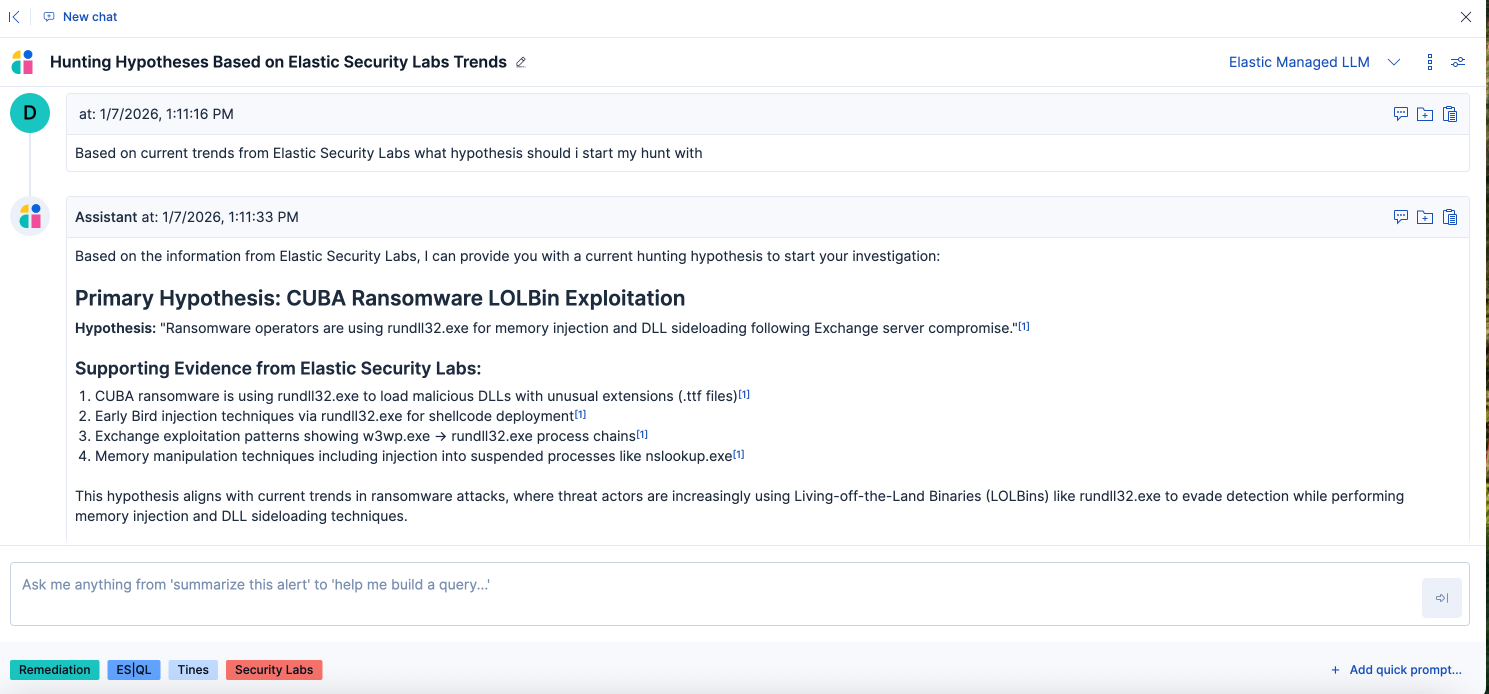

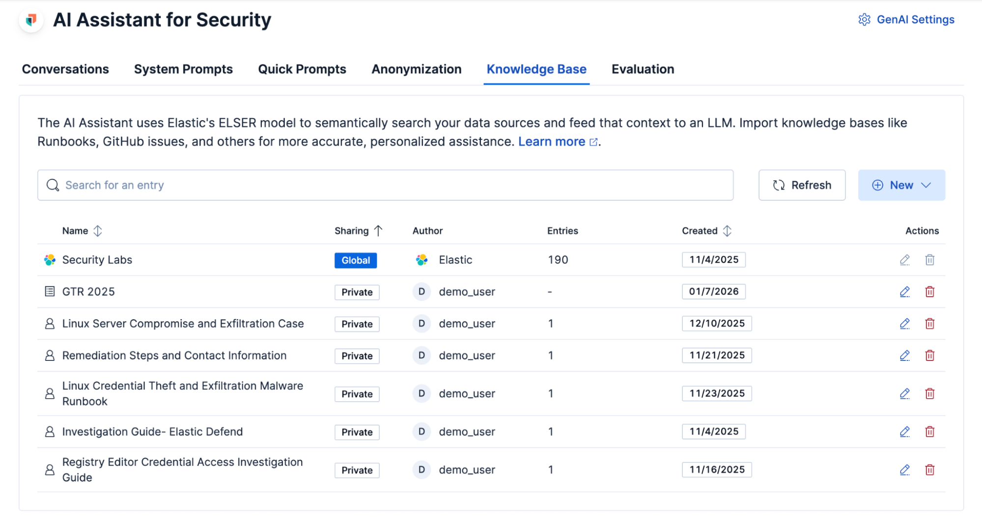

Your investigation can begin even before writing a single query. You can use Elastic’s retrieval-augmented generation (RAG)–powered AI Assistant to pull in trusted knowledge sources, such as Elastic Security Labs research, and build the foundation of your hypothesis. You can add any trusted sources as knowledge to ensure the Assistant reflects the data you rely on.
Elastic AI Assistant knowledge base entries
If you don’t have a specific target yet, you can ask the Assistant,
“Based on current trends, what hypothesis should I start my hunt with today?” The Assistant scans the configured knowledge base, which provides relevant context and directly generates a primary hypothesis along with supporting reasons and evidence. In this scenario, Elastic Security Labs content has been added to the knowledge base to supply the context.

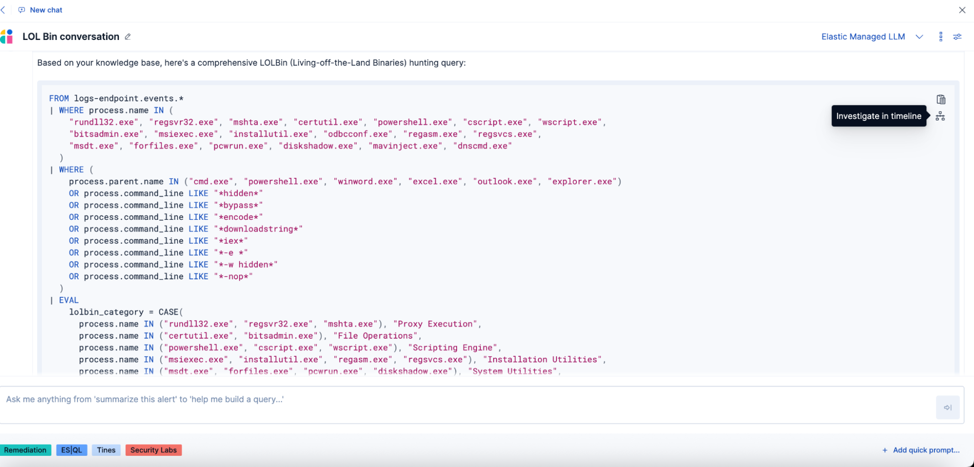

Sit back while AI Assistant creates your tailored threat hunting query

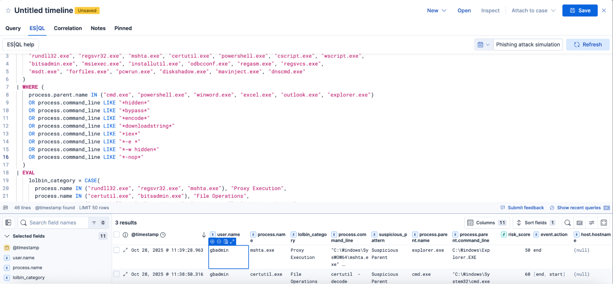

Once you accept the LOLBin hypothesis, the AI Assistant generates a precise ES|QL threat hunting query tailored to your environment. Instead of writing complex syntax from scratch, you receive a targeted search designed to surface the specific suspicious behaviors.
Elastic AI Assistant-generated ES|QL query to detect Office/Server spawned LOLBins with suspicious patterns
To ensure queries are ready to run, the Elastic AI Assistant uses an agentic workflow to generate bespoke ES|QL queries from human-supplied use cases. It draws on your Elastic cluster data to craft accurate, ready-to-run responses and performs automatic validation before returning the final query. This background validation removes the need for manual troubleshooting, delivering a verified, ready-to-use query that can be pulled directly into your investigation timeline from the AI Assistant.
Elastic Security Timeline with ES|QL pulled over from the AI-assistant

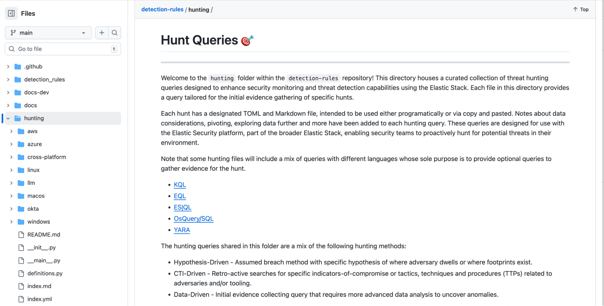

Alternatively, you can link a GitHub repository of Elastic’s threat hunting queries to the Assistant’s knowledge base to use existing queries as a baseline for your next steps.
Threat hunt queries section within Elastic’s pre-built detection rules GitHub repository

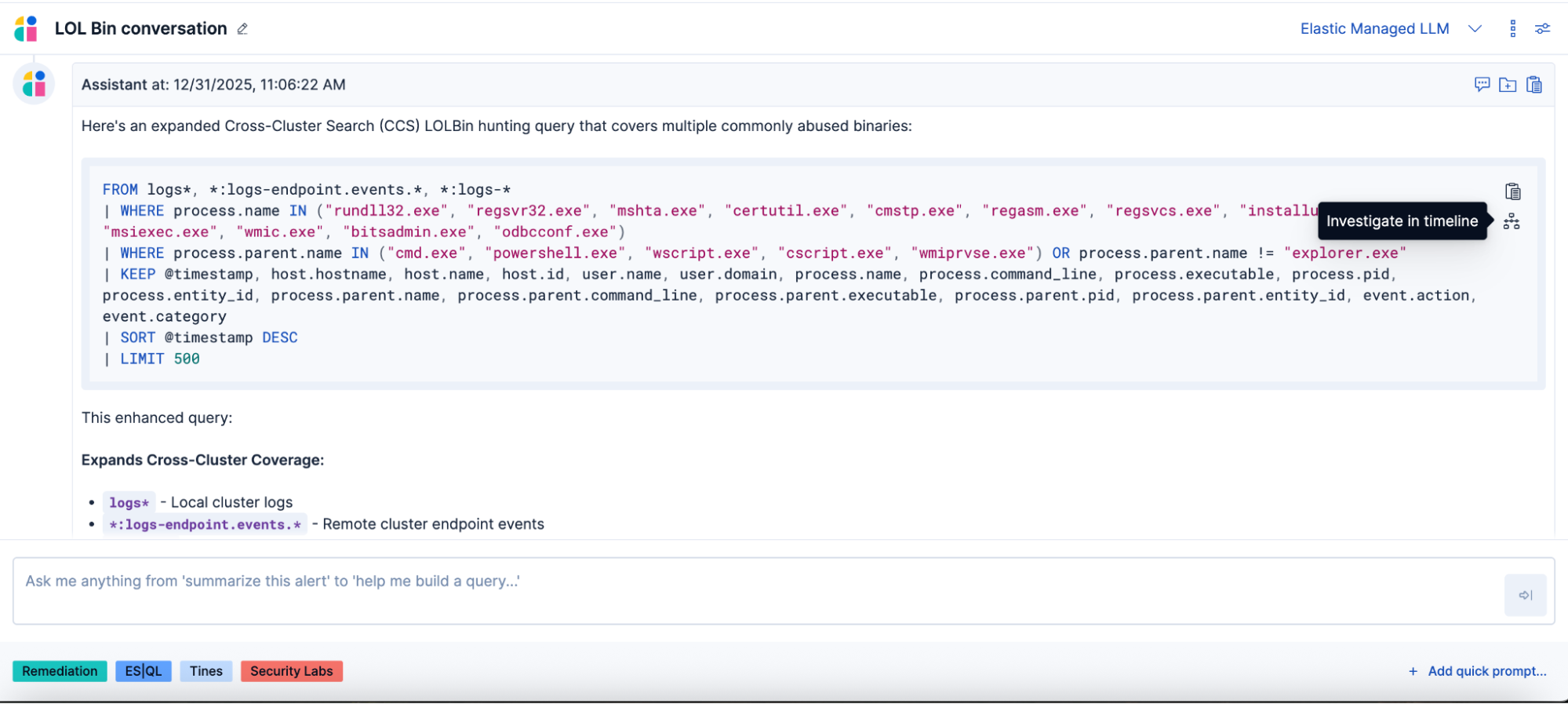

If you manage a global environment and need to determine whether this activity is occurring in other clusters, you can expand your hypothesis by asking the AI Assistant to adapt the query for a Cross-Cluster Search (CCS). This enables you to search across multiple clusters in your environment—including frozen and long-term data—without disrupting your investigative workflow.
Updated ES|QL query using cross-cluster search to show Office/Server spawned LOLBins with suspicious patterns in both local and remote clusters

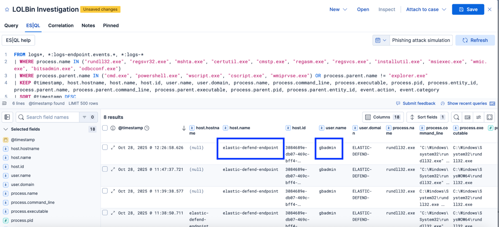

Seamlessly transition from the AI Assistant to the timeline view and run the query. This targeted search uncovers a critical finding: an instance of rundll32.exe executing on a Windows server with hostname elastic-defend-endpoint under the gbadmin user account*.*
LOLBin Investigation Timeline results

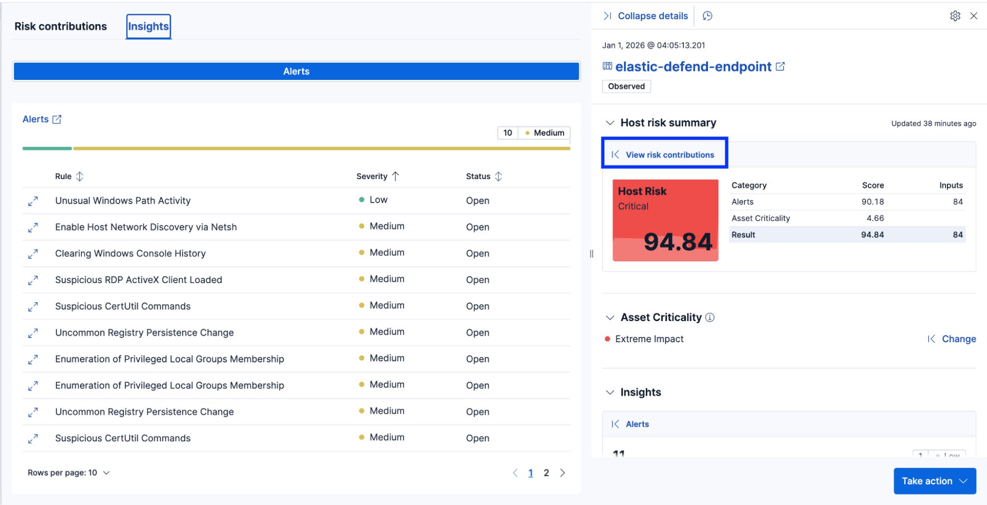

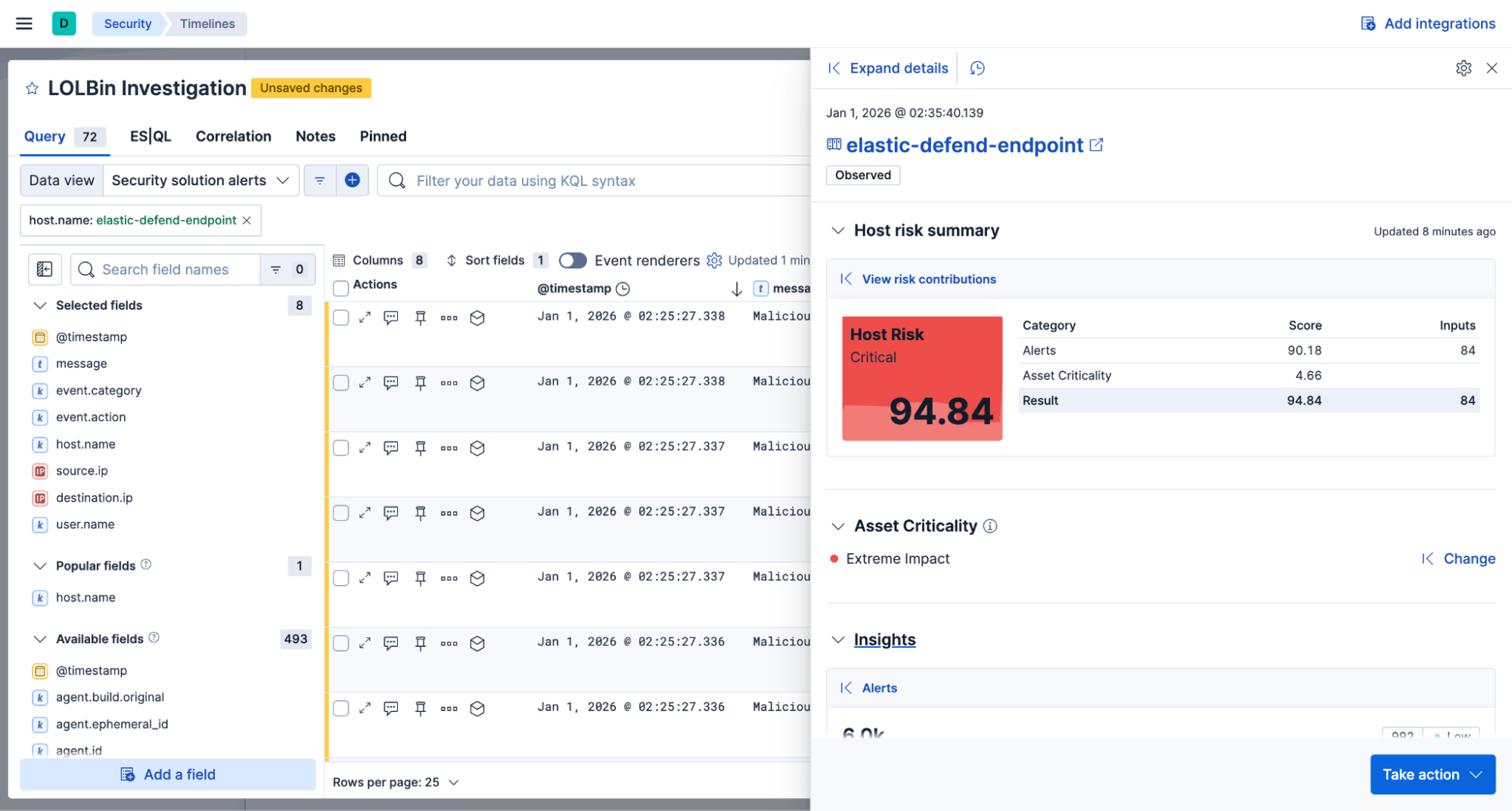

Finding a hit is only step one; now, you must determine if this is an admin performing maintenance or an actual attack. Validating your ideas requires deep analytics across hosts and users. By drilling down into the affected host, you land in the Entity Details.
Host Entity flyout

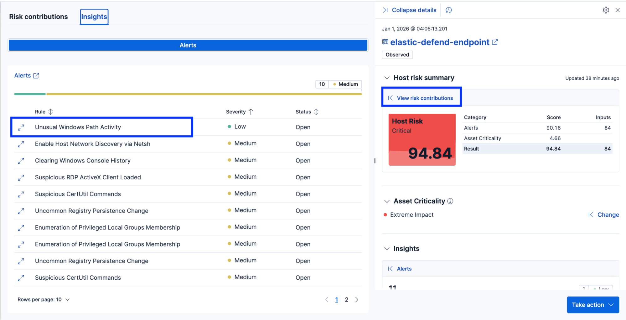

Here, you’re not just seeing a hostname. You’re seeing a consolidated view of the host’s risk score, the specific alerts contributing to that score, and the asset’s criticality—all in one place. By bringing together detection signals, behavioral anomalies, and asset importance, Elastic’s entity risk scoring helps analysts quickly understand why an asset is risky, how urgent the threat is, and where to focus first. This unified context reduces investigation time, minimizes guesswork, and enables confident prioritization in high-volume environments.
Entity details, risk score, and associated alerts for the affected host

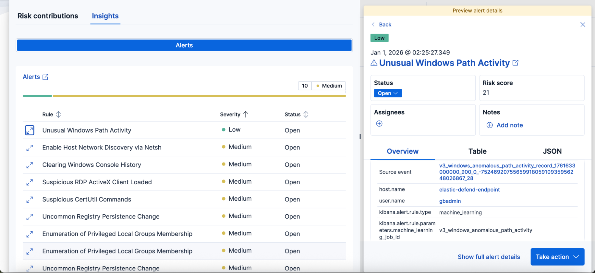

When you examine the risk score, the supporting evidence is displayed alongside it. You can see the specific alerts contributing to the elevated risk score, including a mix of medium-severity alerts and a Machine Learning (ML) alert such as “Unusual Windows Path Activity”.
Machine learning anomaly alert
Because ML is uniquely suited to detecting subtle deviations that static rules often miss, seeing an ML alert contributing to the risk score helps validate that this activity isn’t just noise—it points to a meaningful behavioral anomaly.
‘Unusual Windows Path Activity’ alert flyout

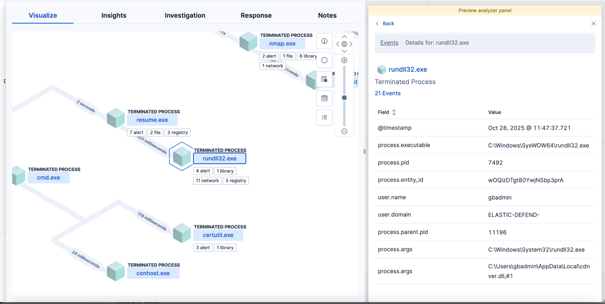

The event details immediately visualize the process lineage, revealing the critical evidence right in the panel. These insights transform your hypothesis from plausible to provable.
Visual event analyzer with rundll32.exe flyout

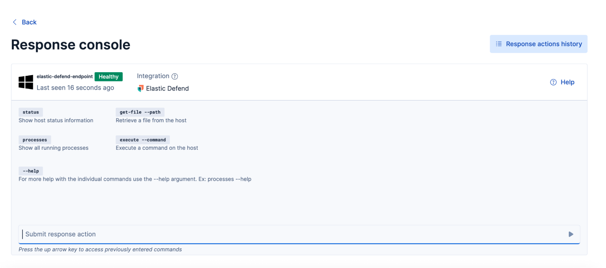

After validating your hypothesis by uncovering suspicious activity, the immediate next step is response. Elastic Security lets responders act directly from their investigations without switching platforms.
Once a compromised host is confirmed, you can take action from the console by isolating the host to prevent lateral movement or terminating the malicious process tree uncovered in your LOLBIN hunt. This seamless transition from investigation to response enables rapid containment using the same tools and context.
Response console for isolated host, elastic-defend-endpoint

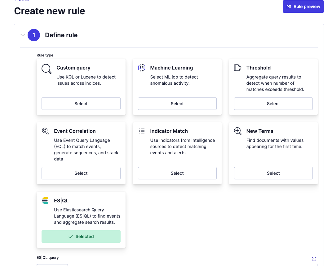

To automate future hunts and eliminate manual verification of recurring patterns, you can directly import a query into an operational detection rule, or create a rule for specific behaviors, anomalies, or new term values appearing for the first time, and convert it into a fully operational detection rule with a single click.
Detection rule creation with ES|QL in Elastic Security

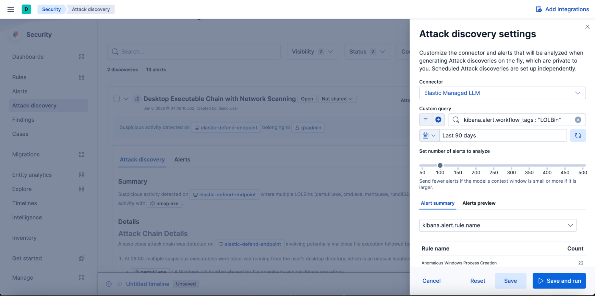

In enterprise environments, a LOLBin hunt can quickly generate a high volume of alerts. This is where agentic Attack Discovery makes a big difference. Its primary purpose is to help you triage efficiently by automatically correlating signals and highlighting the activity that requires immediate attention.
You can also group and tag hunting-related alerts and run Attack Discovery specifically on those sets to uncover meaningful patterns. This flexibility makes Attack Discovery valuable not only for automated alert triage, but also for advanced, hypothesis-driven threat hunting workflows.
Running Attack Discovery on a curated group of LOLBin hunting alerts
