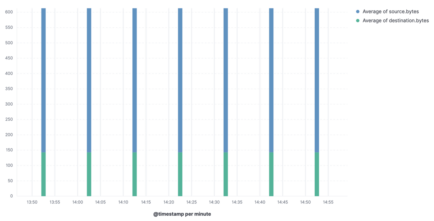

Below is an example of a Koadic C2 beacon, which serves the malicious payload using the DLL host process. As you can see, the payload beacons consistently at an interval of 10 minutes, and the source, as well as destination packet sizes, are almost identical.
Example of a Koadic C2 beacon
It might seem like a trivial task to catch C2 beaconing if all beacons were as neatly structured and predictable as the above. All one would have to look for is periodicity and consistency in packet sizes. However, malware these days is not as straightforward.

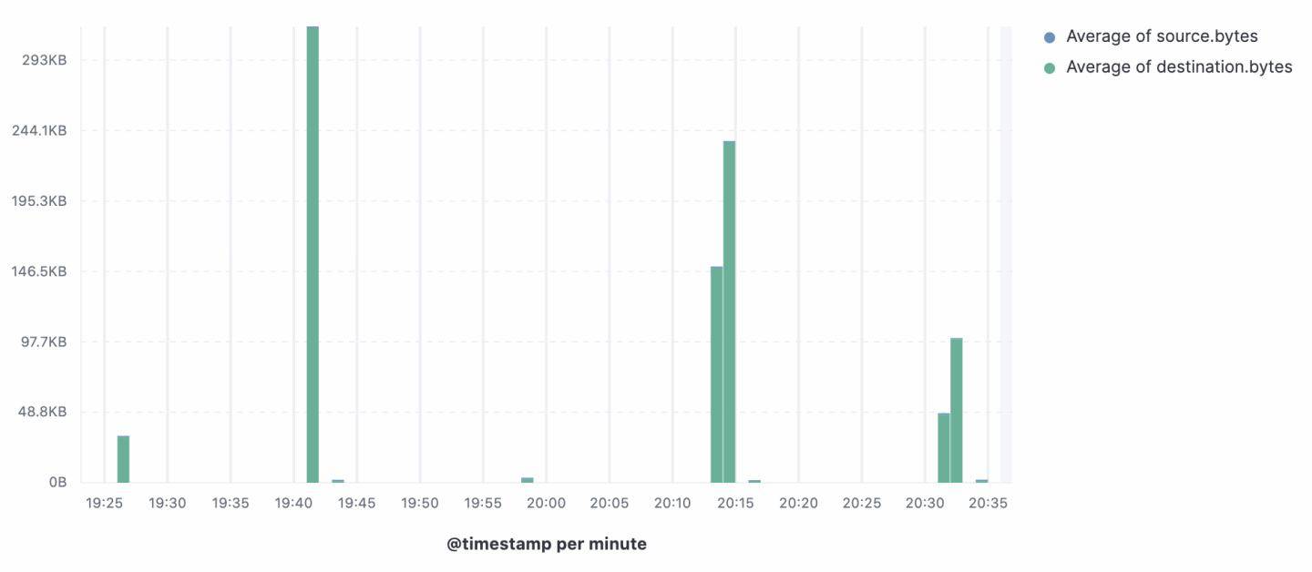

Example of an Emotet beacon
Most sophisticated malware nowadays adds a "jitter" or randomness to the beacon interval, making the signal more difficult to detect. Some malware authors also use longer beacon intervals. The beaconing identification framework we propose accounts for some of these elusive modifications to traditional beaconing behavior.

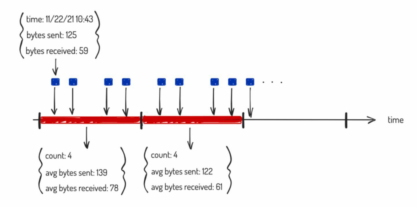

Driven by the need to scale, we chose to detect beaconing by bucketing the data in the time window to be analyzed. We gather the event count and average bytes sent and received in each bucket. These statistics can be computed in MapReduce fashion and values from different shards can be combined at the coordinating node of an Elasticsearch query.
Furthermore, by controlling the ratio between the bucket and window lengths, the data we pass per running process has predictable memory consumption, which is important for system stability. The whole process is illustrated diagrammatically below:
Bucketing data for analysis

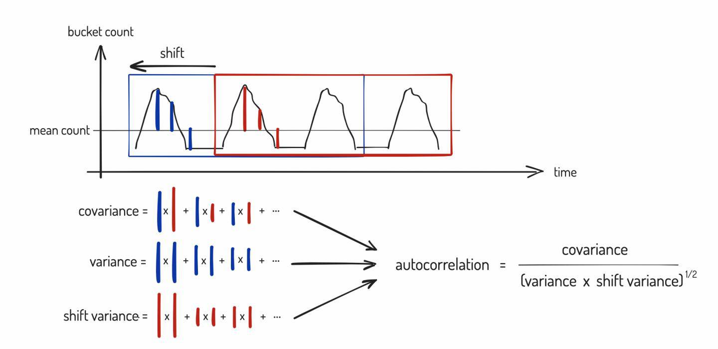

Autocorrelation is a useful statistic for understanding when a time series repeats itself. The basic idea behind autocorrelation is to compare the time series values to themselves after shifting them in time. Specifically, it is the covariance between the two sets of values (which is larger when they are more similar), normalized by dividing it by the square root of the variances of the two sets, which measures how much the values vary among themselves.
This process is illustrated schematically below. We apply this to the time series comprising the bucket counts: if the signal is periodic then the time bucketed counts must also repeat themselves. The nice thing about autocorrelation from our perspective is that it is capable of detecting any periodic pattern. For example, the events don’t need to be regularly spaced but might repeat like two events occurring close to one another in time, followed by a long gap and so on.
We don’t know the shift beforehand that will maximize the similarity between the two sets of values, so we search over all shifts for the maximum. This, in effect, is the period of the data — the closer its autocorrelation is to one, the closer the time series is to being truly periodic. We threshold the autocorrelation close to one to test for low frequency beacons.
Finally, we noted that most beaconing malware these days incorporates jitter. How does autocorrelation deal with this? Well first off, autocorrelation isn’t a binary measure — it is a sliding scale: the closer the value is to 1 the more similar the two sets of values are to one another. Even if they are not identical but similar it can still be close to one. In fact, we can do better than this by modelling how random jitter affects autocorrelation and undoing its effect. Provided the jitter isn’t too large, the process to do this turns out to be about as complex as just finding the maximum autocorrelation.

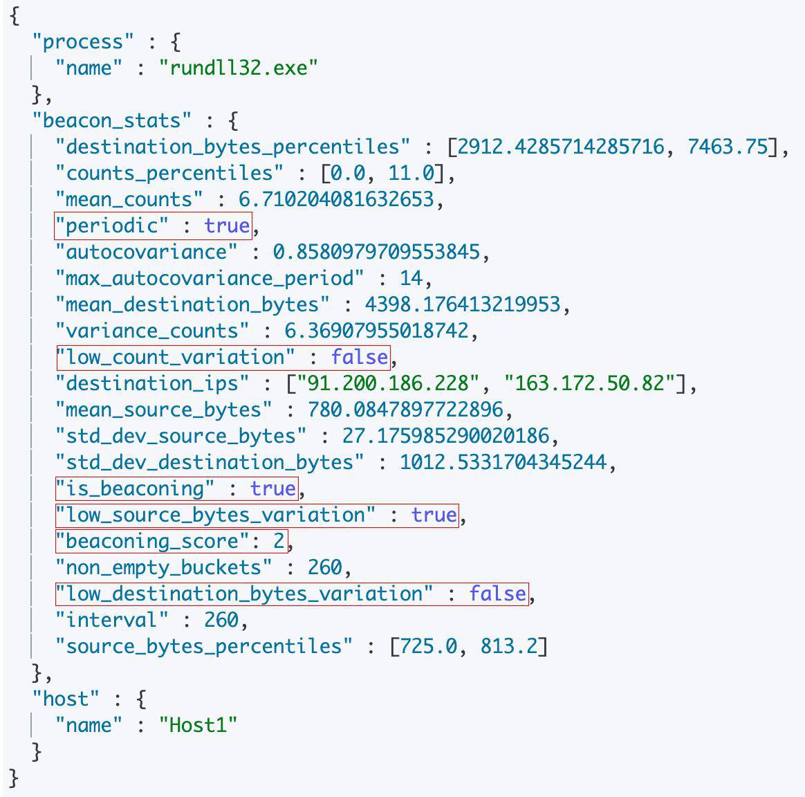

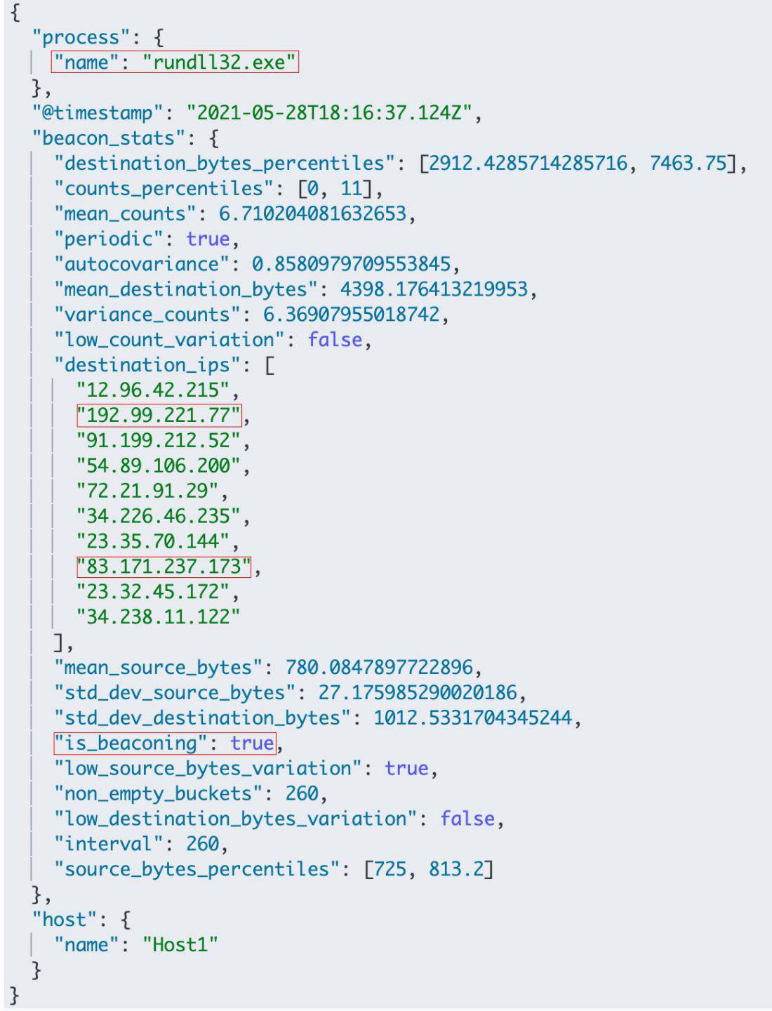

Sample document produced by the beaconing transform
As you can see, the document contains valuable beaconing-related information about the process. First off, the beacon_stats.is_beaconing indicator says whether or not we found the process to be beaconing. If it is, as in the case above, the document will also contain important metadata, such as the frequency of the beacon. The indicator beacon_stats.periodic says whether or not the signal is a low-frequency beacon, while the indicator beacon_stats.low_count_variation indicates whether or not it is a high-frequency beacon.
Furthermore, the indicators beacon_stats.low_source_bytes_variation and low_destination_bytes_variation indicate whether or not the source and destination bytes sent during the beaconing communication were more or less uniform. Finally, you will also notice the beaconing_score indicator, which is a value from 1-3, representing the number of beaconing tests satisfied by the process for that time period.
Writing such metadata out to an index also means that you can search for different facets of beaconing software in your environment. For example, if you want to search for low frequency beaconing processes in your environment, you would query for documents where the beacon_stats.periodic indicator is true and beacon_stats.low_count_variation is false. You can also build second order analytics on top of the indexed data, such as using anomaly detection to find rare beaconing processes, or using a significant terms aggregation to detect lateral movement of beaconing malware in your environment.

Beaconing metadata for NOBELIUM
For NOBELIUM, the beaconing transform catches the offending process, rundll32.exe, as well as the two destination IPs, 192.99.221.77 and 83.171.237.173, which were among the main IoCs for NOBELIUM.
For Koadic and Emotet as well, the transform was able to flag the process as well as the known destination IPs on which the test C2 listeners were running. The characteristics of each of the beacons were different. For example, Koadic was a straightforward, high-frequency beacon that satisfied all the beaconing criteria being checked in the transform i.e. periodicity, as well as low variation of source and destination bytes. Emotet was slightly trickier since it was a low frequency beacon with a high jitter percentage. But we were able to detect it due to the low variation in the source bytes of the beacon.

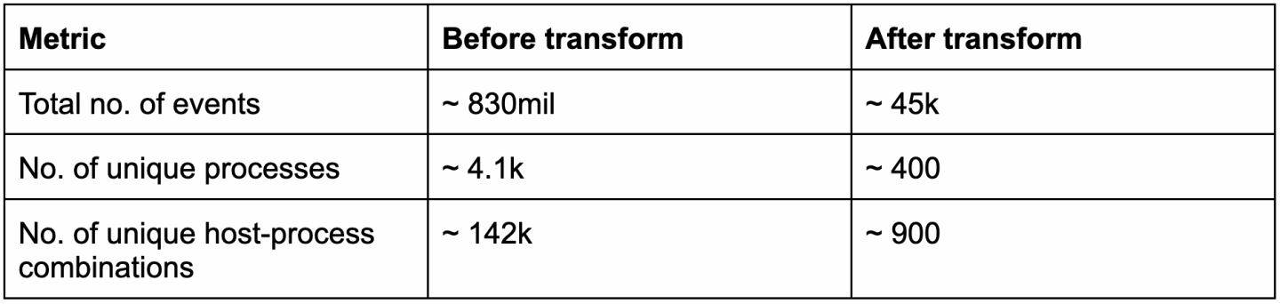

To test the amount of reduction in search space, we ran the transform over three weeks on an internal cluster that was receiving network event logs from ~ 2k hosts during the testing period. We measured the reduction in search space based on the number of network event log messages, processes, and hosts an analyst or threat hunter would have to sift through before and after running the transform, in order to identify malicious beacons. The numbers are as follows:
Search space reduction metrics as a result of the beaconing transform
While the reduction in search space is obvious, another point to note is the scale of data that the transforms are able to churn through comfortably, which becomes an important aspect to consider, especially in production environments. Additionally, we have also released dashboards (available in the release package), which track metrics like prevalence of the beaconing processes, etc. that can help make informed decisions about further filtering of the search space.

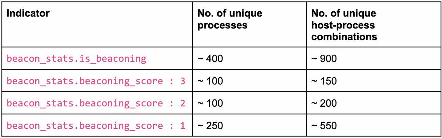

While the released dashboards, and the statistics in the above table are based on cases where the beacon_stats.is_beaconing indicator is true i.e. beacons that satisfy either of the beaconing tests, threat hunters may want to further streamline their search by starting with the most obvious beaconing-like cases and then moving on to the less obvious ones. This can be done by filtering and searching by the beacon_stats.beaconing_score indicator instead of beacon_stats.is_beaconing, where a score of 3 indicates a typical beacon (satisfying tests for periodicity as well as low variation in packet bytes), and score of 1 indicates a less obvious beacon (satisfying only one of the three tests).
For reference, we observed the following on our internal cluster:
