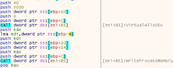

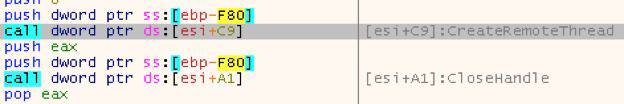

Shellcode injection is the most basic in-memory technique and has also been around the longest. The basic ‘recipe’ for shellcode injection is a four step process. These steps are: 1) open a target process (OpenProcess); 2) allocate a chunk of memory in the process (VirtualAllocEx); 3) write the shellcode payload to the newly allocated section (WriteProcessMemory); and 4) create a new thread in the remote process to execute the shellcode (CreateRemoteThread). The venerable Poison Ivy malware uses this technique, which is a big reason why so many APT groups were drawn to it over the years.
If you pull up a Poison Ivy samplewith x64dbg and set a breakpoint on VirtualAllocEx, you will soon locate the chunk of code responsible for the injection.
Shellcode Injection
Shellcode Injection

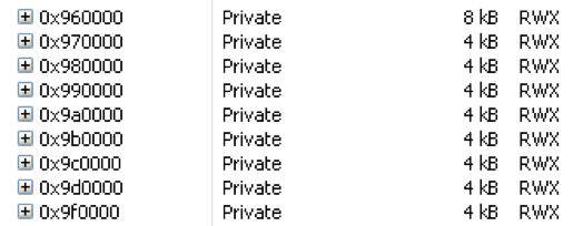

In the first image, the push 40 instruction preceding the call to VirtualAllocEx corresponds to page access protection value of PAGE_EXECUTE_READWRITE. In the following screenshot from ProcessHacker of the memory layout of a Poison Ivy implant, you can see it allocates a number of these RWX sections.
Poison Ivy Implant
Typical code sections are of type ‘Image’ and map to a file on disk. However, these are type ‘Private’ and do not map to a file on disk. They are therefore referred to as unbacked executable sections or floating code. Threads starting from these types of memory regions are anomalous and a good indicator of malicious activity. ProcessHacker can also show you the call stack of the malware threads. There are multiple functions in the call stack which do not map to memory associated with loaded modules.

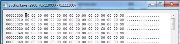

Reflective DLL injection, originally developed by Steven Fewer, is another type of in memory attacker technique. Metasploit’s Meterperter payload was one of the first attempts to fully weaponize the technique, but many malware families use it today. Reflective DLL injection works by creating a DLL that maps itself into memory when executed, instead of relying on the Window’s loader. The injection process is identical to shellcode injection, except the shellcode is replaced with a self-mapping DLL. The self-mapping component added to the DLL is responsible for resolving import addresses, fixing relocations, and calling the DllMain function. Attackers benefit from the ability to code in higher level languages like C/C++ instead of assembly.

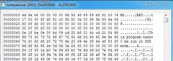

Classic reflective DLL injection, such as that used by Meterpreter, is easy for hunters to find. It leaves large RWX memory sections in the process, even when the meterpreter session is closed. The start of these unbacked executable memory sections contain the full MZ/PE header, as shown in the images below. However, keep in mind that other reflective DLL implementations could wipe the headers and fix the memory leak.
Unbacked executable memory sections

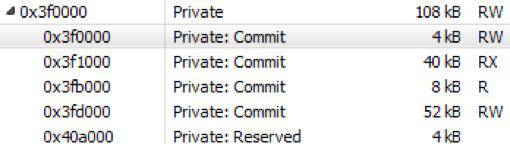

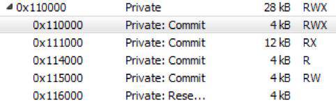

NetTraveler is one malware family that uses a memory module style technique. When NetTraveler starts, it unpacks the core functionality and maps it into memory. The page permissions more closely resemble a legitimate DLL, however the memory regions are still private as opposed to image.
NetTraveler page permissions

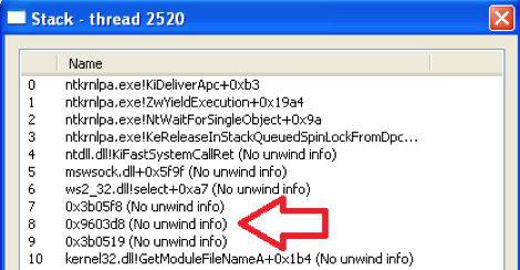

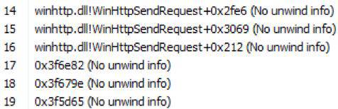

The active threads have start addresses at these private regions. The callstack also reveals these malicious sections.

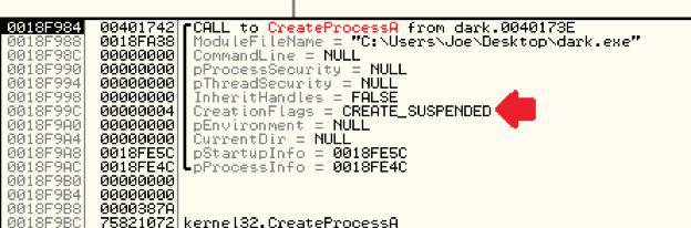

DarkComet is one of many malware families that use process hollowing techniques. Several artifacts can be used to detect process hollowing. One dead giveaway for this activity is a process being spawned with the CREATE_SUSPENDED flag, as shown in the following screenshot from a DarkComet sample.

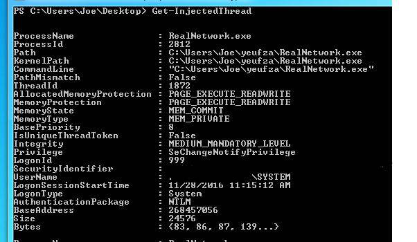

Given the immense size and impact of this detection gap, it is important to raise all boats, not just those of our customers. For this reason, we collaborated with Jared Atkinson on his powershell tool called Get-InjectedThreads, which implements a relatively low-noise method of detecting in memory threats. It scans active threads on the system for suspicious start addresses. Hunters leverage it to scan hosts in their networks and quickly identify many memory resident malware techniques. The script works by querying each active thread with the NtQueryInformationThread function to retrieve its start address. The start address is then queried with the VirtualQueryEx function to determine the associated section properties. If the memory region where the thread started is unbacked and executable (i.e. not image type and has execute bit set), then the thread is considered injected. The following screenshot shows a sample detection when run on a system infected with a 9002 RAT sample.
The script will catch a variety of malware families leveraging the shellcode injection, reflective DLL, memory module, and some process hollowing techniques. However, it is no replacement for security products that comprehensively prevent in-memory attacks, such as Endgame.
