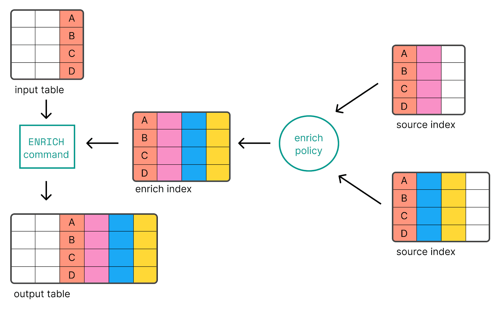

ES|QL ENRICH
The introduction of ES|QL, which went GA in version 8.14, is a piped query language supported by Elasticsearch that allows for the filtering, transforming and analysing of data. Using the ENRICH processing command allows us to add data from existing indices using an enrich policy.
Taking the same policy my_enrich_policy from the original enrich processor example, the ES|QL example would look like the following:
FROM first_index
| WHERE field_in_first_index IS NOT NULL
| ENRICH my_enrich_policyIt is also possible to override the match and enrichment fields, which in our example are field_in_first_index and field_to_enrich respectively:
FROM first_index
| ENRICH my_enrich_policy ON another_field_in_first_index WITH different_field_to_enrichWhile the obvious limitation is that you need to specify an enrich policy first, ES|QL does provide the flexibility to tweak the fields as required.
