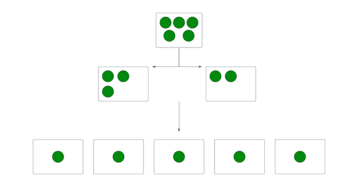

It is not possible to increase the primary shard number of an existing index, meaning an index must be recreated if you want to increase the primary shard count. There are 2 methods that are generally used in these situations: the _reindex API and the _split API.
The _split API is often a faster method than the _reindex API. Indexing must be stopped before both operations, otherwise, the source_index and target_index document counts will differ.
Method 1 – using the split API
The split API is used to create a new index with the desired number of primary shards by copying the settings and mapping an existing index. The desired number of primary shards can be set during creation. The following settings should be checked before implementing the split API:
The source index must be read-only. This means that the indexing process needs to be stopped.
The number of primary shards in the target index must be a multiple of the number of primary shards in the source index. For example, if the source index has 5 primary shards, the target index primary shards can be set to 10,15,20, and so on.
Note: If only the primary shard number needs to be changed, the split API is preferred as it is much faster than the Reindex API.
