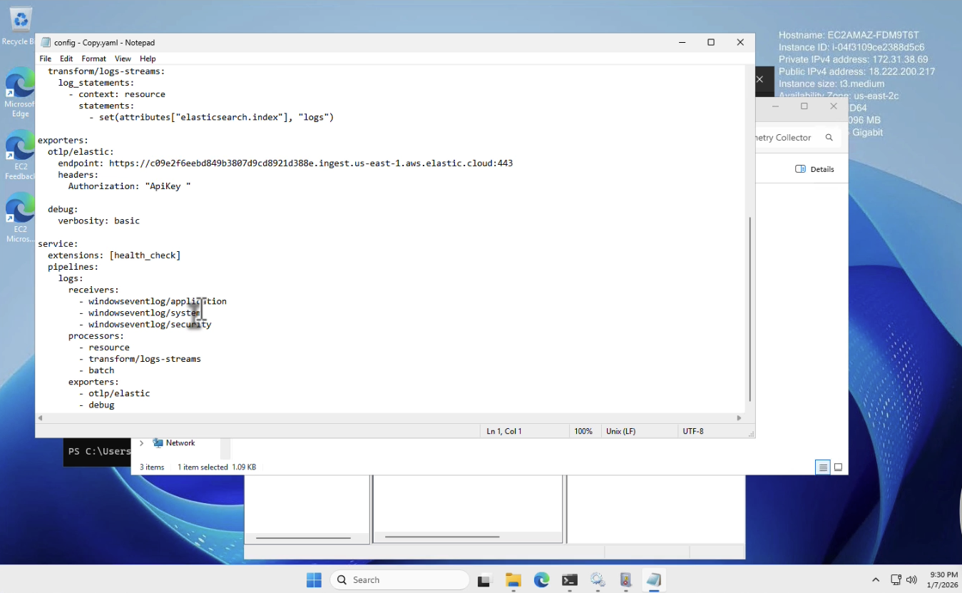

The key thing to pay attention to in this configuration is how we add this transform statement:
transform/logs-streams:
  log_statements:
    - context: resource
      statements:
        - set(attributes["elasticsearch.index"], "logs")
This works with the vanilla opentelemetry collector and when the data arrives in Elastic, it tells Elastic to use the new wired streams feature which enables all the downstream AI features we discuss in later steps.
Checkout my example configuration here

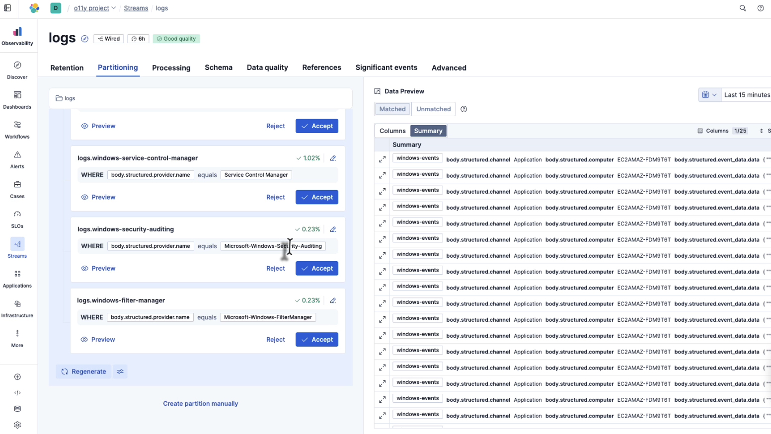

Step 2: AI-Driven Partitioning
Once the data arrives, the next challenge is organization. Dumping all Windows logs into a single logs-* index is a recipe for slow queries and confusion. In the past, we split indices based on hardcoded fields. Now, we can use AI to "fingerprint" the data.
This process involves analyzing the incoming stream to identify patterns. The system looks at the structure and content of the logs to determine their origin. For example, it can distinguish between a Windows Security Audit log and a Service Control Manager log purely based on the data shape.
The result is automatic partitioning. The system creates separate, optimized "buckets" or streams for each data type. You get a clean separation of concerns, Security logs go to one stream, File Manager logs to another, without having to write a single conditional routing rule. This partitioning is crucial for performance and for the next phase of the process: analysis.

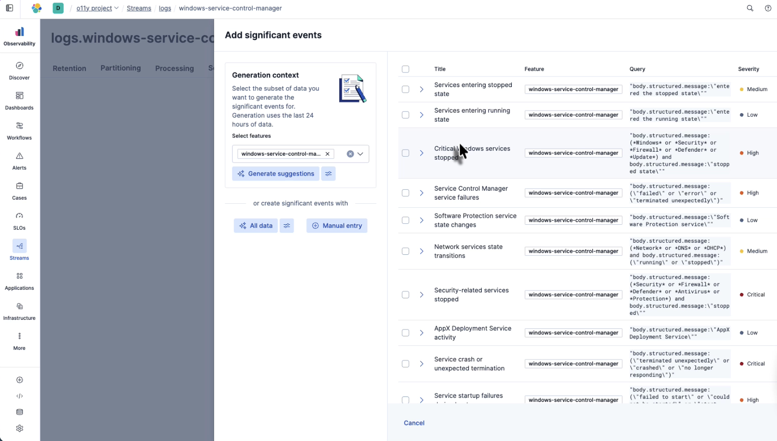

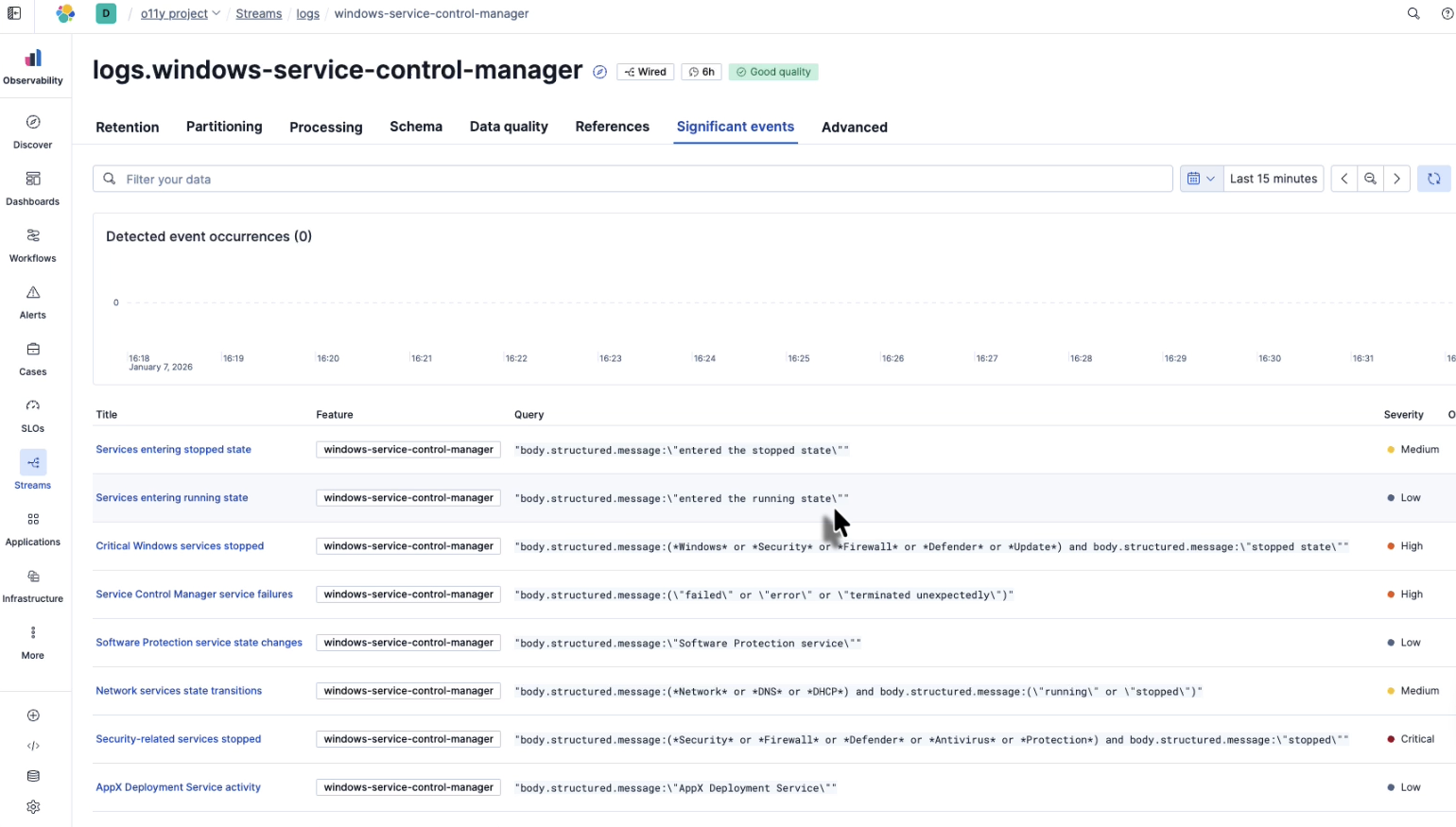

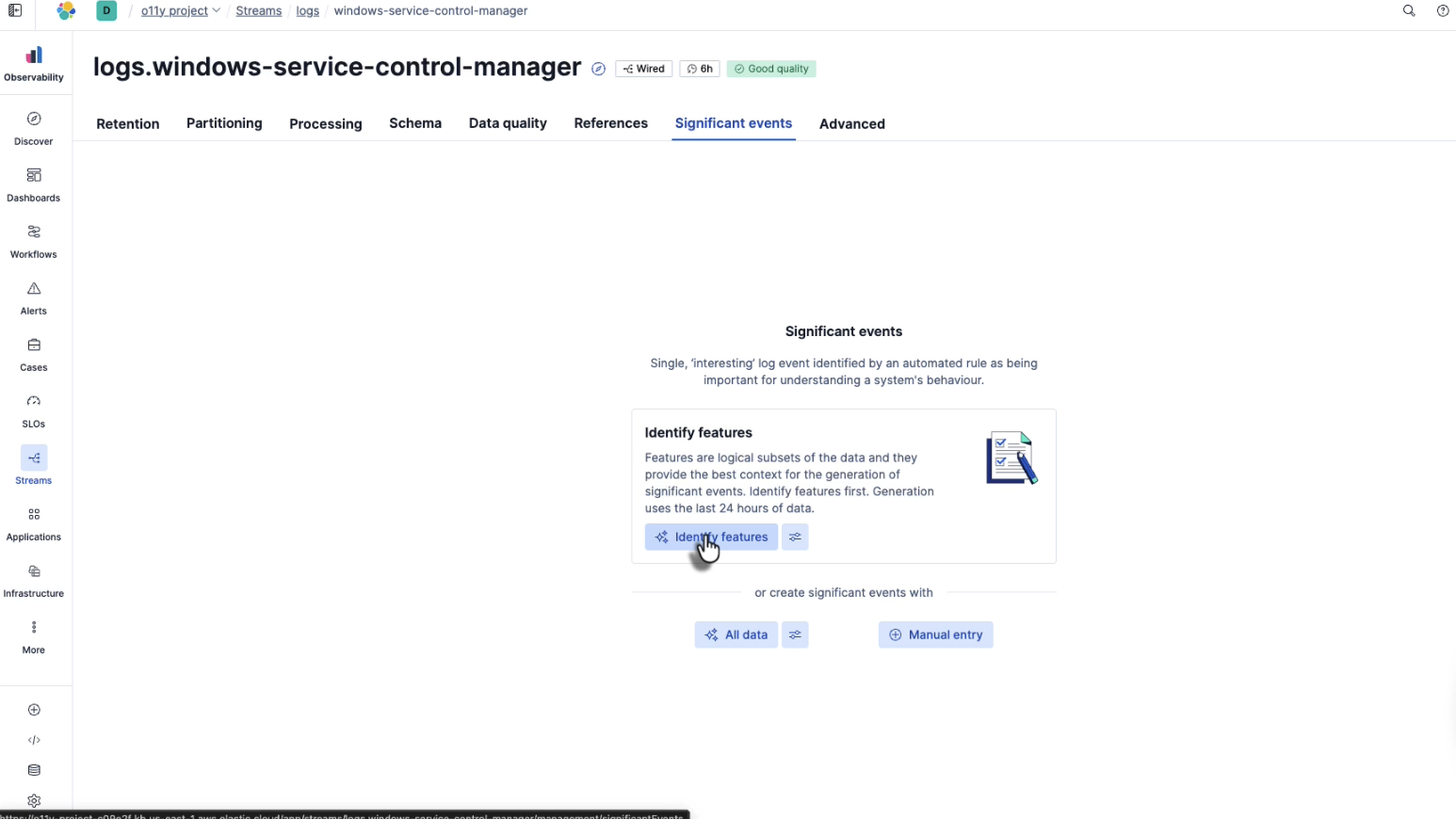

Step 3: Significant Events and LLM Analysis

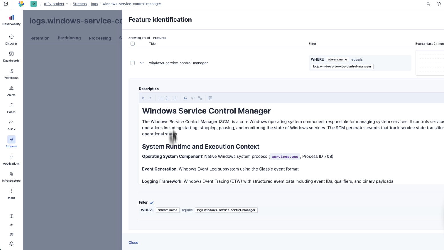

Once your data is partitioned (e.g., into a dedicated Service Control Manager stream), you can apply GenAI models to analyze the semantic meaning of that stream.
In a traditional setup, the system sees text strings. In an AI-driven setup, the system understands context. When an LLM analyzes the Service Control Manager stream, it identifies what that system is responsible for. It knows that this specific component manages the starting and stopping of system services.
Because the model understands the purpose of the log stream, it can generate suggestions for what constitutes a "Significant Event." It doesn't need you to tell it to look for crashes; it knows that for a Service Manager, a crash is a critical failure.
From Passive Storage to Proactive Suggestions
The workflow effectively automates the creation of detection rules. The LLM scans the logs and generates a list of potential problems relevant to that specific dataset, such as:
  • Service Crashes: High severity anomalies where background processes terminate unexpectedly.
  • Startup/Boot Failures: Critical errors preventing the OS from reaching a stable state.
  • Permission Denials: Security-relevant events regarding service interactions.
It bubbles these up as suggested observations. You can review a list of potential issues, see the severity the AI has assigned to them (e.g., Critical, Warning), and with a single click, generate the query required to find those logs.
