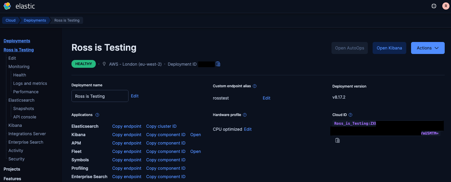

For cloud hosted deployments you can use the deployment’s CloudId for authentication, which you can get from the cloud admin console, on the deployment overview screen:

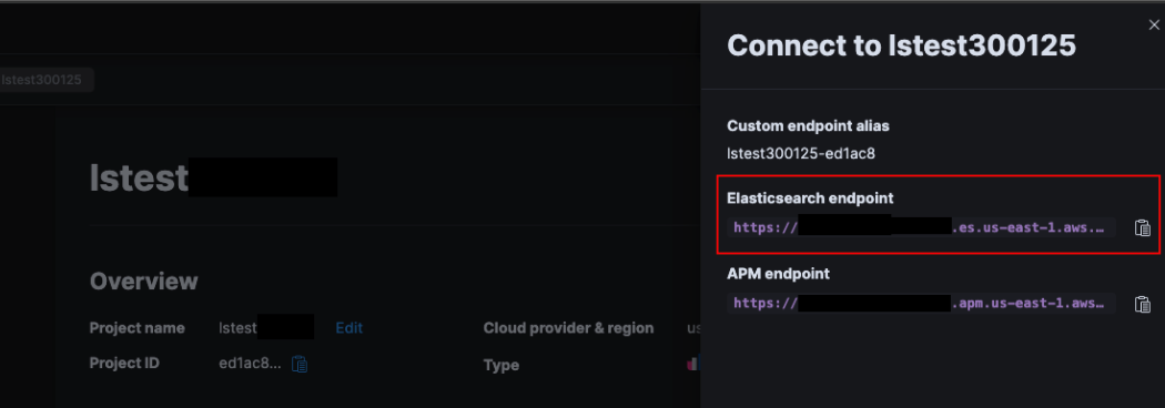

For serverless projects, you’ll need to use your Elasticsearch endpoint and an API key to connect Logstash, as documented here. You can get the Elasticsearch endpoint from the manage project screen of the cloud admin console:
