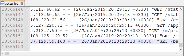

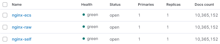

Before we begin, let us review how many documents exist and what we're required to ingest. We have 10,365,152 documents/events from our Nginx log file:
With 10,365,152 documents in our targeted end-state:

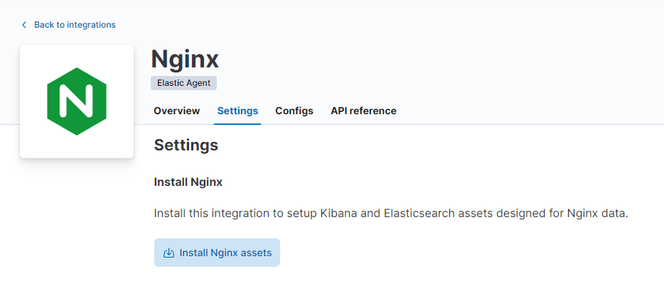

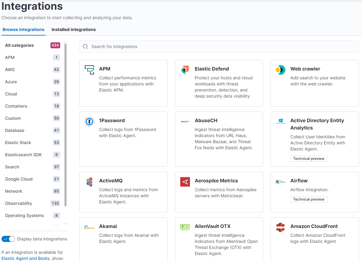

Elastic comes included with many available integrations which contain everything you need to achieve to ensure that your data is ingested as efficiently as possible.
For our use case of Nginx, we'll be using the associated integration's assets only.
The assets which are installed are more than just dashboards, there are ingest pipelines which not only normalize but enrich the data while simultaneously mapping the fields to their correct type via component templates. All we have to do is make sure that as the data is coming in, that it will traverse through the ingest pipeline and use these supplied mappings.

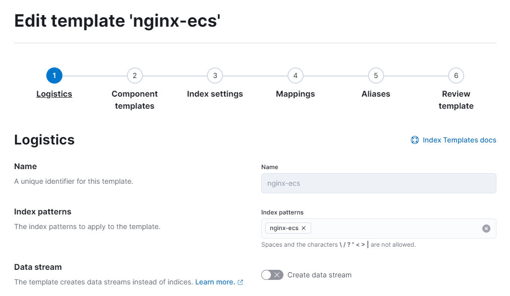

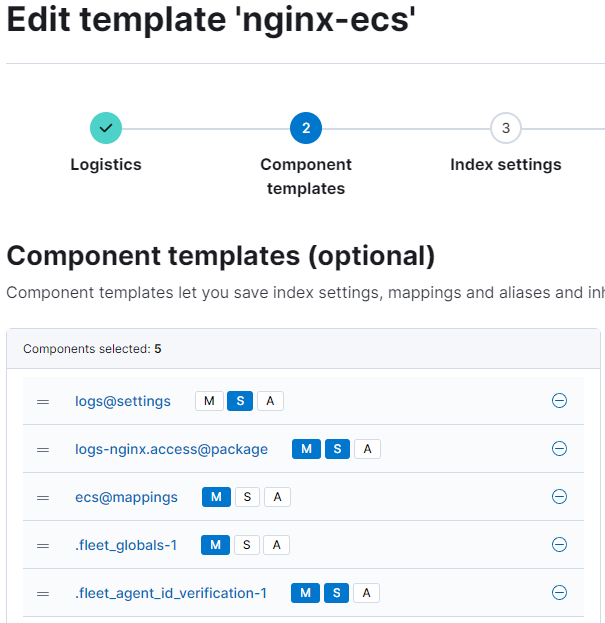

Create your index template, and select the supplied component templates provided from your integration.
Think of the component templates like building blocks to an index template. These allow for the reuse of core settings, ensuring standardization is adopted across your data.
For our ingestion method, we merely point to the index name that we specified during the index template creation, in this case, nginx-ecs and Elastic will handle all the rest!

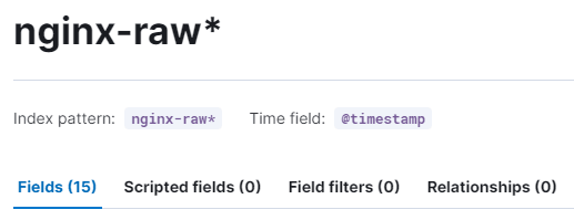

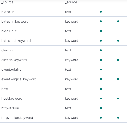

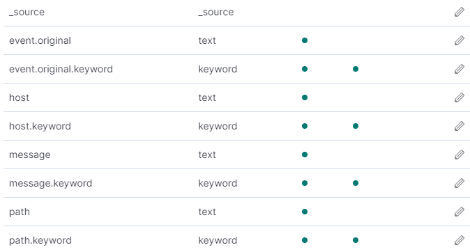

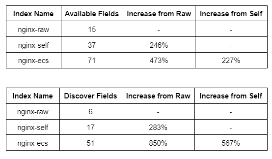

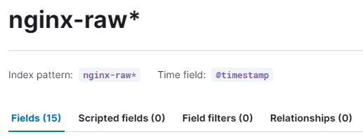

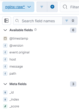

Let's compare how many fields are available to search upon the three indices as well as the quality of the data. Our raw index has but 15 fields to search upon, with most being duplicates for aggregation purposes.
However from a Discover perspective, we are limited to 6 fields!

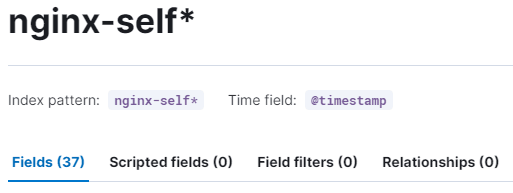

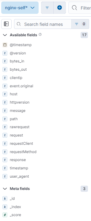

Our self-parsed index has 37 available fields, however these too are duplicated and not ideal for efficient searching.
From a Discover perspective here we have almost 3x as many fields to choose from, yet without the correct mapping the ease of which this data may be searched is less than ideal. A great example of this, is attempting to calculate the average bytes_in on a text field.

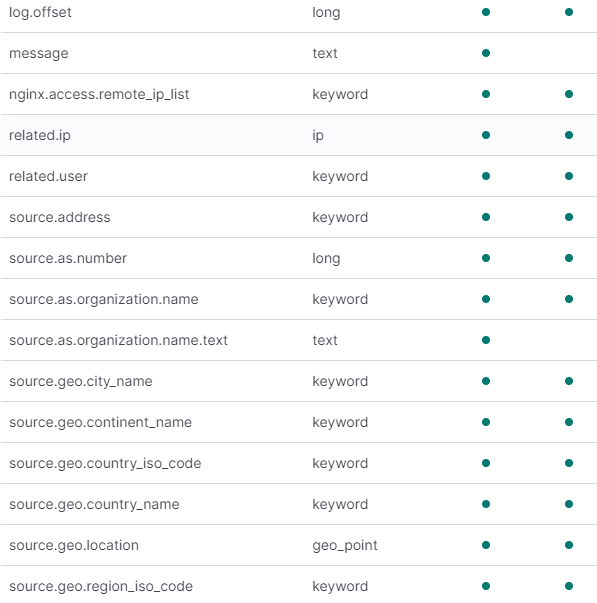

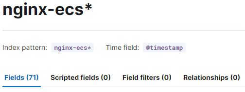

Finally with our ECS index, we have 71 fields available to us! Notice that courtesy of the ingest pipeline, we have enriched fields of geographic information as well as event categorial fields.

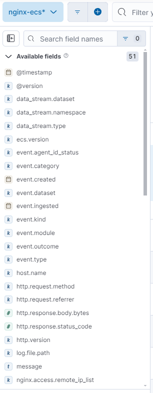

Now what about Discover? There were 51 fields directly available to us for searching purposes:
Using Discover as our basis, our self-parsed index has 283% more fields to search upon whereas our ECS index has 850%!

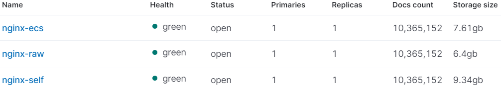

Storage Utilization Comparison

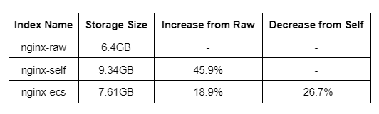

Surely with all these fields in our ECS index the size would be exponentially larger than the self normalized index, let alone the raw index? The results may surprise you.
Accounting for the replica of data of our 3.3GB size data set, we can see that the impact of normalized and mapped data has a significant impact on the amount of storage required.
Conclusion
While there is an increase in the amount required storage for any dataset that is enriched, Elastic provides easy solutions to maximize the fidelity of the data to be searched while simultaneously ensuring operational storage efficiency; that is the power of the Elastic Common Schema.
