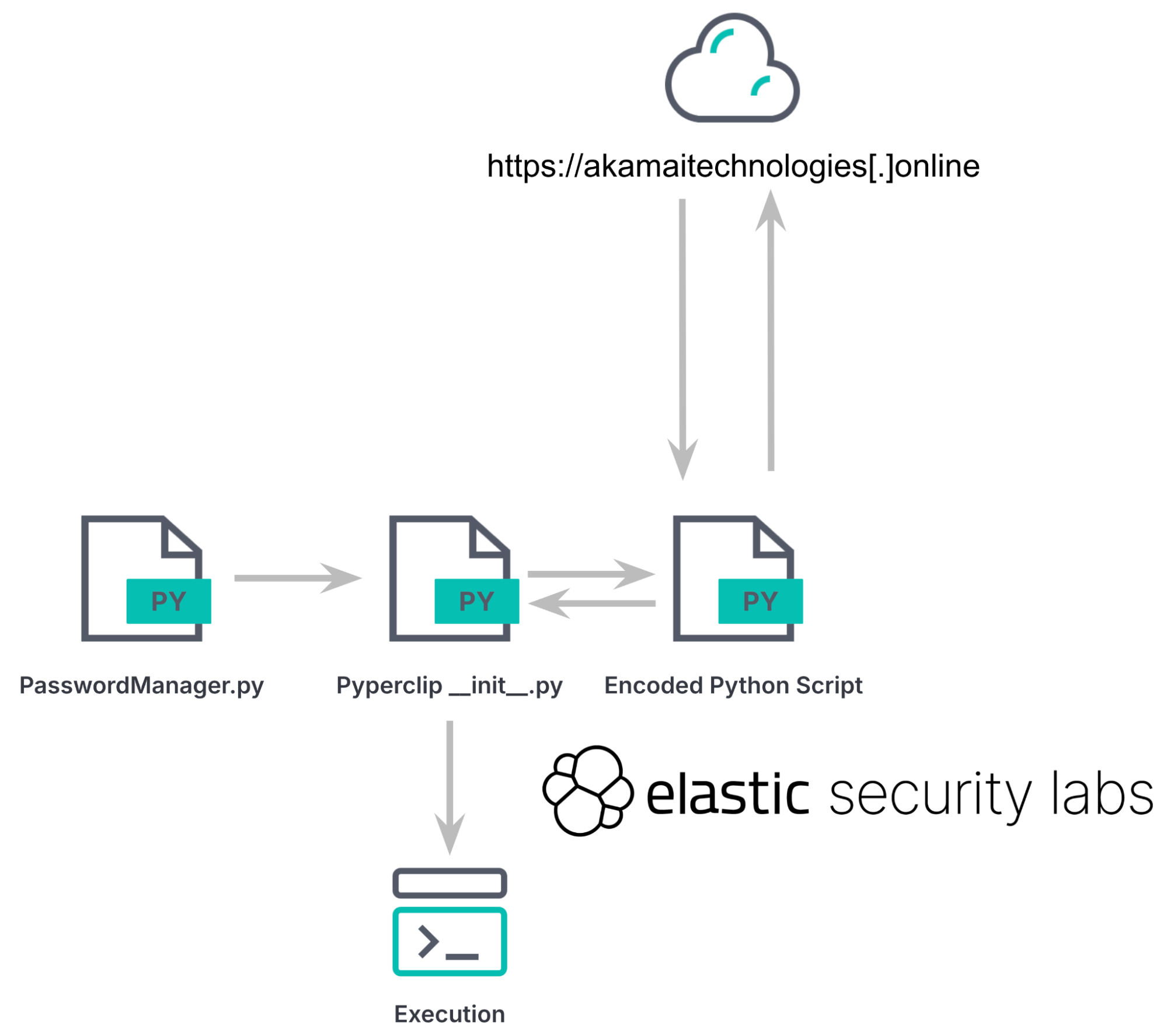

DPRK Python initial access execution flow
PasswordManager.py

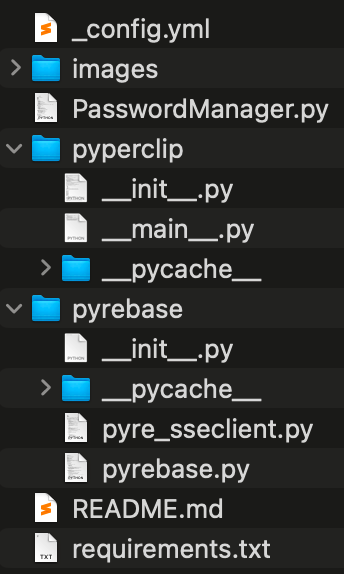

This “Python Challenge” is provided via a .zip file containing a Python application called “PasswordManager”. This application primarily consists of a main script, PasswordManager.py, and two Python modules, Pyperclip and Pyrebase.
PasswordManager Application Contents

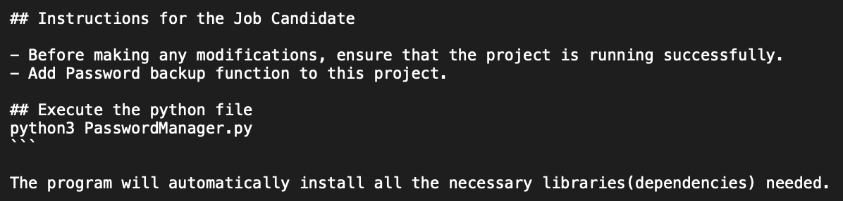

Examining the README.md file first, it is evident that this is meant to be some sort of interview challenge or assessment, but what immediately piqued our interest were the following lines:
Excerpt from “PasswordManager” application README file
This was interesting as they wanted to ensure that the application was run before the user made any changes that may cause certain functionality to break or become noticeable.
The main PasswordManager.py file looks like the makings of a basic Python password manager application. Of course, as we noted above, the application imports two third-party modules (Pyperclip and Pyrebase) into this main script.
Pyperclip module
The Pyperclip module has two files, __init__.py and __main__.py.
Pyperclip module files

Now that we understand the purpose of the encoded Python script let's go back to the __inity__.py script and break down the function that executes the base64-encoded section.
inity.py
Back within the __inity__.py script we can look for any other reference to the req_self variable to see what the script does with that encoded Python script. We find one single reference located in a function defined as cert_acc.

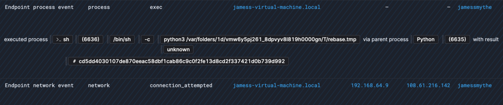

Regarding this sample specifically, there are a few different detections we can write surrounding the behavior of the code execution mechanism and the potential resulting use cases associated with that activity. While these queries are macOS-specific, you can take them and alter them to detect the same activity on Windows as well.
[Detection] Python Subprocess Shell Tempfile Execution and Remote Network Connection
sequence by process.parent.entity_id with maxspan=3s
[process where event.type == "start" and event.action == "exec" and process.parent.name : "python*"
 and process.name : ("sh", "zsh", "bash") and process.args == "-c" and process.args : "python*"]
[network where event.type == "start"]
Sequence based Behavior Rule detection
This rule looks for the specific behavior exhibited when the __init__.py sample writes the obfuscated Python script to disk and utilizes the subprocess.Popen method, setting the shell variable equal to True to execute the Python script that connects to a remote server to retrieve and execute commands.
