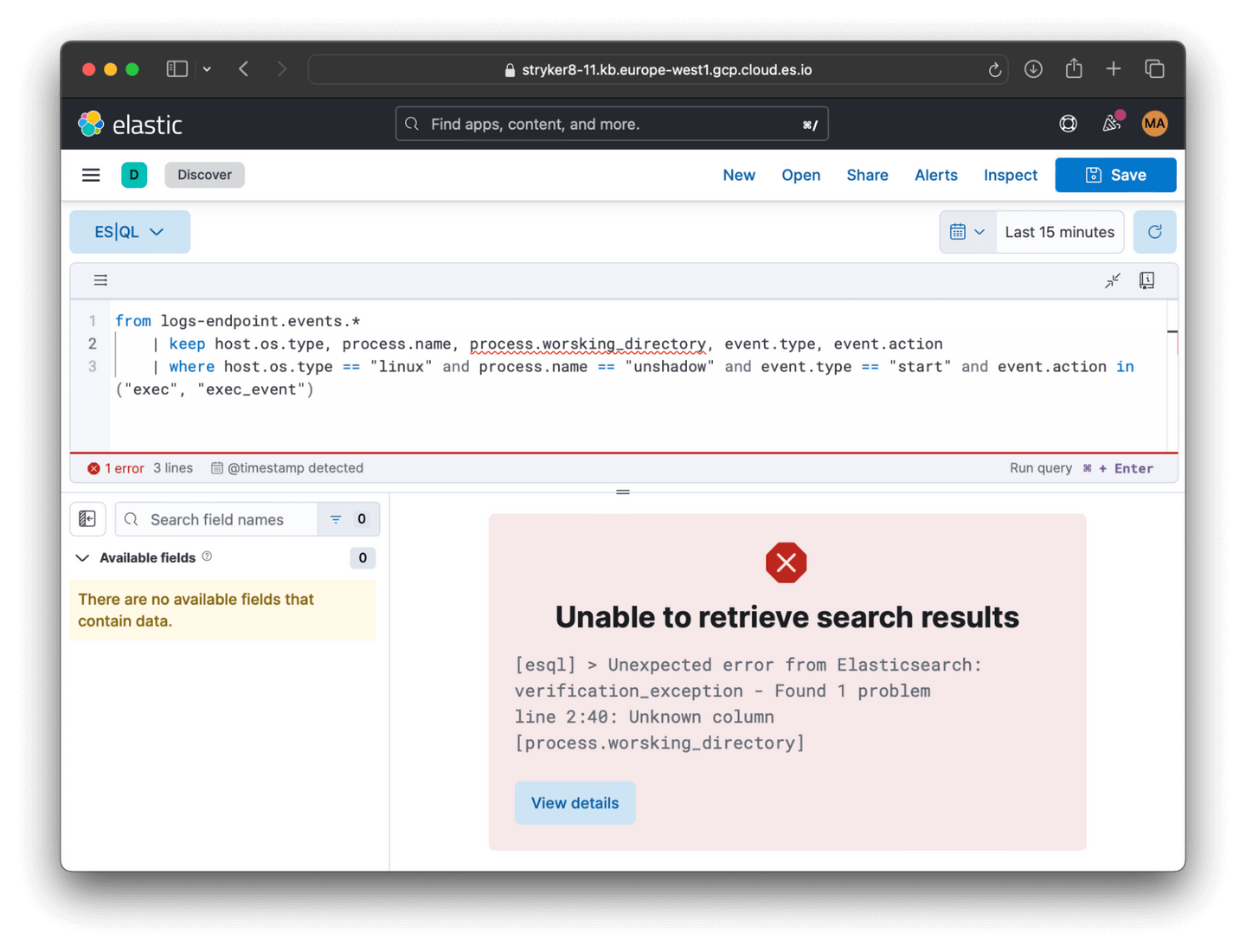

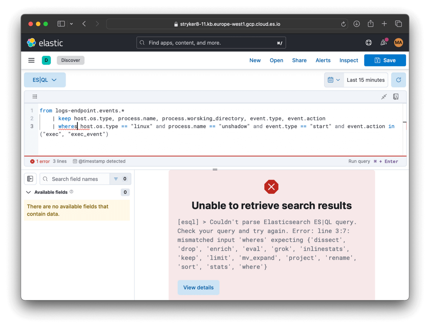

If you want to quickly validate a single query, or feel comfortable manually testing queries one-by-one, the Elastic Stack UI is all you need. After navigating to the Discover tab in Kibana, click on the "Try ES|QL" Technical Preview button in the Data View dropdown to load the query pane. You can also grab sample queries from the ES|QL Examples to get up and running. Introducing non-ECS fields will immediately highlight errors prioritizing syntax errors, then unknown column errors.
In this example, there are two syntax errors that are highlighted:
  • the invalid syntax error on the input wheres which should be where and
  • the unknown column process.worsking_directory, which should be process.working_directory.
After resolving the syntax error in this example, you’ll observe the Unknown column errors. Here are a couple reasons this error may appear:
  • Fix Field Name Typos: Sometimes you simply need to fix the name as suggested in the error; consult the ECS or any integration schemas and confirm the fields are correct
  • Add Missing Data: If you’re confident the fields are correct, sometimes adding data to your stack, which will populate the columns
  • Update Mapping: You can configure Mappings to set explicit fields, or add new fields to an existing data stream or index using the Update Mapping API

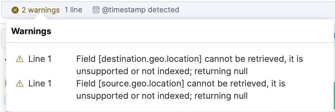

ES|QL warnings
Not all fields will appear as errors, in which case you’re presented with warnings and a dropdown list. Hard failures (e.g. errors), imply that the rule cannot execute, whereas warnings indicate that the rule can run, but the functions may be degraded.
When utilizing broad ES|QL queries that span multiple indices, such as logs-* | limit 10, there might be instances where certain fields fail to appear in the results. This is often due to the fields being undefined in the indexed data, or not yet supported by ES|QL. In cases where the expected fields are not retrieved, it's typically a sign that the data was ingested into Elasticsearch without these fields being indexed, as per the established mappings. Instead of causing the query to fail, ES|QL handles this by returning "null" for the unavailable fields, serving as a warning that something in the query did not execute as expected. This approach ensures the query still runs, distinguishing it from a hard failure, which occurs when the query cannot execute at all, such as when a non-existent field is referenced.

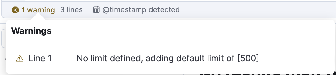

There are also helpful performance warnings that may appear. Providing a LIMIT parameter to the query will help address performance warnings. Note this example highlights that there is a default limit of 500 events returned. This limit may significantly increase once this feature is generally available.

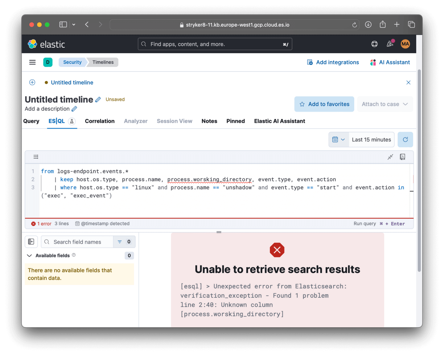

Security
In an investigative workflow, security practitioners prefer to iteratively hunt for threats, which may encompass manually testing, refining, and tuning a query in the UI. Conveniently, security analysts and engineers can natively leverage ES|QL in timelines, with no need to interrupt workflows by pivoting back and forth to a different view in Kibana. You’ll receive the same errors and warnings in the same security component, which shows Elasticsearch feedback under the hood.

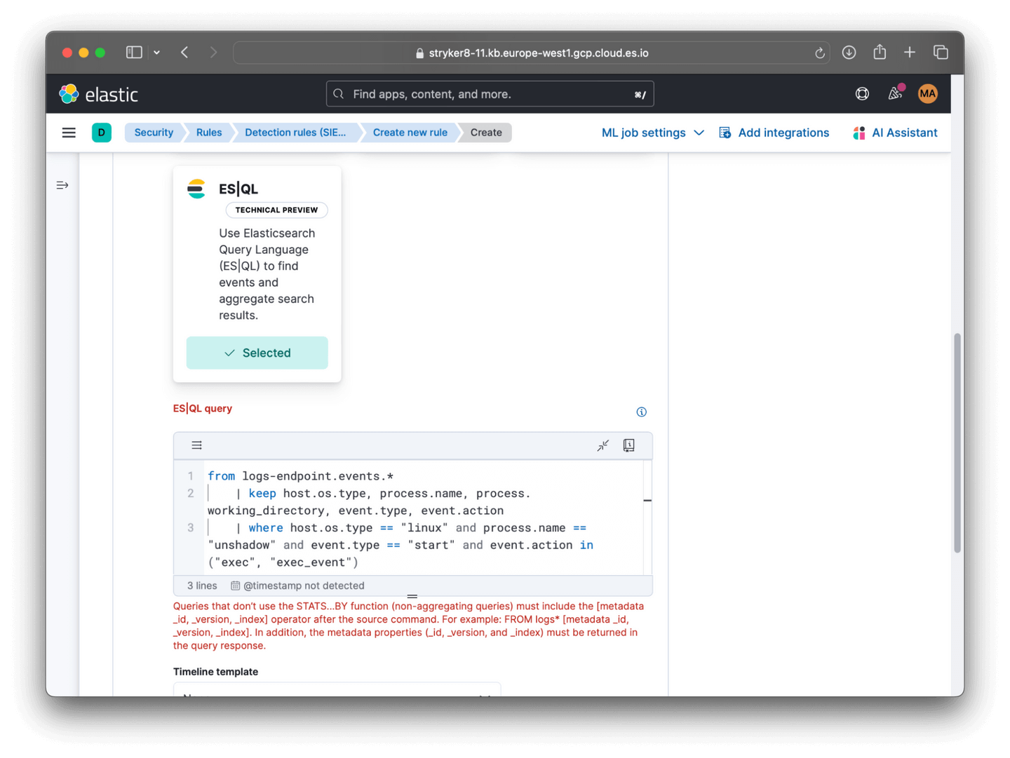

In some components, you will receive additional feedback based on the context of where ES|QL is implemented. One scenario is when you create an ES|QL rule using the create new rule feature under the Detection Rules (SIEM) tab.
For example, this query could easily be converted to an EQL or KQL query as it does not leverage powerful features of ES|QL like statistics, frequency analysis, or parsing unstructured data. If you want to learn more about the benefits of queries using ES|QL check out this blog by Costin, which covers performance boosts. In this case, we must add [metadata _id, _version, _index] to the query, which informs the UI which components to return in the results.

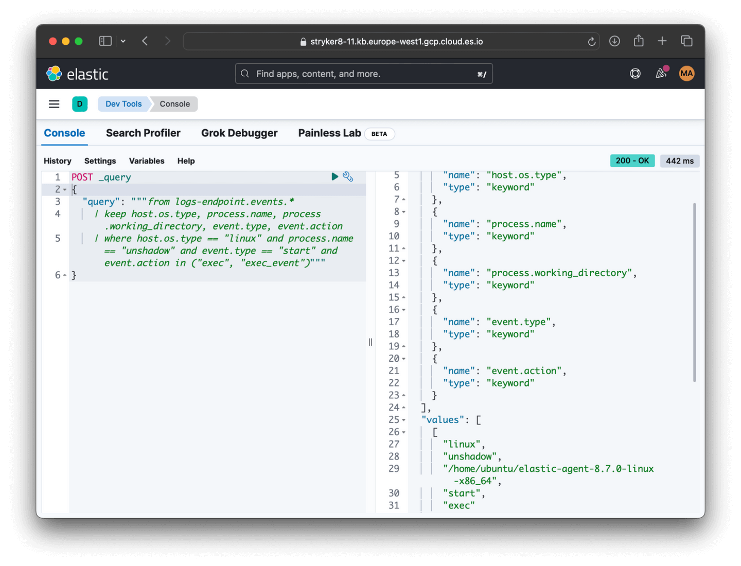

API calls? Of course!
Prior to this section, all of the examples referenced creating ES|QL queries and receiving feedback directly from the UI. For illustrative purposes, the following examples leverage Dev Tools, but these calls are easily migratable to cURL bash commands or the language / tool of your choice that can send an HTTP request.
Here is the same query as previously shown throughout other examples, sent via a POST request to the query API with a valid query.

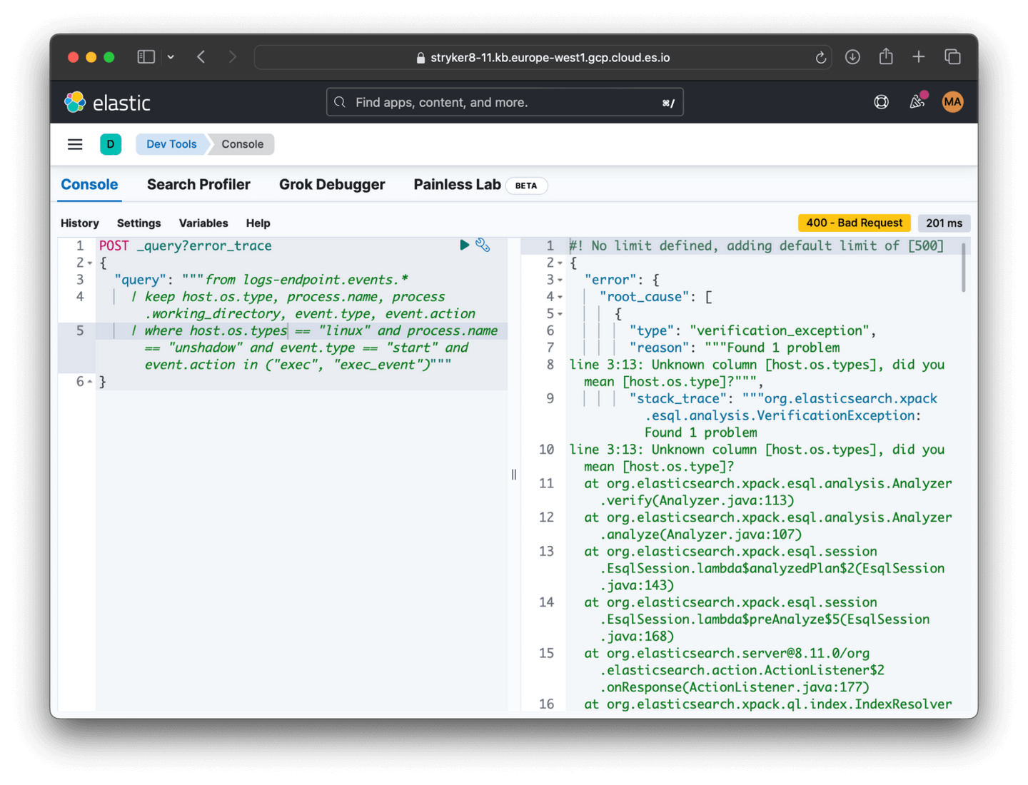

As expected, if you supply an invalid query, you’ll receive similar feedback observed in the UI. In this example, we’ve also supplied the ?error_trace flag which can provide the stack trace if you need additional context for why the query failed validation.
As you can imagine, we can use the API to programmatically validate ES|QL queries. You can also still use the Create rule Kibana API, which requires a bit more metadata associated with a security rule. However, if you want to only validate a query, the _query API comes in handy. From here you can use the Elasticsearch Python Client to connect to your stack and validate queries.

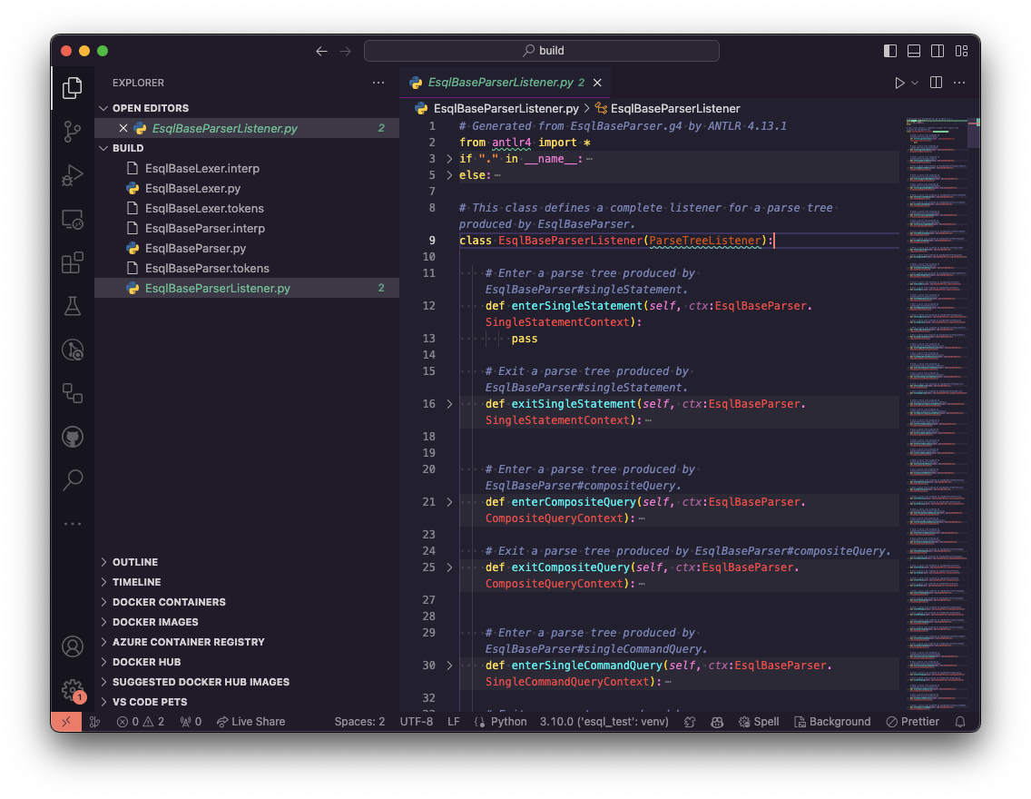

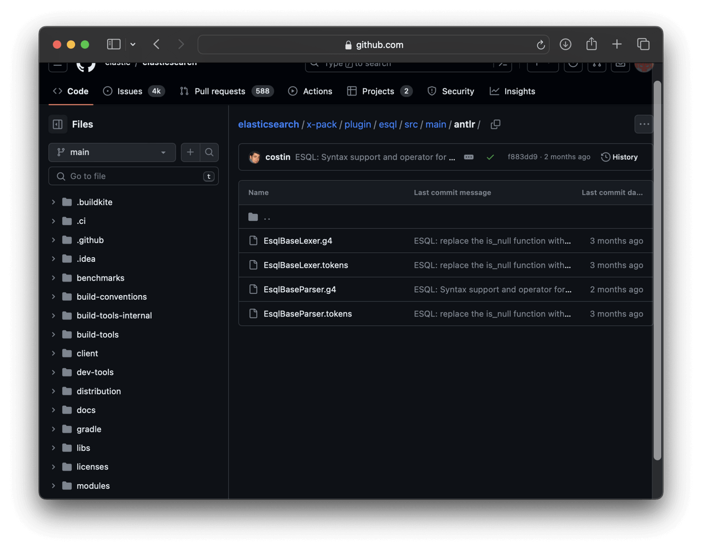

Leverage the grammar
One of the best parts of Elastic developing in the open is the antlr ES|QL grammar is also available.
If you’re comfortable with ANTLR, you can also download the latest JAR to build a lexer and parser.
pip install antlr4-tools # for antlr4
git clone git@github.com:elastic/elasticsearch.git # large repo
cd elasticsearch/x-pack/plugin/esql/src/main/antlr # navigate to grammar
antlr4 -Dlanguage=Python3 -o build EsqlBaseLexer.g4 # generate lexer
antlr4 -Dlanguage=Python3 -o build EsqlBaseParser.g4 # generate parser
This process will require more lifting to get ES|QL validation started, but you’ll at least have a tree object built, that provides more granular control and access to the parsed fields.
However, as you can see the listeners are stubs, which means you’ll need to build in semantics manually if you want to go this route.

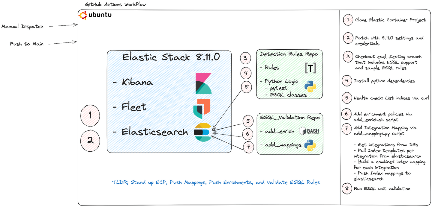

CI checks help to ensure queries still pass ES|QL validation without having to manually check the query in the UI. Based on the examples shown thus far, you have to either stand up a persistent stack and validate queries against the API, or build a parser implementation based on the available grammar outside of the Elastic stack.
One approach to using a short-lived Elastic stack versus leveraging a managed persistent stack is to use the Elastic Container Project (ECP). As advertised, this project will:
Stand up a 100% containerized Elastic stack, TLS secured, with Elasticsearch, Kibana, Fleet, and the Detection Engine all pre-configured, enabled, and ready to use, within minutes.
With a combination of:
  • Elastic Containers (e.g. ECP)
  • CI (e.g. Github Action Workflow)
  • ES|QL rules
  • Automation Foo (e.g. python & bash scripts)

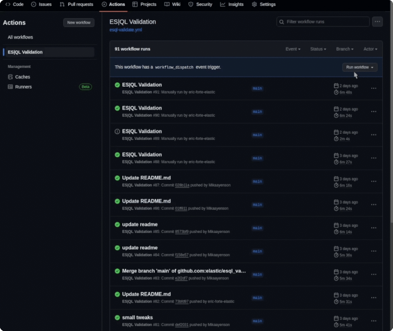

You can validate ES|QL rules via CI against the latest stack version relatively easily, but there are some nuances involved in this approach.
Feel free to check out the sample GitHub action workflow if you’re interested in a high-level overview of how it can be implemented.
Note: if you're interested in using the GitHub action workflow, check out their documentation on using GitHub secrets in Actions and setting up Action workflows.
