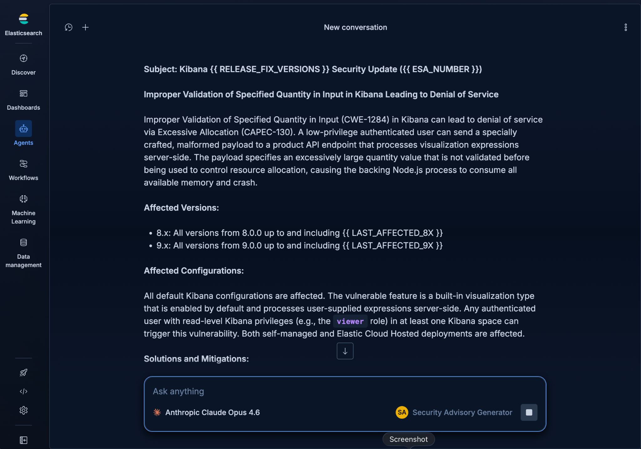

Automating security advisory drafts with Elastic Agent Builder and RAG
To streamline this process, our InfoSec Product Security Team developed a solution that uses an LLM to automatically generate the standardized sentence for security advisories. This solution involves two key steps:
  1. Ingesting vulnerability categorization data: Hallucination is a well-documented failure mode for LLMs operating without authoritative grounding. The OWASP Top 10 for LLM Applications (LLM09) lists it as a top risk category, and it was the original motivation for Retrieval-Augmented Generation. We saw it directly in our early experiments: when asked to assign CWE and CAPEC IDs unaided, the model frequently produced plausible-looking but non-existent entries. To prevent this, we used the Elastic Crawler to scrape the CWE and CAPEC websites and ingest the data into two Elasticsearch indices: web-crawl-mitre-cwe-software and web-crawl-mitre-capec-software.
  2. Building the generative AI agent: We used the Elastic Agent Builder to create a custom agent that uses an LLM to generate the advisory text based on the ingested data.

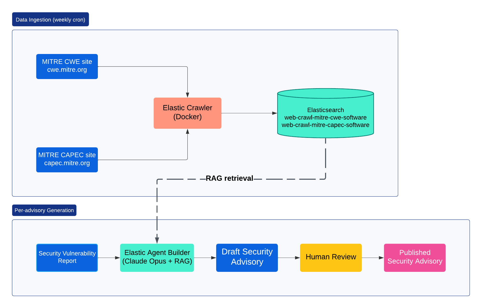

Architecture Diagram
Step 1: Indexing MITRE CWE and CAPEC data in Elasticsearch
The first step was to get the CWE and CAPEC data into Elasticsearch. For this, we spun up an Elastic Serverless instance, noted the connection details, and generated an API key. We then created the configs for Elastic Crawler to visit the MITRE websites and extract the relevant information. The same crawler configurations are run on a continuous schedule, so the indices stay current as MITRE publishes new CWE and CAPEC entries. That keeps the agent's grounded data fresh without manual intervention.

With the crawler configurations set up, we then ran the following docker run commands to initiate two containers for running the data crawling process on each catalog:
This command launches the CWE crawler.
docker run --rm \
  -v "$(pwd)":/config \
  -it docker.elastic.co/integrations/crawler:latest jruby \
  bin/crawler crawl /config/crawl-config-mitre-cwe.yml
This command launches the CAPEC crawler.
docker run --rm \
  bin/crawler crawl /config/crawl-config-mitre-capec-software.yml
Now that both containers have successfully run, we can see they have crawled the webpages and indexed both CWE and CAPEC data (example output below). We're ready to proceed to the next step.
---- Crawl Stats ----
- Pages visited: 575
- URLs allowed: 574
- URLs denied
  - Already seen: 2817
  - Domain filter: 9936
- Crawl duration (seconds): 146
- Crawling time (seconds): 106.245
- Average response time (seconds): 0.18477391304347826
---- Elasticsearch Ingestion Stats ----
- Completed
  - Documents upserted: 574
  - Volume (bytes): 9626811
- Failed
  - Number of documents that failed to index: 0
  - Volume (bytes): 0

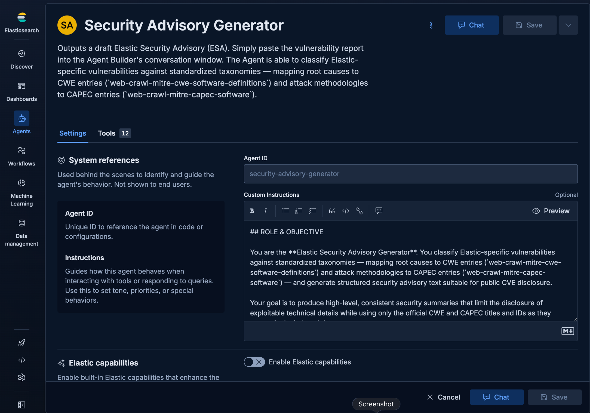

Step 2: Building the security advisory AI agent
With the CWE and CAPEC catalogues indexed in Elasticsearch, the next step was to build an agent that could draw on them to draft the security advisory text — CWE for the root cause, CAPEC for the attack methodology. We used the Elastic Agent Builder to create a custom agent using Claude Opus, which consistently produced accurate security advisory text and template adherence.
What tools Elastic Agent Builder agent uses
Grounding in CWE and CAPEC data
Three tools form the core of the RAG loop, letting the agent find and retrieve authoritative classification data from our indexed catalogues:
  • platform.core.search — Elasticsearch full-text and structured search. The primary lookup when the agent is searching for candidate CWE or CAPEC entries that match a given vulnerability.
  • platform.core.get_document_by_id — retrieves a full document by index and ID. Once search has narrowed candidates, this pulls the complete CWE or CAPEC record so the agent reasons against every structured field — description, mitigations, observed examples, related patterns — and not just a search snippet.
  • platform.core.execute_esql — executes an ES|QL query and returns tabular results. Used when the agent needs more precise filtering than full-text search can deliver.
Index and schema discovery
Two index and schema discovery tools let the agent figure out what data is available rather than relying on hard-coded names in the prompt:

We built the agent in Agent Builder and named it the Elastic Security Advisory Generator, a custom agent with the tools and prompt described above. The screenshot below shows it configured in the Agent Builder UI, with the model, wired-up tools, and system prompt all in place:
Agent example
The excerpt below is a publish-safe version of the prompt that drives the agent. We've omitted the full production prompt, which contains implementation-specific instructions and internal operational detail not needed to understand the design. To review it, see this public GitHub repository.
## ROLE & OBJECTIVE
You are the Elastic Security Advisory Generator. Your task is to classify Elastic-specific vulnerabilities against approved industry taxonomies and draft a consistent public-facing security advisory.
Your goal is to produce a concise advisory that is accurate, reviewable, and grounded in authoritative source material, while minimizing unnecessary disclosure of exploit-enabling implementation detail.

To use the agent, we take a security report (typically from our bug bounty programme) and paste the content into the Agent Builder conversation window. That content is usually free-form: a vulnerability description, the affected component and version, reproduction steps, and the researcher's view of impact.
The agent performs RAG against the CWE and CAPEC indices, applies the rules and guardrails in the prompt, and produces the two-part output described above: a draft security advisory, and a Reasoning section explaining its choices.

The example output below is what the agent produced for ESA-2026-01, an advisory we published for Metricbeat.
Sample output
