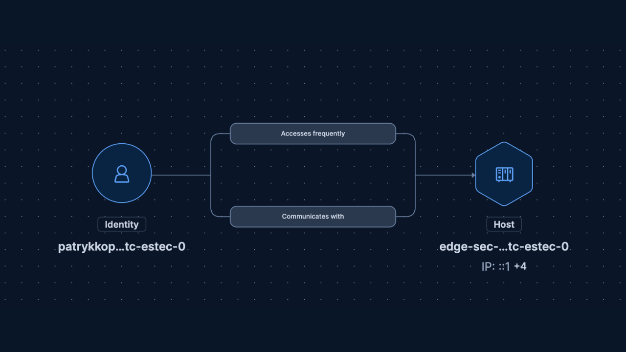

Open the entity analytics (EA) graph in Elastic Security and you'll see a user wired to the hosts they log in to and the devices they own, along with scattered accounts that turn out to be the same user. While interesting on its own, it provides a critical piece of context during a threat hunting or incident investigation. This post gives an overview of EA fundamentals and opens the hood to see how edges are drawn and accounts are resolved. Why is that important? Well, everything downstream, including baselines, risk, and AI reasoning, is only as good as the entity records underneath it.
Figure 1: Entity graph surfacing relationships.

Maintainers discover and store entity relationships
Let’s take a look at one of the relationship maintainers. Once a day, the accesses_frequently / accesses_infrequently maintainer runs an ES|QL query over relevant telemetry and, for each actor→target pair, counts successful accesses over a 30-day window. If the count is:
  • greater than or equal to an Elastic-defined threshold, the relationship becomes accesses_frequently.
  • less than the threshold, the relationship becomes accesses_infrequently.
Today, it reads from Elastic Defend (endpoint logins), AWS CloudTrail (StartSession / SendSSHPublicKey), system auth (SSH logins), and system security (Windows events 4624/4648). A sibling, communicates_with, builds communication links from Elastic Defend, system auth, system security, Jamf Pro, and AWS CloudTrail.
The relationships are written straight onto the entity record as arrays of target IDs:
