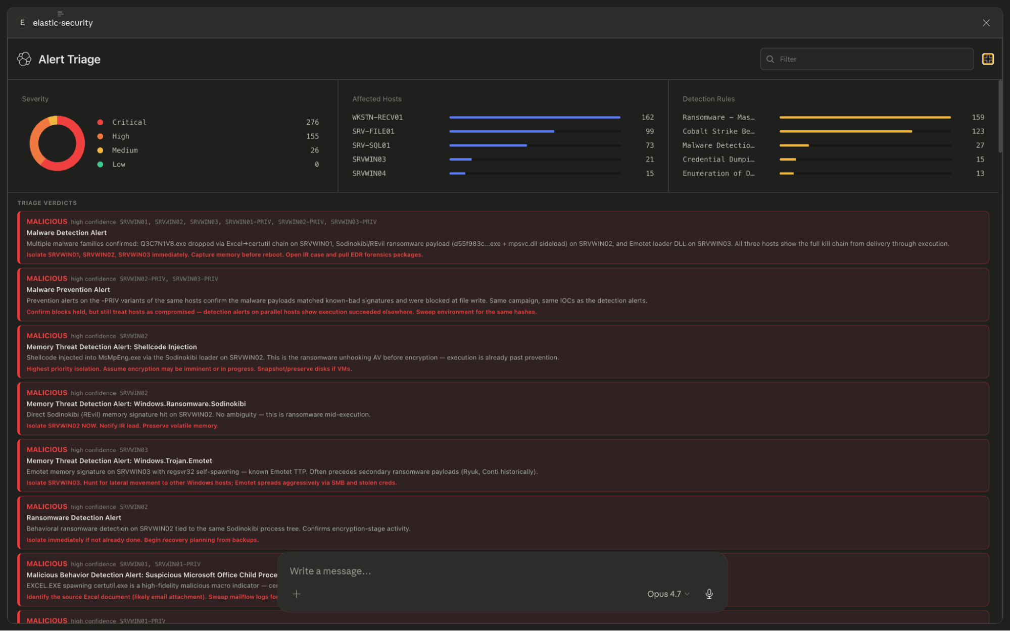

Alert TriageFetch, filter, and classify security alertsSeverity grouping, AI verdict cards, process tree, and network events

Triage alerts. Ask the agent to triage by host, rule, user, or time window. The Alert Triage skill returns a dashboard of AI verdicts above the raw alert list, with one verdict per detection rule classifying that rule's activity as benign, suspicious, or malicious, each with a confidence score and a recommended action. Click any alert to open a detailed view with a process tree, network events, related alerts, and MITRE ATT&CK tags. No tab switching between your AI tool and the alerts dashboard inside Kibana; everything happens in real-time inside the conversation.
Alert Triage
