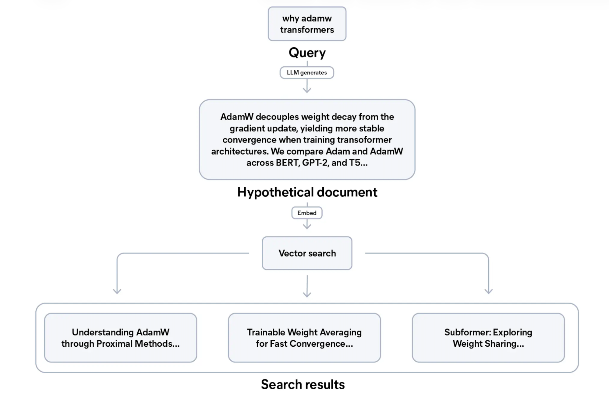

What is HyDE, and why does it work?
HyDE closes the embedding gap between short queries and formal documents by generating a full-length hypothetical document in the same register as the corpus before embedding.
An embedding doesn't just encode a topic. It encodes topic, register, vocabulary density, and sentence structure, all packed into one vector. A four-word casual query, like "adamw vs Adam transformers", carries a handful of semantic signals, so its embedding sits in a vague region of the vector space. A 200-word abstract covering the same subject packs dozens of reinforcing terms (weight decay, gradient update, convergence, generalization) that anchor its embedding much more precisely. The result: A semantic search for the short query can drift toward loosely related papers instead of landing on the best matches.
HyDE closes this gap by asking an LLM to write a document in the same style as the corpus before embedding, a strategy that complements other query rewriting techniques for improving search quality. The flow looks like this:
A flowchart showing a query “why adamw transformers” leading to a hypothetical document about AdamW and transformer architectures and then embedding into a vector search that returns three search results titled “Understanding AdamW through Proximal Methods,” “Trainable Weight Averaging for Fast Convergence,” and “Subformer: Exploring Weight Sharing.”
The hypothetical document doesn’t need to be factually correct. It may contain false details, and that’s fine, because the document is thrown away after its embedding is extracted. The user only ever sees real documents from the index.

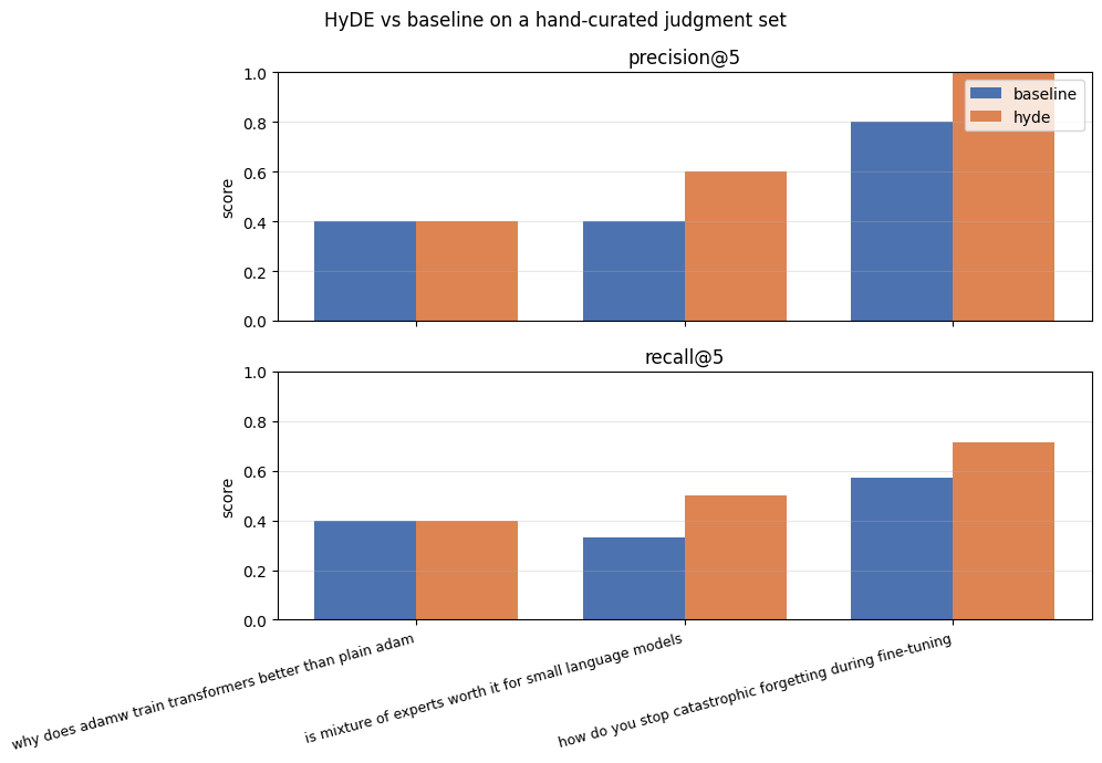

Does HyDE improve semantic search? Evaluation results
HyDE improved precision and recall by 50% on two of the three test queries. The third query already named both optimizers explicitly, so the baseline embedding was already well-anchored.
We define a hand-curated judgment set for three queries, listing the papers considered relevant, and measure standard retrieval metrics:
  • Precision@5: Fraction of the top 5 that are in the relevance set.
  • Recall@5: Fraction of the relevance set captured in the top 5
  • MRR: Reciprocal rank of the first relevant hit (0 if none).

Run both methods across all three queries, and collect results:
results = []
for query, relevant in RELEVANT_DOCS.items():
    baseline_hits = search(query)
    hyde_hits = search(generate_hypothetical_abstract(query))
    results.append({
        "query": query,
        "relevant": relevant,
        "baseline_hits": baseline_hits,
        "hyde_hits": hyde_hits,
Results
Two bar charts titled “HyDE vs baseline on a hand‑curated judgment set.” The top chart shows precision@5 scores and the bottom chart shows recall@5 scores for three queries about AdamW, mixture of experts, and catastrophic forgetting. Orange bars for HyDE are equal to or higher than blue bars for baseline.
HyDE improved precision and recall on queries 2 and 3 but tied with the baseline on query 1. Query 1 ("why does adamw train transformers better than plain adam") already names both optimizers explicitly, so the baseline embedding lands close to the right papers without extra help. The hypothetical abstract adds density but also commits to specific framing, which can swap one relevant paper for another without a net gain. Queries 2 and 3 are vaguer and give the baseline less to anchor on. Here the hypothetical document fills the gap with domain vocabulary the short query lacks, pulling the embedding into a more precise region of the vector space.

On our dataset, HyDE improved precision and recall by 50% on two out of three test queries and tied on the third. That said, it isn’t free: It adds an LLM round trip to every query, and when the model commits to one interpretation of an ambiguous question, it can narrow retrieval instead of broadening it. It’s an interesting alternative, but first evaluate your own data before adopting it as a default.
