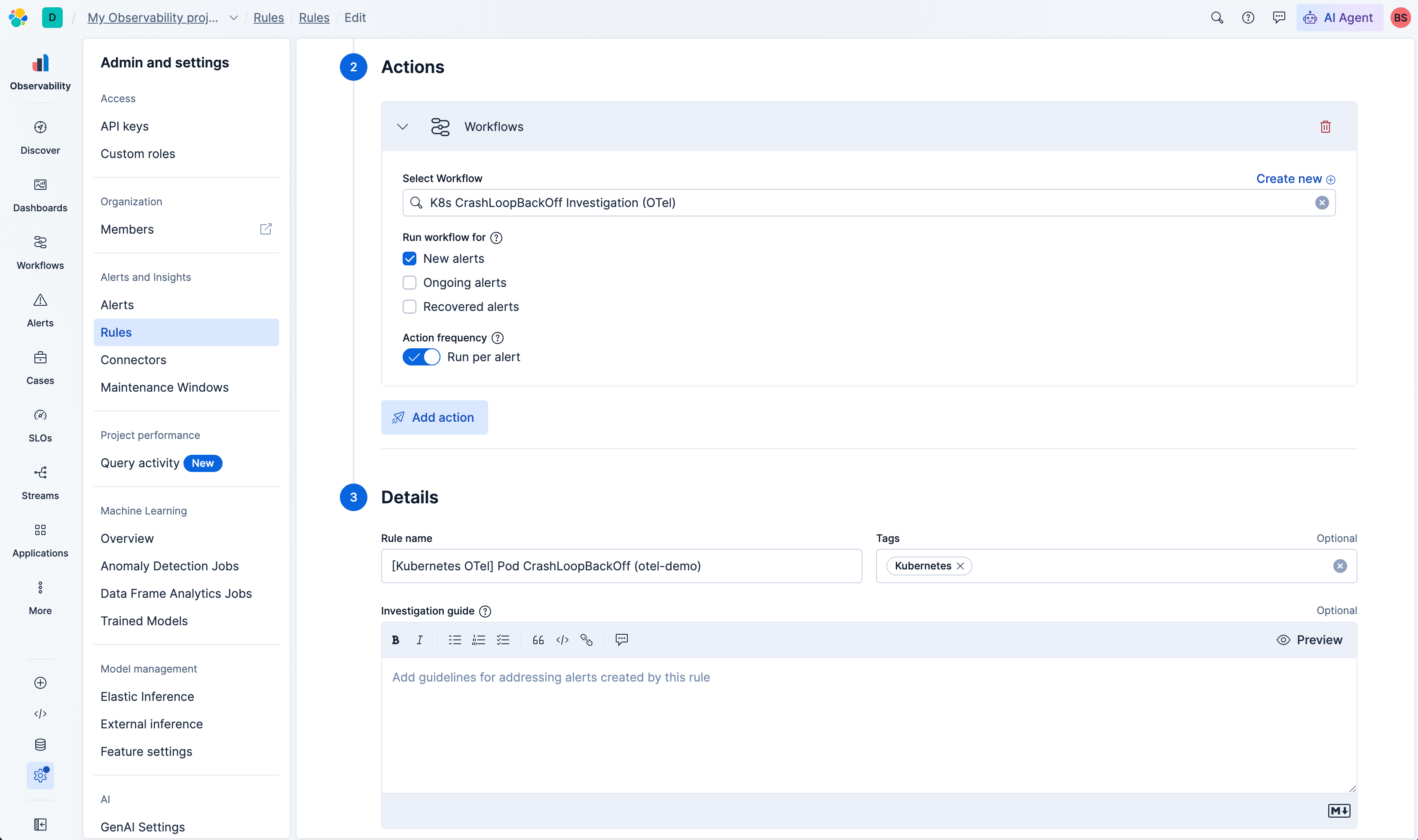

Elastic's Kubernetes integration ships pre-built alert rule templates for states that are wrong by definition; no baseline or warmup required. A pod in CrashLoopBackOff is always a problem, so the rule fires the moment the restart count crosses your configured threshold within a rolling window.
Here's the alert firing in this scenario, both the [Kubernetes OTel] Pod CrashLoopBackOff and OOMKilled containers rules light up for the recommendation group in the otel-demo namespace:
The alert itself is defined by an ES|QL query, so it's transparent and tunable; you can read exactly what triggers it and adjust the threshold to match your environment. And its action is what makes the rest of this post possible: the rule runs the K8s CrashLoopBackOff Investigation (OTel) workflow per alert, the instant a new alert fires. (For a refresher on the alert library and how these templates work, see Part 1.)
In this scenario the rule fires on the recommendation pod (recommendation-788dc88c6c-56w74) in the otel-demo namespace. When you open the alert, Elastic's AI Agent is already summarizing what happened; no rule-details spelunking required:
But the alert firing is only half the story. Attached to it is a Kubernetes Investigation Workflow (technical preview), a directed graph of steps that triggers the instant the alert does. While your phone is still buzzing, the workflow is already querying your cluster, branching on what it finds, and synthesizing an answer.

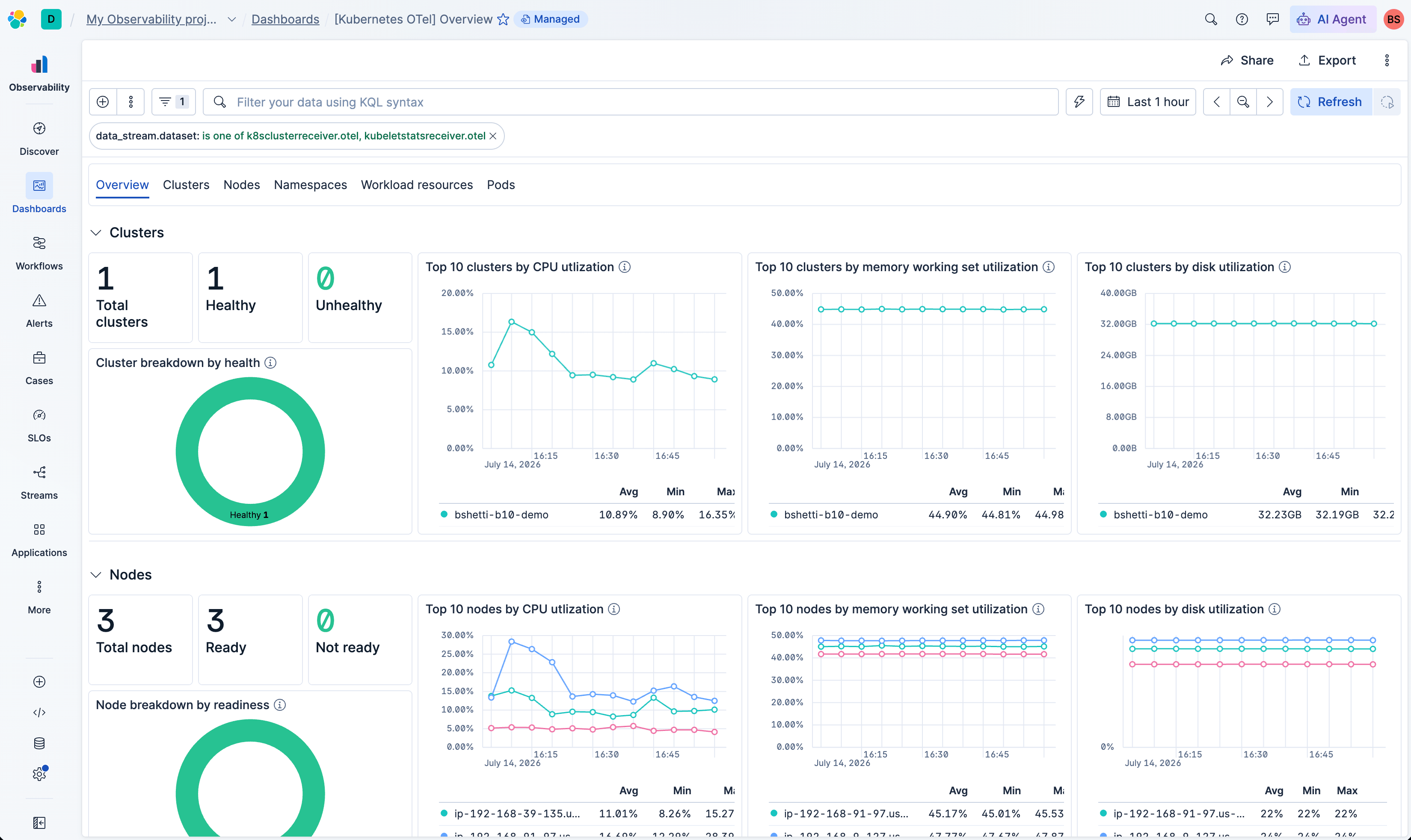

Dashboards — confirm the restart cascade visually. The Kubernetes dashboards are built for drill-down. Start at the cluster Overview, where "top namespaces by container restarts" surfaces the problem at a glance. Click into the flagged namespace, then the pod driving the restarts. The Pods view flags container restarts on the recommendation pod and plots memory against requests and limits over time — you'll see the working set pressing against the limit exactly as the workflow described. It's roughly four clicks from cluster to container.

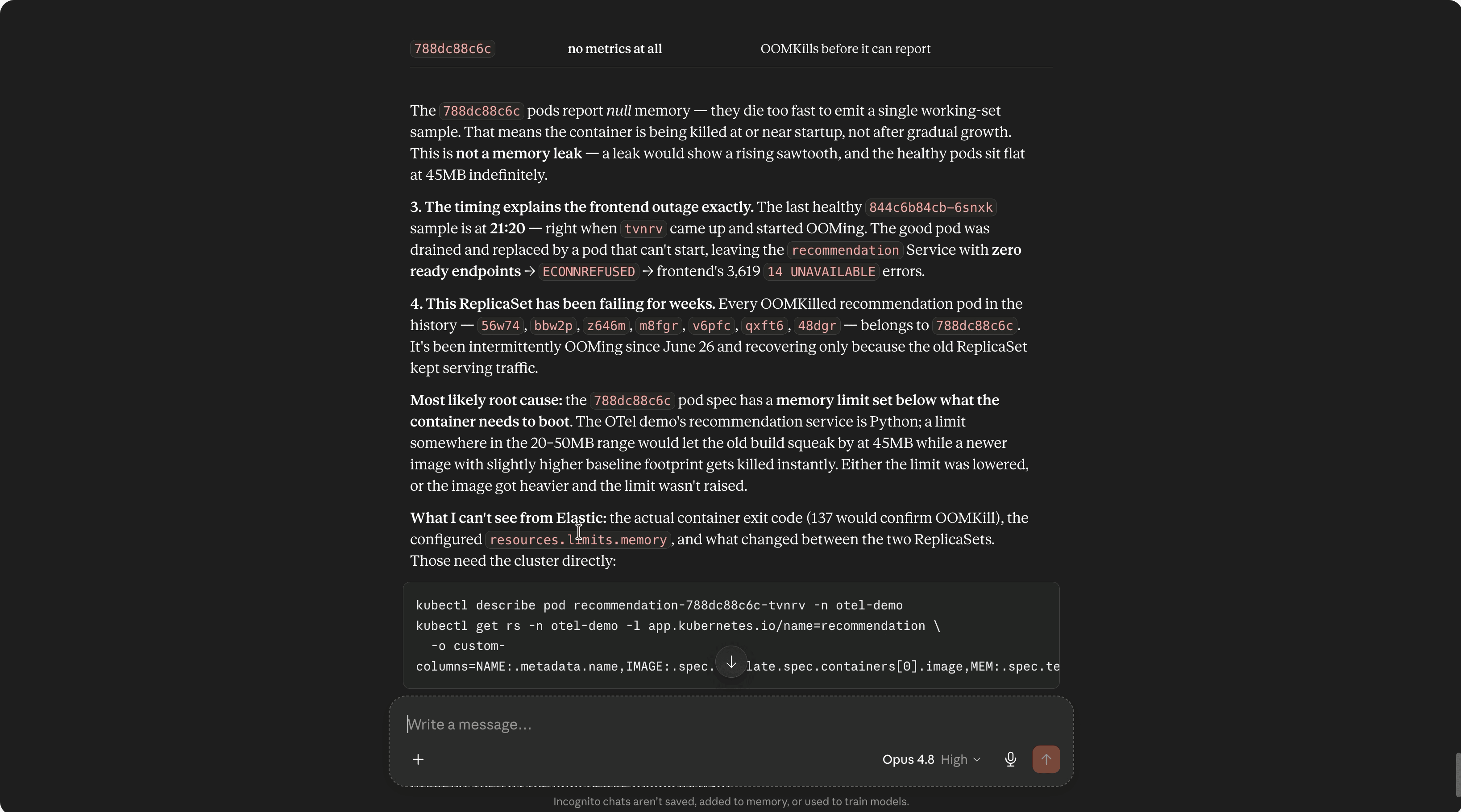

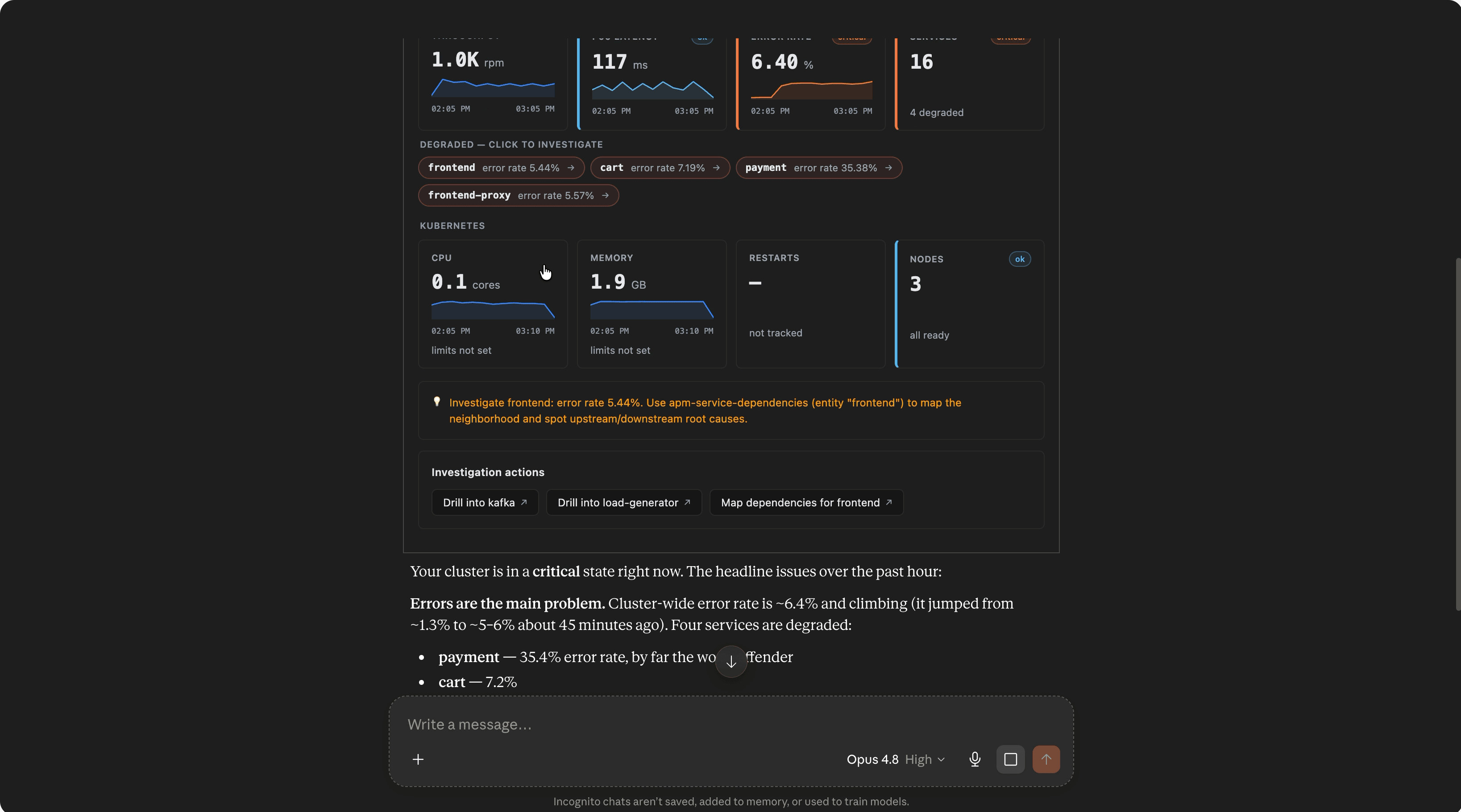

For our CrashLoopBackOff scenario, the flow looks like this from an MCP-compatible client such as Claude Desktop or VS Code:
"What's broken?" → the cluster health rollup returns an overall health badge, degraded services, top memory consumers, and a Kubernetes breakdown (CPU, memory, restarts, nodes) in one inline view. Here it flags a critical cluster with payment, cart, frontend, and frontend-proxy degraded.
"Is anything anomalous in the recommendation pod?" → the memory analysis view confirms the spike is load-driven, not a leak — the crashing 788dc88c6c pods report null memory (they die too fast to emit a sample) while the healthy pods sit flat at 45MB, exactly the ML result the workflow used.
"Why is the recommendation service crashing?" → the agent returns the same structured root-cause reasoning you'd see on the alert, rendered inline: memory limit set below what the container needs to boot, the ReplicaSet has been intermittently OOMing for weeks, and a concrete mitigation (roll back, then fix the limit), all without leaving the editor.
Same evidence, same root cause, delivered wherever you happen to be working. (For the full set of MCP App views and architecture, see Part 2.)
