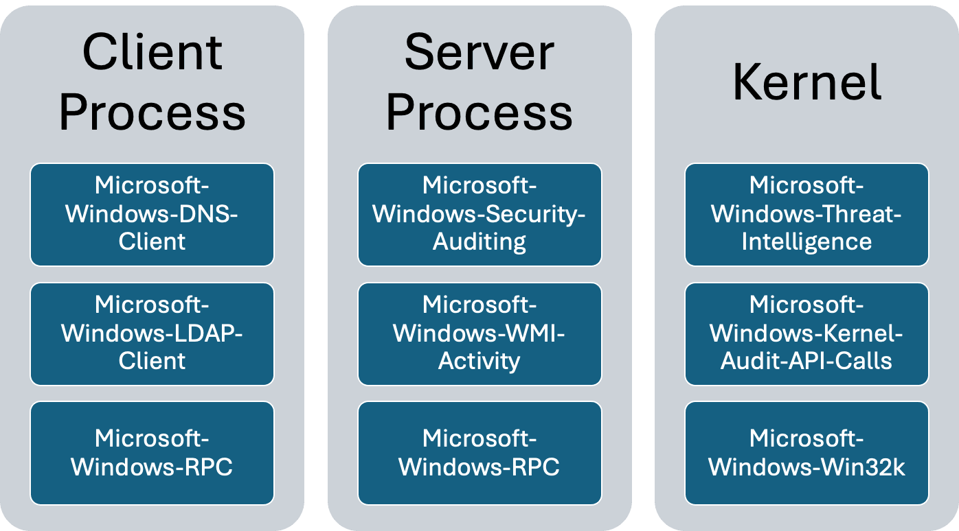

The first consideration is typically the reliability of the event provider itself - in particular, where the logging happens. Is it within the client process and trivially vulnerable to ETW tampering? Or is it perhaps slightly safer over in an RPC server process? Ideally, though, the telemetry will come from the kernel. Given the user-to-kernel security boundary, this provides stronger anti-tamper guarantees over in-process telemetry. This is Microsoft’s recommended approach. Like Elastic Endpoint, Microsoft Defender for Endpoint also uses kernel ETW in preference to fragile user-mode ntdll hooks.
For example, an adversary might be able to easily avoid an in-process user-mode hook on ntdll!NtProtectVirtualMemory, but bypassing a kernel PROTECTVM ETW event is significantly harder. Or, at least, it should be.
Sample ETW providers and where they are logged

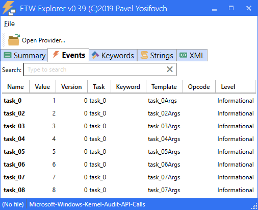

The events in Microsoft-Windows-Kernel-Audit-API-Calls are somewhat opaque

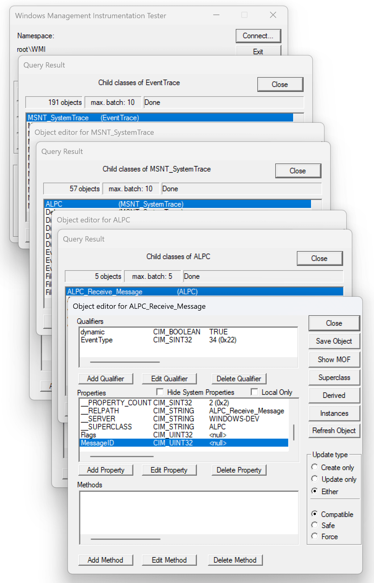

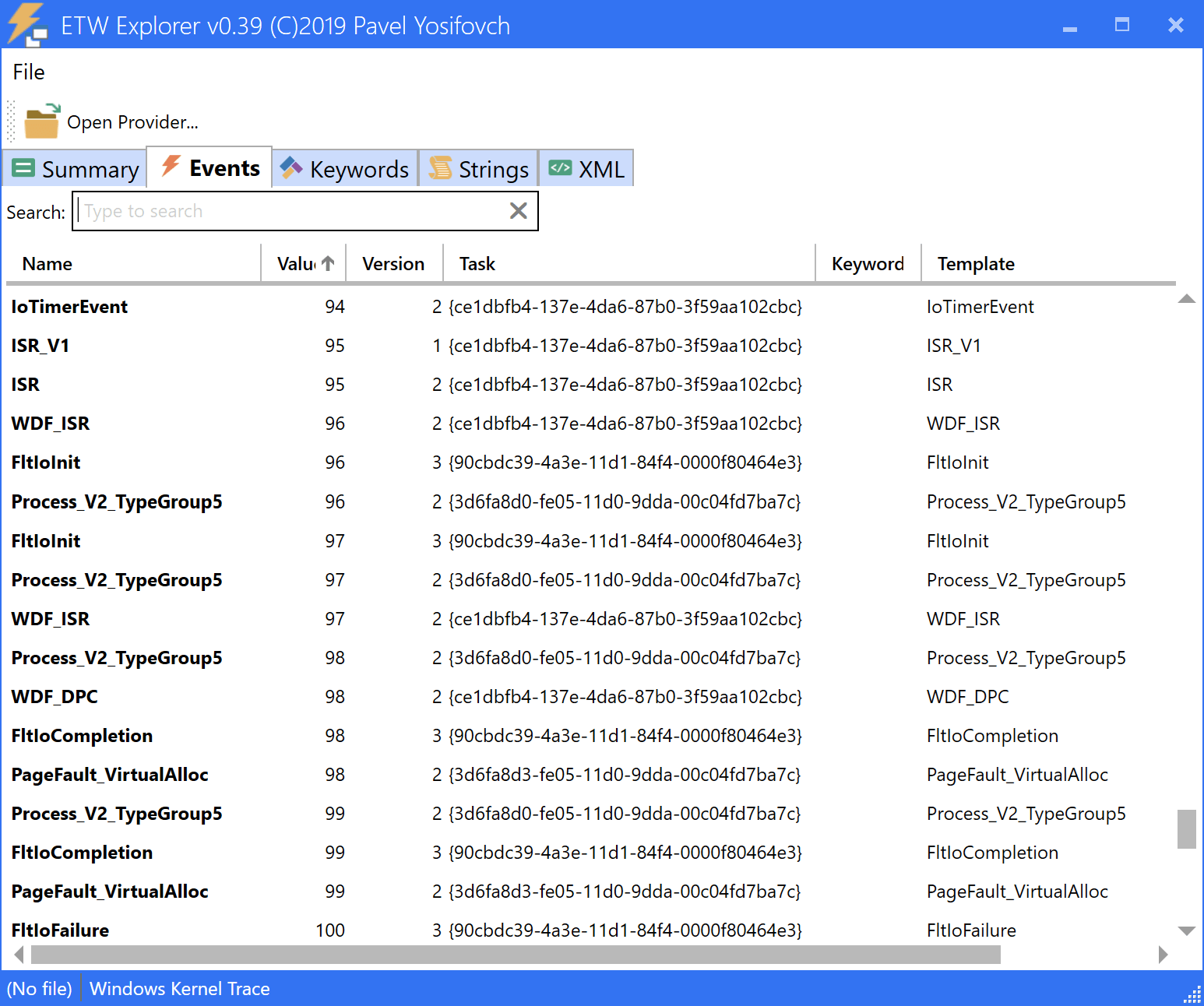

Legacy providers also exist within the operating system as WMI EventTrace classes. Providers are the root classes, groups are the children, and events are the grandchildren.
Enumerating MOF providers with wbemtest
To search the legacy events in the same way as modern eventTo search legacy events in the same way as modern events, these classes were parsed, and the original MOF (mostly) reconstructed. This MOF support was added to EtwExplorer, and tab-separated value summaries of the legacy events were these classes were parsed and the original MOF (mostly) reconstructed. This MOF support was added to EtwExplorer and tab-separated value summaries of the legacy events published.
Enumerating MOF providers with ETW Explorer
The fully reconstructed Windows Kernel Trace MOF is here (or in a tabular format here).

And thankfully, the parameters are almost always well-named. We might guess that task_05 in Microsoft-Windows-Kernel-Audit-API-Calls is related to OpenProcess since it logs fields named TargetProcessId and DesiredAccess.

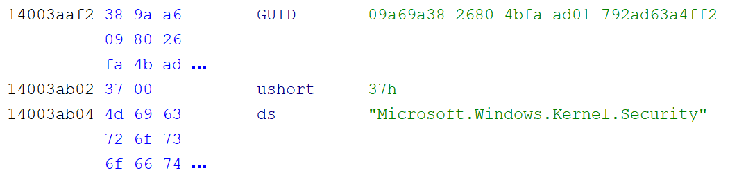

TraceLogging metadata is stored as an opaque blob within the logging binary. Thankfully this format has been reversed by Matt Graeber. We can use Matt’s script to dump all TraceLogging metadata for ntoskrnl.exe. A sample dump of Windows 11 TraceLogging metadata is here.
Unfortunately, the metadata structure alone doesn’t retain the correlation between providers and events. There are interesting provider names, such as Microsoft.Windows.Kernel.Security and AttackSurfaceMonitor, but it’s not yet clear from our metadata dump which events belong to these providers.

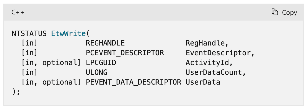

For kernel ETW, we are particularly interested in EtwWrite calls that are reachable from system calls. We want as much of the call site parameter information as possible, including any associated public symbol information. This meant that we needed to walk the call graph but also attempt to resolve the possible values for particular parameters.
alt_text
EtwWrite documentation

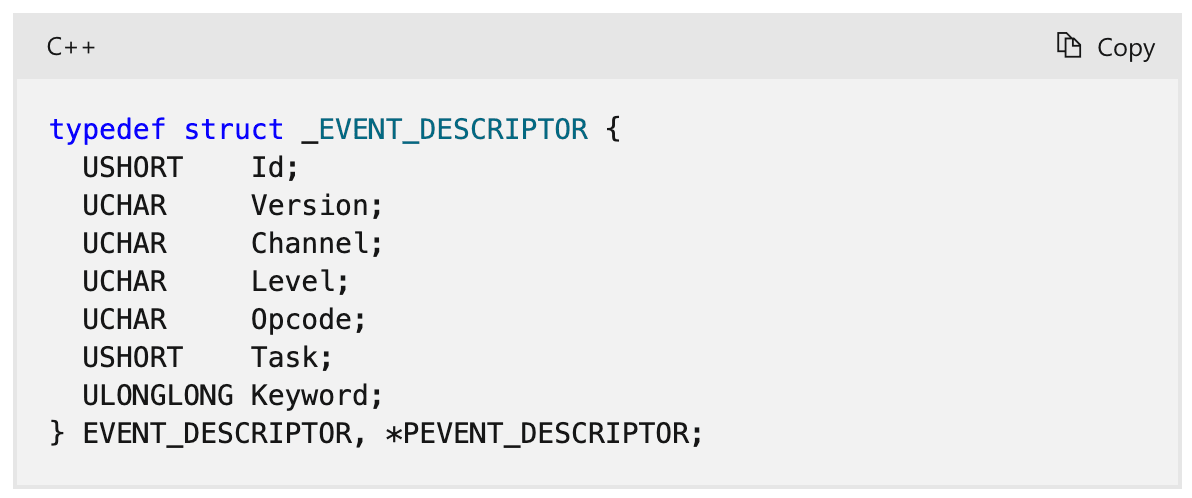

The necessary parameters were the RegHandle and the EventDescriptor. The former is an opaque handle for the provider, and the latter provides event-specific information, such as the event id and its associated keywords. An ETW keyword is an identifier used to enable a set of events.

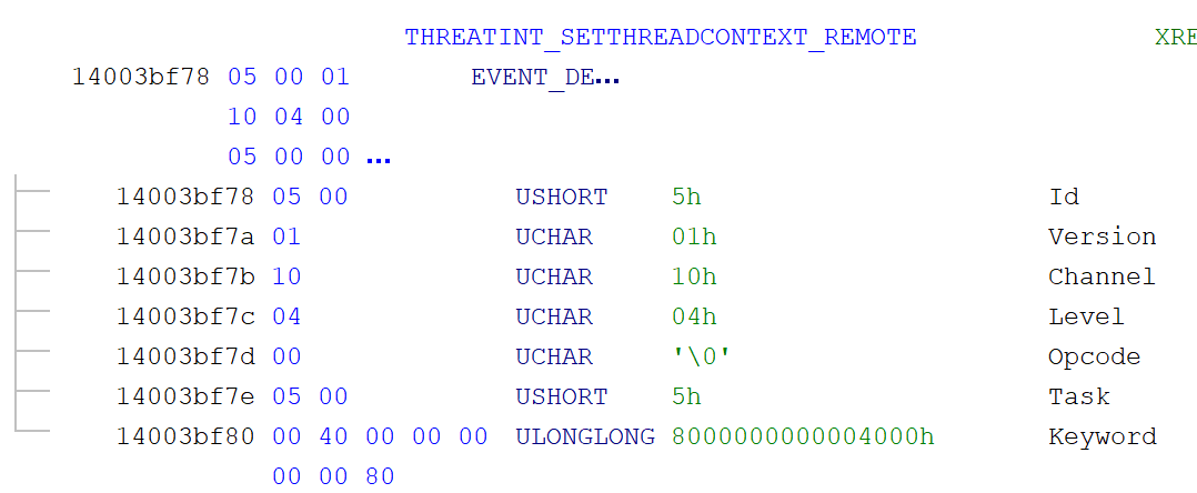

Even better, these event descriptors were typically stored in a global constant with a public symbol.
Example ntoskrnl.exe EVENT_DESCRIPTOR in Ghidra

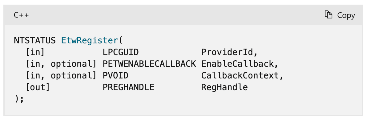

We had sufficient event metadata but still needed to resolve the opaque provider handle assigned at runtime back to the metadata about the provider. For this, we also needed the EtwRegister calls.
EtwRegister documentation
Example ntoskrnl.exe EtwRegister in Ghidra
The typical pattern for kernel modern event providers was to store the constant provider GUID and the runtime handle in globals with public symbols.

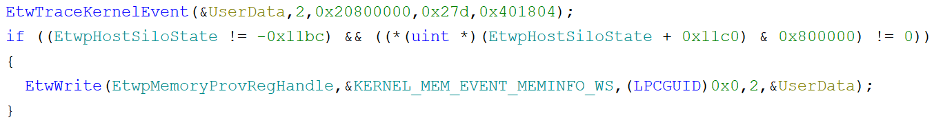

This just left the legacy providers. They didn’t seem to have either public symbols or metadata blobs. Some constants are passed to an undocumented function named EtwTraceKernelEvent which wraps the eventual ETW write call.
Example legacy provider EtwTraceKernelEvent call in Ghidra

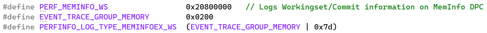

Those constants are present in the Windows 10 1511 WDK headers (and the System Informer headers), so we could label these events with the constant names.
ntwmi.h extract

Our previously anonymous Microsoft-Windows-Kernel-Audit-API-Calls events are quickly unmasked by this script.
IdEVENT_DESCRIPTOR SymbolFunction
1KERNEL_AUDIT_API_PSSETLOADIMAGENOTIFYROUTINEPsSetLoadImageNotifyRoutineEx
2KERNEL_AUDIT_API_TERMINATEPROCESSNtTerminateProcess
3KERNEL_AUDIT_API_CREATESYMBOLICLINKOBJECTObCreateSymbolicLink
4KERNEL_AUDIT_API_SETCONTEXTTHREADNtSetContextThread
5KERNEL_AUDIT_API_OPENPROCESSPsOpenProcess
6KERNEL_AUDIT_API_OPENTHREADPsOpenThread
7KERNEL_AUDIT_API_IOREGISTERLASTCHANCESHUTDOWNNOTIFICATIONIoRegisterLastChanceShutdownNotification
8KERNEL_AUDIT_API_IOREGISTERSHUTDOWNNOTIFICATIONIoRegisterShutdownNotification
Symbol and containing function for Microsoft-Windows-Kernel-Audit-API-Calls events
