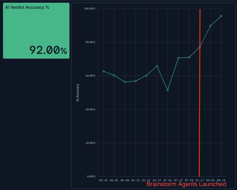

Before getting too in the weeds, here’s the data. Our AI verdict correctness (based on comparing the AI verdict and the analyst close reason) went from 60% to 92% after implementing the changes we discuss in this blog. We’re tracking these metrics using Elastic dashboards by comparing the case custom fields that are discussed more below. This increase in accuracy meant that the analysts could start double-checking the summary and closing the case right away. This changed our AI summaries from being a time sink to allowing our analysts to close the case in one step.
Elastic dashboard showing AI verdict accuracy rising from 60% to 92% after the Brainstorm agents launched.

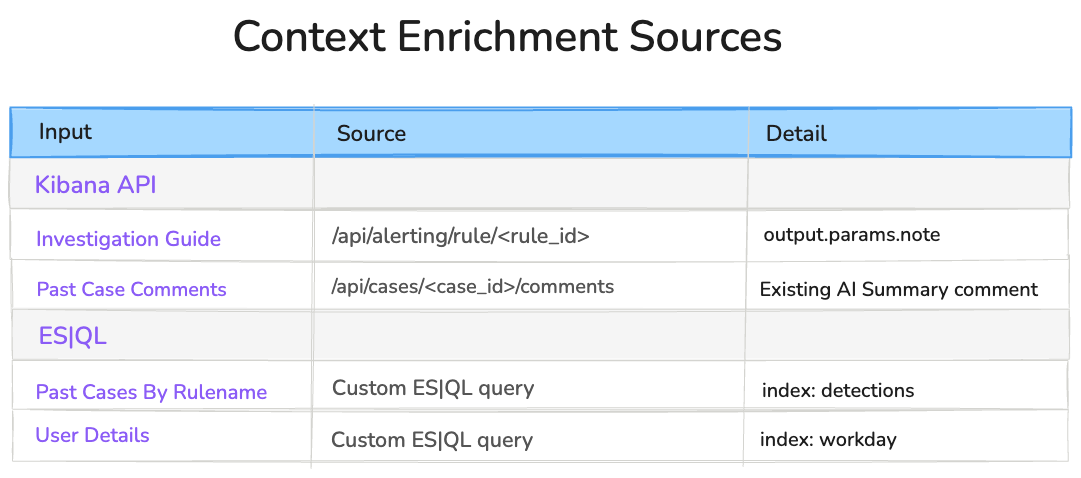

What context AI alert triage actually needs
We significantly increased agent accuracy by feeding them more context. Here's what we pull in from each source before an agent makes a verdict:
Context enrichment sources for AI alert triage: Kibana API and ES|QL lookups with index and endpoint detail.

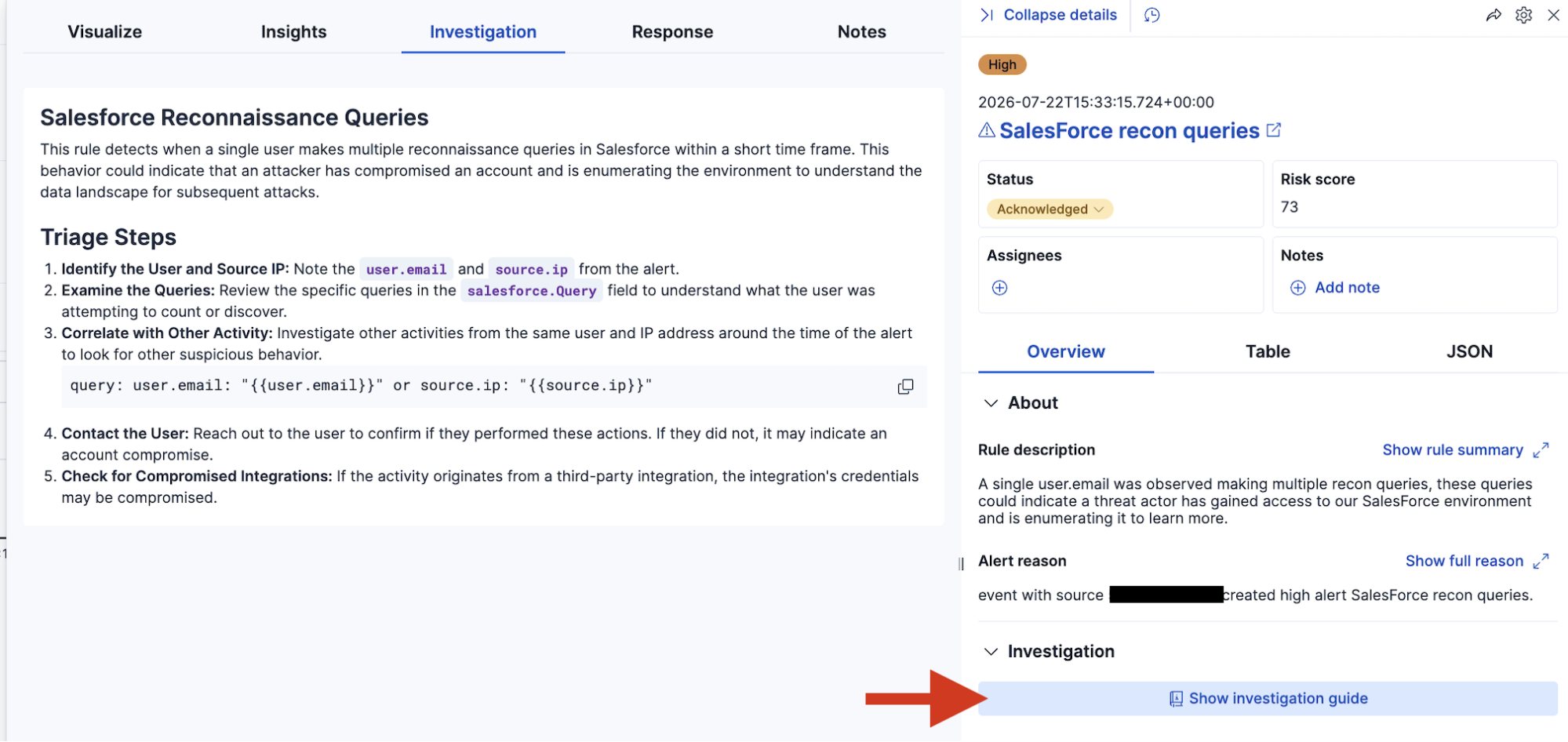

Investigation guide lookup: Per-rule triage instructions
Using the kibana.alert.rule.uuid, we can do a GET request to /api/alerting/rule/\<kibana.alert.rule.uuid\> to grab the investigation guide attached to the detection rule that triggered the alert. Here, we can provide context to both the analyst and our AI agents. Our detection engineers fill out these investigation guides when creating the detection, sometimes separating the analyst sections and AI sections with notes to follow. This gives us specific, per-rule instructions so the AI triages each alert type the same way every time. Here's where to find the investigation guide on a rule:
Navigating to the alert’s associated investigation guide.

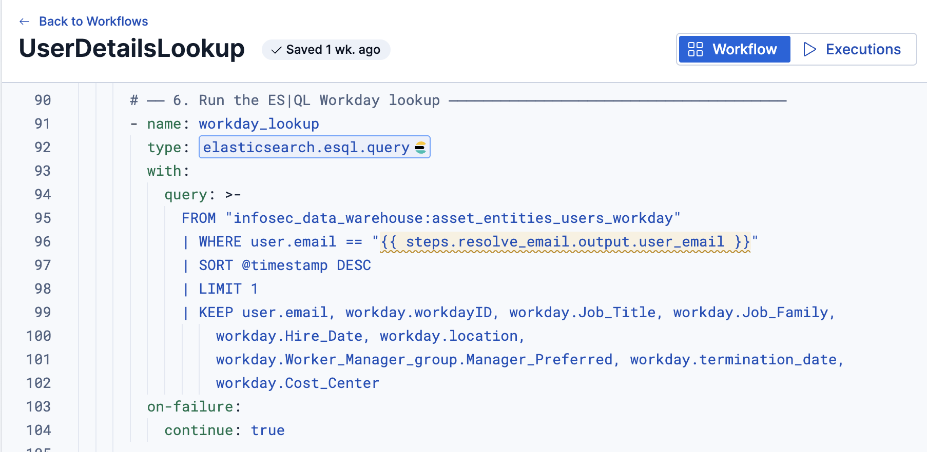

The user details lookup: Finding high-risk users
We look up user details in Workday using the user.email field from the alert. This gives us context on high-risk users, for example:
  • Users who have joined the company in the last 90 days.
  • Users who are leaving the company in the next 90 days.
  • Cost centers that carry elevated risk (for example, help desk, security researchers).
Kibana workflow on UserDetailsLookup.

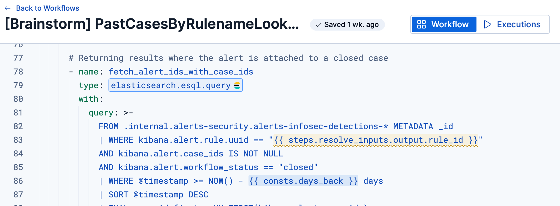

Past cases by rule name: What verdict did the analyst choose?
We look up alerts with the same kibana.alert.rule.uuid from the last 30 days that have been tied to cases and closed. This gives our agents a historical baseline. If this rule has fired 50 times and 48 were false positives, that's critical context. An agent that knows the history of a rule makes significantly better verdicts than one that doesn't.
Kibana workflow on PastCasesByRulenameLookup.

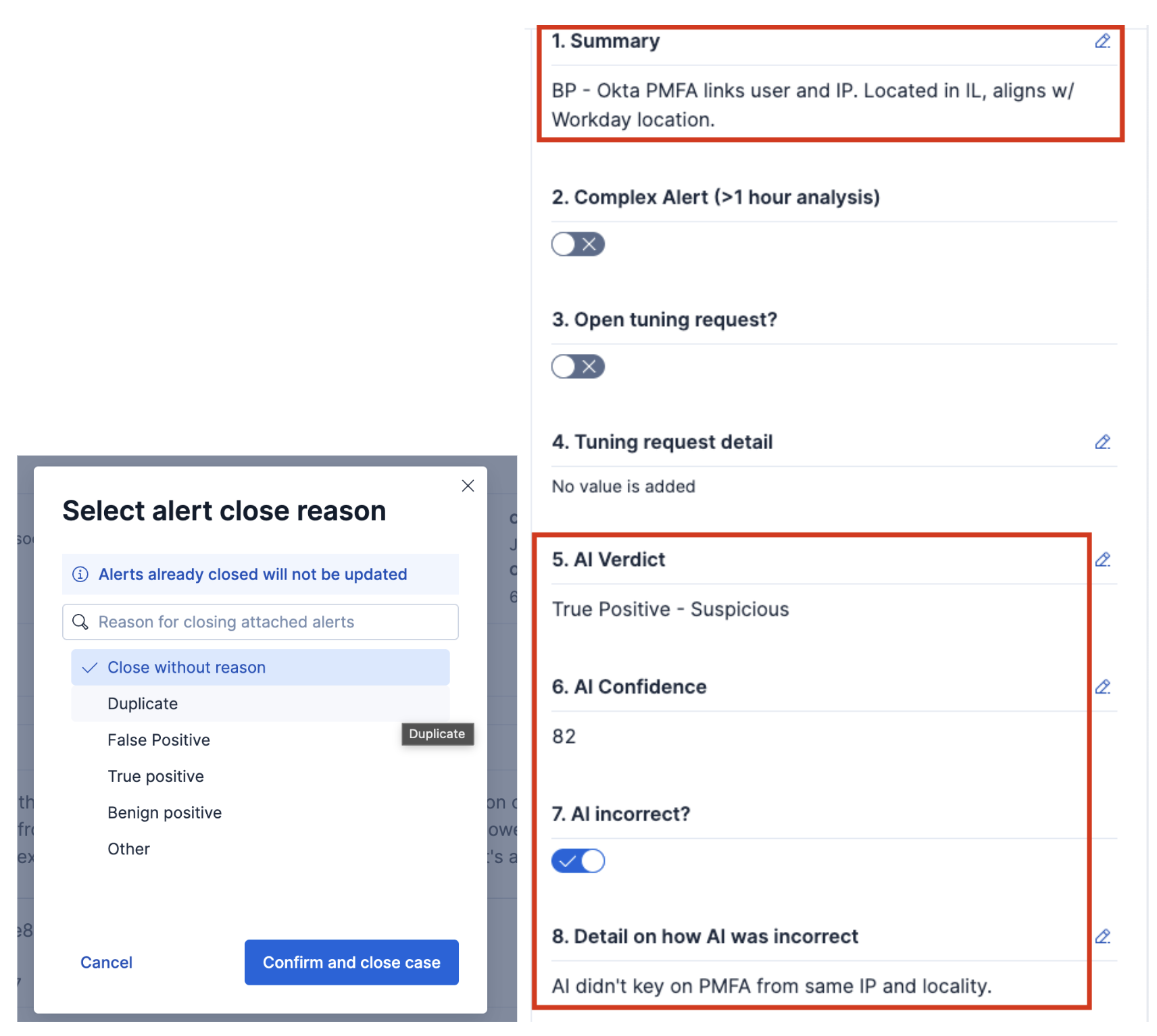

Using the cases we've seen in the last 30 days, we pull the fields that tell us how analysts actually closed them, the verdict they chose, their summary of the activity, and whether the AI got it right. These are the signals that close the loop:
Analyst-selected close reason and custom fields displayed on Kibana Cases.

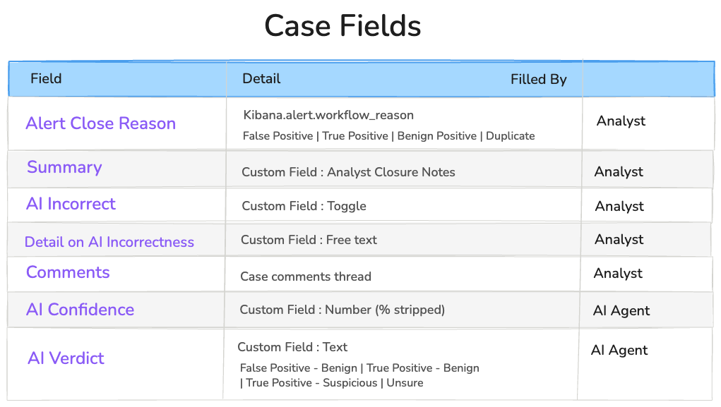

The AI feedback loop: How agents learn from wrong verdicts
Using the data returned from the PastCasesbyRulenameLookup, if the analyst selects False Positive but the AI verdict was True Positive - Suspicious in previous cases, our agents can reference the analyst closure notes and case comments to understand why the previous verdict was incorrect. This context is fed to the agent before it makes a decision on the new case.
Case fields table showing which alert triage fields are filled by the analyst and which by the AI agent.
The AI Incorrect? custom field toggle is optional. An analyst can select it and fill out why they feel the AI verdict was wrong in the 'Detail on AI Incorrectness' custom field. If the AI verdict itself was correct but the “AI Generated Summary” case comment went in the wrong direction, the analyst can also explain here where the comment was incorrect. Even without this field, we can determine AI verdict correctness because the two AI agent–generated fields (AI Confidence and AI Verdict) are always on the alert via the workflows shown here, and the analyst is required to pick a closure reason. Our automation team pulls these custom fields from Kibana cases into a dashboard so we can track incorrect verdicts over time by comparing the analyst closure reason and AI verdict to tune our agent prompts or provide additional context where needed.
Here's the feedback loop in action, where our Pattern Finder Agent catches its own overclassification pattern in previous cases and surfaces tuning requests already filed against this rule:
Real example of mistake auto-correction under AI Generated Summary case comment.

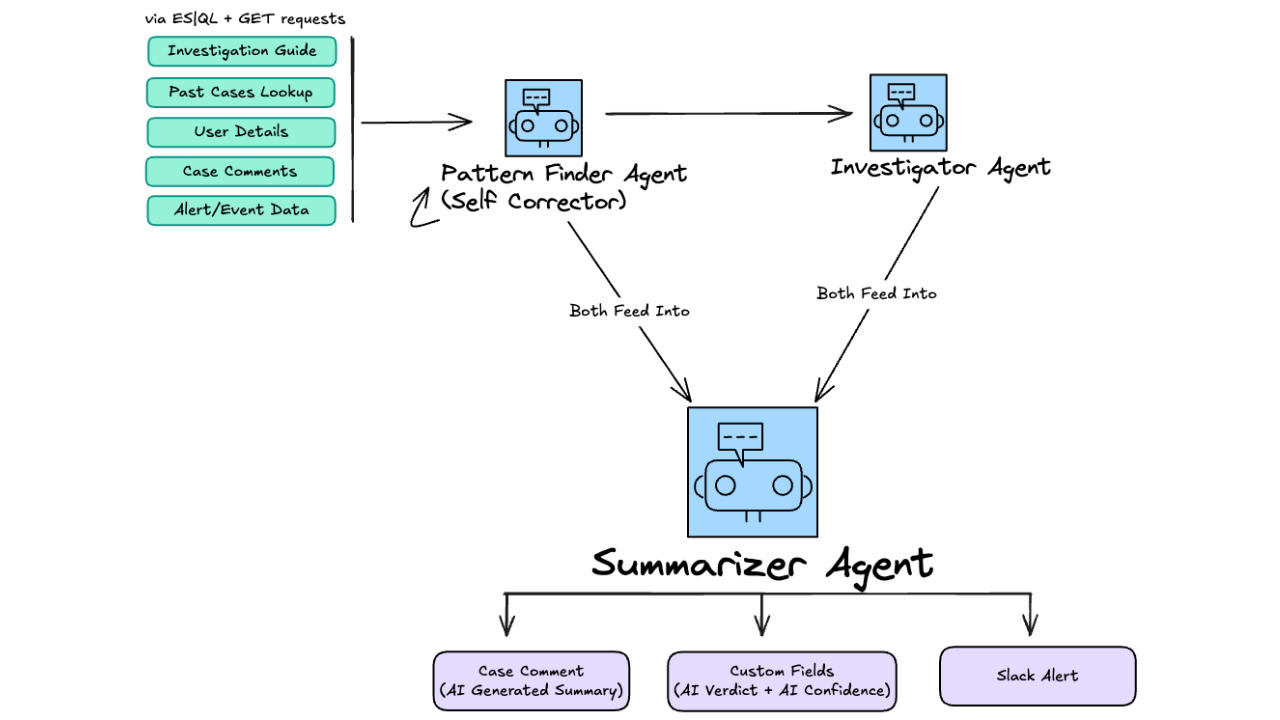

How the agentic SOC pipeline runs in Elastic Workflows

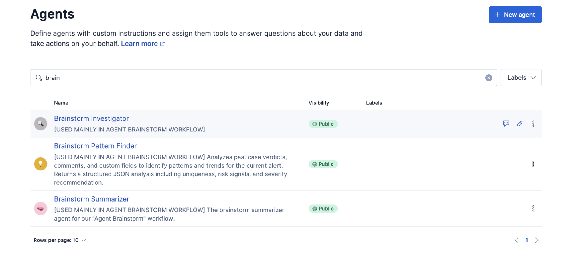

We have one overarching Elastic workflow, Agent Brainstorm, that orchestrates 12 child workflows (and growing). The name reflects what's happening inside: one parent workflow (Agent Brainstorm), many context lookups, and three agents working together to reach a combined AI-generated case summary.
Kibana Agent Builder setup with three agents.
AgentTools assignedInputsOutputExternal queries
Pattern FinderNoneUser details, investigation guide, past cases, current eventJSONNo
L1 InvestigationYesPattern JSON, investigation guide, current alertStructured reportYes
SummarizerNoneInvestigator report, pattern JSON, investigation guide, ES|QL queriesMarkdown for Slack and CasesNo

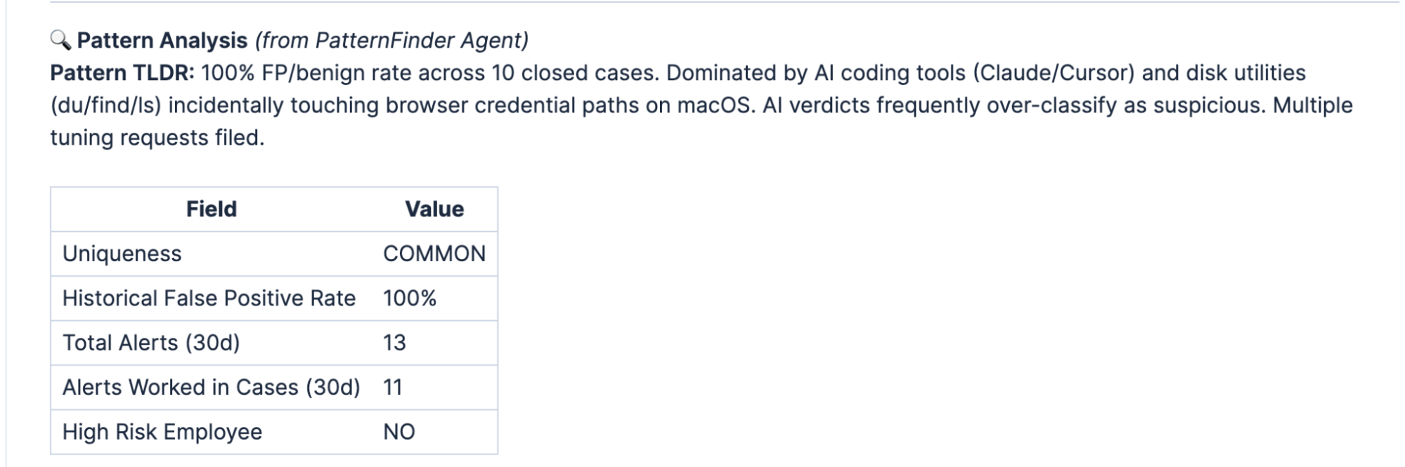

Pattern agent: Finding patterns across closed cases
Our Pattern Finder Agent takes in many inputs (user details, investigation guide, past case records, details about the current event) and makes pattern comparisons across historical cases. This agent has no tools assigned to it in Agent Builder and doesn’t make any external queries. (It only uses the data given to it.) That makes this agent much faster and ensures that the behavior cannot be overridden by injected content. Here’s a snippet of the prompt where we talk about our feedback loop:
    ## AI Notes on Patterns
        Look for patterns across these fields in past_case_records:
        - workflow_reason (benign_positive, true_positive, etc.) This is the ANALYST PICKED result and should be seen as the truth.
        - custom_field_ai_verdict. This is picked by AI - Is AI usually correct on this type of case?
        - custom_field_ai_confidence. This is picked by AI - Is AI usually correct on this type of case?
        - custom_field_ai_incorrect_analyst_bool - This is a boolean the analyst can choose to say that AI was incorrect here.
        - custom_field_summary - This is written by an analyst on why they closed the case. This should be seen as the truth.
        - comments_text (analyst comments and AI summaries)
        - user_id, user_name, user_email (repeat offenders?)
        - source_ip, host_name (recurring infrastructure?)
        - If there is another case with the exact same type of activity, ALWAYS add the case # and a link to the case so we can reference it.
        - Also consider inputs.user_job_family and inputs.user_job_title when assessing whether the alert pattern makes sense for this user type.
At the end of the prompt, we have it return its findings in JSON format:
 ## Required Output Format
        Respond with ONLY a valid JSON object, no markdown, no explanation:
          "percentage_false_positive_or_benign_last_50_cases": "<X>%",
          "number_of_total_alerts": <inputs.total_alerts_for_rule>,
          "number_of_alerts_worked_in_cases": <inputs.total_closed_with_cases>,
          "uniqueness": "RARE or COMMON",
          "high_risk_employee": "NEW HIRE or LEAVING SOON or NO",
          "job_title": "<inputs.user_job_title or unknown>",
          "cost_center": "<from user details or unknown>",
          "ai_notes_on_patterns": "<your pattern analysis here>",
          "ai_pattern_TLDR":"<shortened_version_if_notes_long>",
          "recommendation_for_severity": "medium or high or critical"
          "explanation_on_severity_change_or_no": "<explanation_here>"

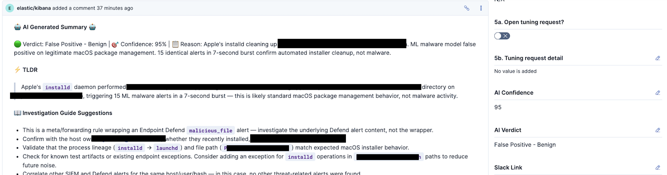

Summarizer Agent: Writing the case comment that analysts read
The Summarizer Agent is responsible for formatting the final AI summary that analysts see in the case comment. Like the Pattern Finder Agent, it has no tools assigned to it in Agent Builder and works only from data passed to it. This keeps it fast. Each time a new alert comes in for the same case, we rerun the Agent Brainstorm workflow and replace the case comment only if it provides a new verdict or new important evidence; otherwise, we skip it. We allow the summarizer to keep replacing itself up until the case is assigned to an analyst, at which point we stop.
Here’s a snippet of the summarizer prompt:
# Role & Objective
You are an expert InfoSec report formatter at Elastic. You receive a structured investigation report from the Investigator agent and a pattern analysis from the PatternFinder agent. Your sole job is to combine these into a high-fidelity Markdown summary formatted for Slack. You run NO queries and make NO investigative decisions — all findings and verdicts come from the Investigator and PatternFinder.
You will also receive:
- `INVESTIGATOR_REPORT` — the full structured output from the Investigator agent
- `PATTERN_FINDER_OUTPUT` — the JSON analysis from the PatternFinder agent
- `INVESTIGATION_GUIDE` - the investigation guide attached to the alert that gives suggestions to analyst and AI on how to handle this case
- `ESQL_QUERIES` — comma-separated ES|QL query strings run during investigation, to be formatted as reference links
Then we ask it to build an output template to post to the case comment:
# Final Output Template
🤖 **AI Generated Summary** 🤖
`<emoji> Verdict: <verdict> | 🎯 Confidence: <0–100%> | 📋 Reason: <max 50 words> |`
**⚡ TLDR**
> {1-2 sentences max. Who did what, on what system, and what the verdict is. Written for an analyst who has 5 seconds. No jargon, no hedging.}
** Investigation Guide Suggestions** (only include if it is present)
- Quick summary of what the analyst should do next based on the investigation guide or how to confirm this activity. Use bullet points if possible
....shortened for purposes of this blog...

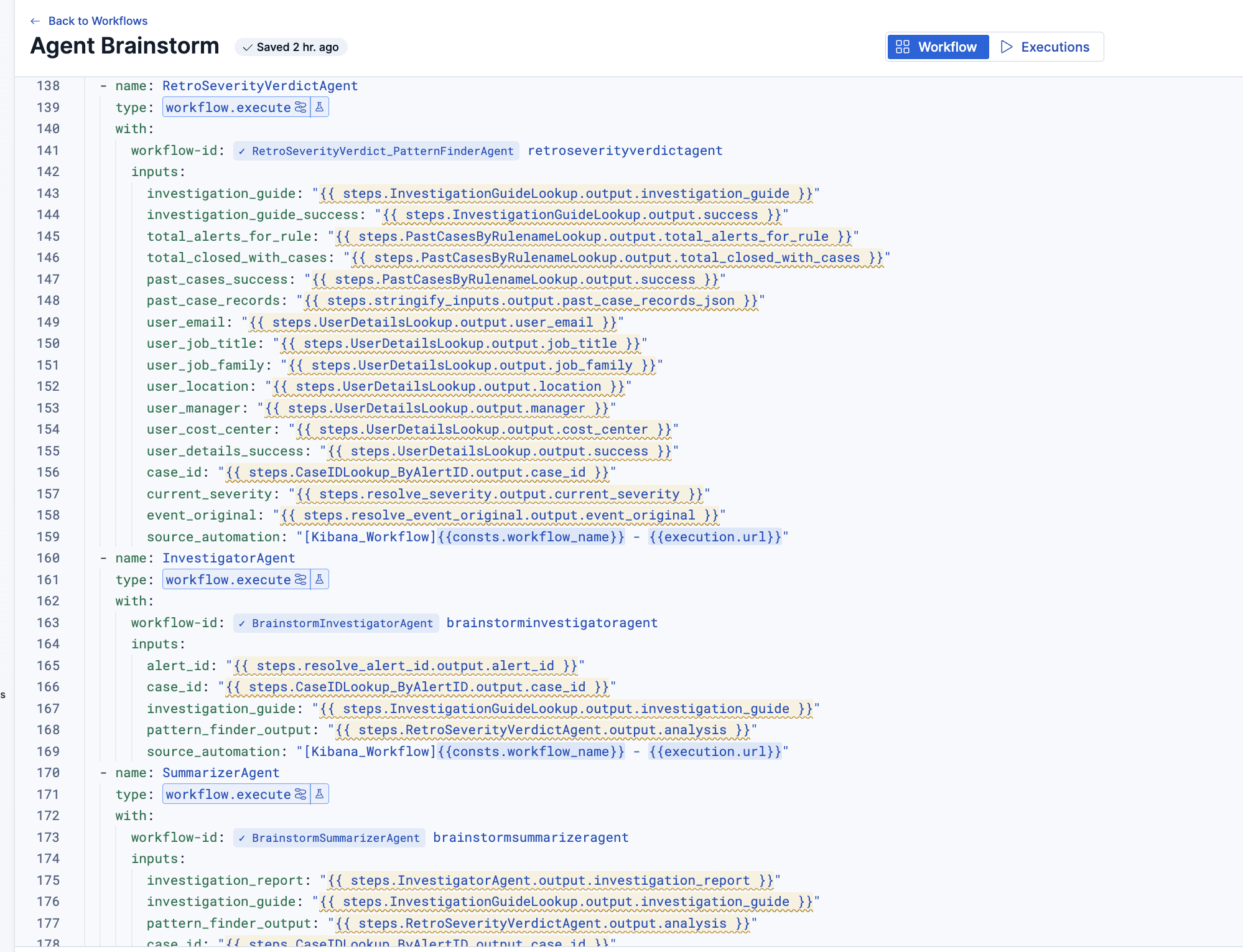

Now that we’ve reviewed each agent's role, here's how they're configured in workflow YAML. Each agent is executed one after the other in a synchronous way, waiting for the one above it to finish:
YAML setup of our three agents in the Agent Brainstorm workflow.
We use two workflows to make POST requests at the end of the Agent Brainstorm to attach the generated final AI summary to both the Kibana case and Slack. Below are some real examples from our environment:

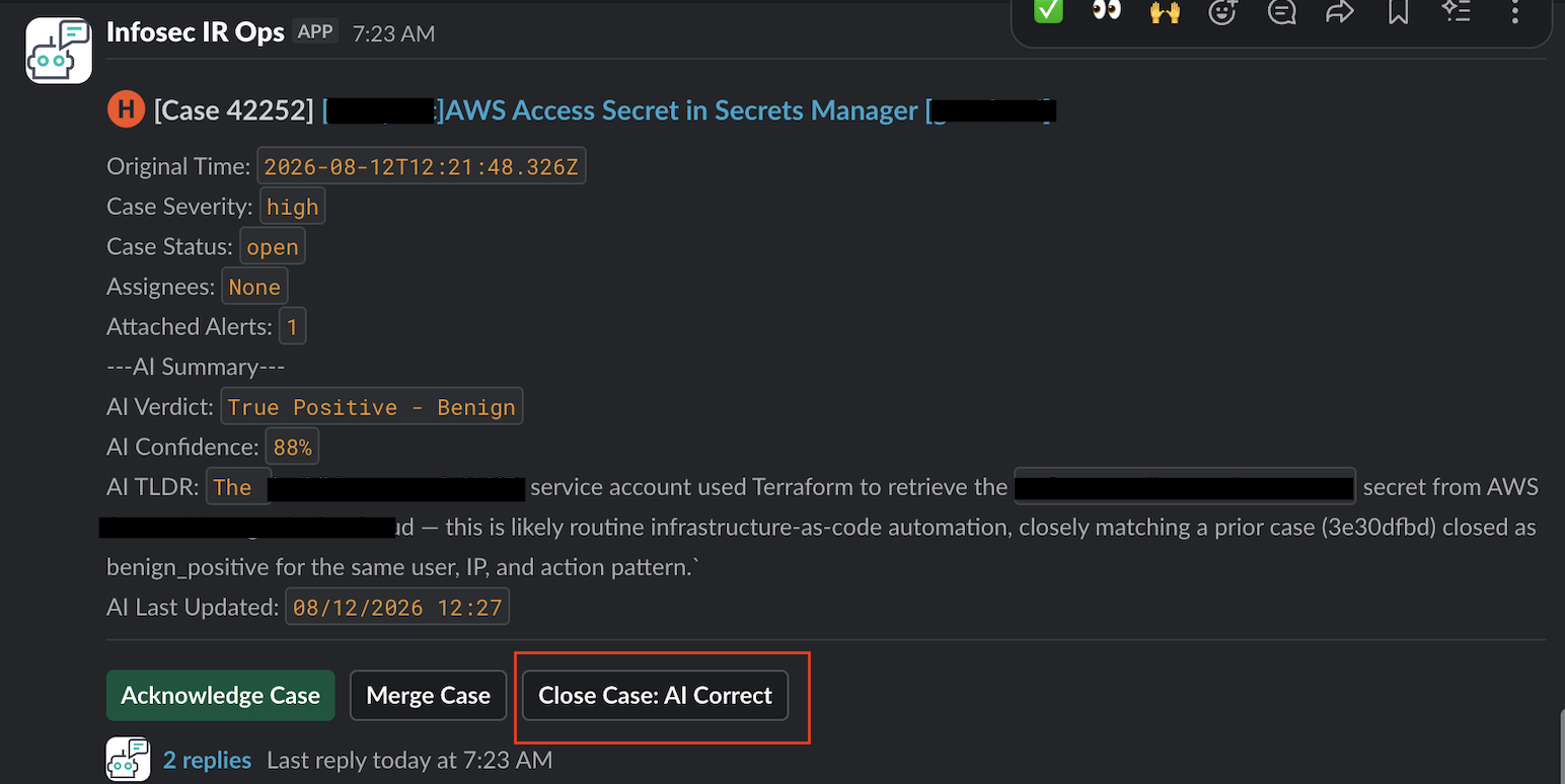

We send alert details to our team Slack channel so that we can monitor the alerts from our phone. Our Slack bot in this channel allows us to perform activities, like Acknowledge Case or Merge Case, all from Slack, allowing us to quickly take action, even directly from a mobile device. After implementing the work in this blog, we added the Close Case: AI Correct button, which you can click to trigger a workflow that assigns you to the case, fills out the closure notes, tags the case, and closes it.
Slack message with AI Verdict added.
