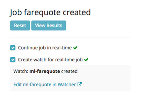

Clicking on the Apply button registers the watch, and gives you a link to edit the watch for further customization:
ML_watch3
