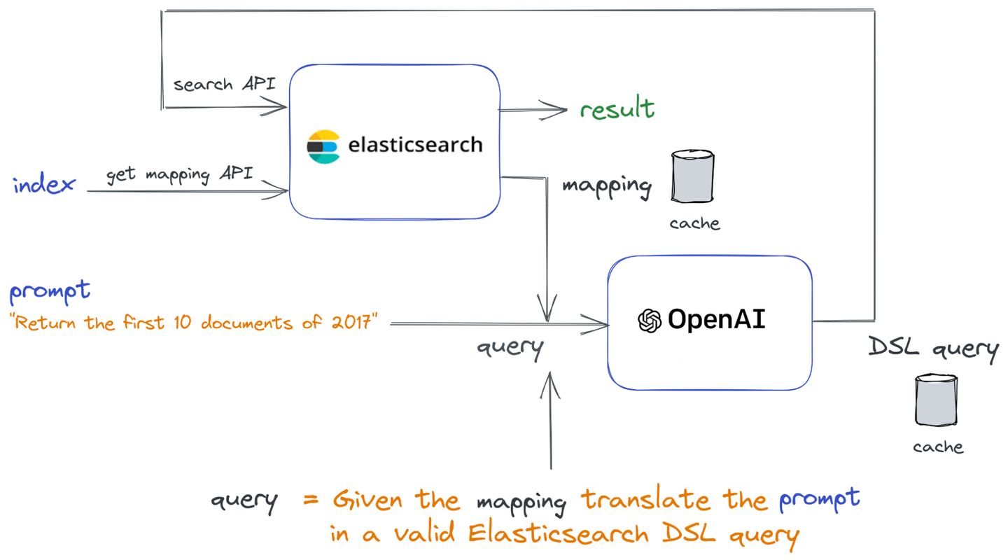

The process of this function is reported in the following diagram:
The inputs are index and prompt (on the left). The index is used to retrieve the mapping from Elasticsearch (using the get mapping API). The result is a mapping in JSON that is used to build the query string to send to ChatGPT using the following API code. We used the gpt-3.5-turbo model of OpenAI that is able to translate in code.
The result from ChatGPT contains an Elasticsearch DSL query that we use to query Elasticsearch. The result is then returned to the user. To query Elasticsearch, we utilized the official elastic%2Felasticsearch-php client.
To optimize response time and reduce the cost of using the ChatGPT API, we used a simple caching system based on files. We used a cache to:
  • Store the mapping JSON returned by Elasticsearch: We store this JSON in a file named after the index. This allows us to retrieve the mapping information without making additional calls to Elasticsearch.
  • Store the Elasticsearch DSL generated by ChatGPT: To cache the generated Elasticsearch DSL, we named the cache file using the hash (MD5) of the prompt used. This approach enables us to reuse previously generated Elasticsearch DSL for the same query, eliminating the need to call the ChatGPT API again.
We also added the possibility to retrieve the Elasticsearch DSL programmatically using the getLastQuery() function.
