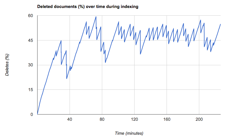

I was curious how effective its defaults are in practice, so I ran a simple worst-case indexing test. First, I built an initial index with 100 M added documents (no deletions) derived from Wikipedia's English export. Then I updated that index by forever randomly replacing an existing document (never adding a new document), so that every add also incurs a deletion.
There was no pattern to the updates, such as favoring replacing older or newer documents. This is unrealistic, but it is a good worst case test because the deletes accumulate uniformly, in proportion to each segment's size. In real usage, certain segments (old or new) would accumulate deletions at a faster rate and thus be more quickly selected for merging.
I measured the percentage of deleted (but not yet merged away) documents over time, computed as maxDoc/numDocs - 1.0 (where numDocs is constant at 100 M in my test). The graph below shows an initial startup transient, when the percentage quickly rise from 0% to 45% at which point a couple of large merges complete and bring it back down. After that the deletions percentage hovers between 35% and 60%, with a sawtooth shape showing a sudden drop whenever varying sized merges finish. It looks somewhat like the stock market!
A maximum sized segment (default: 5 GB) will only be eligible for merging once it accumulates 50% deletions. If this is too slow for your usage, try decreasing that maximum (index.merge.policy.max_merged_segment): this will result in a somewhat larger segment count, but the reclaiming should happen more quickly, especially when there is a pattern to the deletions.
