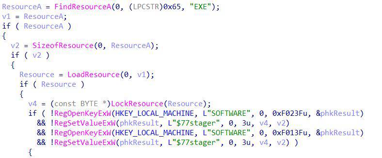

Its first task is to store the stager module PE in the registry, a technique commonly used by malware authors to persistently store their malicious code on a system. Once the stager module is stored in the registry, the installer module builds a PowerShell command that loads the stager module from the registry and executes it, the installer module then creates a scheduled task to run the PowerShell command.
The installer locates the stager module stored as a PE resource named EXE , it then creates a new registry key called $77stager in the HKEY_LOCAL_MACHINE\SOFTWARE hive and writes the stager module to the key.

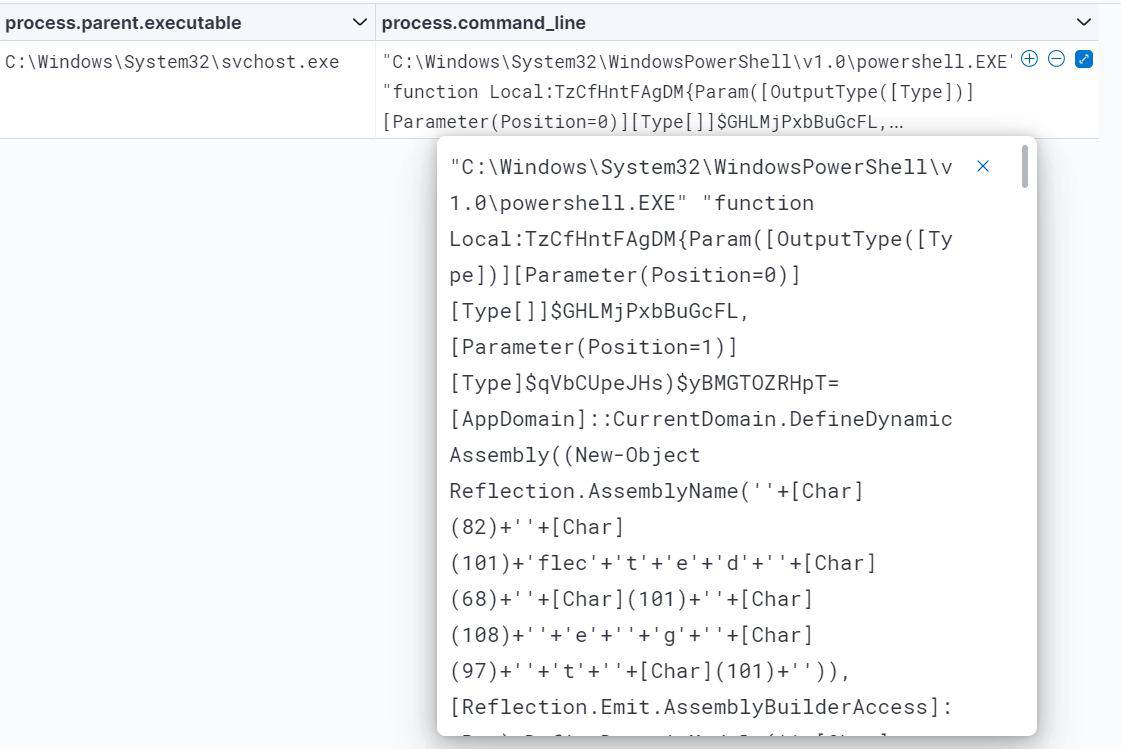

The installer then builds a PowerShell command to reflectively load the .NET stager in memory, using the [Reflection.Assembly]::Load method. Additionally, Microsoft’s Antimalware Scan Interface (AMSI) is circumvented by patching the AmsiScanBuffer API so that it will always return an AMSI_RESULT_CLEAN response. AMSI_RESULT_CLEAN means that the scanned content is “Known good. No detection found, and the result is likely not going to change after a future definition update.” The PowerShell command is then obfuscated by replacing variable names with random strings.

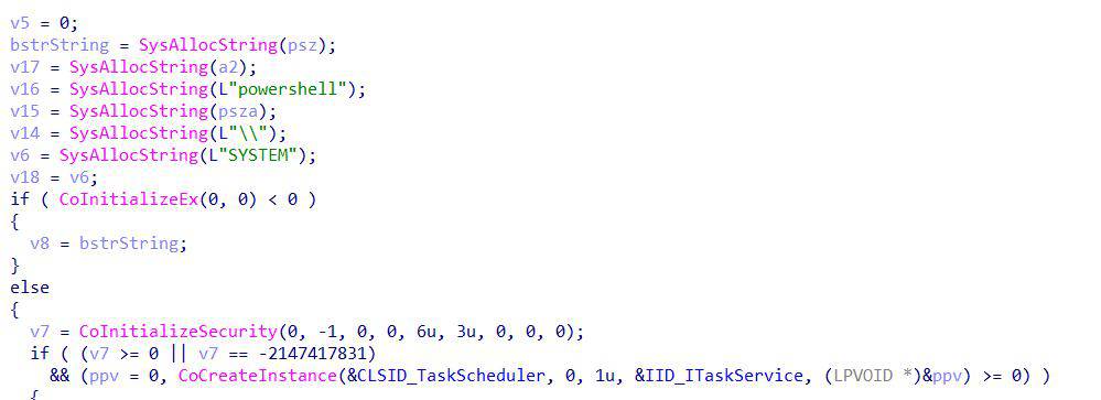

Finally, the installer creates a scheduled task to execute the PowerShell command using COM objects, the task is configured to execute at startup with the SYSTEM account.

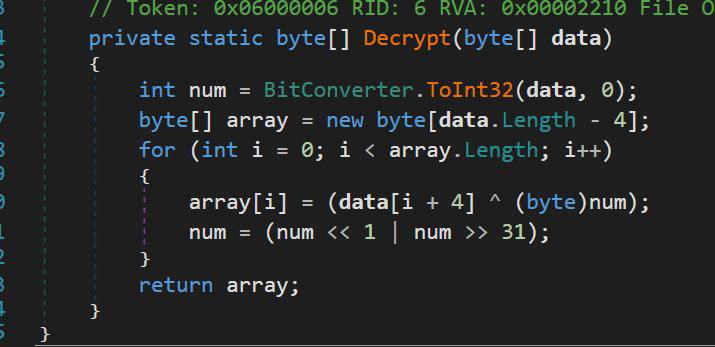

Two versions of the same service module are stored in the resource section of the stager, a 32-bit and 64-bit version that will be deployed according to the system architecture.
The payload is compressed using the GZip compression algorithm and it uses a simple XOR for decryption. After decompression, the stager uses the first 4-bytes as an XOR key to decrypt the rest of the data.

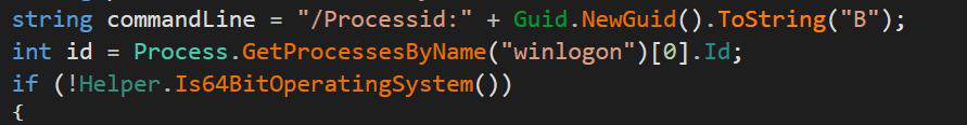

Parent PID spoofing
To make the process hollowing injection appear legitimate, the parent PID spoofing technique is used to evade threat hunters and security tooling. This technique allows attackers to run processes under any parent process they want.
The malware first gets the process ID of the running winlogon.exe process which is a component of the Microsoft Windows operating system.
It then uses 5 Windows APIs:
  1. OpenProcess : Get the parent process handle.
  2. InitializeProcThreadAttributeList : Initialize the attribute list.
  3. UpdateProcThreadAttribute: Set the parent process handle via the PROC_THREAD_ATTRIBUTE_PARENT_PROCESS attribute.
  4. CreateProcess: Creates a new process under the spoofed parent
This technique triggers Elastic’s Parent Process PID Spoofing detection rule.

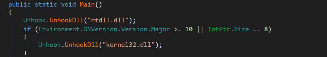

Unhooking DLLs
Using the same technique used in the stager, the binary unhooks both NTDLL.dll and KERNEL32.dll.

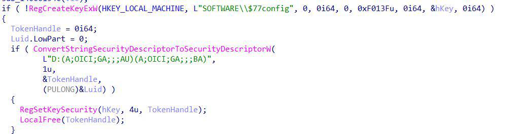

Config setup
The service module stores the configuration as registry entries; it first creates a key in the HKEY_LOCAL_MACHINE** SOFTWARE$77config** file that can be modified by any user on the machine.
It then stores the current process ID running the service module as a value in a registry key named either “svc32” or “svc64” under the key HKEY_LOCAL_MACHINE** SOFTWARE$77config\pid**. The svc32/64 key name is based on the system architecture.

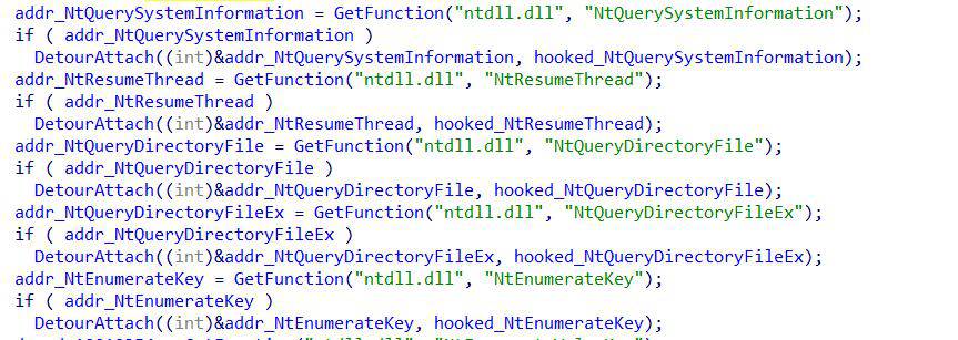

The rootkit’s core
The last module is the core module, responsible for installing hooks on important Windows APIs and filtering the output of said APIs according to the rootkit’s configuration. It is a DLL loaded into running processes by the service module. Its main purpose is to set hooks using the Detours project on important Windows API namely
  • NtQuerySystemInformation
  • NtResumeThread
  • NtQueryDirectoryFile
  • NtQueryDirectoryFileEx
  • NtEnumerateKey
  • NtEnumerateValueKey
  • EnumServiceGroupW
  • EnumServicesStatusExW
  • NtDeviceIoControlFile
These Native Windows APIs are used to enumerate/fetch information about the system, an example of that is regedit which relies heavily on NtEnumerateKey and NtEnumerateValueKey to enumerate the system’s registry keys. The installed hook is capable of enumerating the keys and filtering out keys that are configured by the threat actors, the rest is forwarded to the regedit process.
By filtering the output of the Windows APIs, the core module is able to selectively hide specific files, processes, or registry keys from the system's users and security tools.
