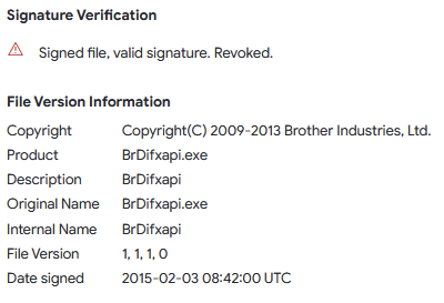

BrDifxapi.exe is a binary developed by the Japanese company Brother Industries and the version we observed has a revoked signature.
BrDifxapi.exe with revoked signature

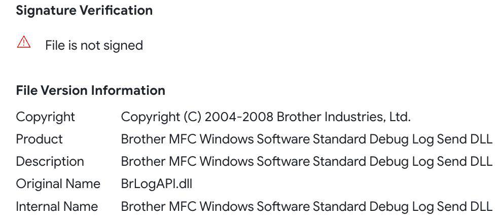

The legitimate DLL named BrLogApi.dll is an unsigned DLL also by Brother Industries. BLOODALCHEMY uses the same DLL name.
The legitimate BrLogApi.dll is an unsigned DLL file

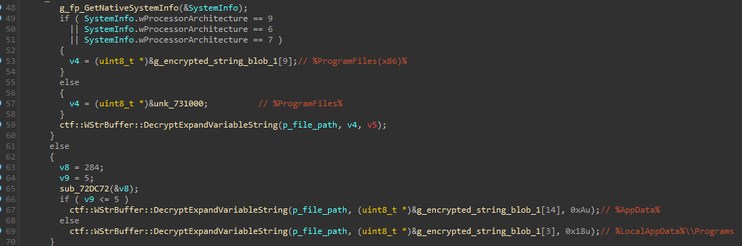

The root directory of the persistence folder is chosen based on its current privilege level, it can be either:
  • %ProgramFiles%
  • %ProgramFiles(x86)%
  • %Appdata%
  • %LocalAppData%\Programs
BLOODALCHEMY root persistence folder choice

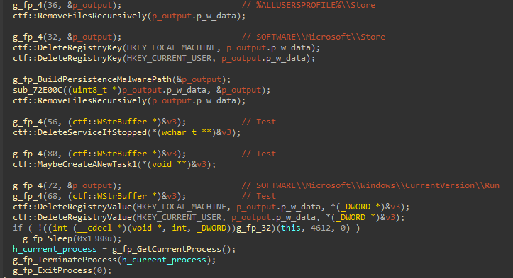

To identify the persistence mechanisms, we can use the uninstall command to observe the different ways that the malware removes persistence.
As a service named Test.
BLOODALCHEMY deleting previously installed service
As a registry key at CurrentVersion\Run
BLOODALCHEMY deleting “CurrentVersion\Run” persistence registry key

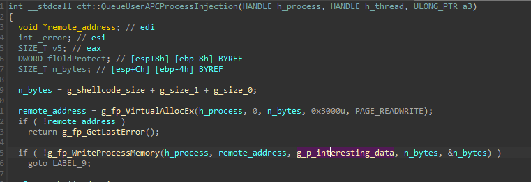

Or create a Windows process from a hardcoded list and inject a shellcode passed by parameter to the entry point using the WriteProcessMemory+QueueUserAPC+ResumeThread method.
Process injection running method
List of target binaries for process injection
The shellcode is contained in the parameters we call p_interesting_data. This parameter is actually a pointer to a structure containing both the malware configuration and executable binary data.
Entrypoint prototype
Provided shellcode copied in the remote process
Final part of the process injection procedure

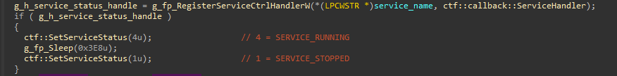

Also when running as a service and started by the service manager the malware will masquerade itself as stopped by first setting the service status to “SERVICE_RUNNING” then setting the status to “SERVICE_STOPPED” while in fact the malware is still running.
BLOODALCHEMY’s service entry point masquerading service status

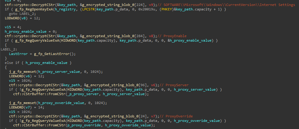

In this scenario, BLOODALCHEMY will try to use any proxy server found in the registry key SOFTWARE\\Microsoft\\Windows\\CurrentVersion\\Internet Settings.
Host proxy information gathered from registry

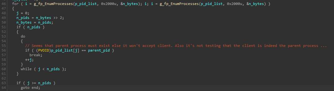

While waiting for a client to connect to this named pipe the malware scans the running processes and checks that its parent process is still running, this may be to limit access to the named pipe. That said, the malware is not checking that the pipe client is the correct parent process, only that the parent process is running. This introduces flawed logic in protecting the named pipe.
Retrieve parent PID
Flawed check for restricting pipe access to parent process

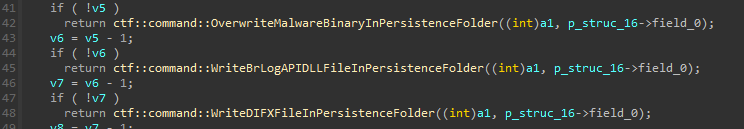

There are three commands that write (or overwrite) the malware tool set with the received Base64-encoded binary data:
  • Either the malware binary (Test.exe)
  • the sideloaded DLL (BrLogAPI.dll)
  • or the main trusted binary (BrDifxapi.exe)
BLOODALCHEMY tool set overwrite commands

The uninstall and terminate itself command will first delete all its files at specific locations then remove any persistence registry key or scheduled task, then remove installed service and finish by terminating itself.
Command to uninstall and terminate itself
Uninstall function
