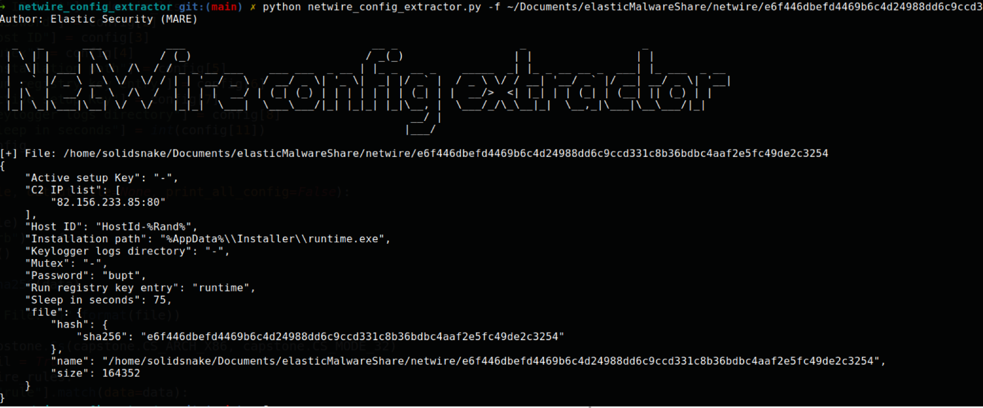

Our extractor takes either a directory of samples with -d option or -f for a single sample and then can output parts of the configuration of note, specifically:
- -k : extract the encryption keys
- -c : extract the C2 information
- -s : extract the wide-character strings
- -a : extract the ASCII character strings
docker run -ti --rm -v $(pwd)/data:/data netwire_loader_config_extractor:latest -d "C:\tmp\samples"
NETWIRE configuration extractor
You can collect the extracted configurations from the directory you set when running the extractor.
