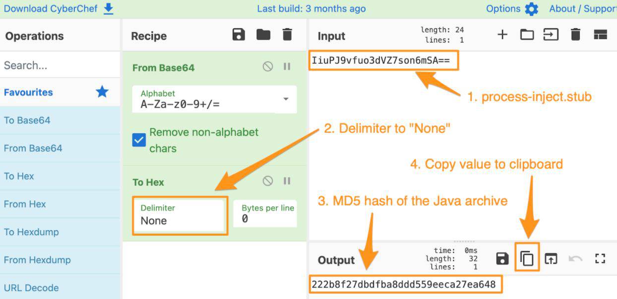

The stub field contains the Base64 encoded MD5 file hash of the Cobalt Strike Java archive. To convert this, we can again use CyberChef, this time add the "From Base64" and "To Hex" recipes, ensure you change the "Delimiter" to "None" in the "To Hex" recipe.

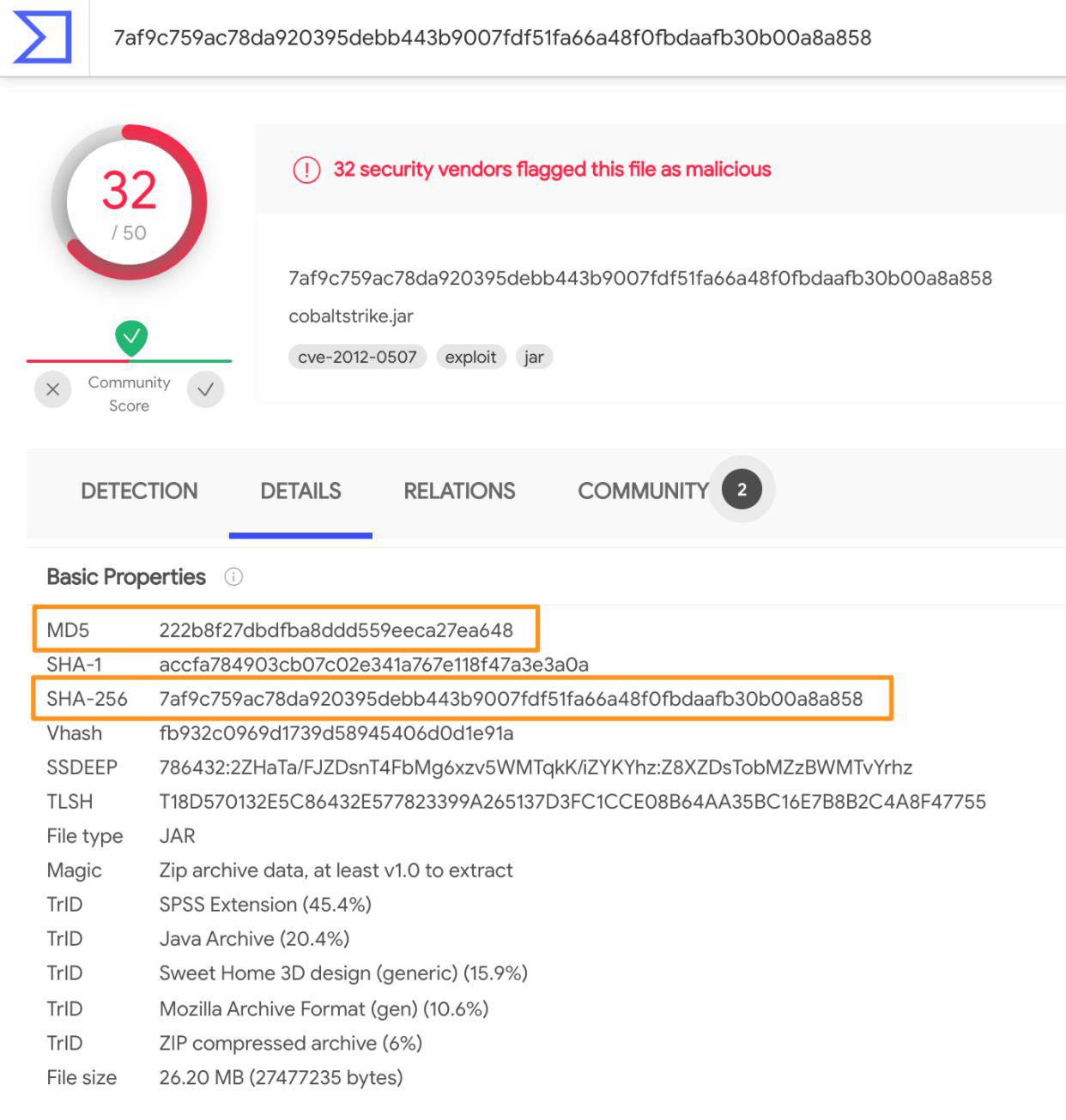

Now that we have the MD5 value of the Java archive (222b8f27dbdfba8ddd559eeca27ea648), we can check that against online databases like VirusTotal to get additional information, specifically, the SHA256 hash (7af9c759ac78da920395debb443b9007fdf51fa66a48f0fbdaafb30b00a8a858).

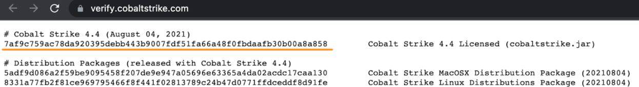

Finally, we can verify the SHA256 hash with CobaltStrike to identify the version of the Java archive by going to https://verify.cobaltstrike.com and searching for the hash.
Now we know that this beacon was created using a licensed version of Cobalt Strike 4.4.

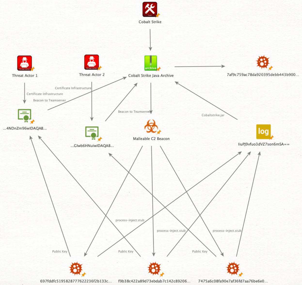

To test out our analyst playbook for collecting Cobalt Strike beacon payloads, their configurations, and metadata contained within; we can apply those to more data to identify clusters of activity.
In the above illustration, we can cluster threat actors based on their shared uses of the beacon payload public key, which as we described above, is unique per Team Server. This would allow us to group multiple beacon payload hashes, infrastructure, and campaigns to a single Threat Actor.
As always, using the atomic indicators extracted from the beacon payload configurations (clevelandclinic[.]cloud in our example) allow you to identify additional shared infrastructure, target verticals, and threat actor capabilities.
