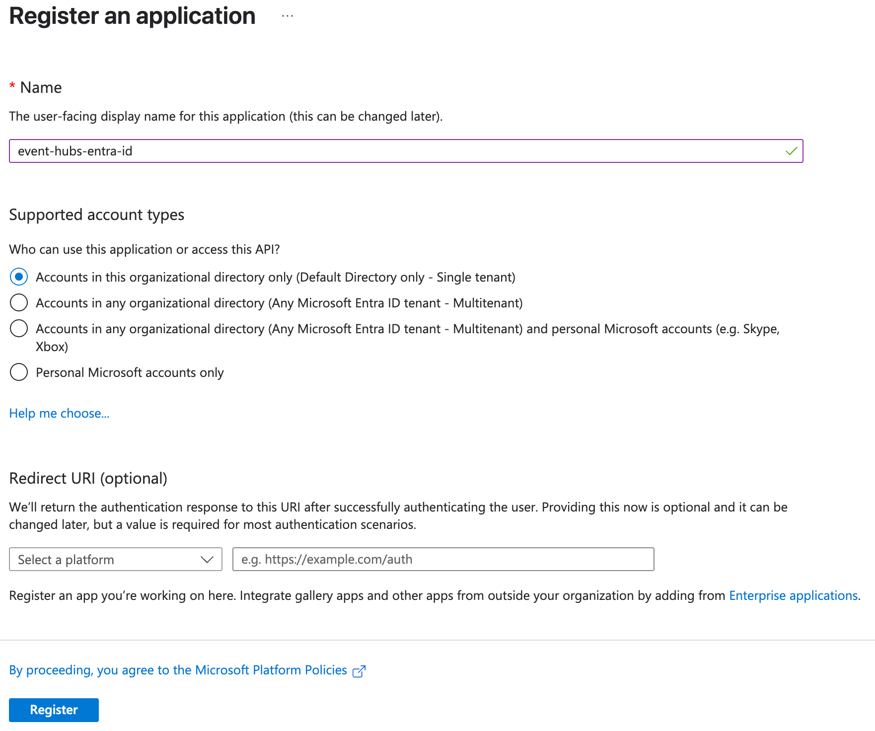

Navigate to the Azure Portal and search for “App Registrations.” On the App Registrations page, add a New Registration. Provide a name, and modify the supported account types if you wish. The Redirect URI can be left empty. Then click Register.
1-register an application

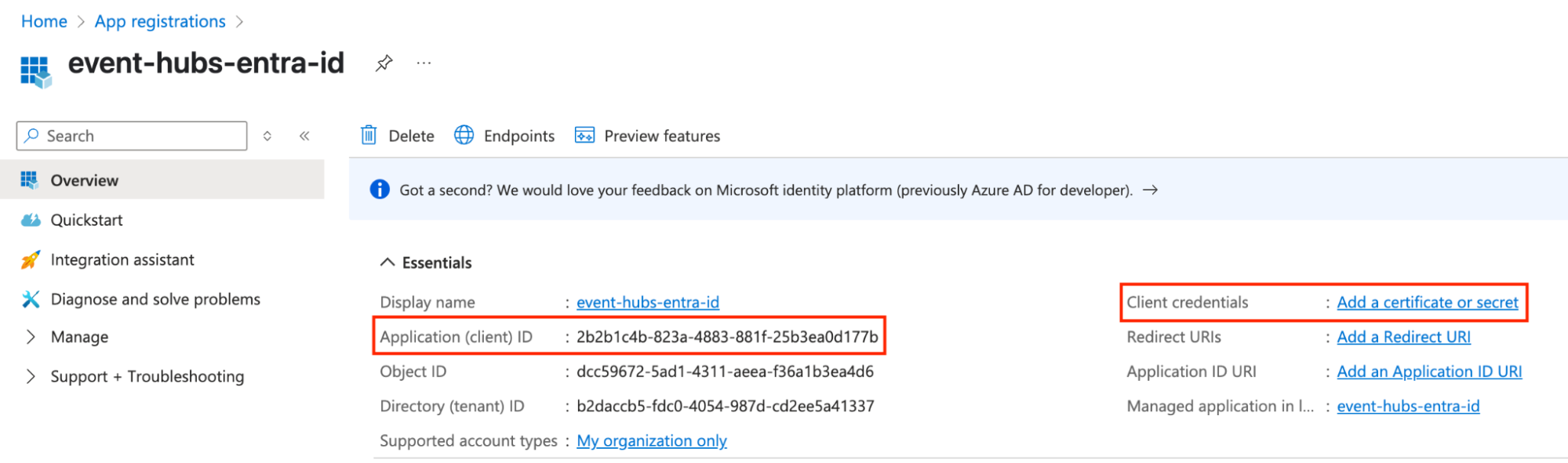

After registering your application, you will be redirected to the details page for your app registration. Here you can find the Application (client) ID and also generate a client credential. Click Add a certificate or secret.
2-event-hubs-entra-id
Add a New Client Secret, provide a name, and set an appropriate expiry. Take note of the Secret Value as it will not appear again.

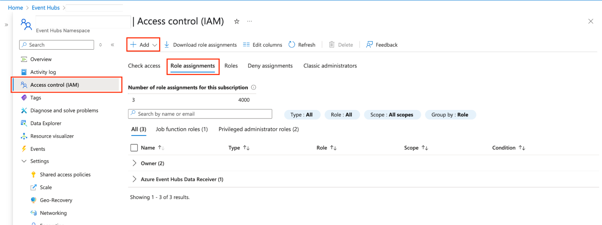

Step 3: Assign Event Hub Data Receiver Role
Now that you have an application registered to Entra ID and have the credentials, the last step is to allow this application to read from Event Hubs. Navigate to the Event Hub you wish to read from and click Access Control (IAM) > Role Assignments > Add.
3-access-control (IAM)

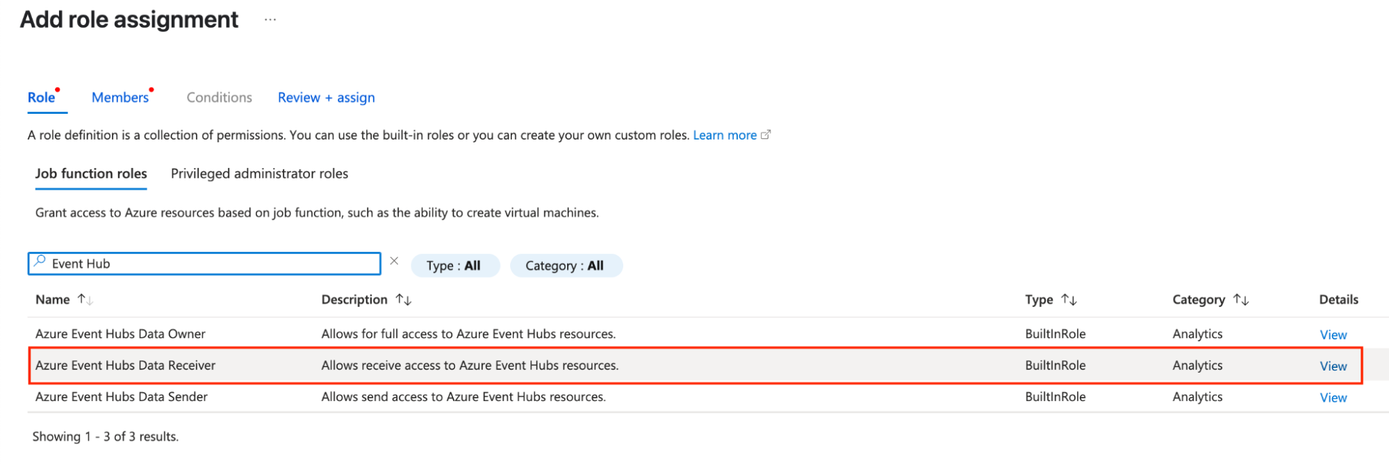

On the Add Role Assignment page, first add the Job Functions Role. Search for “Event Hub” and select Azure Event Hubs Data Receiver.
4-add role assignment

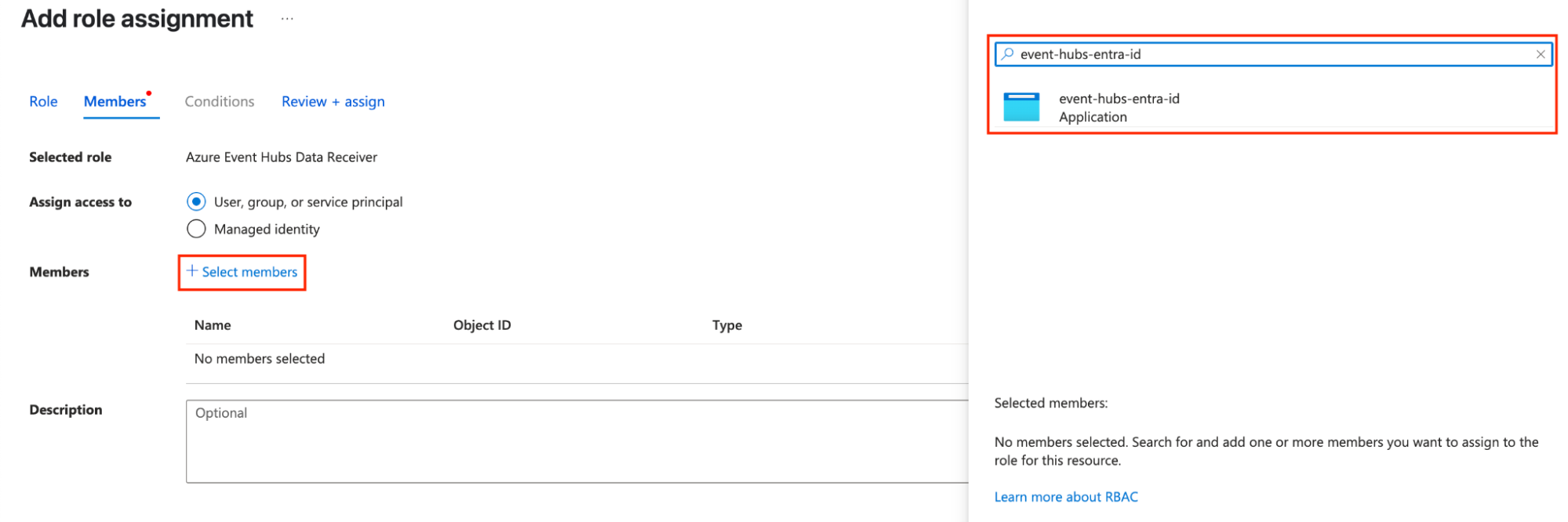

Then click the Members tab, select User, group or service principal, and click Select members. Search for the application name you created in Step 1.
5-add role assignment-2
Click Review and Assign to complete the role assignment.

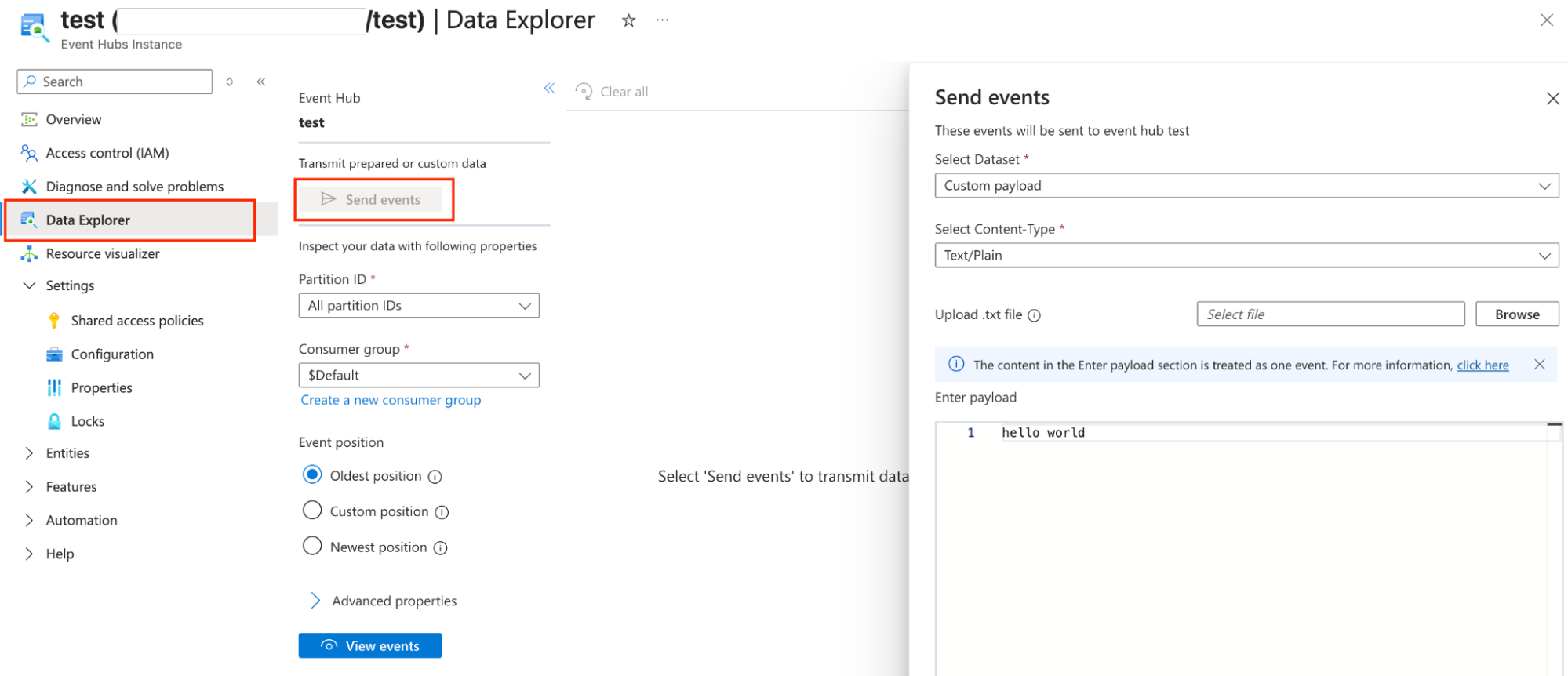

Now, all we need to do is test the configuration. A fast way to test if your configuration is working is to use Event Hubs Data Explorer. This allows you to write events directly into the Event Hub for testing purposes.
6-send events

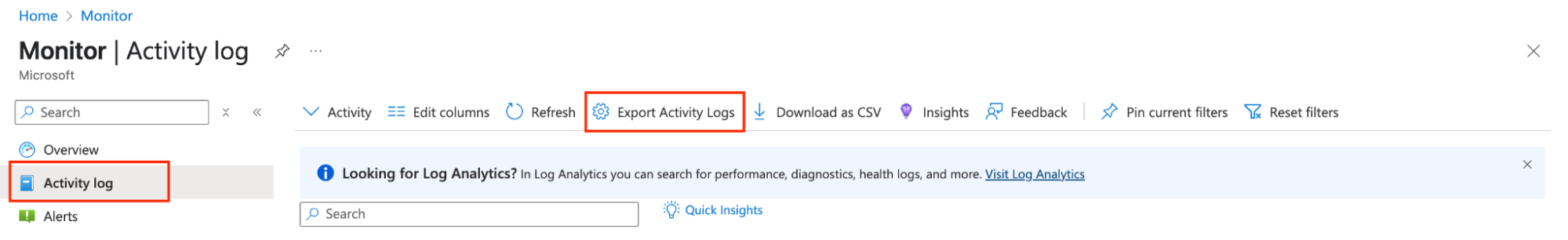

To see this secure pipeline in action, let's configure it for a common and critical use case: streaming Azure Activity Logs into Elastic. This enables robust security analysis and monitoring, all of which is protected by Entra ID authentication. In the Azure portal, search for Monitor, then navigate to Activity Log and Export Activity Logs.
7-monitor activity log

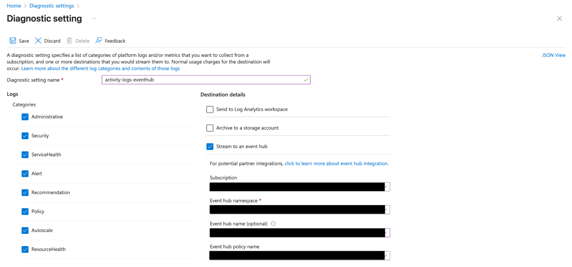

Next, configure a Diagnostic Setting to send the log categories to the Event Hub. In the Event Hub configuration section, select the Event Hub namespace configured in Azure Configuration Step 3. Additionally, provide the Event Hub name and an Event Hub policy name (SAS) with write permissions to the Event Hub.
8-diagnostic setting

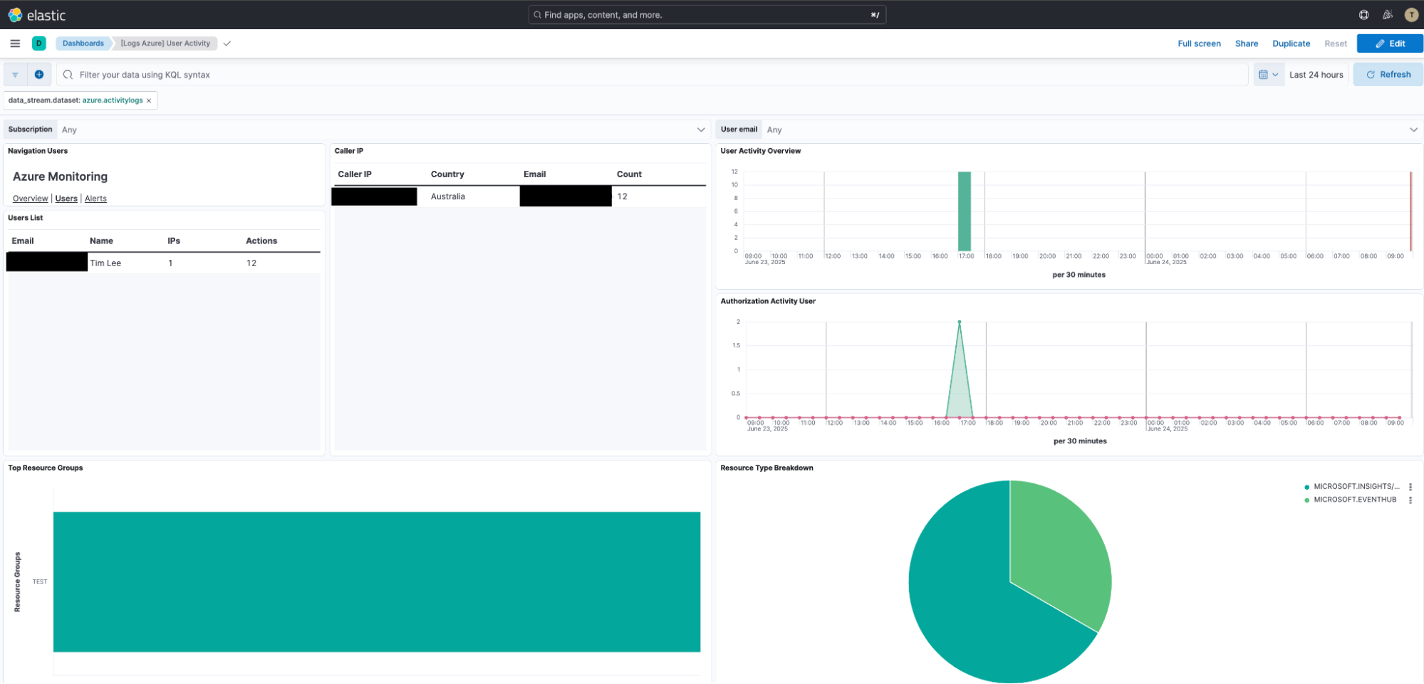

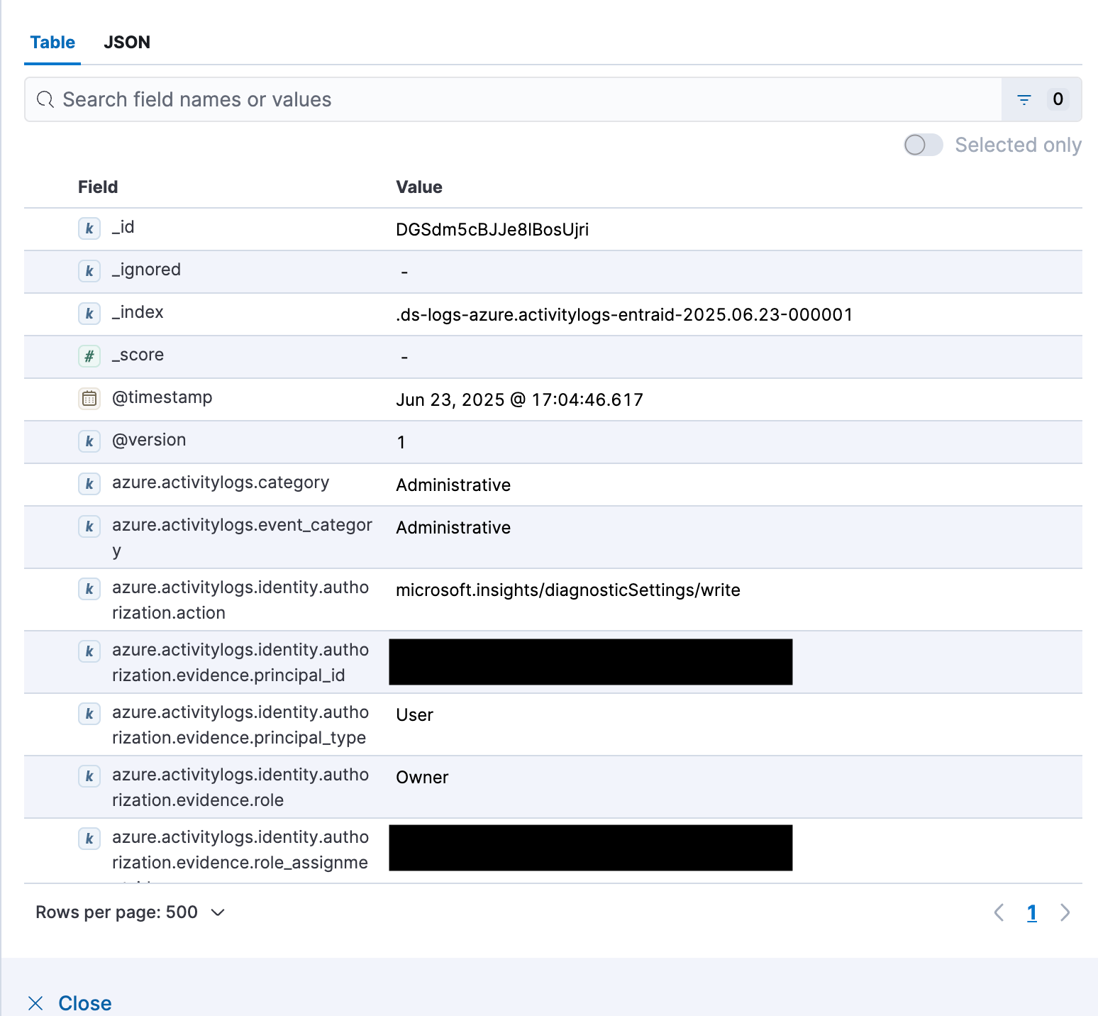

Data is written into the logs-azure.activitylogs-entraid data stream as defined in the Logstash output configuration. This automatically activates the Azure activity logs ingest pipeline in Elasticsearch, processing the incoming data. The data is automatically ingested, and the out-of-the-box Azure Activity Dashboard lights up.
9-table json
10-green graphs
