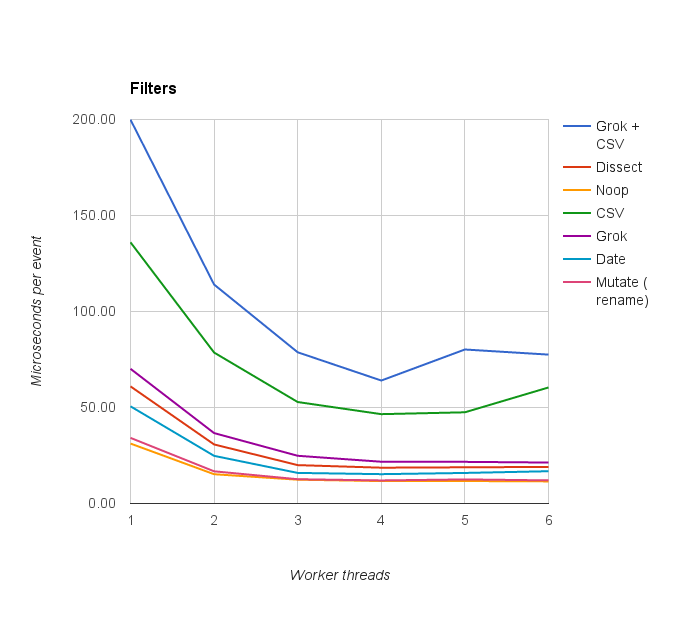

Chart 1: A plot of average time in microseconds taken to process an event for various filters with 1 to 6 workers

From Table 2, it can be seen that Dissect out-performs Grok + CSV by some margin but with less certainty. See the important note below.

From the above tables and chart one can see that the CSV filter is responsible for the lower performance of the Grok + CSV configuration and that Grok when configured optimally, performs just fine for this data set.

Practical configurations might use other filters like the Mutate filter and the Date filter. Tables 3 and 4 show performance for these filters so you can get a feel for how latencies might build on each other.
Also note that the performance for the Date filter above is for a single pattern that always matches and that latency will increase with multiple patterns when some dates in your data do not match the first pattern.
