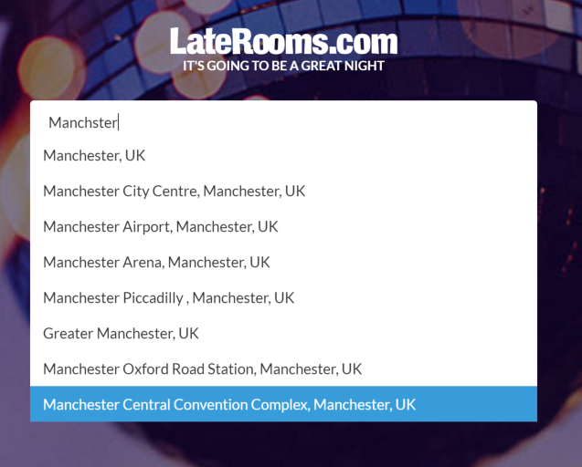

Autocomplete
Last year we completed a project to rewrite our existing autocomplete feature. Our existing system was slow and the results were not great. We chose to use the Elasticsearch Completion Suggester feature, as we were convinced this would give us the performance we needed.
This allowed us to load our destination data and all our hotels into a single index. Each document in the index has a suggest field which we use to match the input text, display text which is what you see in the drop down, and some metadata about the entry.

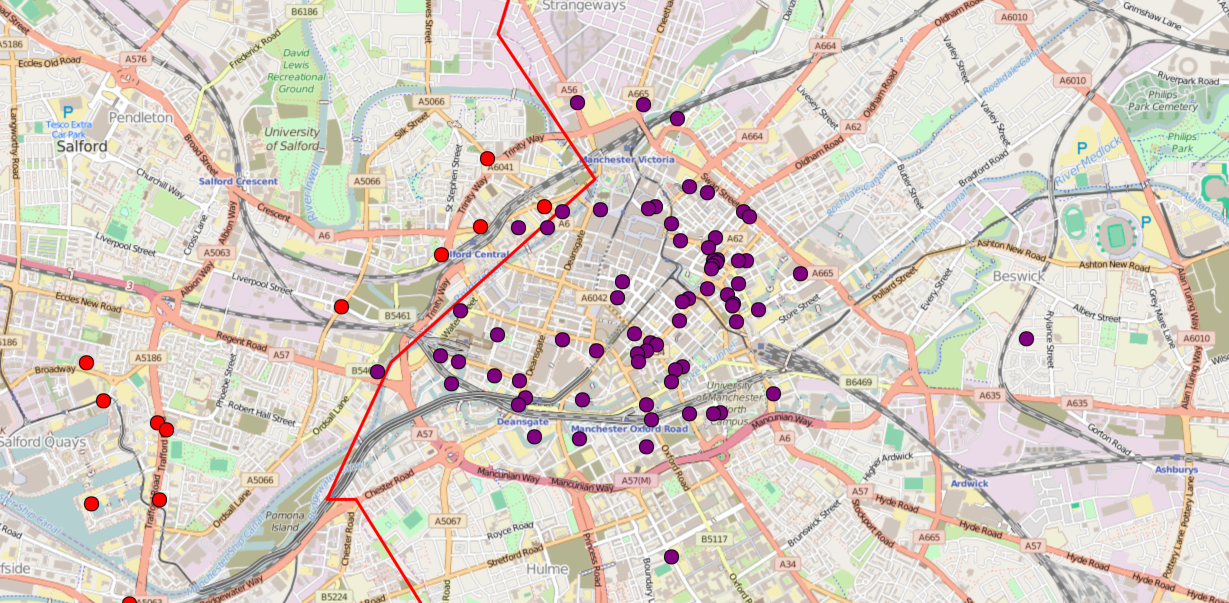

Sourcing the polygons is one of our biggest challenges. Freely available data sources such as OpenStreetMaps and Ordnance Survey have an incredible level of detail we don’t need for our searches. In order to minimise index size and indexing time we reduce the polygon before indexing it. Furthermore we have the issue of accuracy. Most of this data is too accurate for us. While official boundaries and borders are great for administrations they aren’t great for finding hotels, and we often need polygons that extend well beyond the official borders. Our home city of Manchester is a great example, the red line show the boundary of Manchester, purple dots are inside Manchester, red ones outside:
This map shows the official boundaries of Manchester and the neighbouring city of Salford. As you can see many of the hotels near the city centre of Manchester are actually in Salford. If a user is searching for Manchester hotels they expect to see those hotels listed even though they are not technically in Manchester. This turns out to be a very common situation. We could address this with a team of cartographers and a lot of effort but this would be very expensive. So we resolve this issue by having multiple shapes for each destination and A/B testing them until we find one which works best for our customers.
